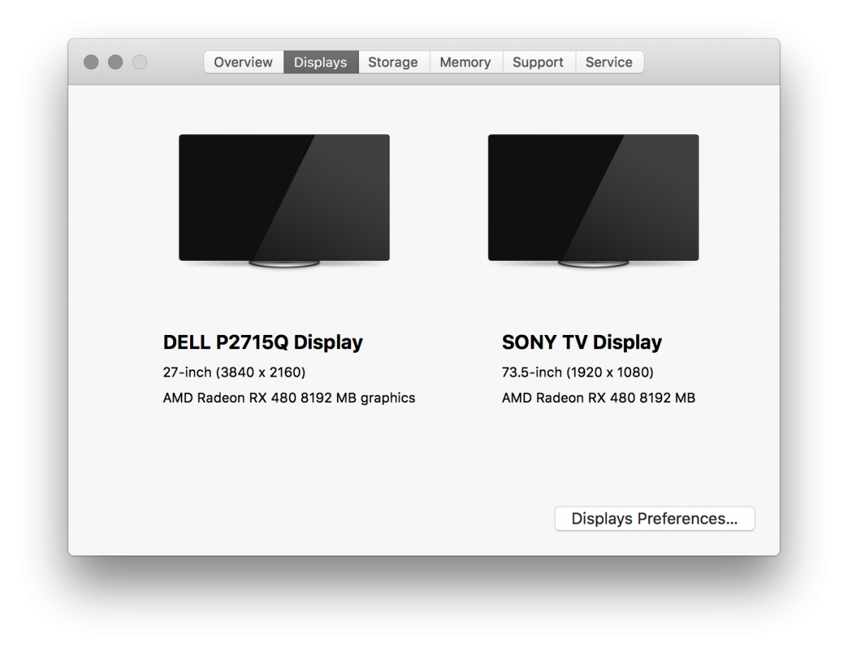

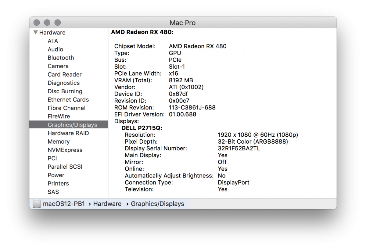

AMD RX 480 8GB can boot on macOS Sierra Public Beta
But no QE/CI.
Need patch AMD9500 kext ?
DP & HDMI can show on.
