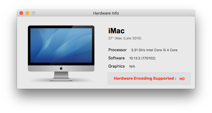

Seems like it’s purely cosmetic so far.
The graphics are fine when I log in through screen sharing, it’s just the screen that is black but I’ll try HDMI instead of DVI.
The Samsung 950 PRO connected to the “HDMI port” is actually the boot drive and I get 1.4 GB/sec write and about 2 GB/sec read speeds.

I tried with an HDMI cable but it made no difference. If I connect both with DVI and HDMI the two screens are detected perfectly in OSX and I can see them through screen sharing.
Screen is detected, resolution is correct, etc. but the screen is black. (though it is active, the screen does not go to sleep or turn off)
OS: 10.13.3
Clover: 4392
LILU: 1.2.2
Whatevergreen: 1.1.4
My system:
HP Z800 motherboard, Xeon X5690 cpu, 48GB ECC RAM
PCIe2 slot0: x4, holds Samsung 950 PRO nvme boot drive. (EFI/Clover is on a USB stick since the Z800 won't load the ahci option rom from the nvme drive)
PCIe2 slot1: x16, ASUS ROG STRIX RX 580 TOP https://www.asus.com/us/Graphics-Cards/ROG-STRIX-RX580-T8G-GAMING/overview/
PCIe2 slot2: x4, empty
PCIe2 slot3: x8, empty
PCIe2 slot4: x16, empty (would normally hold an Intel 520 DA1 10GbE card)
PCI32 slot5: empty
PCIe2 slot6: x8, empty (would normally hold USB 3 card based on FL1100)
Here's a zip of my EFI folder:
https://www.dropbox.com/s/hhcryzaig2nm3pi/EFI-robertr-2018-01-30.zip?dl=0
Please tell me what more info I would need to supply, logs, etc.
If this is the wrong thread/forum, please excuse me and tell me where to post.
Cheers!
