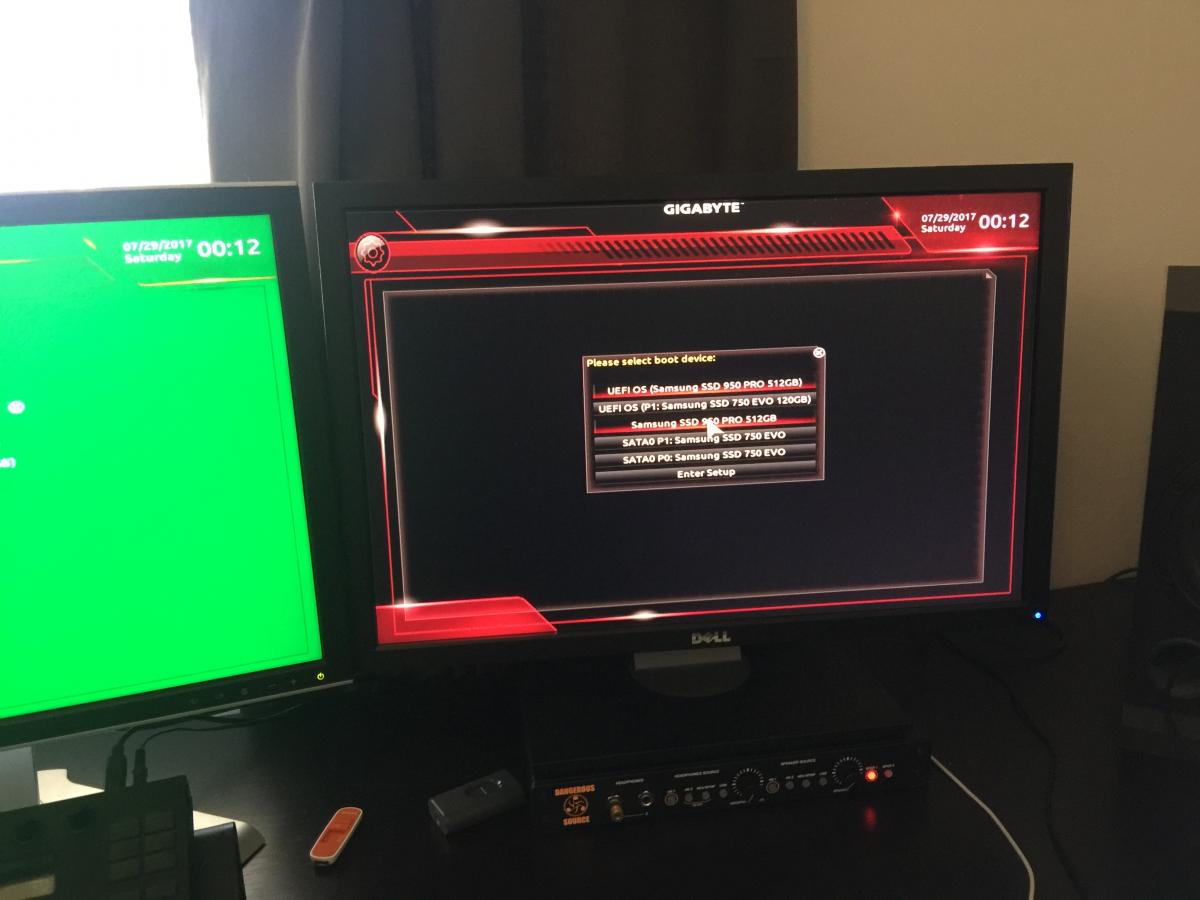

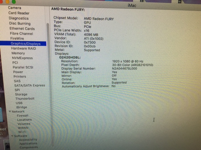

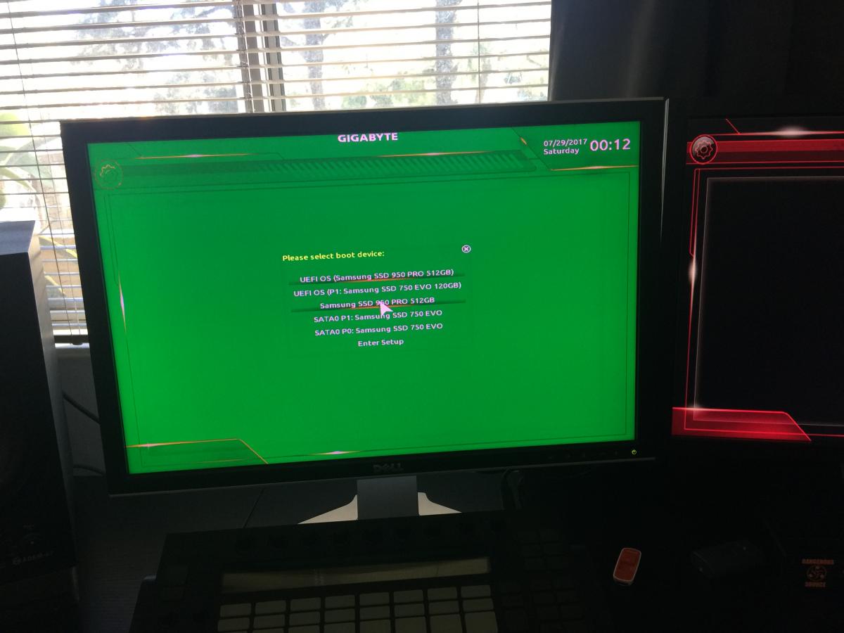

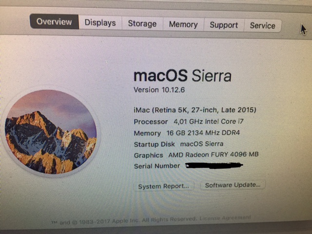

TombaFI Posted July 28, 2017 Share Posted July 28, 2017 Just awesome! macOS Sierra 10.12.6 fully working Amd Fury! Without iGPU helper....No more black screen issue Put WhateverGreen.kext and Lilu.kext (1.1.6) to EFI/Clover/Kext/Other folder, and you ready to GO! Boot arguments -liludbg -raddbg -radbeta Bios settings at my Asus B150I Pro: Advanced/Primary Dispaly= Auto and iGPU Multi-Monitor=Disable I also tested sleep mode and fully working so far.... 4 Link to comment https://www.insanelymac.com/forum/topic/312582-amd-polaris-ids-on-sierra-high-sierra/page/24/#findComment-2470747 Share on other sites More sharing options...
