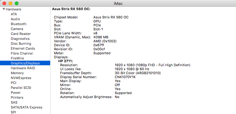

telepati Posted April 5, 2018 Share Posted April 5, 2018 1 hour ago, Cyberdevs said: @telepati Have you tested my EFI folder? Yes, I replace my EFI with yours and result doesn't change signal loss persist but the name is changed in System Reports 55 minutes ago, Cyberdevs said: Can you explain more, what is exactly happening, when does it lose the signal? is it the black screen issue or it loses the signal in the second stage of the boot process? This is what happening; Link to comment https://www.insanelymac.com/forum/topic/312582-amd-polaris-ids-on-sierra-high-sierra/page/32/#findComment-2607979 Share on other sites More sharing options...
Cyberdevs Posted April 6, 2018 Share Posted April 6, 2018 @telepati Oh, Yeah that's normal. That's were the first stage of boot ends and the second stage starts. You check this topic it might be helpful. 1 Link to comment https://www.insanelymac.com/forum/topic/312582-amd-polaris-ids-on-sierra-high-sierra/page/32/#findComment-2608061 Share on other sites More sharing options...

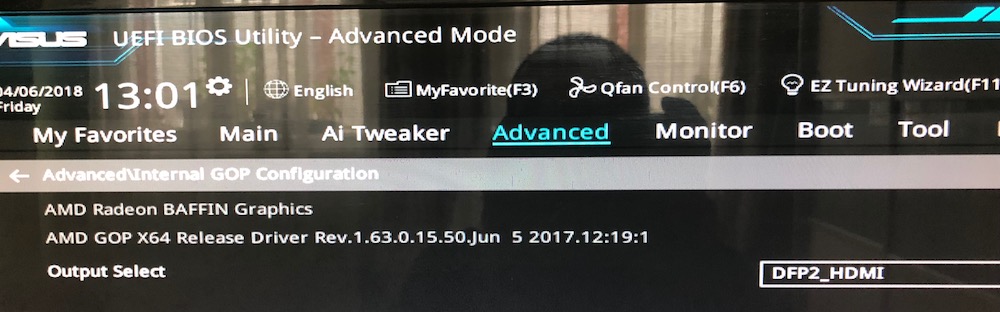

telepati Posted April 6, 2018 Share Posted April 6, 2018 7 hours ago, Cyberdevs said: @telepati Oh, Yeah that's normal. That's were the first stage of boot ends and the second stage starts. You check this topic it might be helpful. Thank you. You mention about GOP settings I checked in the BIOS and my GOP settings look like that; is it Ok? Link to comment https://www.insanelymac.com/forum/topic/312582-amd-polaris-ids-on-sierra-high-sierra/page/32/#findComment-2608132 Share on other sites More sharing options...
Cyberdevs Posted April 6, 2018 Share Posted April 6, 2018 @telepati It depends of the amount of displays you have. on a single display setup it doesn't matter much but when you have more that one display you can select that display as the main display which gets the signal when system is turned on. 1 Link to comment https://www.insanelymac.com/forum/topic/312582-amd-polaris-ids-on-sierra-high-sierra/page/32/#findComment-2608177 Share on other sites More sharing options...

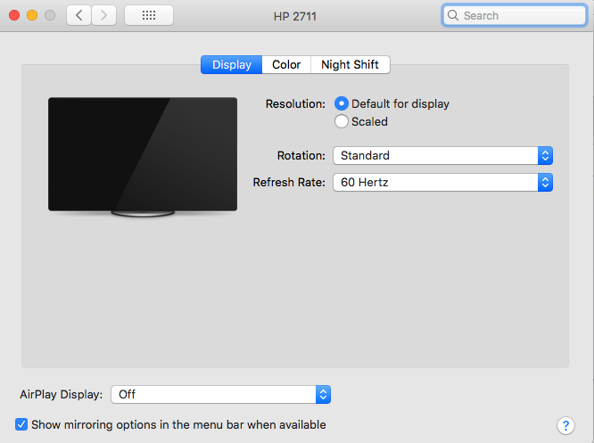

telepati Posted April 6, 2018 Share Posted April 6, 2018 is AirPlay working with RX560? Link to comment https://www.insanelymac.com/forum/topic/312582-amd-polaris-ids-on-sierra-high-sierra/page/32/#findComment-2608224 Share on other sites More sharing options...

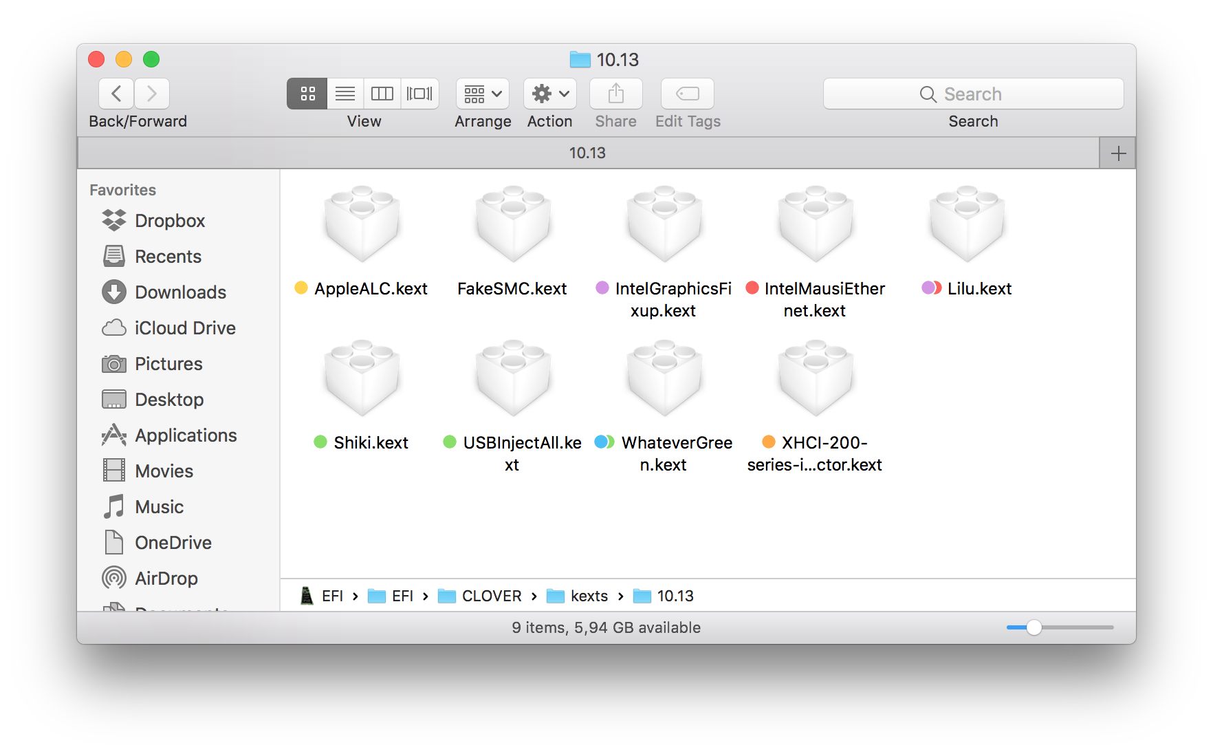

telepati Posted April 11, 2018 Share Posted April 11, 2018 (edited) I activated Airplay and 2 GPU same time Here is what I did; 1. Moved all kexts to Clover/Other 2. Install latest IntelGraphicsFixup.kext (v1.2.7) to Clover/Other 3. BIOS set PEG is primary IGPU Multi monitor Enabled DVMT 128MB 4. Restart Both Graphics and Airplay is working; Edited April 12, 2018 by telepati Link to comment https://www.insanelymac.com/forum/topic/312582-amd-polaris-ids-on-sierra-high-sierra/page/32/#findComment-2609183 Share on other sites More sharing options...
hackaro Posted April 12, 2018 Share Posted April 12, 2018 15 hours ago, telepati said: I activated Airplay and 2 GPU same time Here is what I did; 1. Moved all kexts to Clover/Other 2. Install latest IntelGraphicsFixup.kext (v1.2.6) to Clover/Other 3. BIOS set PEG is primary IGPU Multi monitor Enabled DVMT 128MB 4. Restart Both Graphics and Airplay is working; can you show me your config.plist? Link to comment https://www.insanelymac.com/forum/topic/312582-amd-polaris-ids-on-sierra-high-sierra/page/32/#findComment-2609293 Share on other sites More sharing options...

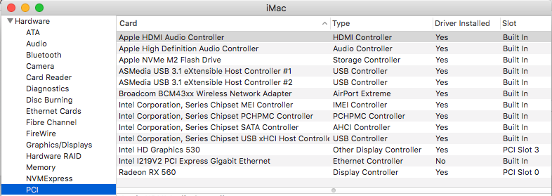

hackaro Posted April 12, 2018 Share Posted April 12, 2018 52 minutes ago, telepati said: Here is my config.plist config.plist Thanks!!! ... I'd like to understand how you have all the PCI controllers listed in Mac->System report, can you also share your folder CLOVER->ACPI->PATCHED? Thank in advance! Link to comment https://www.insanelymac.com/forum/topic/312582-amd-polaris-ids-on-sierra-high-sierra/page/32/#findComment-2609357 Share on other sites More sharing options...

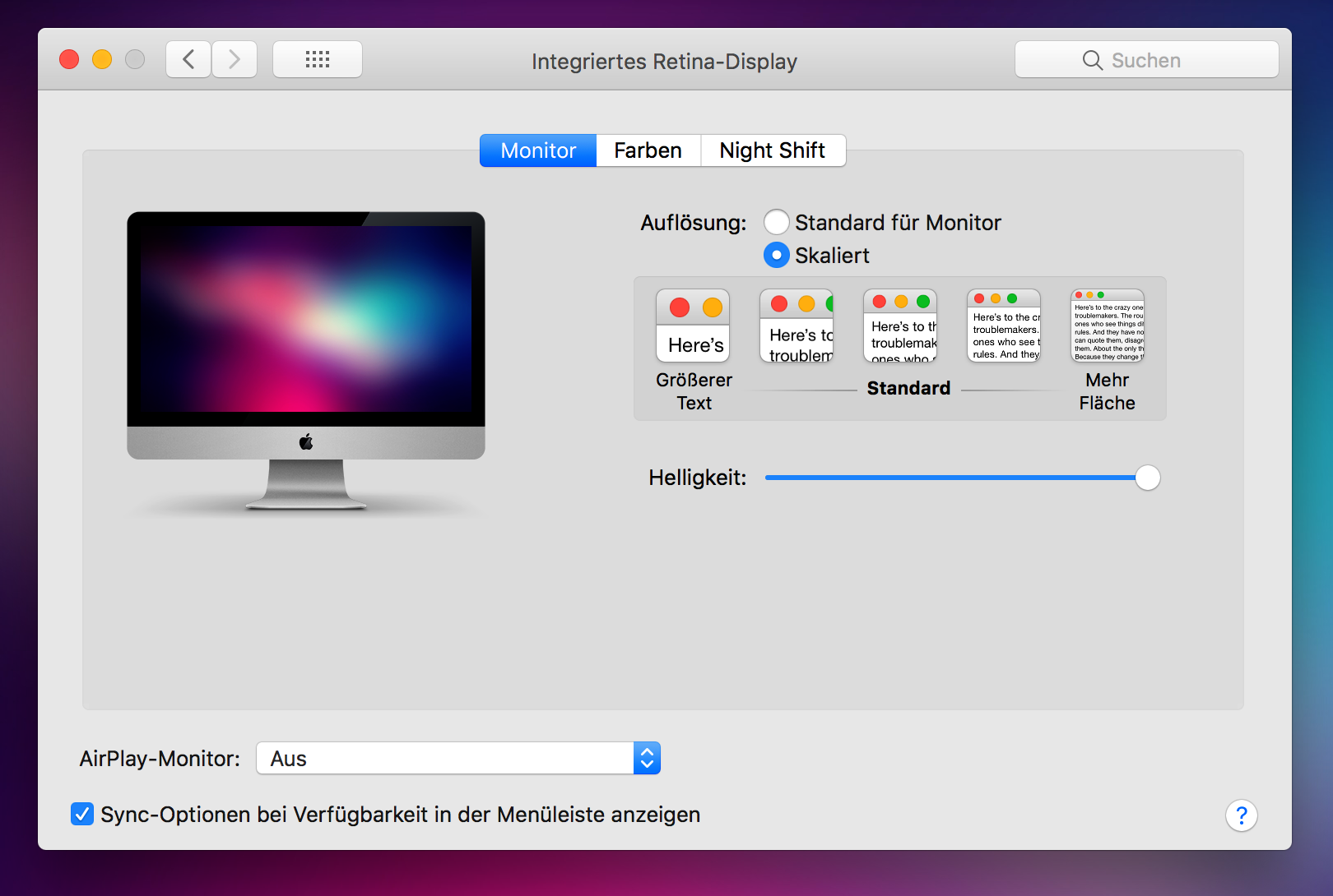

truemac Posted April 12, 2018 Share Posted April 12, 2018 (edited) On 7.4.2018 at 1:32 AM, telepati said: is AirPlay working with RX560? you can enable AirPlay without Intel Graphics. you need to add this to AMDEllesmereGraphicsAccelerator <key>IOGVAHEVCDecode</key> <string>1</string> <key>IOGVAHEVCEncode</key> <string>1</string> Edited April 12, 2018 by truemac 2 Link to comment https://www.insanelymac.com/forum/topic/312582-amd-polaris-ids-on-sierra-high-sierra/page/32/#findComment-2609399 Share on other sites More sharing options...
Cyberdevs Posted April 12, 2018 Share Posted April 12, 2018 (edited) 6 minutes ago, truemac said: you can enable AirPlay without Intel Graphics. you need to add this to AMDEllesmereGraphicsAccelerator <key>IOGVAHEVCDecode</key> <string>1</string> <key>IOGVAHEVCEncode</key> <string>1</string> You're first statement is correct, No need for iGPU to activate AirPlay but I didn't add anything to activate the AirPlay. It's working OOB here. Edited April 12, 2018 by Cyberdevs Link to comment https://www.insanelymac.com/forum/topic/312582-amd-polaris-ids-on-sierra-high-sierra/page/32/#findComment-2609403 Share on other sites More sharing options...
truemac Posted April 12, 2018 Share Posted April 12, 2018 6 minutes ago, Cyberdevs said: You're first statement is correct, No need for iGPU to activate AirPlay but I didn't add anything to activate the AirPlay. It's working OOB here. do you have Vega Card? Link to comment https://www.insanelymac.com/forum/topic/312582-amd-polaris-ids-on-sierra-high-sierra/page/32/#findComment-2609405 Share on other sites More sharing options...
Cyberdevs Posted April 12, 2018 Share Posted April 12, 2018 2 minutes ago, truemac said: do you have Vega Card? Nope, I have an AMD RX580 Link to comment https://www.insanelymac.com/forum/topic/312582-amd-polaris-ids-on-sierra-high-sierra/page/32/#findComment-2609406 Share on other sites More sharing options...
truemac Posted April 12, 2018 Share Posted April 12, 2018 Just now, Cyberdevs said: Nope, I have an AMD RX580 which GraphicsAccelerator use this card? and which OSX version you use? Link to comment https://www.insanelymac.com/forum/topic/312582-amd-polaris-ids-on-sierra-high-sierra/page/32/#findComment-2609407 Share on other sites More sharing options...
Cyberdevs Posted April 12, 2018 Share Posted April 12, 2018 1 minute ago, truemac said: which GraphicsAccelerator use this card? and which OSX version you use? RX580 is using Ellesmere Framebuffer and I use macOS 10.13.4. Link to comment https://www.insanelymac.com/forum/topic/312582-amd-polaris-ids-on-sierra-high-sierra/page/32/#findComment-2609408 Share on other sites More sharing options...
truemac Posted April 12, 2018 Share Posted April 12, 2018 Interesting. I use this to enable Airplay for my R9 270X. Link to comment https://www.insanelymac.com/forum/topic/312582-amd-polaris-ids-on-sierra-high-sierra/page/32/#findComment-2609410 Share on other sites More sharing options...
Cyberdevs Posted April 12, 2018 Share Posted April 12, 2018 Just now, truemac said: Interesting. I use this to enable Airplay for my R9 270X. Ever since macOS 10.13.4 came out there are lots of interesting options available for AMD GPUs on hackintoshes. For instance I don't use WhateverGreen and Lilu and I don't use RadeonDeInit or a SSDT, the GPU is detected OOB and everything is working perfectly fine. I'll give my R9 270X a try later and see if the AirPlay is working on that GPU or not. As you know AirPlay is a feature which is dependent on the network and AirPlay capable devices such as AppleTV so I don't know why it doesn't work on your rig without that patch. 1 Link to comment https://www.insanelymac.com/forum/topic/312582-amd-polaris-ids-on-sierra-high-sierra/page/32/#findComment-2609416 Share on other sites More sharing options...
truemac Posted April 12, 2018 Share Posted April 12, 2018 i have Apple orginal BCM43602 802.11ac Wireless LAN SoC its not depends on that. maybe just for RX Cards and above. Link to comment https://www.insanelymac.com/forum/topic/312582-amd-polaris-ids-on-sierra-high-sierra/page/32/#findComment-2609419 Share on other sites More sharing options...
telepati Posted April 12, 2018 Share Posted April 12, 2018 (edited) 4 hours ago, hackaro said: Thanks!!! ... I'd like to understand how you have all the PCI controllers listed in Mac->System report, can you also share your folder CLOVER->ACPI->PATCHED? Thank in advance! PCI Controls is happening with DSDT. @MaLd0n create it DSDT for me he is the expert on this. Follow this thread; https://www.insanelymac.com/forum/forums/topic/321872-guide-sierra-high-sierra-on-mobos-serie-100-200-300-skylake-kabylake-coffeelake-dsdt/ 1 hour ago, truemac said: you can enable AirPlay without Intel Graphics. you need to add this to AMDEllesmereGraphicsAccelerator <key>IOGVAHEVCDecode</key> <string>1</string> <key>IOGVAHEVCEncode</key> <string>1</string> I checked System/Library/Extensions but I dont see this kext. Where is the path of this kext or plugin? Edited April 12, 2018 by telepati Link to comment https://www.insanelymac.com/forum/topic/312582-amd-polaris-ids-on-sierra-high-sierra/page/32/#findComment-2609422 Share on other sites More sharing options...
truemac Posted April 12, 2018 Share Posted April 12, 2018 53 minutes ago, telepati said: PCI Controls is happening with DSDT. @MaLd0n create it DSDT for me he is the expert on this. Follow this thread; https://www.insanelymac.com/forum/forums/topic/321872-guide-sierra-high-sierra-on-mobos-serie-100-200-300-skylake-kabylake-coffeelake-dsdt/ I checked System/Library/Extensions but I dont see this kext. Where is the path of this kext or plugin? /System/Library/Extensions/AMDRadeonX4000.kext or you add it via Fakesmc info.plist like this <key>eGPU</key> <dict> <key>CFBundleIdentifier</key> <string>com.apple.driver.AppleUSBHostMergeProperties</string> <key>IOClass</key> <string>AppleUSBHostMergeProperties</string> <key>IOProviderClass</key> <string>AMDEllesmereGraphicsAccelerator</string> <key>IOProviderMergeProperties</key> <dict> <key>IOGVAHEVCDecode</key> <string>1</string> <key>IOGVAHEVCEncode</key> <string>1</string> </dict> </dict> </dict> 1 1 Link to comment https://www.insanelymac.com/forum/topic/312582-amd-polaris-ids-on-sierra-high-sierra/page/32/#findComment-2609430 Share on other sites More sharing options...
