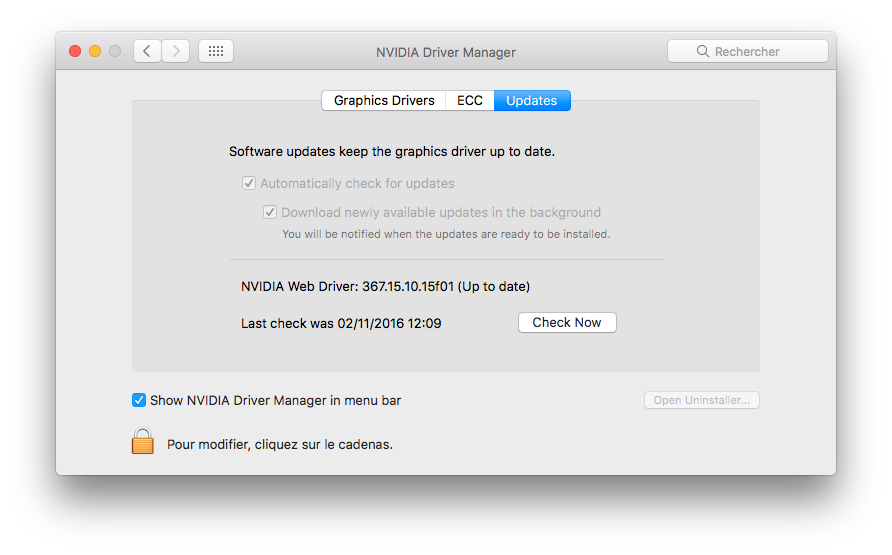

polyzargone Posted November 2, 2016 Share Posted November 2, 2016 It still works at 10.12.2 beta (16C32e): Post 13# at http://www.insanelymac.com/forum/topic/317502-pre-release-macos-sierra-10122/?p=2312391 It works as long as you don't select NVIDIA Web Driver in NVIDIA Driver Manager . Post #17 at http://www.insanelymac.com/forum/topic/317502-pre-release-macos-sierra-10122/?p=2312499 In fact, there's no webdrivers loaded : MacPro:~ polyargone$ kextstat | grep -v com.apple Index Refs Address Size Wired Name (Version) UUID <Linked Against> 24 0 0xffffff7f82b60000 0xb6000 0xb6000 as.vit9696.AppleALC (1.0.15) 70599CD2-9ABD-3DF7-8AF2-09081F153CCD <7 5 4 3 2 1> 25 4 0xffffff7f82c26000 0x19000 0x19000 org.netkas.driver.FakeSMC (1412) 18CC1329-F493-3EC9-BFB1-0F8503241BF8 <11 7 5 4 3 1> 26 0 0xffffff7f82c3f000 0x2e000 0x2e000 as.vit9696.Shiki (1.7.0) 3F68D86E-FC61-3106-AC34-18782D8CB69F <7 5 4 3 2 1> 27 0 0xffffff7f82c72000 0x5000 0x5000 org.hwsensors.driver.CPUSensors (1412) 89AB8FDB-1A2C-30A8-B6CE-CB85C92F4B7D <25 7 5 4 3> 39 0 0xffffff7f82c7a000 0x8000 0x8000 org.hwsensors.driver.ACPISensors (1412) B7BC7084-E304-345A-8CEE-75A0375AE4DA <25 11 7 5 4 3> 41 0 0xffffff7f82c88000 0x5000 0x5000 org.rehabman.driver.FakePCIID (1.2.0) DEB64F79-A945-3AC3-84E2-8A8A5D4FCF20 <12 7 5 4 3 1> 45 0 0xffffff7f82c91000 0x13000 0x13000 org.hwsensors.driver.LPCSensors (1412) 4A526B40-A4F0-369C-A67C-2DD8FEE6640D <25 12 11 7 5 4 3> 51 0 0xffffff7f82ca4000 0x3a000 0x3a000 com.insanelymac.RealtekRTL8111 (2.0.0) 54A33BAE-C115-361F-A956-7FFE91E04329 <50 12 5 4 3 1> 52 0 0xffffff7f82ce0000 0x15000 0x15000 org.hwsensors.driver.GPUSensors (1412) CCDB858D-2F44-3FC8-B384-F9DE63828BA4 <25 12 11 7 5 4 3> 74 0 0xffffff7f80d03000 0xd000 0xd000 com.mice.driver.WirelessGamingReceiver (1.0.0d15) 48550783-C20F-3E39-A59F-0A877E02D2C1 <63 36 5 4 3> 109 0 0xffffff7f820fc000 0x4000 0x4000 com.intel.driver.EnergyDriver (2.0) 358E6AD3-C66B-3E84-8D77-63DEB942A25B <7 5 4 3> 123 0 0xffffff7f80d10000 0x6000 0x6000 com.valvesoftware.SteamInput (3083.39.62) DED4413E-CD8E-3E56-B0AB-7B3B20ECE4BF <36 5 4 3> 124 0 0xffffff7f81145000 0x7000 0x7000 com.AmbrosiaSW.AudioSupport (4.1.4) no UUID <82 5 4 3 1> 130 0 0xffffff7f82cf5000 0x29000 0x29000 org.pqrs.driver.Karabiner (10.22.0) 75A195F3-FC81-39D0-9040-64D3880249EE <36 5 4 3 1> 138 0 0xffffff7f82110000 0x2000 0x2000 com.nvidia.CUDA (1.1.0) DD792765-CA28-395A-8593-D6837F05C4FF <4 1> 139 3 0xffffff7f82d1e000 0x63000 0x63000 org.virtualbox.kext.VBoxDrv (5.0.26) C47FFBAD-20EC-3203-AF08-9E6FA4C5C0BE <7 5 4 3 1> 140 0 0xffffff7f82d81000 0x17000 0x17000 com.tuxera.filesystems.tufsfs.fusefs_txantfs (2015.11.5) D961CF7D-F98C-EE44-3AA8-175397F81CB3 <7 5 4 3 1> 142 0 0xffffff7f82c16000 0x8000 0x8000 org.virtualbox.kext.VBoxUSB (5.0.26) BA00D956-8C19-360E-9F31-5957AE3E2D88 <141 139 63 7 5 4 3 1> 143 0 0xffffff7f82c1e000 0x5000 0x5000 org.virtualbox.kext.VBoxNetFlt (5.0.26) B09BEE18-08A1-3B8E-AA70-591C702AC702 <139 7 5 4 3 1> 145 0 0xffffff7f82d98000 0x6000 0x6000 org.virtualbox.kext.VBoxNetAdp (5.0.26) 9D101030-90D0-3447-8340-CCDD6B58165A <139 5 4 1> Link to comment https://www.insanelymac.com/forum/topic/312525-nvidia-web-driver-updates-for-macos-sierra-update-sept-27-2019/page/20/#findComment-2312550 Share on other sites More sharing options...

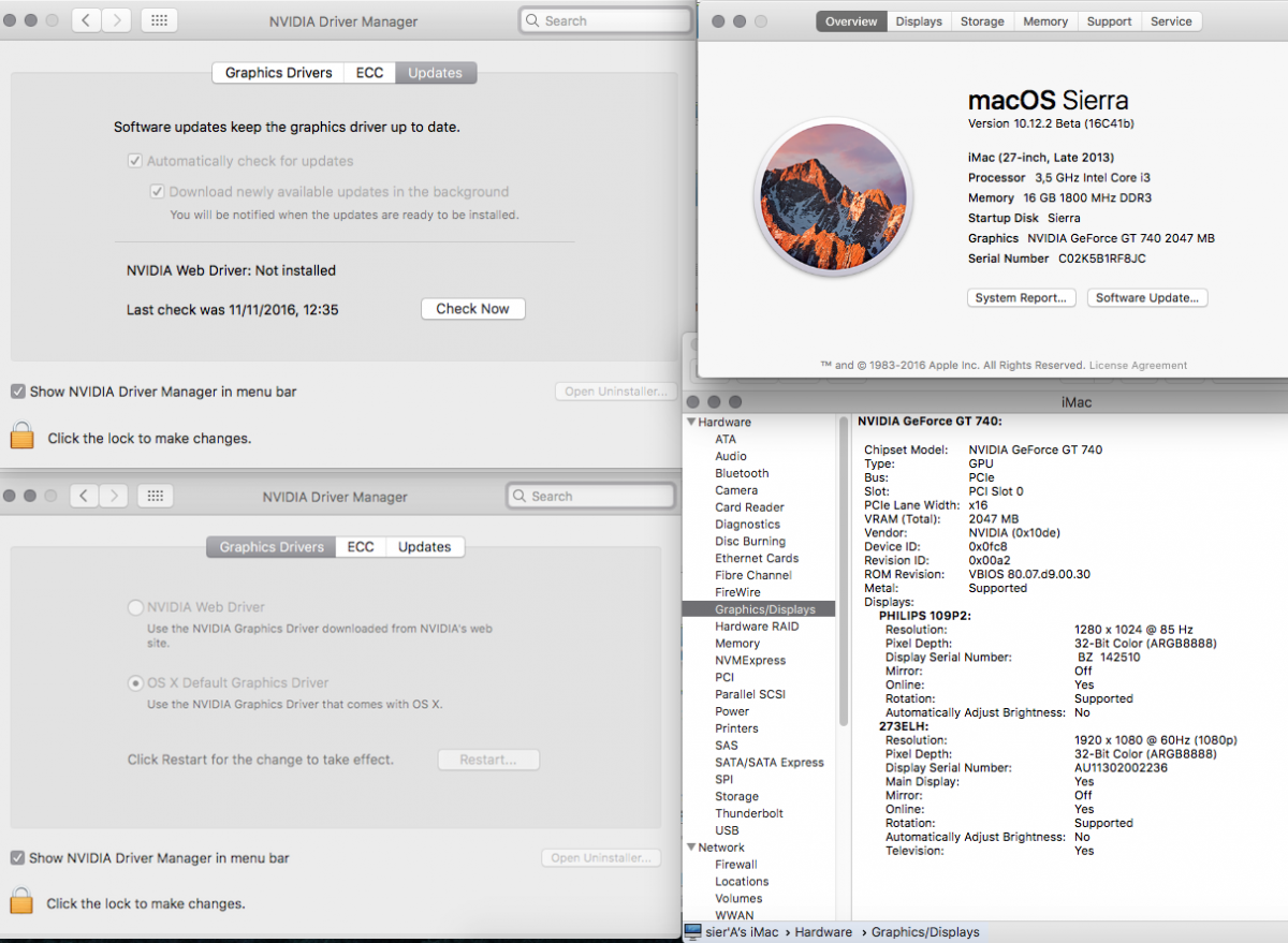

SavageAUS Posted November 4, 2016 Share Posted November 4, 2016 Does the new driver above resolve nvidia B&W? Sent from my SM-G930F using Tapatalk Link to comment https://www.insanelymac.com/forum/topic/312525-nvidia-web-driver-updates-for-macos-sierra-update-sept-27-2019/page/20/#findComment-2313583 Share on other sites More sharing options...
SammlerG Posted November 4, 2016 Share Posted November 4, 2016 no, no fix for 10.12.2 beta. Still b&w with unusable system 1 Link to comment https://www.insanelymac.com/forum/topic/312525-nvidia-web-driver-updates-for-macos-sierra-update-sept-27-2019/page/20/#findComment-2313643 Share on other sites More sharing options...

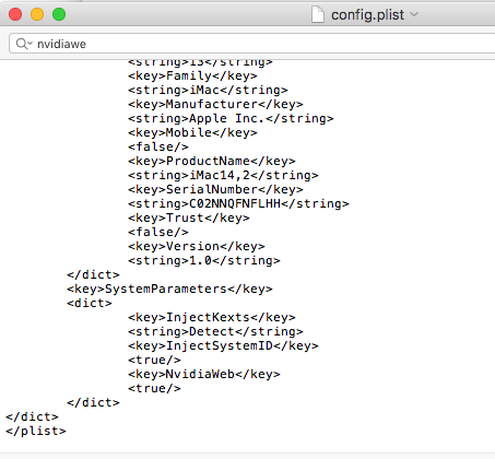

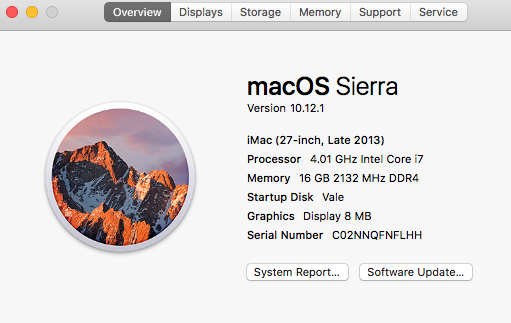

jsl Posted November 8, 2016 Share Posted November 8, 2016 I got black screen too. After install latest CUDA driver & change (Clover) ProductName to iMac14,2, the screen is back. Hope it helps. I think it's the same bug as I posted before: Post#3875 http://www.insanelymac.com/forum/topic/231075-chameleon-23svn-official-pkg-installer-binaries/page-194 There is some bug of X99 chip of which NVRAM can not load Nvidia Web Driver at 10.12GM/10.12.1/10.12.2beta Link to comment https://www.insanelymac.com/forum/topic/312525-nvidia-web-driver-updates-for-macos-sierra-update-sept-27-2019/page/20/#findComment-2315562 Share on other sites More sharing options...

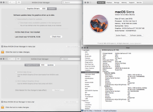

LAbyOne Posted November 11, 2016 Share Posted November 11, 2016 Finally this was latest solution for me at least Link to comment https://www.insanelymac.com/forum/topic/312525-nvidia-web-driver-updates-for-macos-sierra-update-sept-27-2019/page/20/#findComment-2317551 Share on other sites More sharing options...

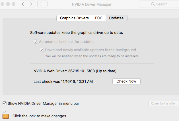

mitch_de Posted November 12, 2016 Share Posted November 12, 2016 Hi everyone, Like many other users I face the problem that I can't set nva_drv = 1 and in Nvidia panel I alway see "OSX driver". First of all two words about my configuration: mother board MSI z170A gaming m7 msi gtx 970 Mac os sierra final 10.12.1 Nvidia Web Driver - 367.15.10.15f03 After reading tons of threads with no luck, I found your post and I would like to try the solution indicated in your link, but I have some questions (sorry but I'm quiet newbie in this world): - Got it fixed using the nvram ... dlib (in /Extra/modules) Where can I find the NVRram... dlib? and is /Extra/modules in Sierra? because I didn't find such directory in filesystem. - NvramFile.kext (in /L/E) Same question for NVramFile.kext. Where can I find this file? and where is /L/E? no problem for the terminal command:). Thank you You will get the 2 needed files DL link from the Link , which was some post before linked. (named FileNVRAM_El_Capitan for chameleon.zip ) Copy the FileNVRAM.dylib in /Extra/modules , which is the folder for Chameleon/Enoch .Folder /Extra exist if you use Chameleon. If the subfolder modules not exist, you must create it before you can copy the .dylib into it. Install NvramFile.kext (in /Library/Extensions). Be sure to set right owner in terminal (sudo chown -R root:wheel ....) or better use an kext install util for that - and /L/E not! /S/L/E. The .kext must exist in all OS X Partions you use. If you have more than one OS X Version on HD , or within HDs partition or on more than one HD you have to install the .kext also in all other partitions. It is not enough for example if you have two Partitions, one (main) running El Captain and second Partition Sierra. Your sierra Partition /L/E needs the kext (also). I am unsure about the chameleon installs on different HDs partitions. If you have only one /Extra on the main Partition with all subfolders, .plist etc. it should be enough, but all OS versions you try to boot will use the same chameleon config. plist and /Extra content. After copy and install the two files be sure that the Kextcache/prelinked kernel got updated (because of the new .kext). Then, you must reboot. Nothing special happens then, util you use the terminal. sudo nvram nvda_drv=1 After that command , if all worked, the .kext created an nvram.....plist. That .plist will be read and used next reboot and forever, until you change nvram by sudo nvram .... again. So that are the steps: copy install 2 files . REBOOT. sudo ... REBOOT. 2 Link to comment https://www.insanelymac.com/forum/topic/312525-nvidia-web-driver-updates-for-macos-sierra-update-sept-27-2019/page/20/#findComment-2317671 Share on other sites More sharing options...
