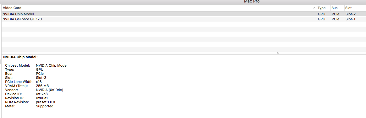

hexxus Posted December 30, 2016 Share Posted December 30, 2016 Hi, Where is your System report ? Did you use these webdrivers ? macOS 10.12.2 (16C67) 367.15.10.25f01 or (16C68) 367.15.10.25f02 Which graphic card did you use for the 10.12.2 install ? (before changing to GTX 980Ti) May be a NVRAM reset could help .... ( Cmd (⌘) + Opt + P + R) on boot Good luck Hey there, the system report was uploaded however I don't see it in my post. I've got a GT 120 and an ATI 4870, 4870 was not in the machine during the tests. I used these web drivers "(16C68) 367.15.10.25f02" Strange thing is the PCI part of the report... it's as if it doesn't have the kext for my EVGA GTX 980TI SC Thanks for the help!! @hexxus I'm in the same boat as you, but with some mer experience. I think most of this community is hackintoshes. You'll need to have an older official GPU as installed, I have the stock gt120 at the ready for when things go sideways. The card you have installed has no EFI drivers so it won't show boot screen or anything. I'm actually sending my card (gtx970) to macvidcards.com for a custom flash here in January when I'm on vacation. This will make it just work on the mac pro like any other stock mac card. So, to get it working on your system get the older GPU in there as well as the new one, connect a display to the old GPU, install the nvidia web driver, reboot and the new card should now work, but only after initial boot, you'll never be able to get boot screen support unless you too get it custom flashed. This guy at macvidcards has pretty much reverse engineered some firmware and whatnot to made this work, he's not sharing it, there appears to be no other way to do it on an nVidia card. Thanks Neoneddy! I tried that exactly, and unfortunately with both of my EVGA GTX 980TI SC's I get the same result. Black screen forever. (I have an SSD as OS X boot up is usually in the 15 second range.) I left it for 5 minutes with a single monitor to no effect. Take a look at my System Report... kind of strange there. If you don't mind me asking, how much was the cost to send your card to macvidcards.com and have them flash yours for you? I may need to do that. Link to comment https://www.insanelymac.com/forum/topic/312525-nvidia-web-driver-updates-for-macos-sierra-update-sept-27-2019/page/25/#findComment-2341328 Share on other sites More sharing options...
Lord Kamina Posted December 30, 2016 Share Posted December 30, 2016 Do not inject Nvidia. I wasn't. I already managed to get it fixed, with the DisableASPM thing, which is why I recommended it above to people who are experiencing the prolonged black screen issue. (I assume my case was an extreme version of that!) Link to comment https://www.insanelymac.com/forum/topic/312525-nvidia-web-driver-updates-for-macos-sierra-update-sept-27-2019/page/25/#findComment-2341332 Share on other sites More sharing options...
