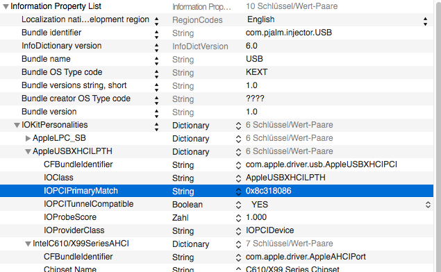

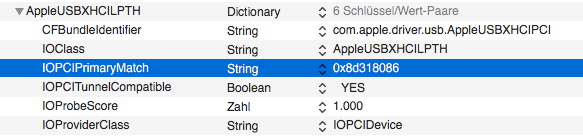

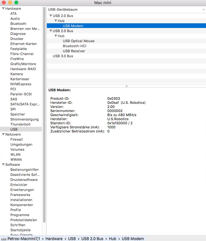

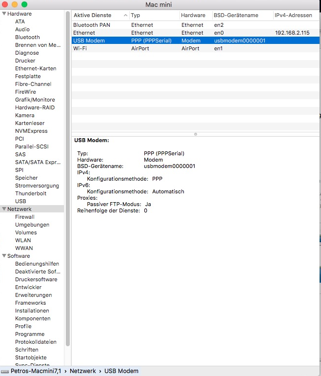

pinarek Posted April 30, 2016 Share Posted April 30, 2016 Hy Friends I want one more time the old post from my brush with news: The modem now also runs under El Capitan 10.11.4 with my new motherboard MSI Z97 G43. The only thing I have done is added in the network left modem and then not made standard but new configuration. And the US Robotics modem runs in this setting as "General" did not change anything there. attention I became when I times the Library rummaged through, I wanted to see where MS Outlook 2015 its files (stores the email accounts) but found nothing. But But seen the Modem Scripts and the US Robotics 5637 was there. So I thought then the modem must also work ... and it does. Perhaps another user has also had as a modem and problem with it .. In my MSI Z77 G43 it went oddly not work, at El Capitan 10.11.2 it was then. http://www.insanelymac.com/forum/topic/306777-guide-usb-fix-el-capitan-1011/?view=findpost&p=2168231 Link to comment Share on other sites More sharing options...

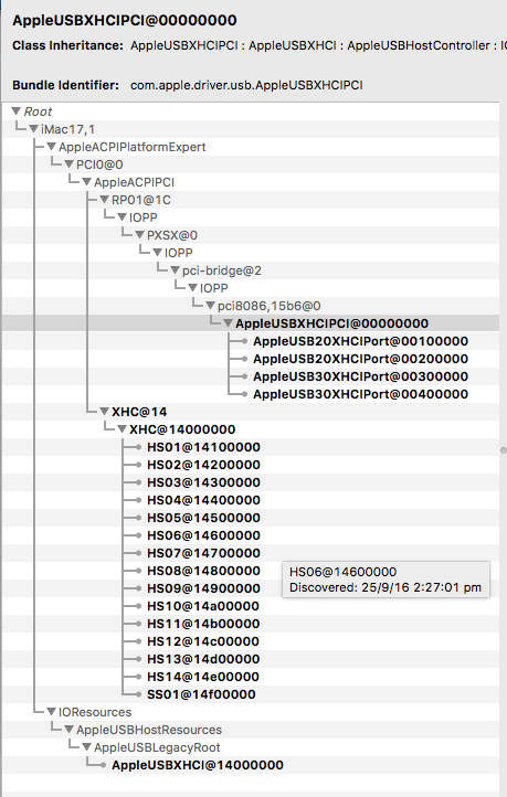

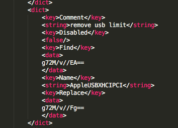

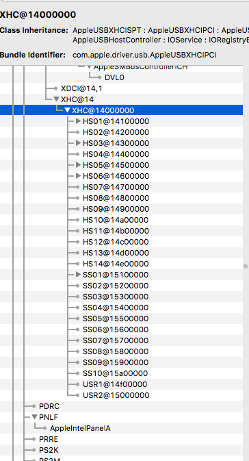

Andres ZeroCross Posted June 20, 2016 Share Posted June 20, 2016 To unlock 31 Ports at Intel 100 Series Chipset at macOS Sierra use this patchFind : 00837D94100F835AReplace : 00837D941F0F835AName : AppleUSBXHCIPCILook at my IOREG Link to comment Share on other sites More sharing options...

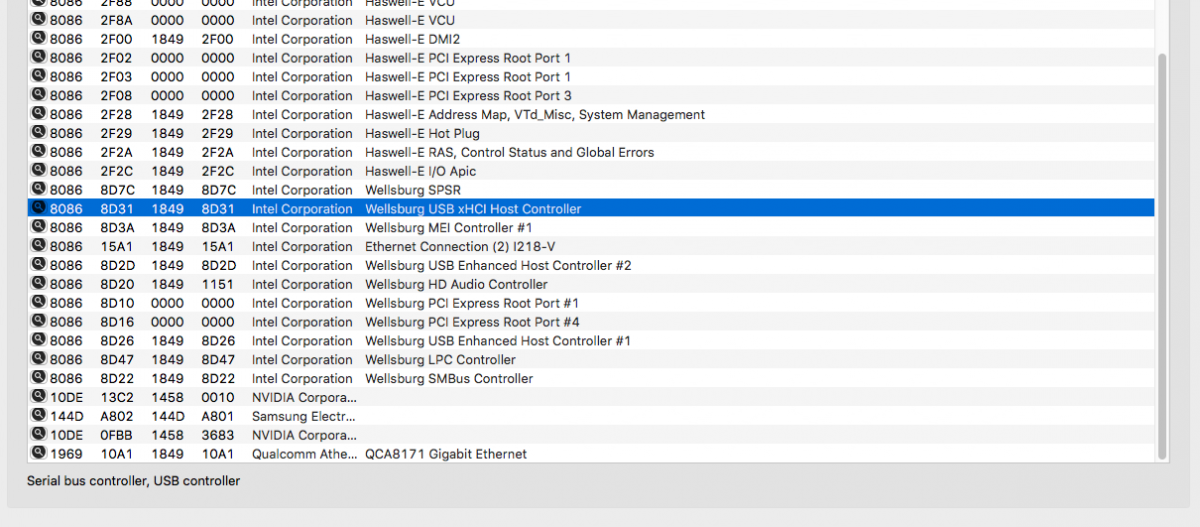

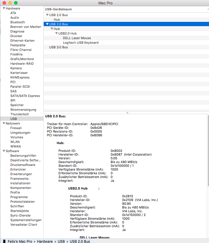

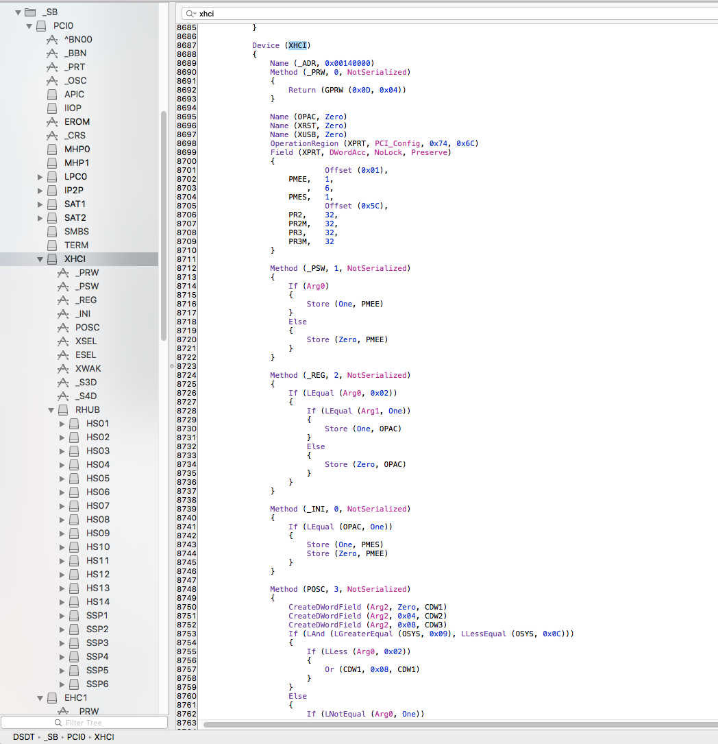

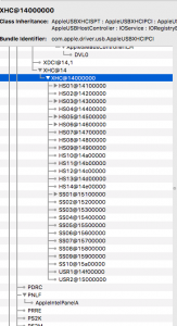

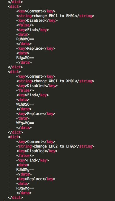

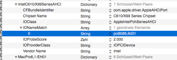

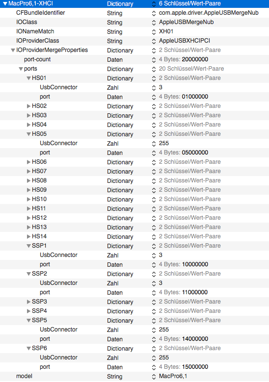

Multisaft Posted June 29, 2016 Share Posted June 29, 2016 Guys, I need your help. What am I doing wrong with my USB injection? Ive tried to capture every detail, therefore quite some long post around! Sorry!!! Im using an Asrock X99M Extreme4 which is quit rare to what I know at the moment (no other hackintosh around in our community or others so fare?!) 1) DSDT original finds USB2/3 directly under XHCI/RHUB/ - see attached DSDT.aml in zip-File and Screenshot, 14 USB2.0 (4 IO-shield, 10 internal), 6 USB3.0 (4 IO-shield, 2 internal): conclusion 1) all Ports under XHCI to my knowledge, no Ports under EHC1 or EHC2. Under EHC1 and EHC2 I find /HUBN/PRO1/PR11-PR18 and PR11-16. question 1) What is a PR Device? 2) DPCI Manager tells my my Wellsburg USB xHCI Host controller Device-ID which is: 8086, 8D31: USB2 Host Controller #1 and #2: 8086, 8D26 and 8D2D 3) Clover Config DSDT/kext patches My clover.config where I used the following DSDT and kext patches is attached in the zip-file. clover config DSDT Patch (screenshot and code) <dict> <key>Comment</key> <string>change EHC1 to EH01</string> <key>Disabled</key> <false/> <key>Find</key> <data> RUhDMQ== </data> <key>Replace</key> <data> RUgwMQ== </data> </dict> <dict> <key>Comment</key> <string>change XHCI to XH01</string> <key>Disabled</key> <false/> <key>Find</key> <data> WEhDSQ== </data> <key>Replace</key> <data> WEgwMQ== </data> </dict> <dict> <key>Comment</key> <string>change EHC2 to EH02</string> <key>Disabled</key> <false/> <key>Find</key> <data> RUhDMg== </data> <key>Replace</key> <data> RUgwMg== </data> </dict> clover config usblimit kext patch (screenshot and code) <dict> <key>Comment</key> <string>remove usb limit</string> <key>Disabled</key> <false/> <key>Find</key> <data> g72M/v//EA== </data> <key>Name</key> <string>AppleUSBXHCIPCI</string> <key>Replace</key> <data> g72M/v//Fg== </data> </dict> 4) X99 Injector kext here is my injector kext: X99_Injector.kext.zip I've used the pjalm injector as the basis and added my ports and my device id for my xhci usb controller, some screenshots: Can someone plz look into the x99_injector and tell me if this is correct what I have done? I have guessed which ports are internal (3) and external (255) as I dont have yosemite or windows installed to map the ports (I would guess that this is not the problem in the first step). Question: what does the AppleUSBXHCILPTH do? this is attached original to the devide-id: 8c31 which is no usb controller on my board. I changed it to 8d31 new: 5) verification: after clover config patches and x99 injection, my IORegistry Explorer finds the patches for xhci to xh01 and ehc1 to eh01 and ehc2 to eh02 (ioreg in attachment): the ports by itself are correct I guess, but why or what is the location ID (I never defined these entries)?! And still my usb ports are not shown in the system information: can someone plz help me and tell me what I'm doing wrong???? thank you very much for reading till the end, I know this is a long post. all the files needed: asrock_x99m_ext4_usb.zip Link to comment Share on other sites More sharing options...

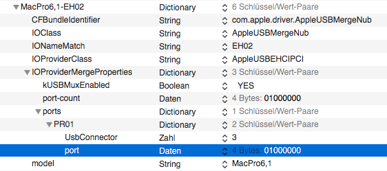

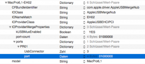

blakken Posted July 11, 2016 Share Posted July 11, 2016 Hi, can anybody help me please , I'm right now struggling for one entire week with my el capitan fix with my airport card that's is not working anymore(detected but not showing any available network) Originaly (Yosemite) BRCM20702 was working perfectly and was showed on usb 3 concentrator , after 10.11 installation it is located on usb 2 port EH02. Is there any way to move it to XHC port ? Thanks. My smbios definition is iMac 14.1 Link to comment Share on other sites More sharing options...

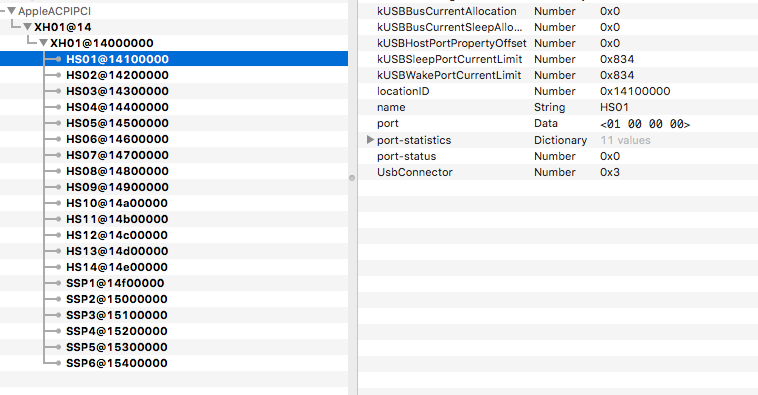

sstyle Posted July 29, 2016 Share Posted July 29, 2016 Guys, please help. Only 2 usb ports works. Tried to follow manual from first post, but I can not find such strings in plist Link to comment Share on other sites More sharing options...
SavageAUS Posted September 25, 2016 Share Posted September 25, 2016 To unlock 31 Ports at Intel 100 Series Chipset at macOS Sierra use this patch Find : 00837D94100F835A Replace : 00837D941F0F835A Name : AppleUSBXHCIPCI Look at my IOREG Are you also using kext usbinjectall? Sent from my SM-G900I using Tapatalk Link to comment Share on other sites More sharing options...

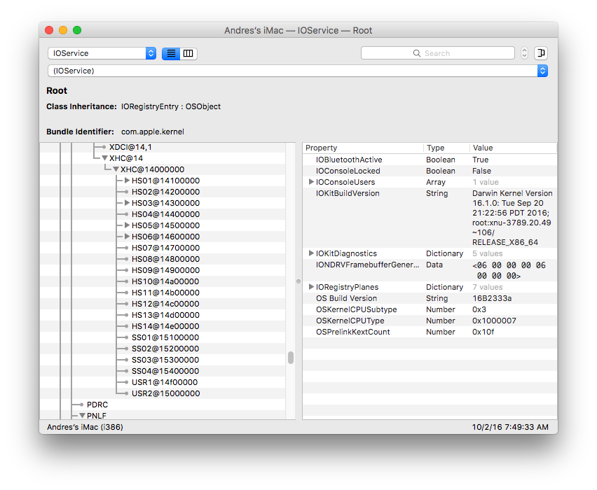

Andres ZeroCross Posted October 2, 2016 Share Posted October 2, 2016 New Patch to Unlock Max 31Port XHC Device Port at Sierra 10.12.1 Beta Build 16B2333aFind : 83BD74FFFFFF1048Replace : 83BD74FFFFFF1548Comment : Unlock Limit Port XHC Port Name : AppleUSBXHCIPCI 2 Link to comment Share on other sites More sharing options...

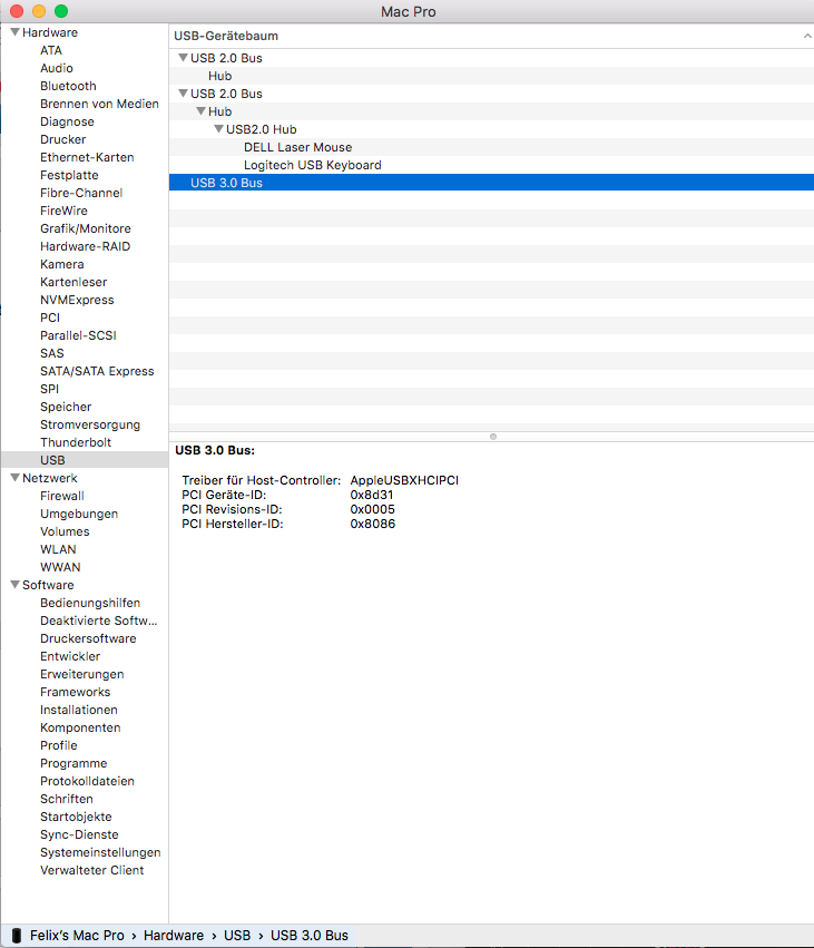

thez3 Posted October 19, 2016 Share Posted October 19, 2016 @pokenguyen I had in the last year able to install the Mountain Lion and Yosemite successfully in my desktop (Lenovo D30 - workstation with dual Xeon). X79 series 7. In El Captain, the USB works only with GenericUSBXHCI.kext, but only some ports works (and keyboard/mouse devices). I have an working and compiled SSDT (ACPI 4.0) that doesn't needs NullPowerManagement.kext these days. I can boot El Captain with the GenericUSBXHCI as well to make anything, but I need the bluetooth driver working. I don't care about USB 3.0, but neither USB 2.0 ports is working. I tried to follow your guide, but in my DSDT (getting via F4 in Clover boot menu) I don't see any XHC* or EHC* references! I tried FakePCIID and FakePCI*Mux and also X79USBHub and X79USBEHCIPCI kexts as well, but without GenericUSBXHCI, the clover boot always fail in IOUSBHostFamily error. Can you help me? What do you need? Thanks in advance Link to comment Share on other sites More sharing options...
RehabMan Posted October 19, 2016 Share Posted October 19, 2016 @pokenguyen I had in the last year able to install the Mountain Lion and Yosemite successfully in my desktop (Lenovo D30 - workstation with dual Xeon). X79 series 7. In El Captain, the USB works only with GenericUSBXHCI.kext, but only some ports works (and keyboard/mouse devices). I have an working and compiled SSDT (ACPI 4.0) that doesn't needs NullPowerManagement.kext these days. I can boot El Captain with the GenericUSBXHCI as well to make anything, but I need the bluetooth driver working. I don't care about USB 3.0, but neither USB 2.0 ports is working. I tried to follow your guide, but in my DSDT (getting via F4 in Clover boot menu) I don't see any XHC* or EHC* references! I tried FakePCIID and FakePCI*Mux and also X79USBHub and X79USBEHCIPCI kexts as well, but without GenericUSBXHCI, the clover boot always fail in IOUSBHostFamily error. Can you help me? What do you need? Thanks in advance FakePCIID_XHCIMux.kext is specific to Intel USB3/XHCI. Therefore nonsense with X79. X79 does not include an Intel XHCI controller. Link to comment Share on other sites More sharing options...
thez3 Posted October 19, 2016 Share Posted October 19, 2016 FakePCIID_XHCIMux.kext is specific to Intel USB3/XHCI. Therefore nonsense with X79. X79 does not include an Intel XHCI controller. But I have 4 USB 3.0 ports. This is the specs: http://thinkstation-specs.com/thinkstation-d30/ Far I know, I had read that is a X79 7-series Ivy Brigde The El Captain work flawless, but the USB not. Event the Audio I could install (using VoodooHDA) Thanks Link to comment Share on other sites More sharing options...
