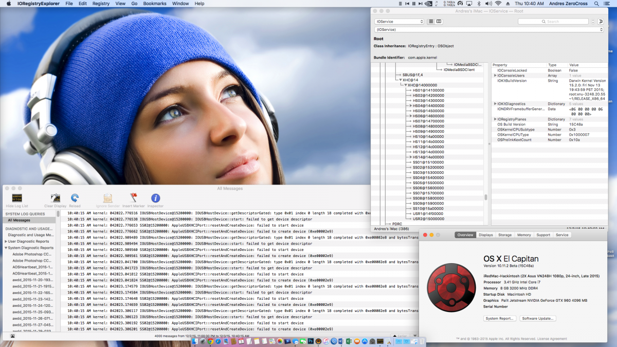

jan-munich Posted November 20, 2015 Share Posted November 20, 2015 anyone tried 10.11.2 beta 4 yet? seems os x can't initialize my SS0X ports for any reason after the update? Nov 20 18:48:51 jans-iMac kernel[0]: 000013.136870 SS01@14900000: AppleUSBXHCIPort::resetAndCreateDevice: failed to start device Nov 20 18:48:51 jans-iMac kernel[0]: 000013.136882 SS01@14900000: AppleUSBXHCIPort::resetAndCreateDevice: failed to create device (0xe00002e9) Nov 20 18:48:51 jans-iMac kernel[0]: 000013.254429 IOUSBHostDevice@14900000: IOUSBHostDevice::getDescriptorGated: type 0x01 index 0 length 18 completed with 0xe00002e8 and bytesTransferred 0 Nov 20 18:48:51 jans-iMac kernel[0]: 000013.254433 IOUSBHostDevice@14900000: IOUSBHostDevice::start: failed to get device descriptor Nov 20 18:48:51 jans-iMac kernel[0]: 000013.254474 AppleUSBHostResources@: AppleUSBHostResources::allocateDownstreamBusCurrentGated: assuming successful wakeUnits 150 sleepUnits 0 Nov 20 18:48:51 jans-iMac kernel[0]: 000013.254497 SS01@14900000: AppleUSBXHCIPort::resetAndCreateDevice: failed to start device Nov 20 18:48:51 jans-iMac kernel[0]: 000013.254506 SS01@14900000: AppleUSBXHCIPort::resetAndCreateDevice: failed to create device (0xe00002e9) Nov 20 18:48:51 jans-iMac kernel[0]: 000013.371904 IOUSBHostDevice@14900000: IOUSBHostDevice::getDescriptorGated: type 0x01 index 0 length 18 completed with 0xe00002e8 and bytesTransferred 0 Nov 20 18:48:51 jans-iMac kernel[0]: 000013.371932 IOUSBHostDevice@14900000: IOUSBHostDevice::start: failed to get device descriptor Link to comment Share on other sites More sharing options...
Andres ZeroCross Posted November 20, 2015 Share Posted November 20, 2015 anyone tried 10.11.2 beta 4 yet? seems os x can't initialize my SS0X ports for any reason after the update? Nov 20 18:48:51 jans-iMac kernel[0]: 000013.136870 SS01@14900000: AppleUSBXHCIPort::resetAndCreateDevice: failed to start device Nov 20 18:48:51 jans-iMac kernel[0]: 000013.136882 SS01@14900000: AppleUSBXHCIPort::resetAndCreateDevice: failed to create device (0xe00002e9) Nov 20 18:48:51 jans-iMac kernel[0]: 000013.254429 IOUSBHostDevice@14900000: IOUSBHostDevice::getDescriptorGated: type 0x01 index 0 length 18 completed with 0xe00002e8 and bytesTransferred 0 Nov 20 18:48:51 jans-iMac kernel[0]: 000013.254433 IOUSBHostDevice@14900000: IOUSBHostDevice::start: failed to get device descriptor Nov 20 18:48:51 jans-iMac kernel[0]: 000013.254474 AppleUSBHostResources@: AppleUSBHostResources::allocateDownstreamBusCurrentGated: assuming successful wakeUnits 150 sleepUnits 0 Nov 20 18:48:51 jans-iMac kernel[0]: 000013.254497 SS01@14900000: AppleUSBXHCIPort::resetAndCreateDevice: failed to start device Nov 20 18:48:51 jans-iMac kernel[0]: 000013.254506 SS01@14900000: AppleUSBXHCIPort::resetAndCreateDevice: failed to create device (0xe00002e9) Nov 20 18:48:51 jans-iMac kernel[0]: 000013.371904 IOUSBHostDevice@14900000: IOUSBHostDevice::getDescriptorGated: type 0x01 index 0 length 18 completed with 0xe00002e8 and bytesTransferred 0 Nov 20 18:48:51 jans-iMac kernel[0]: 000013.371932 IOUSBHostDevice@14900000: IOUSBHostDevice::start: failed to get device descriptor I think, your issue was there from 10.11.1 Public Release version. I have same issue with 10.11.1 - 10.11.2 Beta Build 15C47a. I have skylake too. Link to comment Share on other sites More sharing options...

jan-munich Posted November 20, 2015 Share Posted November 20, 2015 thanks anyway Rehabman, it seem to be not about the usb injection and or usb port mappings they work, the moment i plug in a device to the port ill see the following output via console: it looks like he cant get the proper device descriptor to load the appropriate driver for the device. I dont know what apple did change but i did a reset of all IOUSB*.kext files back to 10.11.1 without success to get them back running. Seems so they changed something somewhere else in the usb driver stack / kernel extensions causing the issues mentioned. Nov 20 23:45:25 jans-iMac kernel[0]: 000454.952457 IOUSBHostDevice@14b00000: IOUSBHostDevice::start: failed to get device descriptor Nov 20 23:45:25 jans-iMac kernel[0]: 000454.952507 AppleUSBHostResources@: AppleUSBHostResources::allocateDownstreamBusCurrentGated: assuming successful wakeUnits 150 sleepUnits 0 Nov 20 23:45:25 jans-iMac kernel[0]: 000454.952539 SS02@14b00000: AppleUSBXHCIPort::resetAndCreateDevice: failed to start device Nov 20 23:45:25 jans-iMac kernel[0]: 000454.952549 SS02@14b00000: AppleUSBXHCIPort::resetAndCreateDevice: failed to create device (0xe00002e9) Nov 20 23:45:25 jans-iMac kernel[0]: 000454.952551 SS02@14b00000: AppleUSB30XHCIPort::resetAndCreateDevice: failed to create device after (30) tries, disabling port 1 Link to comment Share on other sites More sharing options...

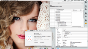

Andres ZeroCross Posted December 3, 2015 Share Posted December 3, 2015 Super Speed USB 3.0 is still not function normally at El Capitan Build 15C48a, SkyLake's Build System here 1 Link to comment Share on other sites More sharing options...
