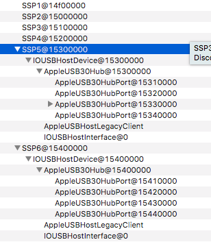

llamafilm Posted December 28, 2016 Share Posted December 28, 2016 I have read about the XHC1 device in this thread and many others. But on my machine, the device is called XHCI (letter I instead of number 1). Does that mean there is no port restriction already? In my DSDT, I have HS01 thru HS14, and SSP1 thru SSP6. SSP1 is one port (green in this diagram). SSP5 (pink) and SSP6 (cyan) are Renesas hubs on the motherboard with 4 ports each. SSP 2,3, and 4 are not used. I have renamed EHC1 and EHC2 using this SSDT code. And I have an X99 injector kext from pjalm, which adds the 20 ports listed in DSDT. The problem is, the four ports on SSP6 only function at USB2 speeds, even though they do appear in ioreg under XHCI. Any help would be much appreciated. External (_SB_.PCI0.EHC2, DeviceObj) External (_SB_.PCI0.EHC1, DeviceObj) Scope (_SB.PCI0.EHC1) { Name (_STA, Zero) } Scope (_SB.PCI0.EHC2) { Name (_STA, Zero) } Device (_SB.PCI0.EH01) { Name (_ADR, 0x001D0000) Name (_S4D, 0x02) Name (_S3D, 0x02) Name (_S2D, 0x02) Name (_S1D, 0x02) Name (MBSD, One) } Device (_SB.PCI0.EH02) { Name (_ADR, 0x001A0000) Name (_S4D, 0x02) Name (_S3D, 0x02) Name (_S2D, 0x02) Name (_S1D, 0x02) Name (MBSD, One) } X99_Injector USB 3.kext.zip Sierra-Hack ioreg.zip Link to comment Share on other sites More sharing options...

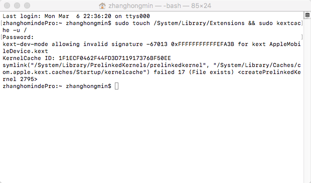

RehabMan Posted March 5, 2017 Share Posted March 5, 2017 Z270-AR USB3.0 installed the latest version of USBInjectall.kext does not work Attach ioreg from IORegistryExplorer v2.1. Attach output of (in Terminal): sudo touch /System/Library/Extensions && sudo kextcache -u / Link to comment Share on other sites More sharing options...
RehabMan Posted March 5, 2017 Share Posted March 5, 2017 @RehabMan USB3.0 interface can identify USB2.0 devices, USB3.0 devices can not be identified The ioreg is not from IORegistryExplorer v2.1. No kextcache output provided. Please read the request carefully. Link to comment Share on other sites More sharing options...
webhappyboy070 Posted March 6, 2017 Share Posted March 6, 2017 @RehabMan In accordance with the 2.1 method proposed Dreamboat的Mac Pro.zip Link to comment Share on other sites More sharing options...
RehabMan Posted March 6, 2017 Share Posted March 6, 2017 @RehabMan In accordance with the 2.1 method proposed According to ioreg, USBInjectAll.kext is loaded and is working perfectly. It is injecting all ports HS01-HS14, SS01-SS10, USR1,USR2. But the wrong class is loaded for XHC. You need XHCI-200-series-injector.kext, as per USBInjectAll README. Link to comment Share on other sites More sharing options...
webhappyboy070 Posted March 6, 2017 Share Posted March 6, 2017 XHCI-200-series-injector.kext can give a download address? Link to comment Share on other sites More sharing options...
RehabMan Posted March 6, 2017 Share Posted March 6, 2017 XHCI-200-series-injector.kext can give a download address? It is in the USBInjectAll github. Download the ZIP for the repo. Link to comment Share on other sites More sharing options...
webhappyboy070 Posted March 6, 2017 Share Posted March 6, 2017 It is in the USBInjectAll github. Download the ZIP for the repo. Thank you! Success Link to comment Share on other sites More sharing options...
