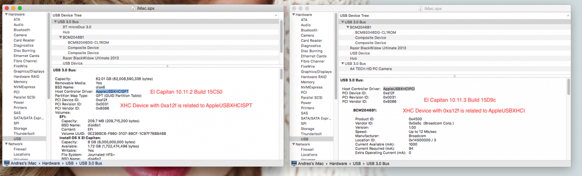

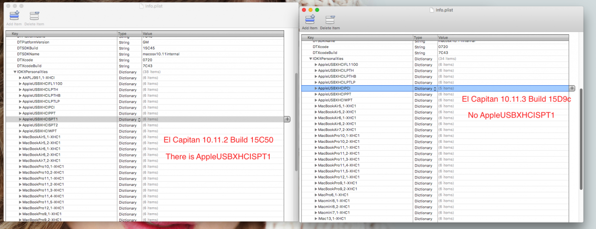

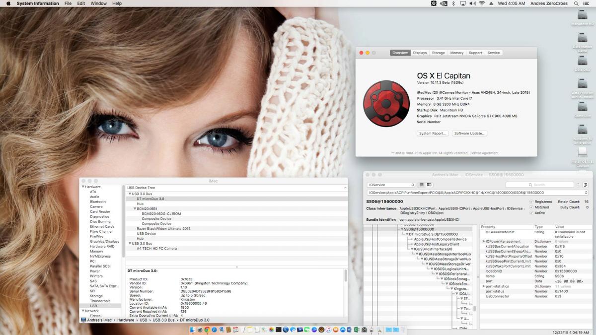

Andres ZeroCross Posted December 22, 2015 Share Posted December 22, 2015 Hi Guys, I have motherboard Z170X Gaming 7 I just re-update to El Capitan 10.11.3 Beta Build 15D9c, and i have no working Super Speed Port (SS01-SS10), but before update i just back up my "IOUSBHostFamily.kext". Then i compare both of this kext. And i found different info.plist structure of AppleUSBXHCIPCI.kext. Take a look at screenshot.I have 2 USB 3.0 Bus (Devices) with different different device id.1. 0xa12f8086 (all USB Port 3.0) 2. 0x15b68086 (for Keyboard and mouse at upper back panel) At El Capitan 10.11.2, 0xa12f8086 is related to Host Controller Driver "AppleUSBXHCISPT" and 0x15b68086 is related to Host Controller Driver "AppleUSBXHCIPCI" but if you update to beta 10.11.3 then both of them will be related to Host Controller Driver "AppleUSBXHCIPCI". I don't know, maybe because of this my SS01-SS10 had not work afterall. So i just need to install "IOUSBHostFamily.kext" from 10.11.2 Build 15C50 to El Capitan 15D9c and My SS01-SS10 are work again .I don't know,, why apple remove iMac17,1 Profile at "AppleUSBXHCIPCI.kexts's info.plist at 10.11.3 So for SkyLake user, if you want updating to El Capitan 10.11.3 then reinstall "IOUSBHostFamily.kext" again from El Capitan 10.11.2 Build 15C50. But you still need to follow instructions of this topic to activate your XHC Ports Sorry for my Bad English Link to comment Share on other sites More sharing options...

driftwood Posted December 27, 2015 Share Posted December 27, 2015 Did you try editing the AppleUSBXHCIPCI info.plist in IOKitPersonalities and adding 17,1 items? For those who don't know: These are missing from the latest 10.11.3 beta AppleUSBXHCIPCI kext;- AAPLJ951,1-XHCI (new mac pro 7,1?) Piker alpha mentioned about this in the past here: https://pikeralpha.wordpress.com/2015/11/01/first-signs-of-new-macpro71-found-in-el-capitan/ AppleUSBXHCISPT1, AppleUSBXHCISPT2 and of course, iMac17,1-XHCI are also omitted. I'm going to wait to see the ssdt that Piker Alpha puts up soon (see here: https://pikeralpha.wordpress.com/2015/12/22/my-initial-elcapitan-usb-workaround/) Link to comment Share on other sites More sharing options...

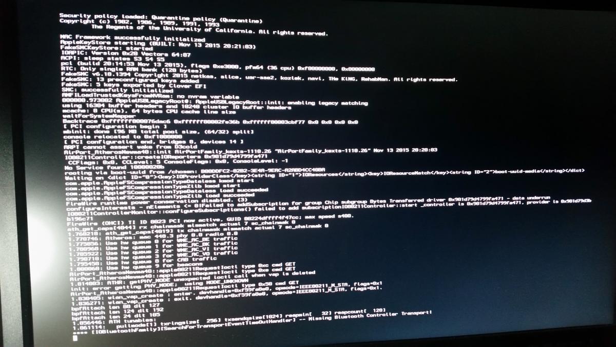

Max.1974 Posted December 31, 2015 Share Posted December 31, 2015 Please someone could help me, sorry my english is not so good. Im trying install El Capitan 10.11 and my usb ports need a correct configuration, because usb install stop on missing ...transporter. So sorry for im not could understand how to edit DSDT. My IOregistry and DSDT in zip atachment. Greate for help !!! My mobo is Intel BP67BG i7 Core, LGA 1155, Sandy Brigde. Im wait for your precious help!! Happy New Year!!! dsdt.aml.zip IORegistry-Max.zip Link to comment Share on other sites More sharing options...
tluck Posted December 31, 2015 Share Posted December 31, 2015 @max.1974 A quick fix is often to global search/replace the USB devices EHC1 to EH01 and EHC2 to EH02 - and then use rehabMan's USBInject_all.kext. Clover can also do this DSDT patch for you. Link to comment Share on other sites More sharing options...
