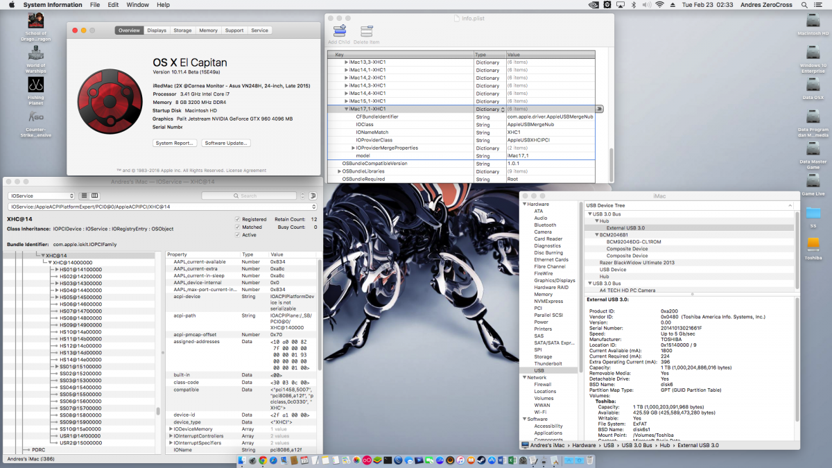

Andres ZeroCross Posted February 22, 2016 Share Posted February 22, 2016 Sukses update to El Capitan 10.11.4 Developer Beta Build 15E49aNow at this version, we can find profile iMac17,1 at AppleUSBXHCIPCI.kext's info.plist , no more roll back kext from 10.11.3 + USBInjection.kext to activate Super Speed USB 3.0 (5GB/s). Just make USBInjection.kext (customized according to your DSDT) then it will work 1 Link to comment https://www.insanelymac.com/forum/topic/306777-guide-usb-fix-el-capitan-1011/page/30/#findComment-2217446 Share on other sites More sharing options...
