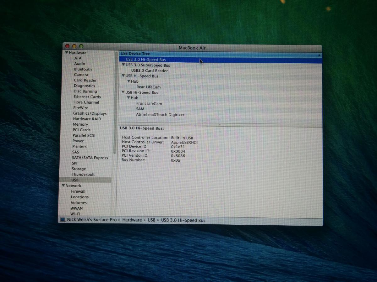

usb seems working good, don't know what could have caused your usb port not working...
did it work on a safe boot?

does the usb port work in safe mode?
After you boot the system try to install all the kexts via kextdrop, you can place it in your installation drive and copy it like you did with the kexts.
