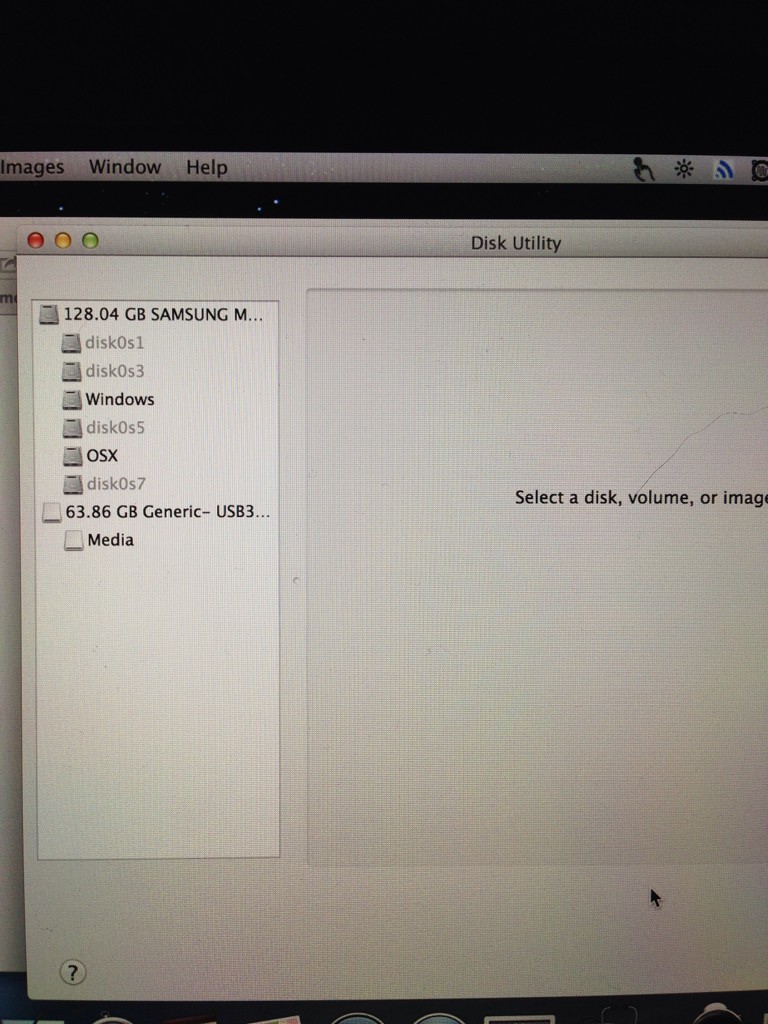

I've had the same issue on mine, and I also noticed that on bad boots the launchpad app arrangement gets reset to default and the color profile doesn't load by default. I get bad boots with and without voodoohda and have had it across 3 separate OS X installs, but I still can't seem to find anything that affects their frequency or behavior.
I'm currently dual booting with Windows 8.1 and I'm fairly certain it has something to do with my EFI partition. In disk utility it shows 4 partitions - disk0s1 (630mb, no info), disk0s3 (134 mb, Microsoft Reserved), Windows, and OS X. When mounting the efi partition with clover configurator, I get a message saying "Unexpected disk identifier: disk0s2", but it still mounts iff it was a "good" boot.
Any help is appreciated, thanks!
@ caleidosCope
I'll start testing tonight. I'm duel booting with win8.1. Disk utility shows 6 partitions in totalpost-354868-13956278995293_thumb.jpg
@ eoveem
I'll post any findings here. I get the same error/warning when I load the edit partition. My intuition is leading me to believe that the efi partition is root of the problem.
update:
i think i resolved my issue.  i deleted partitions 1 and 5 and reinstalled all kext in safe mode.  after rebooting and shutting down multiple times with and without usb devices plugged in, i'm able to get to the desktop within 10 seconds and sound works as it's supposed to.  i verified win8.1 boot as well.  both os' are booting successfully.  i should have deleted those partitions when i originally installed osx.  it might have also been a factor in why i couldn't install clover successfully with the installer app.  i hope this is helpful to others

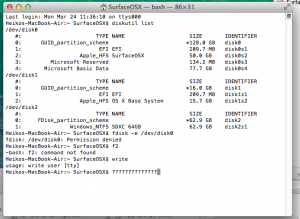

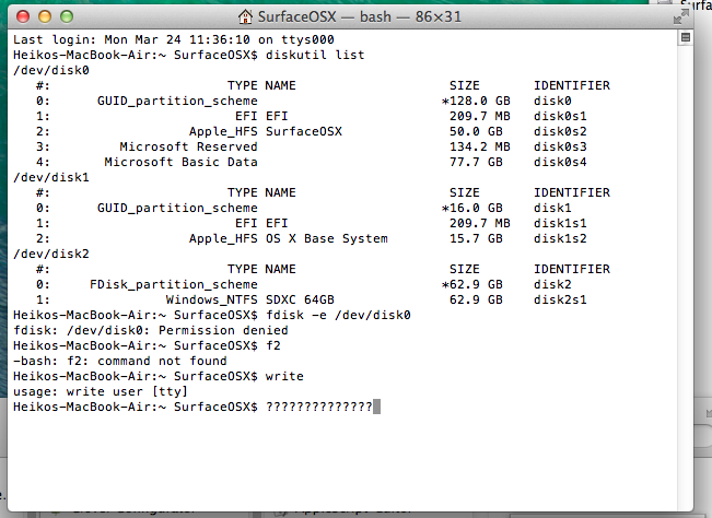

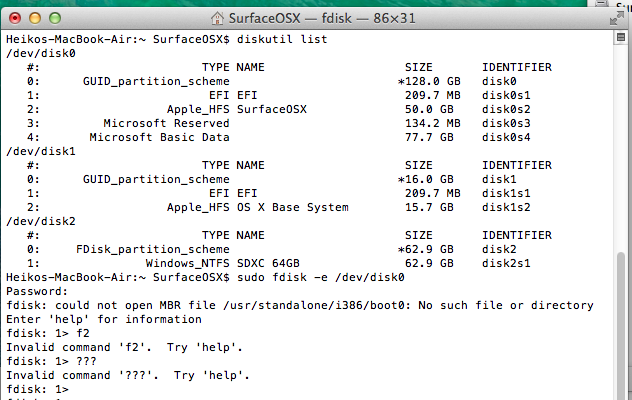

I cant fix the bootloader. (for dual boot) - It worked on my previous install, now refuses to 'fdisk'...
Hi. Can anybody point me to a way out of this:
(Installed OSX clean, installed Win8.1 on free diskspace, now hanging on getting clover back to dual boot / tried in safemode, also tried terminal from install-usb ...nope)
Now in terminal this happens:
... "permission denied"
same with sudo:
... "could not open MBR file" / "no such file"
