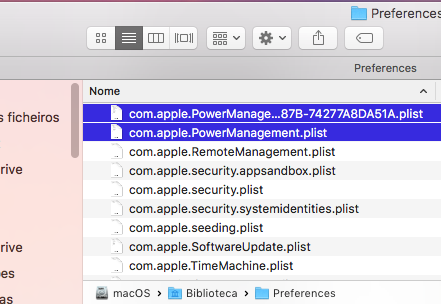

artur_pt Posted September 24, 2016 Share Posted September 24, 2016 hello Slice this is changed in sierra 1:836 0:000 Checking volume "macOS" (PciRoot(0x0)\Pci(0x1F,0x2)\Sata(0x0,0x0,0x0)\HD(7,GPT,7C5D318E-1C1F-46E7-A433-25F36CEA6FEC,0x1D2A5248,0x8A7CD78)) ... match!1:873 0:037 Check if volume Is Hibernated: 1:873 0:000 Check sleep image 'by signature': 1:878 0:005 read prefs \Library\Preferences\SystemConfiguration\com.apple.PowerManagement.plist status=Not Found 1:878 0:000 using default sleep image name = \private\var\vm\sleepimage 1:894 0:015 Reading first 512 bytes of sleepimage ... 1:895 0:000 OurBlockIoRead: Lba=21EDD890, Offset=43DBB12000 (BlockSize=512) 1:895 0:000 sig lion: 73696D65 1:895 0:000 sig snow: 0 1:895 0:000 got sleep image offset 1:895 0:000 Reading completed -> Success 1:895 0:000 sleepimage offset acquired successfully: 43DBB12000 1:895 0:000 gSleepTime: 1474731740 1:895 0:000 HFS+ volume modifyDate: 1474731740 1:895 0:000 image older then volume: 0 sec 1:895 0:000 hibernated: yes 1:895 0:000 UEFI with NVRAM: Boot0082 no read prefs \Library\Preferences\SystemConfiguration\com.apple.PowerManagement.plist status=Not Found now 2 files is in first file the hibernate mode thanks 1 Link to comment https://www.insanelymac.com/forum/topic/284656-clover-general-discussion/page/443/#findComment-2284240 Share on other sites More sharing options...
Sherlocks Posted September 24, 2016 Share Posted September 24, 2016 hello Slice this is changed in sierra 1:836 0:000 Checking volume "macOS" (PciRoot(0x0)\Pci(0x1F,0x2)\Sata(0x0,0x0,0x0)\HD(7,GPT,7C5D318E-1C1F-46E7-A433-25F36CEA6FEC,0x1D2A5248,0x8A7CD78)) ... match!1:873 0:037 Check if volume Is Hibernated: 1:873 0:000 Check sleep image 'by signature': 1:878 0:005 read prefs \Library\Preferences\SystemConfiguration\com.apple.PowerManagement.plist status=Not Found 1:878 0:000 using default sleep image name = \private\var\vm\sleepimage 1:894 0:015 Reading first 512 bytes of sleepimage ... 1:895 0:000 OurBlockIoRead: Lba=21EDD890, Offset=43DBB12000 (BlockSize=512) 1:895 0:000 sig lion: 73696D65 1:895 0:000 sig snow: 0 1:895 0:000 got sleep image offset 1:895 0:000 Reading completed -> Success 1:895 0:000 sleepimage offset acquired successfully: 43DBB12000 1:895 0:000 gSleepTime: 1474731740 1:895 0:000 HFS+ volume modifyDate: 1474731740 1:895 0:000 image older then volume: 0 sec 1:895 0:000 hibernated: yes 1:895 0:000 UEFI with NVRAM: Boot0082 no read prefs \Library\Preferences\SystemConfiguration\com.apple.PowerManagement.plist status=Not Foundnow 2 files Captura de ecrã 2016-09-24, às 16.52.29.png is in first file the hibernate mode thanks Some system can use hibernate wake. But if other system have hibernate mode, cant wakeup. So users usually use "Cancel hibernate wake". Latest Clover hasnt this option. Therefore we have to use "neverhibernate" on boot in config.plist. 나의 LG-F410S 의 Tapatalk에서 보냄 Link to comment https://www.insanelymac.com/forum/topic/284656-clover-general-discussion/page/443/#findComment-2284392 Share on other sites More sharing options...

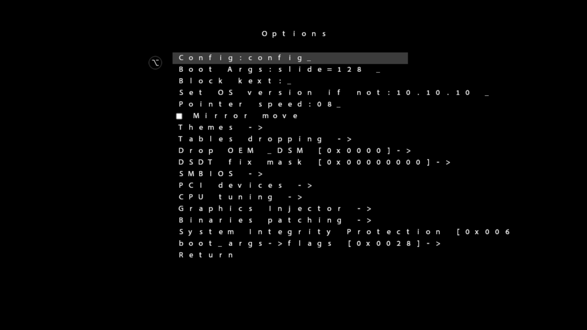

lisai9093 Posted September 24, 2016 Share Posted September 24, 2016 Rev 3537 Do you like proportional fonts? Depends on... Vertical menu looks better with constant width fonts. Other text with proportional. So I made questionable change that options menu will switch font to constant width with char width set in Theme.plist. While Help, About and Boot information will be proportional or no depends on Theme.plist. In this case char width doesn't matter. <key>Font</key> <dict> <key>CharWidth</key> <integer>12</integer> <key>Path</key> <string>Cambria_20pt_Cell_22x25_l-2_ra.png</string> <key>Type</key> <string>Load</string> <key>Proportional</key> <true/> </dict> Is it possible to let option menu using proportional font? Constant width font in option in my theme OSS makes it hard to read. Link to comment https://www.insanelymac.com/forum/topic/284656-clover-general-discussion/page/443/#findComment-2284464 Share on other sites More sharing options...

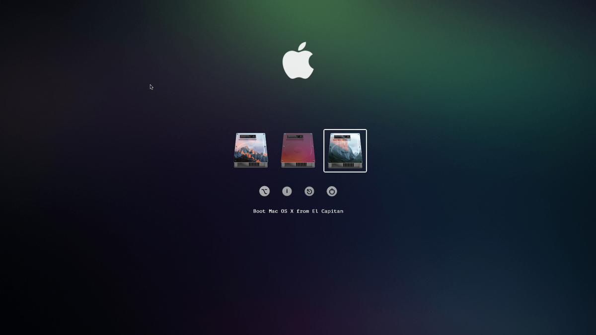

davidm71 Posted September 24, 2016 Share Posted September 24, 2016 Hi, I was trying to setup two duplicate drives containing El Cap with Clover but the Clover on one drive is pulling the config details from the other drive and I want them to be independant of each other such that if I make a mistake updating OSX on one drive I can go in with my clone drive and fix it. But the problem is Clover even though I select which drive to load from bios is pulling the kexts and config info from the wrong drive. What am I doing wrong? Thanks Link to comment https://www.insanelymac.com/forum/topic/284656-clover-general-discussion/page/443/#findComment-2284572 Share on other sites More sharing options...

tluck Posted September 25, 2016 Share Posted September 25, 2016 @davidm71 typically clover is is set up to scan all drives and find bootable partitions and then present them as options. you can turn that scanning off or just present specific volumes say just OSX on disk0. so now you boot from disk1 - which is your duplicate - it will only inject kexts from itself (if you set up clover to inject them vs cached from /L/E or /S/L/E. meaning clover will not look at the ESP on other disks for kexts. so i am not sure what you mean pulling kexts from the wrong drive. perhaps you should test this by installing a different theme on your duplicate so you can tell which drive you booted. Link to comment https://www.insanelymac.com/forum/topic/284656-clover-general-discussion/page/443/#findComment-2284630 Share on other sites More sharing options...
davidm71 Posted September 25, 2016 Share Posted September 25, 2016 @davidm71 typically clover is is set up to scan all drives and find bootable partitions and then present them as options. you can turn that scanning off or just present specific volumes say just OSX on disk0. so now you boot from disk1 - which is your duplicate - it will only inject kexts from itself (if you set up clover to inject them vs cached from /L/E or /S/L/E. meaning clover will not look at the ESP on other disks for kexts. so i am not sure what you mean pulling kexts from the wrong drive. perhaps you should test this by installing a different theme on your duplicate so you can tell which drive you booted. I'm way ahead of you in that I already tried that and set different themes and set one drives config.plist to verbose boot and the other without and Clover would still default to loading settings from the other drive. I noticed though if you exit Clover your taken to a legacy bios interface where you can select a default boot drive though that setting doesnt last after a reboot. So my theory is Clover looks for the CLOVER EFI folder on the first drive on the sata chain. This makes it very difficult to maintain separate independent installations. Thanks. Link to comment https://www.insanelymac.com/forum/topic/284656-clover-general-discussion/page/443/#findComment-2284644 Share on other sites More sharing options...
MacUser2525 Posted September 25, 2016 Share Posted September 25, 2016 So my theory is Clover looks for the CLOVER EFI folder on the first drive on the sata chain. This makes it very difficult to maintain separate independent installations. Thanks. From my experience all efi bootloaders do that ie first SATA device seen with efi partition is loaded or written to on update, windows does it linux does it and as you have seen clover as well. Your best bet is USB stick with your known good config in its efi partition that gets loaded no matter what when booted from no messing around loading from other devices. Link to comment https://www.insanelymac.com/forum/topic/284656-clover-general-discussion/page/443/#findComment-2284650 Share on other sites More sharing options...
davidm71 Posted September 25, 2016 Share Posted September 25, 2016 From my experience all efi bootloaders do that ie first SATA device seen with efi partition is loaded or written to on update, windows does it linux does it and as you have seen clover as well. Your best bet is USB stick with your known good config in its efi partition that gets loaded no matter what when booted from no messing around loading from other devices. I think your right. I unplugged the first drive and tried to boot off of the second one with out success ie there is no boot loader on the second drive despite running the installer on it. Was thinking about using a usb key too but can't find one at the moment. Maybe manually installing clover on the drive solve my problem. Thanks Link to comment https://www.insanelymac.com/forum/topic/284656-clover-general-discussion/page/443/#findComment-2284651 Share on other sites More sharing options...
tluck Posted September 25, 2016 Share Posted September 25, 2016 @davidm71. well on my UEFI system, in BIOS I can set which drive is the default boot disk - like Sata0 or Sata1. Clover loads from which ever drive is selected - and will only read the configuration and kexts from the boot disk - whether the boot disk is the default or selected by F12. You can target Clover to install on a specific disk. this is true for UEFI and Legacy. Link to comment https://www.insanelymac.com/forum/topic/284656-clover-general-discussion/page/443/#findComment-2284656 Share on other sites More sharing options...

davidm71 Posted September 25, 2016 Share Posted September 25, 2016 Yeah I also installed the latest Clover version 3763 and can tell you that the cloned drive does not boot by itself despite repeatedly installing clover on it to no effect. If I unplug the first sata ssd drive the cloned drive will not boot and the system throws an error complaining its a non bootable no operating system found drive. Wonder is there anyway to check that the uefi boot files were written to the drive? Maybe its not setting the drive as active? Thanks Link to comment https://www.insanelymac.com/forum/topic/284656-clover-general-discussion/page/443/#findComment-2284864 Share on other sites More sharing options...
davidm71 Posted September 25, 2016 Share Posted September 25, 2016 Well its never been required to clone the boot loader. I've always run either chimera, chameleon, or clover installer and that was enough. Going to try installing from another version or usb and report my findings later. thanks Edit: Booted from a usb drive and was able to install Clover on the second hard disk and boot from it with the first drive and usb drive both unplugged... BUT with the first drive plugged back in no matter what selecting the second drive from bios boot menu still loads the uefi boot loader from the first drive! No sure if this is because of how my bios operates. Maybe its the bios choosing the first uefi install. I don't know. Second Edit: After swapping both sata cables Clover this time finally loads from its own drive BUT now the second drive is loading Clover from the first hard drive bios has marked 'P1' whereas the second drive designated as 'P2'. So if anything ever goes wrong in the future with the installation your going to either use a usb key with current clover config files up to date or swap sata cables. Not sure if its Clover doing this or my bios's half arse uefi implementation at fault. At least I proved Clover installer will not install to a second drive while theres a primary on the Sata chain. You got to unplug it first and use USB! Link to comment https://www.insanelymac.com/forum/topic/284656-clover-general-discussion/page/443/#findComment-2284897 Share on other sites More sharing options...
bronxteck Posted September 25, 2016 Share Posted September 25, 2016 it probably depends on which EFI volume is mounted when installing. you probably should mount the one you want to install too manually before installing clover instead of letting the clover installer do it for you. Link to comment https://www.insanelymac.com/forum/topic/284656-clover-general-discussion/page/443/#findComment-2285407 Share on other sites More sharing options...

davidm71 Posted September 25, 2016 Share Posted September 25, 2016 it probably depends on which EFI volume is mounted when installing. you probably should mount the one you want to install too manually before installing clover instead of letting the clover installer do it for you. Well i went as far as unmounting the volume i did not want touched but that didnt work. Only way was to unplug the first volume physically by hand and then the installer has no choice to install to the intended drive. In any case no mater what drive i select from bios boot menu the first disks config.plist file gets loaded. Still not sure if its the bios fault or Clover. it probably depends on which EFI volume is mounted when installing. you probably should mount the one you want to install too manually before installing clover instead of letting the clover installer do it for you. Well i went as far as unmounting the volume i did not want touched but that didnt work. Only way was to unplug the first volume physically by hand and then the installer has no choice to install to the intended drive. In any case no mater what drive i select from bios boot menu the first disks config.plist file gets loaded. Still not sure if its the bios fault or Clover. Link to comment https://www.insanelymac.com/forum/topic/284656-clover-general-discussion/page/443/#findComment-2285485 Share on other sites More sharing options...

lisai9093 Posted September 26, 2016 Share Posted September 26, 2016 Is it possible to let option menu using proportional font? Constant width font in option in my theme OSS makes it hard to read. Any developer here? Link to comment https://www.insanelymac.com/forum/topic/284656-clover-general-discussion/page/443/#findComment-2286247 Share on other sites More sharing options...

Slice Posted September 27, 2016 Share Posted September 27, 2016 Is it possible to let option menu using proportional font? Constant width font in option in my theme OSS makes it hard to read. Change CharWIdth. 3000 revision lived with constant width fonts and all was OK for all. @Slice i wonder why disable "Cancel hibernate wake" option in latest clover? https://sourceforge.net/p/cloverefiboot/code/3728/tree/rEFIt_UEFI/entry_scan/loader.c If Hibernate Wake is checked then in will happen If unchecked then "Cancel hibernate wake". I have a problem with new clover. After update to the newest version, when my system up, everything freezing, status bar is grey, no icon in icon bar, and can't move mouse cursor.. Any help? Any proof? Logs? Link to comment https://www.insanelymac.com/forum/topic/284656-clover-general-discussion/page/443/#findComment-2286780 Share on other sites More sharing options...
lisai9093 Posted September 27, 2016 Share Posted September 27, 2016 Change CharWIdth. 3000 revision lived with constant width fonts and all was OK for all. If Hibernate Wake is checked then in will happen If unchecked then "Cancel hibernate wake". Any proof? Logs? Got it. Thanks for the info. Link to comment https://www.insanelymac.com/forum/topic/284656-clover-general-discussion/page/443/#findComment-2287311 Share on other sites More sharing options...
