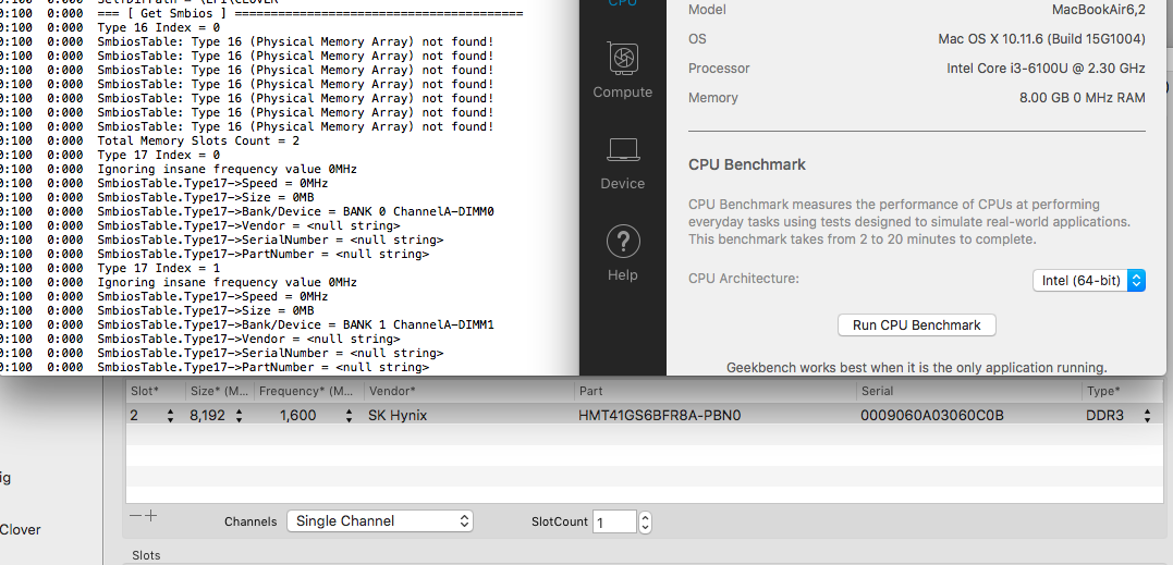

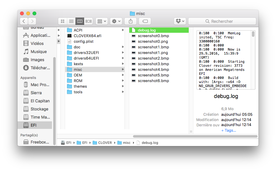

Balamut Posted October 5, 2016 Share Posted October 5, 2016 (edited) @Slice I'm attaching preboot/debug logs from Clover as well as: smbiosview pci memmap dmem and some other dumps from EFI I'm far from being a programmer but i've noticed this when I was just looking around in Clover debug: 0:100 0:000 === [ Get Smbios ] ======================================== 0:100 0:000 Total Memory Slots Count = 4 0:100 0:000 Type 17 Index = 0 0:100 0:000 SmbiosTable.Type17->Speed = 2133MHz 0:100 0:000 SmbiosTable.Type17->Size = 16384MB 0:100 0:000 SmbiosTable.Type17->Bank/Device = NODE 1 DIMM_A1 0:100 0:000 SmbiosTable.Type17->Vendor = Micron 0:100 0:000 SmbiosTable.Type17->SerialNumber = 12167707 0:100 0:000 SmbiosTable.Type17->PartNumber = 36ASF2G72PZ-2G1B1 0:100 0:000 Type 17 Index = 1 0:100 0:000 Ignoring insane frequency value 0MHz 0:100 0:000 SmbiosTable.Type17->Speed = 0MHz 0:100 0:000 SmbiosTable.Type17->Size = 0MB 0:100 0:000 SmbiosTable.Type17->Bank/Device = NODE 1 DIMM_A2 0:100 0:000 SmbiosTable.Type17->Vendor = <null string> 0:100 0:000 SmbiosTable.Type17->SerialNumber = <null string> 0:100 0:000 SmbiosTable.Type17->PartNumber = <null string> in Smbiosview ========================================================= Type=17, Handle=0x81 Dump Structure as: Index=129,Length=0x6D,Addr=0x7DB50332 00000000: 11 28 81 00 7C 00 FE FF-48 00 48 00 00 40 09 00 *.(......H.H..@..* 00000010: 01 02 1A 80 00 55 08 03-04 05 06 02 00 00 00 00 *.....U..........* 00000020: 55 08 00 00 00 00 00 00-44 49 4D 4D 5F 48 31 00 *U.......DIMM_H1.* 00000030: 4E 4F 44 45 20 34 00 4D-69 63 72 6F 6E 00 31 32 *NODE 4.Micron.12* 00000040: 31 36 37 38 35 37 00 44-49 4D 4D 5F 48 31 5F 41 *167857.DIMM_H1_A* 00000050: 73 73 65 74 54 61 67 00-33 36 41 53 46 32 47 37 *ssetTag.36ASF2G7* 00000060: 32 50 5A 2D 32 47 31 42-31 20 20 00 00 *2PZ-2G1B1 ..* Looks like index is different, sorry if/most likely I'm talking out of my a$$ without understanding {censored}. Also is there a way for a Clover to detect both CPUs? Thanks a lot, EFI_Shell_Dumps.zip preboot_debug_logs.zip Edited October 5, 2016 by Balamut Link to comment https://www.insanelymac.com/forum/topic/284656-clover-general-discussion/page/447/#findComment-2293159 Share on other sites More sharing options...
Slice Posted October 5, 2016 Share Posted October 5, 2016 here is log. debug.log.zip my laptop have hibernate booted Macintosh SSD(hibernate). but i have black screen. so i need "cancel hibernate wake" Take, please, latest Clover 3789 Uncomment those DBG statements at the end of menu.c ((LOADER_ENTRY*)TempChosenEntry)->Flags |= (UINT16)(gSettings.FlagsBits & 0x0FFF); // DBG("get FlagsBits = 0x%x\n", gSettings.FlagsBits); #endif FreePool(TmpArgs); SubMenuExit = 0; while (!SubMenuExit) { SubMenuExit = RunGenericMenu(MainChosenEntry->SubScreen, Style, &SubMenuIndex, &TempChosenEntry); #ifdef CHECK_FLAGS DecodeOptions((LOADER_ENTRY*)MainChosenEntry); // DBG("get OptionsBits = 0x%x\n", gSettings.OptionsBits); ((LOADER_ENTRY*)MainChosenEntry)->Flags = (UINT16)(gSettings.FlagsBits & 0x0FFF); // DBG("get FlagsBits = 0x%x\n", gSettings.FlagsBits); #endif Cancel Hibernate Wake means the flag #define OSFLAG_HIBERNATED (1 8) will be zero @Slice I'm attaching preboot/debug logs from Clover as well as: smbiosview pci memmap dmem and some other dumps from EFI I'm far from being a programmer but i've noticed this when I was just looking around in Clover debug: 0:100 0:000 === [ Get Smbios ] ======================================== 0:100 0:000 Total Memory Slots Count = 4 0:100 0:000 Type 17 Index = 0 0:100 0:000 SmbiosTable.Type17->Speed = 2133MHz 0:100 0:000 SmbiosTable.Type17->Size = 16384MB 0:100 0:000 SmbiosTable.Type17->Bank/Device = NODE 1 DIMM_A1 0:100 0:000 SmbiosTable.Type17->Vendor = Micron 0:100 0:000 SmbiosTable.Type17->SerialNumber = 12167707 0:100 0:000 SmbiosTable.Type17->PartNumber = 36ASF2G72PZ-2G1B1 0:100 0:000 Type 17 Index = 1 0:100 0:000 Ignoring insane frequency value 0MHz 0:100 0:000 SmbiosTable.Type17->Speed = 0MHz 0:100 0:000 SmbiosTable.Type17->Size = 0MB 0:100 0:000 SmbiosTable.Type17->Bank/Device = NODE 1 DIMM_A2 0:100 0:000 SmbiosTable.Type17->Vendor = <null string> 0:100 0:000 SmbiosTable.Type17->SerialNumber = <null string> 0:100 0:000 SmbiosTable.Type17->PartNumber = <null string> in Smbiosview ========================================================= Type=17, Handle=0x81 Dump Structure as: Index=129,Length=0x6D,Addr=0x7DB50332 00000000: 11 28 81 00 7C 00 FE FF-48 00 48 00 00 40 09 00 *.(......H.H..@..* 00000010: 01 02 1A 80 00 55 08 03-04 05 06 02 00 00 00 00 *.....U..........* 00000020: 55 08 00 00 00 00 00 00-44 49 4D 4D 5F 48 31 00 *U.......DIMM_H1.* 00000030: 4E 4F 44 45 20 34 00 4D-69 63 72 6F 6E 00 31 32 *NODE 4.Micron.12* 00000040: 31 36 37 38 35 37 00 44-49 4D 4D 5F 48 31 5F 41 *167857.DIMM_H1_A* 00000050: 73 73 65 74 54 61 67 00-33 36 41 53 46 32 47 37 *ssetTag.36ASF2G7* 00000060: 32 50 5A 2D 32 47 31 42-31 20 20 00 00 *2PZ-2G1B1 ..* Looks like index is different, sorry if/most likely I'm talking out of my a$$ without understanding {censored}. Also is there a way for a Clover to detect both CPUs? Thanks a lot, I see something new. Your SMBIOS has several tables type16 which is very unusual. I will try to take them into account. About CPU I don't know if you have any inconvenience. The system works? At full speed? 1 Link to comment https://www.insanelymac.com/forum/topic/284656-clover-general-discussion/page/447/#findComment-2293174 Share on other sites More sharing options...

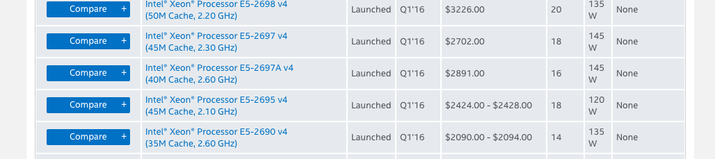

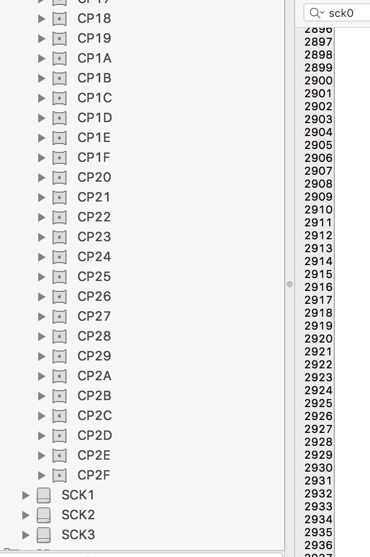

Balamut Posted October 5, 2016 Share Posted October 5, 2016 Thank you very much Slice. It doesn't. When the hyper threading is on the system gets instant panic on ApicCPU = 121 when in reality it should only be 87( 2cpus X 22 cores X threads per CPU). Note: you can't see on that picture but it shows ApicCPU from 0 to 121 twice. But when I disable the hyperthreading I managed to install but here is the problem, ApicCPU gets to 120 and after installation this happens; Terminal crashes instantly, when looking at the crash log it says out of kernel memory. Apps randomly crash or say the application is corrupted. By biggest concern right now is terminal because most of my work is based on it, and if some system mods needed I'm fresh out of luck. About full speed, actually I don't know, can't get to the terminal to install or check anything, cpumonitoring kext causes kernel panic, from your version or kozleks. If needed I can explain in details at applelife I'm fluent in Russian:) Thanks again Link to comment https://www.insanelymac.com/forum/topic/284656-clover-general-discussion/page/447/#findComment-2293191 Share on other sites More sharing options...

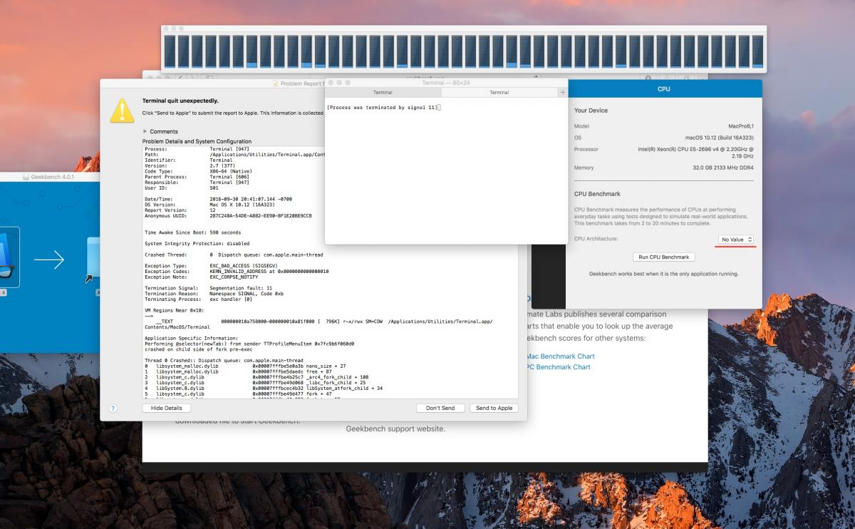

Balamut Posted October 5, 2016 Share Posted October 5, 2016 Preboot log is attached. Looks like its almost there. You're the man The only thing will be left is the dreadful CPU issue Also just noticed this in preboot.log: The CPU not supported turbo, but I'm pretty sure it does. This is what I was telling you about, the terminal crush and Geekbench showing No Value on the CPU architecture. preboot.log.zip Link to comment https://www.insanelymac.com/forum/topic/284656-clover-general-discussion/page/447/#findComment-2293210 Share on other sites More sharing options...
Slice Posted October 5, 2016 Share Posted October 5, 2016 You seems have an beta-CPU, not documented Can you make full DarwinDumper report without BIOS, without html, archive LZMA? 1 Link to comment https://www.insanelymac.com/forum/topic/284656-clover-general-discussion/page/447/#findComment-2293269 Share on other sites More sharing options...
Fljagd Posted October 5, 2016 Share Posted October 5, 2016 Preboot log is attached. Looks like its almost there. You're the man The only thing will be left is the dreadful CPU issue Also just noticed this in preboot.log: The CPU not supported turbo, but I'm pretty sure it does. This is what I was telling you about, the terminal crush and Geekbench showing No Value on the CPU architecture. Terminal_Geekbench.jpg Impressive Congratulations Slice Link to comment https://www.insanelymac.com/forum/topic/284656-clover-general-discussion/page/447/#findComment-2293279 Share on other sites More sharing options...

Balamut Posted October 5, 2016 Share Posted October 5, 2016 It's OEM and if rumors to be true thats the CPU that Apple might be using on the higher end BTO on the new Mac Pros. Here is the darwin dump as you asked. Also just in case I'm attaching CPU and ACPI dumps from Linux, x86infoCPU is interesting it shows 120 APICs. On the side note, the hyper threading is not the only thing that causes panic, activating x2apic trows the system into panic with and without hyper threading. You seems have an beta-CPU, not documented Screen Shot 2016-10-05 at 14.07.40.png Can you make full DarwinDumper report without BIOS, without html, archive LZMA? 46:908 0:002 Found ACPI CPU: CP00 | CP01 | CP02 | CP03 | CP04 | CP05 | CP06 | CP07 | CP08 | CP09 | CP0A | CP0B | CP0C | CP0D | CP0E | CP0F | CP10 | CP11 | CP12 | CP13 | CP14 | CP15 | CP16 | CP17 | CP18 | CP19 | CP1A | CP1B | CP1C | CP1D | CP1E | CP1F , within the score: _SB_SCK0 I have the same thing BUT, look at the image, ACPI CPU in the DSDT goes all the way up to the CP2F (47?) and I've got 4 SCK's DarwinDumper_3.0.1_05.10_11.48.44_MacPro6,1_AMI_X64_3790_Sierra_16A323_balamut.tar.lzma.zip UbuntuDumps.zip Link to comment https://www.insanelymac.com/forum/topic/284656-clover-general-discussion/page/447/#findComment-2293741 Share on other sites More sharing options...
