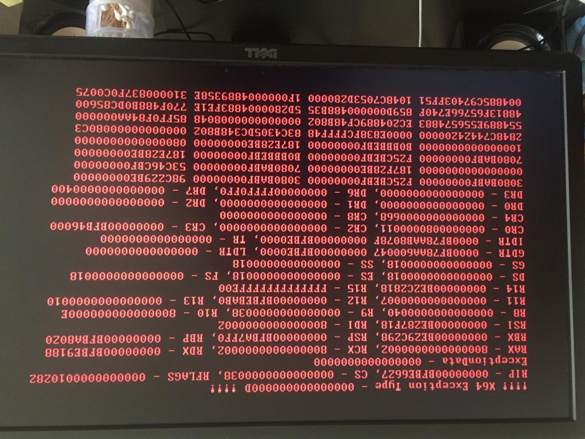

Guys, is there a problem with Sierra booting? I keep having KPs. The PC automatically restarts and usually, after the restart everything works fine. I thought it could be because I was using the Beta version. But now, even with the live version, I'm having the same issue.
First boot goes to KP, then automatically restarts, then everything ok... What's wrong? Anyone else having these issues? Could be the 3rd party kexts?
UPDATE:
Well, turns out it was the 3rd party kexts. AppleALC.kext in particular. Updated it from 1.0.12 to 1.0.16 and so far so good.
When I install 10.12(16A319) by using Clover_v2.3k_r3761 From my USB Flash Drive to SSD,I got this on my screen and install stopped.What's the problem?
Yes, already reported the boot file rev3761 at sf.net is bad. Will be corrected soon.
Use the file from previous revision.
