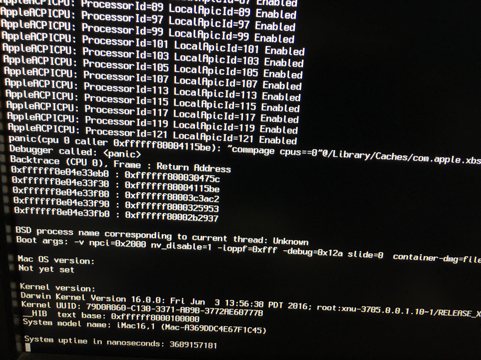

Hi Slice, I would like to know if it is a normal behaviour that I have these flags set when in my config.plist I have not configured with this flags?
Clover version is 3716 My cpu is a Broadwell EP Xeon 2696 v4
Edit same behaviour with clover 3726
Hello there,
I hope you don't mind if I will answer to your question.
The default value for the GeneratePS/CS states and EnableC6 options are set to true when the CPU Model is equal or bigger than Ivy Bridge and nothing is set in the config.plist file.
if (gCPUStructure.Model >= CPU_MODEL_IVY_BRIDGE) {
    gSettings.GeneratePStates    = TRUE;
    gSettings.GenerateCStates    = TRUE;
    //  gSettings.EnableISS          = FALSE;
    //  gSettings.EnableC2           = TRUE;
    gSettings.EnableC6           = TRUE;
    gSettings.PluginType         = 1;
    if (gCPUStructure.Model == CPU_MODEL_IVY_BRIDGE) {
      gSettings.MinMultiplier    = 7;
    //  gSettings.DoubleFirstState   = FALSE;
    gSettings.DropSSDT           = TRUE;
    gSettings.C3Latency          = 0x00FA;
The Broadwell EP does not exist in the CPU model definition but I suppose it's recognised as different Broadwell Model which has a higher hex value than the Ivy Bridge model.
Best regards.
Hi Needy
No, I don't mind and I am grateful for your answer
I am using a FakeCpuid to boot as advised by pikeralpha, but a this moment I can't resolve this error message X86PlatformShim::start - Failed to send stepper and it seems that I have generated other PM ssdt other than one I would like to use present in clover/acpi/patched folder
I'm not familiar with that error.
Set the mentioned options to false in the config.plist file, remove the bad SSDT tables, generate new good ones and put them in the directory you mentioned.
Best of luck.

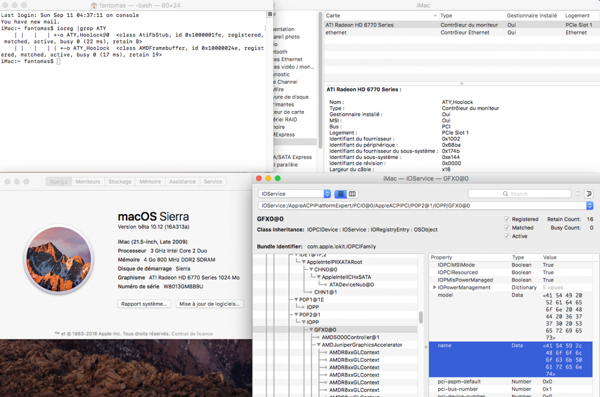

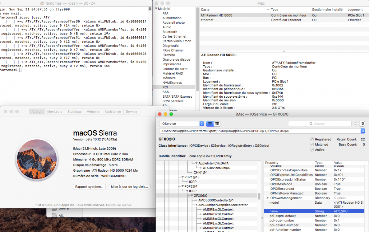

I would like to inject a property for gfx card as type STRING, but it always gets injected as type DATA:
the marked string was injected via CLOVER config.plist as the following:
but as you can see in the first picture, it was injected as type DATA. Question: WHY?
what has to be done to get this injected as type STRING?
it must be possible, as you can see in this screenshot (thx to PAVO 4 providing his IORegistryExplorer file):
Any help is welcome and much appreciated.
Regards...
Mork vom Ork
@ Mork vom Ork
The value "ATY_GPU" is the default value (as String) when the framebuffer is not properly allocated.
An example with my HD 6770:
But if the famebuffer is properly allocated, then the value is showed as "Data" type.
Clover injects "Hoolock" as the default framebuffer for my card:
name Data 41 54 59 2c 48 6f 6f 6c 6f 63 6b 50 61 72 65 6e 74   -->  ATY,HoolockParent
SMBIOS is equal to Apple machine model and indeed ur smbios is a bit old for that cpu/gpu generation...try mbp11,2, about ur AMD GPU (Caicos family) sometimes u must use another framebuffer to get output or editon on one, also in clover the setting DualPort to 0/1 is helpful in notebooks to achieve output.
Off course that an updated Bios from the manufacturer is advised to ur laptop model.

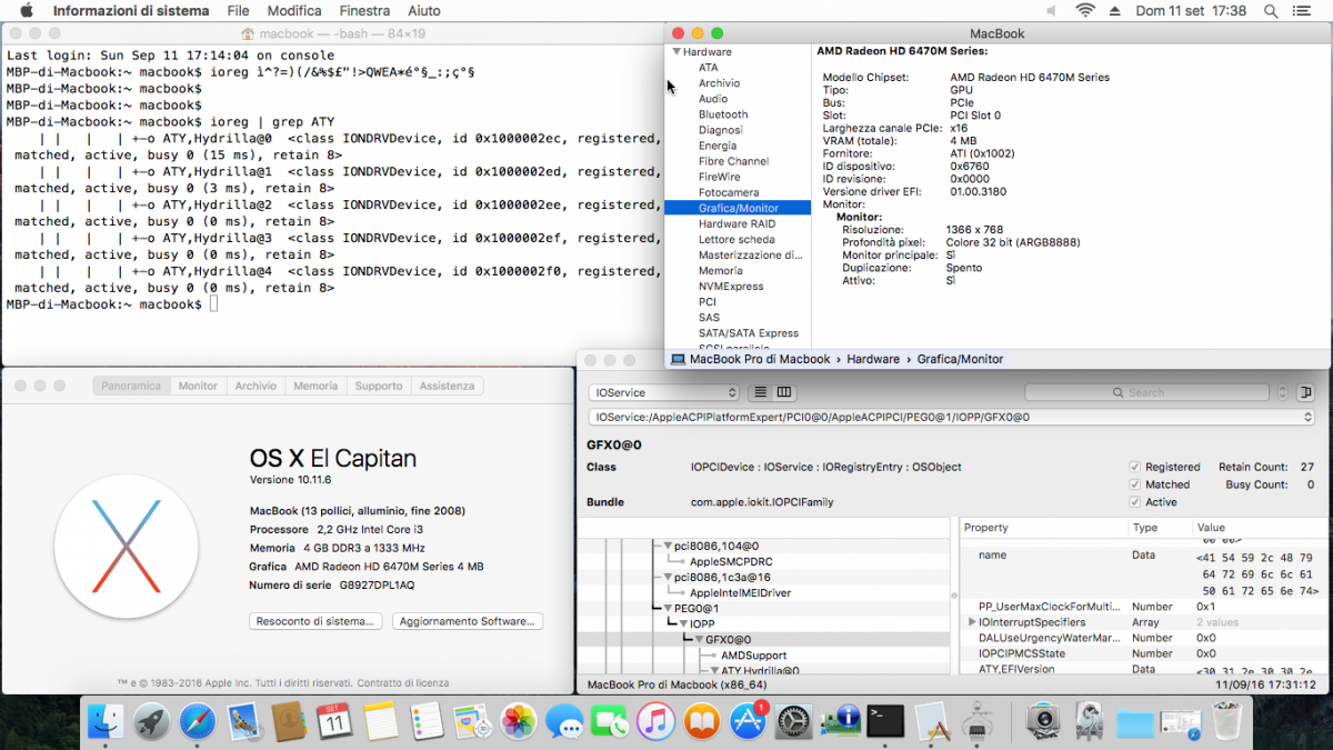

I have to update the bios of the notebook ?
I'm not talking about your bios... but about the SMBIOS entry in the config.plist. Off course a framebuffer should have an lvds port (display) to work with a laptop, otherwise a manual editing  (KextsToPatch) is needed.
But before try all framebuffers available:
@"AMD6000Controller:", \
@"Pithecia",    @"Bulrushes",   @"Cattail",     @"Hydrilla",    @"Duckweed", \
@"Fanwort",     @"Elodea",      @"Kudzu",       @"Gibba",       @"Lotus", \
@"Ipomoea",     @"Muskgrass",   @"Juncus",      @"Osmunda",     @"Pondweed", \
@"Spikerush",   @"Typha",
You actually have Hydrilla as default and you should try all the ports available on each framebuffers... good luck
It is not an error.
The DeviceTree don't contain a type field. It is IORegistryExplorer business to show what is string or probably data.

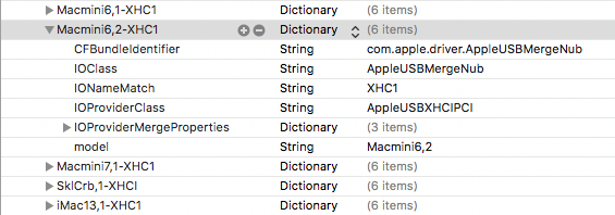

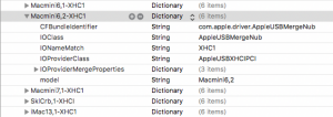

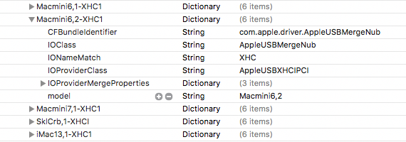

Morning folks, can I please ask for advice on the use of "InfoPlistPatch" and if it would be able to patch the Info.plist of AppleUSBXHCIPCI.kext (Which is inside IOUSBHostFamily.kext)?
I would like it to change "XHC1" to "XHC" which might not be possible as they are not the same length?
From this:
To This:
