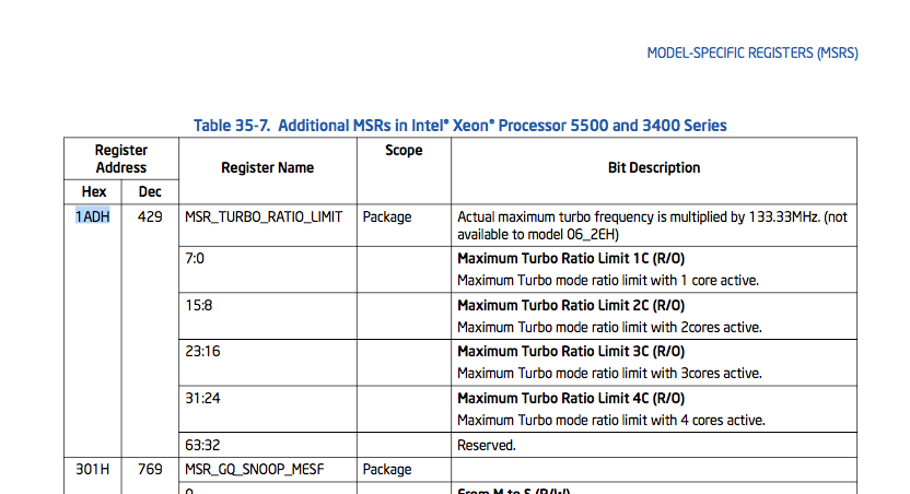

Also for some odd reason the turbo mode is still set to 0/0/0/0
Look, this is just Get Smbios. Clover showns you what is written in your BIOS.
The same about turbo. The information read from MSR 0x1AD
But if you can bring me CPU report from AIDA64 I will look for other registers.
