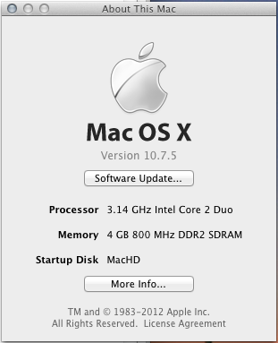

How to setup overclock in clover? My Turbo is enabled on BIOS when I use this setting on Chimera type installation I seeing 3.9 Ghz default. But on clover I can just see 3.5Ghz as Default. I want to overclock my system 4.4Ghz but I don't know how to setup in Clover? Is there a any guide how to setup overclock in clover? Thank you.
	<key>CPU</key>
	<dict>
		<key>FrequencyMHz</key>
		<integer>3141</integer>
	</dict>
Be happy!

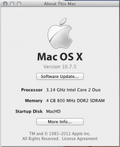

Hey Slice.  Any idea why this isn't working?  Only in my About This Mac window though...
<key>CPU</key>
<dict>
	<integer>4500</integer>
</dict>
About This Mac:
System Information:
EDIT:  The Clover wiki shows it like this:
Which way is correct?
OS X by default has register for maximum 4.2 GHz overclock and that is the maximum it will show (I think). In clover you overclock in BIOS, clover on boot takes care of the rest. On my asus gene III it is like that. I overclock with bus FREQ, leave multiplier on auto, and in clover boot.log i see proper bus freq detected, proper multi and turbo and it is just working. Curently at 3.46GHz freq with turbo up to 3.76Ghz on two cores. This is from default 3.07Ghz. "About this mac" will always show base freq. Hope this helps. Use Geekbench to verify new speed.
Both and are correct.
The setting is not overclock. It is only cosmetic for System Profiler.
I understand that, I'm overclocked via BIOS. I just thought that adding that to config would reflect system wide. Everything shows 4.5GHz except for the About This Mac window (see above). Is this setting in config.plist supposed to affect the About This Mac window, or just System Profiler?
From this thread:
http://www.insanelymac.com/forum/topic/277704-overclocked-in-bios-but-about-this-mac-says-otherwise/
The Edge3000:
I don't know what utility you are using, but I would recommend a utility named SMC monitor (make sure you have latest FakeSMC.kext installed). This will tell you the true frequency in real time.
About this Mac has trouble on Sandy Bridge CPUs, so I just correct mine cosmetically using this in smbios.plist:
<key>SMmaximalclock</key>
<string>4200000</string>
System Information shows my CPU speed as 40.16 GHz and Geekbench reports my lowest multiplier, 1.6GHz, but SMC monitor shows (and the Geekbench score confirms) that I am indeed running at 4.2GHz.
One problem I haven't been able to figure out is that my multiplier seems to be alternating between 1.6GHz and 4.2GHz only. Chameleon is generating the P-States correctly (I can extract SSDT and they are there), but OS X doesn't seem to use the states in between.
Also, while this is the overclocking forum, you'd probably have better luck discussing this in one of the many threads on the topic in the general Lion forums.
Best of luck.
EDIT: Just read . You need to get a properly patched DSDT, as it will make your whole install much better. If you do not know how or what the DSDT is, then you have a lot of reading ahead of you. There are many good threads on this forum that will teach you the ways.
About this Mac has trouble on Sandy Bridge CPUs, so I just correct mine cosmetically using this in smbios.plist:SMmaximalclock
4200000
Is there a similar key I can add to my smbios in config.plist for clover? Since there is no smbios.plist…
first, there can be smbios.plist if you like, the clover will read it and overide clover settings with it, second, in config.plist you have smbios settings and you can put it in there, if i am not mistaken, or i get another face palm from slice.  :P
Hahahaha ok thanks man. I'll add it to my config.plist.
Actually, I've been clocked down to 4GHz since I started using Clover. I upped my clock back to 4.5GHz last night and I've been getting random system freezes ever since…. Didn't used to do that when I was using Chameleon.
Would Clover effect OC stability at all?
smbios.plist:SMmaximalclock == FrequencyMHz * 1000000
Are you saying these two methods will produce the same result?  Because my About This Mac window still doesn't show 4.5.  It shows 4.3 and I don't know why.
