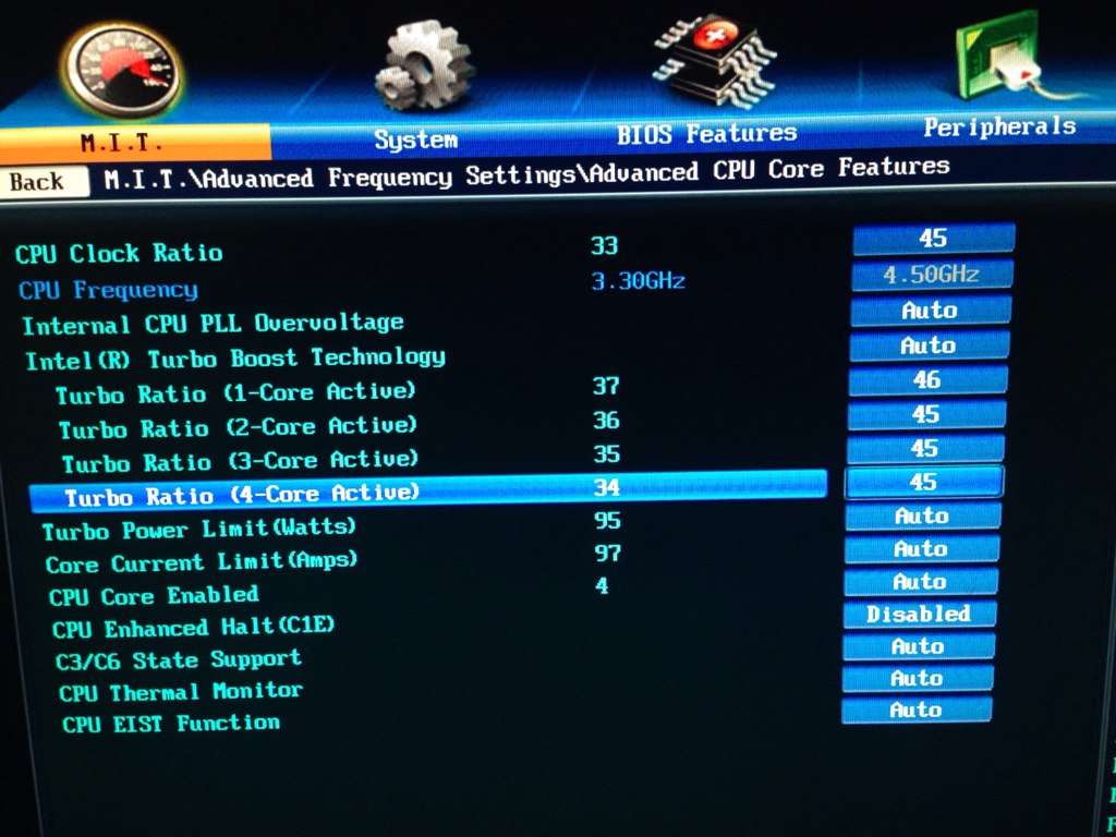

ADHDMedia Posted July 9, 2014 Share Posted July 9, 2014 I'm not even gonna pretend to know what I'm looking at lol This is when booted with 4.3GHz set in BIOS. I'll post one from a 4.5GHz OC in a second. It seems like I can go up to 4.3GHz and retain stability but as soon as I go above 4.3GHz, I get random system freezes and have to hard reset. Never happened with Chameleon, although I supposed any number of factors could be causing this, so I'm not blaming Clover just yet Does everything look ok? ------------------------------- DATE: 2014-07-09 TIME: 13:23:29 ------------------------------- 0:100 0:100 MemLog inited, TSC freq: 3309724023 0:101 0:001 0:101 0:000 Now is 9.7.2014, 20:23:20 (GMT+2047) 0:101 0:000 Starting Clover rev 2747 on American Megatrends EFI 0:101 0:000 SelfDevicePath=PciRoot(0x0)\Pci(0x1F,0x2)\Sata(0x3,0xFFFF,0x0)\HD(1,GPT,29F3DF13-7214-4AD1-B772-55F134498D8F,0x28,0x64000) @D22A4B98 0:101 0:000 SelfDirPath = \EFI\BOOT 0:101 0:000 UnicodeCollation Status=Success 0:101 0:000 Total Memory Slots Count = 4 0:101 0:000 Type 17 Index = 0 0:101 0:000 Ignoring insane frequency value 0MHz 0:101 0:000 SmbiosTable.Type17->Speed = 0 0:101 0:000 SmbiosTable.Type17->Size = 0 0:101 0:000 Type 17 Index = 1 0:101 0:000 SmbiosTable.Type17->Speed = 1333 0:101 0:000 SmbiosTable.Type17->Size = 4096 0:101 0:000 Type 17 Index = 2 0:101 0:000 SmbiosTable.Type17->Speed = 1333 0:101 0:000 SmbiosTable.Type17->Size = 4096 0:101 0:000 Type 17 Index = 3 0:101 0:000 SmbiosTable.Type17->Speed = 1333 0:101 0:000 SmbiosTable.Type17->Size = 4096 0:101 0:000 Boot status=0 0:101 0:000 Clover revision: 2747 running on To be filled by O.E.M. 0:101 0:000 ... with board Z68MX-UD2H-B3 0:101 0:000 Clover load options size = 4 bytes 0:103 0:002 Oem AMBO.plist not found at path: EFI\CLOVER\AMBO.plist 0:103 0:000 EFI\CLOVER\AMBO.plist not loaded with name from LoadOptions: Not Found 0:104 0:001 Using OEM config.plist at path: EFI\CLOVER\config.plist 0:105 0:000 EFI\CLOVER\config.plist loaded: Success 0:106 0:001 Found theme MAC 0:110 0:003 Loading early settings 0:110 0:000 timeout set to 0 0:110 0:000 Default theme: mac 0:110 0:000 Hiding entries with string Windows 0:110 0:000 Hiding entries with string BOOTX64.EFI 0:110 0:000 LoadDrivers() start 0:112 0:002 Loading CsmVideoDxe-64.efi 0:114 0:002 - driver needs connecting 0:114 0:000 Loading FSInject-64.efi 0:117 0:002 Loading OsxFatBinaryDrv-64.efi 0:119 0:002 Loading VBoxHfs-64.efi 0:122 0:002 - driver needs connecting 0:122 0:000 Loading OsxAptioFixDrv-64.efi 0:124 0:002 Loading EmuVariableUefi-64.efi 0:127 0:002 EmuVariableUefi Initialize: VariableCommonInitialize = Success, orig services stored, install gEmuVariableControlProtocolGuid = Success 0:128 0:001 2 drivers needs connecting ... 0:128 0:000 PlatformDriverOverrideProtocol->GetDriver overriden 0:128 0:000 Video driver loaded: disconnect Success 0:208 0:080 Searching for invalid DiskIo BY_DRIVER connects: not found, all ok 0:228 0:019 CsmVideoDriverBindingStart 0:228 0:000 mixed support=40010 0:228 0:000 Controller is [030000] 0:228 0:000 Check for VBE 0:304 0:076 found Detail Timing 1680x1050 0:317 0:012 0 640x480 attr=3BF - ok, edid+, 640x480, working, highest, pref=0 0:319 0:002 1 800x600 attr=3BF - ok, edid+, 800x600, working, highest, pref=1 0:321 0:002 2 1024x768 attr=3BF - ok, edid+, 1024x768, working, highest, pref=2 0:323 0:002 3 1280x1024 attr=3BF - ok, edid+, working, highest, pref=3 0:336 0:012 4 1680x1050 attr=3BF - ok, edid+, working, highest, pref=4 0:338 0:002 5 1280x800 attr=3BF - ok, edid- 0:338 0:000 CsmVideo: New mode: 4 1680x1050 - set 0:642 0:304 - SetMode pref 4 (4) = Success 0:642 0:000 CsmVideoCheckForVbe - Success 0:643 0:000 CsmVideoDriverBindingStart end Success 0:643 0:000 CsmVideo: New mode: 2 1024x768 - blocking that switch 0:644 0:001 CsmVideo: New mode: 2 1024x768 - blocking that switch 0:646 0:002 CsmVideo: New mode: 2 1024x768 - blocking that switch 0:998 0:351 LoadDrivers() end 0:998 0:000 EmuVariable InstallEmulation: orig vars copied, emu.var.services installed, CreateEvent = Success, done 1:073 0:074 Console modes reported: 4, available modes: 1:073 0:000 Mode 1: 80x25 (current mode) 1:073 0:000 Mode 2: 80x50 1:073 0:000 Mode 3: 100x31 1:073 0:000 Mode 4: 128x30 1:073 0:000 SetScreenResolution: 1680x1050 - already set 1:073 0:000 reinit: self device path=PciRoot(0x0)\Pci(0x1F,0x2)\Sata(0x3,0xFFFF,0x0)\HD(1,GPT,29F3DF13-7214-4AD1-B772-55F134498D8F,0x28,0x64000) 1:073 0:000 new SelfHandle=D22A4B98 1:073 0:000 CPU Vendor = 756E6547 Model=206A7 1:073 0:000 The CPU supported turbo 1:073 0:000 BrandString = Intel(R) Core(TM) i5-2500K CPU @ 3.30GHz 1:073 0:000 MSR 0xE2 before patch 1E000403 1:073 0:000 MSR 0xE4 00010414 1:073 0:000 MSR 0xCE 00001000_70012100 1:073 0:000 non-usable FLEX_RATIO = F0000 1:073 0:000 corrected FLEX_RATIO = E0000 1:073 0:000 MSR 0x1B0 00000000 1:073 0:000 FSBFrequency=130MHz 1:073 0:000 Corrected FSBFrequency=100MHz 1:073 0:000 Vendor/Model/Stepping: 0x756E6547/0x2A/0x7 1:073 0:000 Family/ExtFamily: 0x6/0x0 1:073 0:000 MaxDiv/MinDiv: 33.0/16 1:073 0:000 Turbo: 34/59/59/59 1:073 0:000 Features: 0xBFEBFBFF 1:073 0:000 Threads: 4 1:073 0:000 Cores: 4 1:073 0:000 FSB: 100 MHz 1:073 0:000 CPU: 4300 MHz 1:073 0:000 TSC: 4300 MHz 1:073 0:000 PIS: 400 MHz 1:073 0:000 PCI (00|00:00.00) : 8086 0100 class=060000 1:073 0:000 PCI (00|00:01.00) : 8086 0101 class=060400 1:073 0:000 PCI (00|01:00.00) : 10DE 0FC6 class=030000 1:073 0:000 Found NVidia model=PNY GeForce GTX 650 1:073 0:000 PCI (00|01:00.01) : 10DE 0E1B class=040300 1:073 0:000 PCI (00|00:16.00) : 8086 1C3A class=078000 1:073 0:000 PCI (00|00:16.01) : FFFF FFFF class=FFFFFF 1:073 0:000 PCI (00|00:16.02) : FFFF FFFF class=FFFFFF 1:073 0:000 PCI (00|00:16.03) : FFFF FFFF class=FFFFFF 1:073 0:000 PCI (00|00:1A.00) : 8086 1C2D class=0C0320 1:073 0:000 PCI (00|00:1B.00) : 8086 1C20 class=040300 1:073 0:000 PCI (00|00:1C.00) : 8086 1C10 class=060400 1:073 0:000 PCI (00|02:00.00) : 168C 0030 class=028000 1:073 0:000 PCI (00|00:1C.04) : 8086 1C18 class=060400 1:073 0:000 PCI (00|03:00.00) : 1B4B 9172 class=010601 1:073 0:000 PCI (00|00:1C.05) : 8086 1C1A class=060400 1:073 0:000 PCI (00|04:00.00) : 1B6F 7023 class=0C0330 1:073 0:000 PCI (00|00:1C.06) : 8086 1C1C class=060400 1:074 0:000 PCI (00|05:00.00) : 10EC 8168 class=020000 1:074 0:000 PCI (00|00:1C.07) : 8086 1C1E class=060400 1:074 0:000 PCI (00|06:00.00) : 1B6F 7023 class=0C0330 1:074 0:000 PCI (00|00:1D.00) : 8086 1C26 class=0C0320 1:074 0:000 PCI (00|00:1F.00) : 8086 1C44 class=060100 1:074 0:000 PCI (00|00:1F.02) : 8086 1C02 class=010601 1:074 0:000 PCI (00|00:1F.03) : 8086 1C22 class=0C0500 1:074 0:000 PCI (00|00:1F.06) : FFFF FFFF class=FFFFFF 1:074 0:000 ScanSPD() start 1:074 0:000 SMBus CmdReg: 0x1 1:074 0:000 Scanning SMBus [8086:1C22], mmio: 0xF7505004, ioport: 0xF000, hostc: 0x1 1:088 0:014 SPD[0]: Type 11 @0x50 1:097 0:008 DDR speed 1333MHz 1:097 0:000 Slot: 0 Type 24 4096MB 1333MHz Vendor=Corsair PartNo=CMX16GX3M4A1333C9 SerialNo=0000000000000000 1:111 0:014 SPD[1]: Type 11 @0x51 1:120 0:008 DDR speed 1333MHz 1:120 0:000 Slot: 1 Type 24 4096MB 1333MHz Vendor=Corsair PartNo=CMX16GX3M4A1333C9 SerialNo=0000000000000000 1:134 0:014 SPD[2]: Type 11 @0x52 1:143 0:008 DDR speed 1333MHz 1:143 0:000 Slot: 2 Type 24 4096MB 1333MHz Vendor=Corsair PartNo=CMX16GX3M4A1333C9 SerialNo=0000000000000000 1:307 0:163 ScanSPD() end 1:307 0:000 Get Acpi Tables List from RSDT: 1:307 0:000 Found table: FACP A M I len=132 1:307 0:000 Found table: APIC A M I len=114 1:307 0:000 Found table: MCFG A M I len=60 1:307 0:000 Found table: HPET A M I len=56 1:307 0:000 Found table: SSDT SataTabl len=877 1:307 0:000 Found table: SSDT Cpu0Ist len=2474 1:307 0:000 Found table: SSDT CpuPm len=2706 1:307 0:000 Found table: MATS A M I len=52 1:307 0:000 Calibrated TSC frequency =3309724023 =3309MHz 1:307 0:000 Loading main settings 1:307 0:000 USB FixOwnership: true 1:307 0:000 Dropping 3 tables 1:307 0:000 Drop table 0 signature="SSDT" (54445353) table-id="CpuPm" (0000006D50757043) 1:307 0:000 set table: 54445353, 6D50757043 to drop: true 1:307 0:000 1:307 0:000 Drop table 1 signature="SSDT" (54445353) table-id="Cpu0Ist" (0074734930757043) 1:307 0:000 set table: 54445353, 74734930757043 to drop: true 1:307 0:000 1:307 0:000 Drop table 2 signature="DMAR" (52414D44) 1:307 0:000 set table: 52414D44, 0 to drop: 1:307 0:000 Config set EnableC6: + 1:307 0:000 Config set ChassisType=0x6 1:307 0:000 Config set CpuFreq=4300MHz 1:307 0:000 Config set FakeCPUID=0 1:307 0:000 KextsToPatch: 2 requested 1:307 0:000 KextToPatch 0: IOAHCIBlockStorage (TRIM Enabler) Kext bin patch, data len: 11 1:307 0:000 KextToPatch 1: AppleAHCIPort (External icons patch) Kext bin patch, data len: 8 1:307 0:000 Oem smbios.plist not found at path: EFI\CLOVER\smbios.plist 1:307 0:000 smbios.plist not found, not overriding config.plist 1:307 0:000 found 19 volumes with blockIO 1:307 0:000 0. Volume: 1:307 0:000 PciRoot(0x0)\Pci(0x1C,0x7)\Pci(0x0,0x0)\USB(0x4,0x0) 1:307 0:000 USB volume 1:307 0:000 Volume 'Whole Disc Boot', LegacyOS '', LegacyIcon(s) 'legacy', GUID = <null guid> 1:307 0:000 1. Volume: 1:307 0:000 PciRoot(0x0)\Pci(0x1C,0x7)\Pci(0x0,0x0)\USB(0x4,0x0)\HD(1,GPT,145DE34B-F9BE-4B24-B4D4-8C70CAAB773F,0x28,0x64000) 1:308 0:000 Result of bootcode detection: bootable <null string> (<null string>) 1:308 0:000 USB volume 1:416 0:108 Volume 'EFI', LegacyOS '', LegacyIcon(s) '<null string>', GUID = 145DE34B-F9BE-4B24-B4D4-8C70CAAB773F 1:416 0:000 2. Volume: 1:417 0:000 PciRoot(0x0)\Pci(0x1C,0x7)\Pci(0x0,0x0)\USB(0x4,0x0)\HD(2,GPT,41B9F53E-C014-4B3F-BEC6-A965F477FED2,0x64028,0x3A2E1FE0) 1:417 0:000 USB volume 1:417 0:000 Volume 'ADHD Data Ext', LegacyOS '', LegacyIcon(s) '<null string>', GUID = 41B9F53E-C014-4B3F-BEC6-A965F477FED2 1:417 0:000 3. Volume: 1:417 0:000 PciRoot(0x0)\Pci(0x1A,0x0)\USB(0x1,0x0)\USB(0x6,0x0) 1:417 0:000 USB volume 1:417 0:000 USB volume 1:418 0:000 Volume 'Whole Disc Boot', LegacyOS '', LegacyIcon(s) 'legacy', GUID = <null guid> 1:418 0:000 4. Volume: 1:418 0:000 PciRoot(0x0)\Pci(0x1C,0x7)\Pci(0x0,0x0)\USB(0x1,0x0) 1:419 0:001 Result of bootcode detection: bootable <null string> (<null string>) 1:419 0:000 USB volume 1:419 0:000 Volume 'Whole Disc Boot', LegacyOS '', LegacyIcon(s) 'legacy', GUID = <null guid> 1:419 0:000 5. Volume: 1:419 0:000 PciRoot(0x0)\Pci(0x1C,0x7)\Pci(0x0,0x0)\USB(0x1,0x0)\HD(1,MBR,0xF1080C9B,0x800,0x74705800) 1:419 0:000 Result of bootcode detection: bootable Windows (vista,win) 1:419 0:000 USB volume 1:419 0:000 Volume 'Legacy HD1', LegacyOS 'Windows', LegacyIcon(s) 'vista,win', GUID = <null guid> 1:419 0:000 6. Volume: 1:419 0:000 PciRoot(0x0)\Pci(0x1C,0x4)\Pci(0x0,0x0)\Ata(0x0) 1:419 0:000 found optical drive 1:419 0:000 Volume 'Whole Disc Boot', LegacyOS '', LegacyIcon(s) 'legacy', GUID = <null guid> 1:419 0:000 7. Volume: 1:419 0:000 PciRoot(0x0)\Pci(0x1F,0x2)\Sata(0x0,0xFFFF,0x0) 1:420 0:000 Volume 'Whole Disc Boot', LegacyOS '', LegacyIcon(s) 'legacy', GUID = <null guid> 1:420 0:000 8. Volume: 1:420 0:000 PciRoot(0x0)\Pci(0x1F,0x2)\Sata(0x2,0xFFFF,0x0) 1:437 0:016 Volume 'Whole Disc Boot', LegacyOS '', LegacyIcon(s) 'legacy', GUID = <null guid> 1:437 0:000 9. Volume: 1:437 0:000 PciRoot(0x0)\Pci(0x1F,0x2)\Sata(0x3,0xFFFF,0x0) 1:437 0:000 Result of bootcode detection: bootable <null string> (<null string>) 1:437 0:000 Volume 'Whole Disc Boot', LegacyOS '', LegacyIcon(s) 'legacy', GUID = <null guid> 1:437 0:000 10. Volume: 1:437 0:000 PciRoot(0x0)\Pci(0x1F,0x2)\Sata(0x4,0xFFFF,0x0) 1:438 0:000 Result of bootcode detection: bootable <null string> (<null string>) 1:438 0:000 Volume 'Whole Disc Boot', LegacyOS '', LegacyIcon(s) 'legacy', GUID = <null guid> 1:438 0:000 11. Volume: 1:438 0:000 PciRoot(0x0)\Pci(0x1F,0x2)\Sata(0x0,0xFFFF,0x0)\HD(1,GPT,035274A1-4FF6-4080-9FCD-5C0A797E74A1,0x28,0x64000) 1:439 0:000 Result of bootcode detection: bootable <null string> (<null string>) 1:468 0:029 Volume 'EFI', LegacyOS '', LegacyIcon(s) '<null string>', GUID = 035274A1-4FF6-4080-9FCD-5C0A797E74A1 1:468 0:000 12. Volume: 1:468 0:000 PciRoot(0x0)\Pci(0x1F,0x2)\Sata(0x0,0xFFFF,0x0)\HD(2,GPT,9386873D-B2CA-433B-B24F-F98C0AEEC793,0x64028,0x1D121920) 1:469 0:000 Volume 'ADHD Data', LegacyOS '', LegacyIcon(s) '<null string>', GUID = 9386873D-B2CA-433B-B24F-F98C0AEEC793 1:469 0:000 13. Volume: 1:469 0:000 PciRoot(0x0)\Pci(0x1F,0x2)\Sata(0x2,0xFFFF,0x0)\HD(1,GPT,76BE2372-042E-41AD-8B63-E1389E90D491,0x28,0x64000) 1:469 0:000 Result of bootcode detection: bootable <null string> (<null string>) 1:483 0:013 Volume 'EFI', LegacyOS '', LegacyIcon(s) '<null string>', GUID = 76BE2372-042E-41AD-8B63-E1389E90D491 1:483 0:000 14. Volume: 1:483 0:000 PciRoot(0x0)\Pci(0x1F,0x2)\Sata(0x2,0xFFFF,0x0)\HD(2,GPT,8F195F5E-ABB3-4E58-9450-7FAB94504FD8,0x64028,0x3A2E1FE0) 1:483 0:000 Volume 'ADHD Data II', LegacyOS '', LegacyIcon(s) '<null string>', GUID = 8F195F5E-ABB3-4E58-9450-7FAB94504FD8 1:483 0:000 15. Volume: 1:483 0:000 PciRoot(0x0)\Pci(0x1F,0x2)\Sata(0x3,0xFFFF,0x0)\HD(1,GPT,29F3DF13-7214-4AD1-B772-55F134498D8F,0x28,0x64000) 1:484 0:000 Result of bootcode detection: bootable <null string> (<null string>) 1:492 0:007 Volume 'EFI', LegacyOS '', LegacyIcon(s) '<null string>', GUID = 29F3DF13-7214-4AD1-B772-55F134498D8F 1:492 0:000 This is SelfVolume !! 1:492 0:000 16. Volume: 1:492 0:000 PciRoot(0x0)\Pci(0x1F,0x2)\Sata(0x3,0xFFFF,0x0)\HD(2,GPT,79441282-6806-47E2-8D75-1C5BC1E8BDE4,0x64028,0xEDD8260) 1:493 0:000 Result of bootcode detection: bootable <null string> (<null string>) 1:493 0:000 Volume 'Yosemite HD', LegacyOS '', LegacyIcon(s) '<null string>', GUID = 79441282-6806-47E2-8D75-1C5BC1E8BDE4 1:493 0:000 17. Volume: 1:493 0:000 PciRoot(0x0)\Pci(0x1F,0x2)\Sata(0x4,0xFFFF,0x0)\HD(1,GPT,EF47B501-767E-45DF-9ED5-41EEEC65454D,0x28,0x64000) 1:493 0:000 Result of bootcode detection: bootable Clover (clover) 1:542 0:048 Volume 'EFI', LegacyOS 'Clover', LegacyIcon(s) 'clover', GUID = EF47B501-767E-45DF-9ED5-41EEEC65454D 1:542 0:000 18. Volume: 1:542 0:000 PciRoot(0x0)\Pci(0x1F,0x2)\Sata(0x4,0xFFFF,0x0)\HD(2,GPT,3F1F1561-1EB6-438E-838F-B63DD5BA30D9,0x64028,0x2538AA60) 1:543 0:000 Result of bootcode detection: bootable <null string> (<null string>) 1:543 0:000 Volume 'ADHD Data III', LegacyOS '', LegacyIcon(s) '<null string>', GUID = 3F1F1561-1EB6-438E-838F-B63DD5BA30D9 1:543 0:000 Searching volumes for latest nvram.plist ... 1:543 0:000 1. Volume 'EFI', GUID = 145DE34B-F9BE-4B24-B4D4-8C70CAAB773F - no nvram.plist - skipping! 1:543 0:000 2. Volume 'ADHD Data Ext', GUID = 41B9F53E-C014-4B3F-BEC6-A965F477FED2 - no nvram.plist - skipping! 1:594 0:050 11. Volume 'EFI', GUID = 035274A1-4FF6-4080-9FCD-5C0A797E74A1 - no nvram.plist - skipping! 1:594 0:000 12. Volume 'ADHD Data', GUID = 9386873D-B2CA-433B-B24F-F98C0AEEC793 - no nvram.plist - skipping! 1:612 0:018 13. Volume 'EFI', GUID = 76BE2372-042E-41AD-8B63-E1389E90D491 - no nvram.plist - skipping! 1:612 0:000 14. Volume 'ADHD Data II', GUID = 8F195F5E-ABB3-4E58-9450-7FAB94504FD8 - no nvram.plist - skipping! 1:624 0:011 15. Volume 'EFI', GUID = 29F3DF13-7214-4AD1-B772-55F134498D8F - no nvram.plist - skipping! 1:624 0:000 16. Volume 'Yosemite HD', GUID = 79441282-6806-47E2-8D75-1C5BC1E8BDE4 Modified = 2014-7-9 20:22:20 (3683650940000 ms) - newer - will use this one 1:627 0:003 17. Volume 'EFI', GUID = EF47B501-767E-45DF-9ED5-41EEEC65454D - no nvram.plist - skipping! 1:627 0:000 18. Volume 'ADHD Data III', GUID = 3F1F1561-1EB6-438E-838F-B63DD5BA30D9 - no nvram.plist - skipping! 1:663 0:035 Loading nvram.plist from Vol 'Yosemite HD' - loaded, size=1340 1:664 0:000 PutNvramPlistToRtVars ... 1:664 0:000 Adding Key: Clover.LogEveryBoot: Data: Size = 2: Success 1:664 0:000 Adding Key: Clover.LogLineCount: Data: Size = 4: Success 1:664 0:000 Adding Key: Clover.MountEFI: Data: Size = 3: Success 1:664 0:000 Adding Key: EFIBluetoothDelay: Data: Size = 2: Success 1:664 0:000 Skipping EmuVariableUefiPresent 1:664 0:000 Adding Key: LocationServicesEnabled: Data: Size = 1: Success 1:664 0:000 Skipping OsxAptioFixDrv-RelocBase 1:664 0:000 Adding Key: bluetoothActiveControllerInfo: Data: Size = 16: Success 1:664 0:000 Adding Key: efi-boot-device: Data: Size = 216: Success 1:664 0:000 Adding Key: efi-boot-device-data: Data: Size = 74: Success 1:664 0:000 Adding Key: fmm-computer-name: Data: Size = 10: Success 1:664 0:000 Adding Key: prev-lang:kbd: Data: Size = 4: Success 1:664 0:000 Adding Key: security-mode: String: Size = 4, Val = 'none': Success 1:664 0:000 Invalidating BuiltinIcons... 1:665 0:001 Using theme 'mac' (EFI\CLOVER\themes\mac) 1:676 0:011 font mpr.png loaded from themedir 1:676 0:000 Font loaded: ImageWidth=176 ImageHeight=288 1:676 0:000 Font 2 prepared WxH=11x18 CharWidth=10 1:676 0:000 Choosing theme mac 1:677 0:000 Custom entries start 1:677 0:000 Custom entries finish 1:677 0:000 Scanning loaders... 1:677 0:000 0: 'Whole Disc Boot' no file system 1:677 0:000 1: 'EFI' 1:693 0:016 2: 'ADHD Data Ext' 1:702 0:009 3: 'Whole Disc Boot' no file system 1:702 0:000 4: 'Whole Disc Boot' no file system 1:702 0:000 5: 'Legacy HD1' no file system 1:702 0:000 6: 'Whole Disc Boot' no file system 1:702 0:000 7: 'Whole Disc Boot' no file system 1:702 0:000 8: 'Whole Disc Boot' no file system 1:702 0:000 9: 'Whole Disc Boot' no file system 1:702 0:000 10: 'Whole Disc Boot' no file system 1:702 0:000 11: 'EFI' 1:710 0:007 12: 'ADHD Data' 1:724 0:014 13: 'EFI' 1:732 0:007 14: 'ADHD Data II' 1:741 0:009 15: 'EFI' 1:749 0:008 hiding entry: \EFI\BOOT\BOOTX64.efi 1:749 0:000 16: 'Yosemite HD' 1:766 0:017 Check if volume Is Hibernated: 1:766 0:000 Check sleep image 'by signature': 1:772 0:005 read prefs \Library\Preferences\SystemConfiguration\com.apple.PowerManagement.plist status=Success 1:772 0:000 SleepImage name from pref: ImageVolume = 'Yosemite HD', ImageName = '\private\var\vm\sleepimage' 1:778 0:005 sleepimage not found -> Not Found 1:778 0:000 hibernated: no - sign 1:792 0:014 found PciRoot(0x0)\Pci(0x1F,0x2)\Sata(0x3,0xFFFF,0x0)\HD(2,GPT,79441282-6806-47E2-8D75-1C5BC1E8BDE4,0x64028,0xEDD8260)\System\Library\CoreServices\boot.efi 1:848 0:056 17: 'EFI' 1:856 0:007 18: 'ADHD Data III' 1:866 0:010 Custom legacy start 1:866 0:000 Custom legacy end 1:866 0:000 Scanning legacy ... 1:866 0:000 0: 'Whole Disc Boot' (legacy) not legacy 1:866 0:000 1: 'EFI' (<null string>) not legacy 1:866 0:000 2: 'ADHD Data Ext' (<null string>) not legacy 1:866 0:000 3: 'Whole Disc Boot' (legacy) not legacy 1:866 0:000 4: 'Whole Disc Boot' (legacy) not legacy 1:866 0:000 5: 'Legacy HD1' (vista,win) add legacy 1:870 0:003 added 'Boot Windows from Legacy HD1' OSType=2 Icon=vista,win 1:870 0:000 6: 'Whole Disc Boot' (legacy) not legacy 1:870 0:000 7: 'Whole Disc Boot' (legacy) not legacy 1:870 0:000 8: 'Whole Disc Boot' (legacy) not legacy 1:870 0:000 9: 'Whole Disc Boot' (legacy) not legacy 1:870 0:000 10: 'Whole Disc Boot' (legacy) not legacy 1:870 0:000 11: 'EFI' (<null string>) not legacy 1:870 0:000 12: 'ADHD Data' (<null string>) not legacy 1:870 0:000 13: 'EFI' (<null string>) not legacy 1:870 0:000 14: 'ADHD Data II' (<null string>) not legacy 1:870 0:000 15: 'EFI' (<null string>) not legacy 1:870 0:000 16: 'Yosemite HD' (<null string>) not legacy 1:870 0:000 17: 'EFI' (clover) add legacy 1:875 0:004 added 'Boot Clover from EFI' OSType=3 Icon=clover 1:875 0:000 18: 'ADHD Data III' (<null string>) not legacy 1:875 0:000 Custom tool start 1:875 0:000 Custom tool end 1:878 0:003 found tool \EFI\CLOVER\tools\Shell64U.efi 1:878 0:000 Checking EFI partition Volume 1 for Clover 1:878 0:000 Checking EFI partition Volume 11 for Clover 1:878 0:000 Checking EFI partition Volume 13 for Clover 1:878 0:000 Checking EFI partition Volume 15 for Clover 1:879 0:000 Found Clover 1:881 0:001 EmuVariable UninstallEmulation: CloseEvent = Success, original var services restored 1:881 0:000 FindBootOptionForFile: D22A4B98, \EFI\CLOVER\CLOVERX64.EFI 1:881 0:000 BootOrder: 8: Boot0001, Boot000D, Boot000E, Boot000C, Boot0000, Boot0010, Boot0011, Boot0013 1:881 0:000 Searching for: PciRoot(0x0)\Pci(0x1F,0x2)\Sata(0x3,0xFFFF,0x0)\HD(1,GPT,29F3DF13-7214-4AD1-B772-55F134498D8F,0x28,0x64000)\EFI\CLOVER\CLOVERX64.EFI (Len: 130) 1:881 0:000 and for: HD(1,GPT,29F3DF13-7214-4AD1-B772-55F134498D8F,0x28,0x64000)\EFI\CLOVER\CLOVERX64.EFI (Len: 102) 1:886 0:004 FindBootOptionForFile: Not found. 1:886 0:000 Checking EFI partition Volume 17 for Clover 1:892 0:005 EmuVariable InstallEmulation: orig vars copied, emu.var.services installed, CreateEvent = Success, done 1:967 0:075 Searching for DefaultVolume 'Yosemite HD' ... 1:967 0:000 found entry 0. 'Boot Mac OS X from Yosemite HD', Volume 'Yosemite HD', DevicePath 'PciRoot(0x0)\Pci(0x1F,0x2)\Sata(0x3,0xFFFF,0x0)\HD(2,GPT,79441282-6806-47E2-8D75-1C5BC1E8BDE4,0x64028,0xEDD8260)\System\Library\CoreServices\boot.efi' 1:967 0:000 EmuVariable UninstallEmulation: CloseEvent = Success, original var services restored 1:967 0:000 DefaultIndex=0 and MainMenu.EntryCount=9 1:967 0:000 StartLoader() start 1:967 0:000 Finally: Bus=100294kHz CPU=4300MHz 1:967 0:000 Loading boot.efi 2:201 0:233 EmuVariable InstallEmulation: orig vars copied, emu.var.services installed, CreateEvent = Success, done 2:277 0:076 insert table 9 for dev 0:0 2:277 0:000 insert table 9 for dev 0:0 2:277 0:000 insert table 9 for dev 0:0 2:278 0:000 Channels: 2 2:278 0:000 Interleave: 0 2 1 3 4 6 5 7 8 10 9 11 12 14 13 15 16 18 17 19 20 22 21 23 2:278 0:000 SMBIOS Type 17 Index = 0 => 0 0: 2:278 0:000 DIMM1 1333MHz 4096MB 2:278 0:000 mTotalSystemMemory = 4096 2:278 0:000 SMBIOS Type 17 Index = 1 => 2 2: 2:278 0:000 DIMM2 1333MHz 4096MB 2:278 0:000 mTotalSystemMemory = 8192 2:278 0:000 SMBIOS Type 17 Index = 2 => 1 1: 2:278 0:000 DIMM3 1333MHz 4096MB 2:278 0:000 mTotalSystemMemory = 12288 2:278 0:000 SMBIOS Type 17 Index = 3 => 3 3: 2:278 0:000 DIMM4 EMPTY 2:278 0:000 NumberOfMemoryDevices = 4 2:278 0:000 Type20[0]->End = 0xBFFFFF, Type17[2] = 0x3000 2:278 0:000 Type20[1]->End = 0x7FFFFF, Type17[1] = 0x5000 2:278 0:000 Type20[2]->End = 0x3FFFFF, Type17[0] = 0x6000 2:278 0:000 Table 131 is present, CPUType=10 2:278 0:000 Change to: 603 2:278 0:000 RSDT 0xDE599028 2:278 0:000 FADT from RSDT: 0xDE5990E8 2:278 0:000 XSDT 0xDE599070 2:278 0:000 FADT from XSDT: 0xDE5A33E8 2:278 0:000 Xsdt reallocation done 2:278 0:000 old FADT length=F4 2:278 0:000 Found OperationRegion(GNVS, SystemMemory, DE5B5E18, ...) 2:278 0:000 Found OperationRegion(MCHT, SystemMemory, FED10000, ...) 2:278 0:000 Found OperationRegion(RCRB, SystemMemory, FED1C000, ...) 2:278 0:000 Found OperationRegion(CPSB, SystemMemory, DE490F98, ...) 2:278 0:000 Found OperationRegion(IGDM, SystemMemory, 0, ...) 2:279 0:001 DSDT len = 0xA273 new len = 0xB6C1 2:279 0:000 Apply DsdtFixMask=0x00000000 old way 2:279 0:000 drop _DSM mask=0xFFFF 2:279 0:000 ========= Auto patch DSDT Starting ======== 2:279 0:000 VideoCard devID=0xFC610DE 2:279 0:000 DisplayADR1[0] = 0x10000, DisplayADR2[0] = 0x0 2:279 0:000 Display 0 is notPCIE 2:280 0:000 USBADR[0] = 0x1A0000 and PCIe = 0xFFFE 2:411 0:131 Found Airport Atheros at 0x1C0000, 0x0 2:411 0:000 USBADR[1] = 0x1C0005 and PCIe = 0x0 2:411 0:000 USBADR[2] = 0x1C0007 and PCIe = 0x0 2:411 0:000 USBADR[3] = 0x1D0000 and PCIe = 0xFFFE 2:411 0:000 first CPU found at 7E45 offset 7E48 2:411 0:000 score candidate at 7E41 2:411 0:000 score inserted in acpi_cpu_score _PR_ 2:411 0:000 Found ACPI CPU: CPU0 And CPU1 And CPU2 And CPU3 And CPU4 And CPU5 And CPU6 And CPU7 within the score: _PR_ 2:411 0:000 Found PCIROOTUID = 0 2:411 0:000 ========= Auto patch DSDT Finished ======== 2:411 0:000 Attempting to drop "SSDT" (54445353) " CpuPm" (0000006D50757043) L=2706 2:411 0:000 Drop tables from Xsdt, SIGN=SSDT TableID=CpuPm Length=2706 2:411 0:000 Xsdt has tables count=8 2:411 0:000 Table: SSDT CpuPm 2706 dropped 2:411 0:000 corrected XSDT length=92 2:411 0:000 Attempting to drop "SSDT" (54445353) " Cpu0Ist" (0074734930757043) L=2474 2:411 0:000 Drop tables from Xsdt, SIGN=SSDT TableID=Cpu0Ist Length=2474 2:411 0:000 Xsdt has tables count=7 2:411 0:000 Table: SSDT Cpu0Ist 2474 dropped 2:411 0:000 corrected XSDT length=84 2:411 0:000 Drop tables from Xsdt, SIGN=SSDT TableID= Length=0 2:411 0:000 Xsdt has tables count=6 2:411 0:000 Table: SSDT SataTabl 877 dropped 2:411 0:000 corrected XSDT length=76 2:411 0:000 Inserting SSDT.aml from EFI\CLOVER\ACPI\patched ... Success 2:413 0:001 CPUBase=0 and ApicCPUBase=1 ApicCPUNum=4 2:413 0:000 Maximum control=21 2:413 0:000 Turbo control=3B 2:413 0:000 P-States: min 0x10, max 0x3B 2:413 0:000 SSDT with CPU P-States generated successfully 2:413 0:000 EdidDiscovered size=128 2:413 0:000 00 | 00 FF FF FF FF FF FF 00 10 AC 15 D0 4D 42 51 35 2:413 0:000 16 | 2A 11 01 03 80 2F 1E 78 EE 8F 30 A3 55 49 98 27 2:413 0:000 32 | 14 50 54 A5 4B 00 71 4F 81 80 01 01 01 01 01 01 2:413 0:000 48 | 01 01 01 01 01 01 7C 2E 90 A0 60 1A 1E 40 30 20 2:413 0:000 64 | 36 00 D9 28 11 00 00 1A 00 00 00 FF 00 4B 55 33 2:413 0:000 80 | 31 31 37 41 46 35 51 42 4D 0A 00 00 00 FD 00 38 2:413 0:000 96 | 4B 1E 53 0E 00 0A 20 20 20 20 20 20 00 00 00 FC 2:413 0:000 112 | 00 44 45 4C 4C 20 45 32 32 38 57 46 50 0A 00 57 2:413 0:000 NVidia GFX injection not set 2:413 0:000 USB Controller [8086:1C2D] :: PciRoot(0x0)\Pci(0x1A,0x0) 2:413 0:000 USB Controller [1B6F:7023] :: PciRoot(0x0)\Pci(0x1C,0x5)\Pci(0x0,0x0) 2:413 0:000 LAN Controller [10EC:8168] :: PciRoot(0x0)\Pci(0x1C,0x6)\Pci(0x0,0x0) 2:413 0:000 USB Controller [1B6F:7023] :: PciRoot(0x0)\Pci(0x1C,0x7)\Pci(0x0,0x0) 2:413 0:000 USB Controller [8086:1C26] :: PciRoot(0x0)\Pci(0x1D,0x0) 2:413 0:000 stringlength = 1632 2:413 0:000 CurrentMode: Width=1680 Height=1050 2:413 0:000 FSInjection: using kexts path: 'EFI\CLOVER\kexts\10.10' 2:416 0:002 Preparing kexts injection for arch=x86_64 from EFI\CLOVER\kexts\10.10 2:418 0:002 Extra kext: EFI\CLOVER\kexts\10.10\FakeSMC.kext 2:424 0:006 Extra PlugIn kext: EFI\CLOVER\kexts\10.10\FakeSMC.kext\Contents\PlugIns\ACPISensors.kext 2:429 0:004 Extra PlugIn kext: EFI\CLOVER\kexts\10.10\FakeSMC.kext\Contents\PlugIns\CPUSensors.kext 2:432 0:003 Extra PlugIn kext: EFI\CLOVER\kexts\10.10\FakeSMC.kext\Contents\PlugIns\GPUSensors.kext 2:437 0:005 Extra PlugIn kext: EFI\CLOVER\kexts\10.10\FakeSMC.kext\Contents\PlugIns\LPCSensors.kext 2:449 0:011 Extra kext: EFI\CLOVER\kexts\10.10\GenericUSBXHCI.kext 2:456 0:007 Extra kext: EFI\CLOVER\kexts\10.10\RealtekRTL81xx.kext 2:468 0:011 Extra kext: EFI\CLOVER\kexts\10.10\AppleGraphicsPowerManagement.kext 2:489 0:021 SetStartupDiskVolume: 2:489 0:000 * Volume: 'Yosemite HD' 2:489 0:000 * LoaderPath: '<null string>' 2:490 0:000 * DevPath: Yosemite HD 2:490 0:000 * GUID = 79441282-6806-47E2-8D75-1C5BC1E8BDE4 2:490 0:000 * efi-boot-device: <array><dict><key>IOMatch</key><dict><key>IOProviderClass</key><string>IOMedia</string><key>IOPropertyMatch</key><dict><key>UUID</key><string>79441282-6806-47E2-8D75-1C5BC1E8BDE4</string></dict></dict></dict></array> 2:490 0:000 Closing log ...and here's the boot.log from a 4.5GHz OC boot. Is there anything that stands out that would cause my system to freeze? I'm not running hot, all temps are perfectly normal. ------------------------------- DATE: 2014-07-09 TIME: 15:26:54 ------------------------------- 0:100 0:100 MemLog inited, TSC freq: 3301103131 0:101 0:001 0:101 0:000 Now is 9.7.2014, 22:26:43 (GMT+2047) 0:101 0:000 Starting Clover rev 2747 on American Megatrends EFI 0:101 0:000 SelfDevicePath=PciRoot(0x0)\Pci(0x1F,0x2)\Sata(0x3,0xFFFF,0x0)\HD(1,GPT,29F3DF13-7214-4AD1-B772-55F134498D8F,0x28,0x64000) @D22A4B98 0:101 0:000 SelfDirPath = \EFI\BOOT 0:101 0:000 UnicodeCollation Status=Success 0:101 0:000 Total Memory Slots Count = 4 0:101 0:000 Type 17 Index = 0 0:101 0:000 Ignoring insane frequency value 0MHz 0:101 0:000 SmbiosTable.Type17->Speed = 0 0:101 0:000 SmbiosTable.Type17->Size = 0 0:101 0:000 Type 17 Index = 1 0:101 0:000 SmbiosTable.Type17->Speed = 1333 0:101 0:000 SmbiosTable.Type17->Size = 4096 0:101 0:000 Type 17 Index = 2 0:101 0:000 SmbiosTable.Type17->Speed = 1333 0:101 0:000 SmbiosTable.Type17->Size = 4096 0:101 0:000 Type 17 Index = 3 0:101 0:000 SmbiosTable.Type17->Speed = 1333 0:101 0:000 SmbiosTable.Type17->Size = 4096 0:101 0:000 Boot status=0 0:101 0:000 Clover revision: 2747 running on To be filled by O.E.M. 0:101 0:000 ... with board Z68MX-UD2H-B3 0:101 0:000 Clover load options size = 4 bytes 0:103 0:002 Oem AMBO.plist not found at path: EFI\CLOVER\AMBO.plist 0:103 0:000 EFI\CLOVER\AMBO.plist not loaded with name from LoadOptions: Not Found 0:104 0:001 Using OEM config.plist at path: EFI\CLOVER\config.plist 0:105 0:000 EFI\CLOVER\config.plist loaded: Success 0:106 0:001 Found theme MAC 0:110 0:003 Loading early settings 0:110 0:000 timeout set to 0 0:110 0:000 Default theme: mac 0:110 0:000 Hiding entries with string Windows 0:110 0:000 Hiding entries with string BOOTX64.EFI 0:110 0:000 LoadDrivers() start 0:112 0:002 Loading CsmVideoDxe-64.efi 0:115 0:002 - driver needs connecting 0:115 0:000 Loading FSInject-64.efi 0:117 0:002 Loading OsxFatBinaryDrv-64.efi 0:119 0:002 Loading VBoxHfs-64.efi 0:122 0:002 - driver needs connecting 0:122 0:000 Loading OsxAptioFixDrv-64.efi 0:125 0:002 Loading EmuVariableUefi-64.efi 0:127 0:002 EmuVariableUefi Initialize: VariableCommonInitialize = Success, orig services stored, install gEmuVariableControlProtocolGuid = Success 0:128 0:001 2 drivers needs connecting ... 0:128 0:000 PlatformDriverOverrideProtocol->GetDriver overriden 0:128 0:000 Video driver loaded: disconnect Success 0:216 0:088 Searching for invalid DiskIo BY_DRIVER connects: not found, all ok 0:236 0:019 CsmVideoDriverBindingStart 0:236 0:000 mixed support=40010 0:236 0:000 Controller is [030000] 0:236 0:000 Check for VBE 0:313 0:076 found Detail Timing 1680x1050 0:325 0:012 0 640x480 attr=3BF - ok, edid+, 640x480, working, highest, pref=0 0:328 0:002 1 800x600 attr=3BF - ok, edid+, 800x600, working, highest, pref=1 0:330 0:002 2 1024x768 attr=3BF - ok, edid+, 1024x768, working, highest, pref=2 0:332 0:002 3 1280x1024 attr=3BF - ok, edid+, working, highest, pref=3 0:344 0:012 4 1680x1050 attr=3BF - ok, edid+, working, highest, pref=4 0:347 0:002 5 1280x800 attr=3BF - ok, edid- 0:347 0:000 CsmVideo: New mode: 4 1680x1050 - set 0:651 0:303 - SetMode pref 4 (4) = Success 0:651 0:000 CsmVideoCheckForVbe - Success 0:651 0:000 CsmVideoDriverBindingStart end Success 0:651 0:000 CsmVideo: New mode: 2 1024x768 - blocking that switch 0:652 0:001 CsmVideo: New mode: 2 1024x768 - blocking that switch 0:655 0:002 CsmVideo: New mode: 2 1024x768 - blocking that switch 1:294 0:639 LoadDrivers() end 1:294 0:000 EmuVariable InstallEmulation: orig vars copied, emu.var.services installed, CreateEvent = Success, done 1:372 0:078 Console modes reported: 4, available modes: 1:372 0:000 Mode 1: 80x25 (current mode) 1:372 0:000 Mode 2: 80x50 1:372 0:000 Mode 3: 100x31 1:372 0:000 Mode 4: 128x30 1:372 0:000 SetScreenResolution: 1680x1050 - already set 1:372 0:000 reinit: self device path=PciRoot(0x0)\Pci(0x1F,0x2)\Sata(0x3,0xFFFF,0x0)\HD(1,GPT,29F3DF13-7214-4AD1-B772-55F134498D8F,0x28,0x64000) 1:372 0:000 new SelfHandle=D22A4B98 1:372 0:000 CPU Vendor = 756E6547 Model=206A7 1:372 0:000 The CPU supported turbo 1:372 0:000 BrandString = Intel(R) Core(TM) i5-2500K CPU @ 3.30GHz 1:372 0:000 MSR 0xE2 before patch 1E000403 1:372 0:000 MSR 0xE4 00010414 1:372 0:000 MSR 0xCE 00001000_70012100 1:372 0:000 non-usable FLEX_RATIO = F0000 1:372 0:000 corrected FLEX_RATIO = E0000 1:372 0:000 MSR 0x1B0 00000000 1:372 0:000 FSBFrequency=136MHz 1:372 0:000 Corrected FSBFrequency=100MHz 1:372 0:000 Vendor/Model/Stepping: 0x756E6547/0x2A/0x7 1:372 0:000 Family/ExtFamily: 0x6/0x0 1:372 0:000 MaxDiv/MinDiv: 33.0/16 1:372 0:000 Turbo: 34/59/59/59 1:372 0:000 Features: 0xBFEBFBFF 1:372 0:000 Threads: 4 1:372 0:000 Cores: 4 1:373 0:000 FSB: 100 MHz 1:373 0:000 CPU: 4500 MHz 1:373 0:000 TSC: 4500 MHz 1:373 0:000 PIS: 400 MHz 1:373 0:000 PCI (00|00:00.00) : 8086 0100 class=060000 1:373 0:000 PCI (00|00:01.00) : 8086 0101 class=060400 1:373 0:000 PCI (00|01:00.00) : 10DE 0FC6 class=030000 1:373 0:000 Found NVidia model=PNY GeForce GTX 650 1:373 0:000 PCI (00|01:00.01) : 10DE 0E1B class=040300 1:373 0:000 PCI (00|00:16.00) : 8086 1C3A class=078000 1:373 0:000 PCI (00|00:16.01) : FFFF FFFF class=FFFFFF 1:373 0:000 PCI (00|00:16.02) : FFFF FFFF class=FFFFFF 1:373 0:000 PCI (00|00:16.03) : FFFF FFFF class=FFFFFF 1:373 0:000 PCI (00|00:1A.00) : 8086 1C2D class=0C0320 1:373 0:000 PCI (00|00:1B.00) : 8086 1C20 class=040300 1:373 0:000 PCI (00|00:1C.00) : 8086 1C10 class=060400 1:373 0:000 PCI (00|02:00.00) : 168C 0030 class=028000 1:373 0:000 PCI (00|00:1C.04) : 8086 1C18 class=060400 1:373 0:000 PCI (00|03:00.00) : 1B4B 9172 class=010601 1:373 0:000 PCI (00|00:1C.05) : 8086 1C1A class=060400 1:373 0:000 PCI (00|04:00.00) : 1B6F 7023 class=0C0330 1:373 0:000 PCI (00|00:1C.06) : 8086 1C1C class=060400 1:373 0:000 PCI (00|05:00.00) : 10EC 8168 class=020000 1:373 0:000 PCI (00|00:1C.07) : 8086 1C1E class=060400 1:373 0:000 PCI (00|06:00.00) : 1B6F 7023 class=0C0330 1:373 0:000 PCI (00|00:1D.00) : 8086 1C26 class=0C0320 1:373 0:000 PCI (00|00:1F.00) : 8086 1C44 class=060100 1:373 0:000 PCI (00|00:1F.02) : 8086 1C02 class=010601 1:373 0:000 PCI (00|00:1F.03) : 8086 1C22 class=0C0500 1:373 0:000 PCI (00|00:1F.06) : FFFF FFFF class=FFFFFF 1:373 0:000 ScanSPD() start 1:373 0:000 SMBus CmdReg: 0x1 1:373 0:000 Scanning SMBus [8086:1C22], mmio: 0xF7505004, ioport: 0xF000, hostc: 0x1 1:388 0:014 SPD[0]: Type 11 @0x50 1:396 0:008 DDR speed 1333MHz 1:396 0:000 Slot: 0 Type 24 4096MB 1333MHz Vendor=Corsair PartNo=CMX16GX3M4A1333C9 SerialNo=0000000000000000 1:411 0:014 SPD[1]: Type 11 @0x51 1:419 0:008 DDR speed 1333MHz 1:419 0:000 Slot: 1 Type 24 4096MB 1333MHz Vendor=Corsair PartNo=CMX16GX3M4A1333C9 SerialNo=0000000000000000 1:433 0:014 SPD[2]: Type 11 @0x52 1:442 0:008 DDR speed 1333MHz 1:442 0:000 Slot: 2 Type 24 4096MB 1333MHz Vendor=Corsair PartNo=CMX16GX3M4A1333C9 SerialNo=0000000000000000 1:614 0:172 ScanSPD() end 1:614 0:000 Get Acpi Tables List from RSDT: 1:614 0:000 Found table: FACP A M I len=132 1:614 0:000 Found table: APIC A M I len=114 1:614 0:000 Found table: MCFG A M I len=60 1:614 0:000 Found table: HPET A M I len=56 1:614 0:000 Found table: SSDT SataTabl len=877 1:614 0:000 Found table: SSDT Cpu0Ist len=2474 1:614 0:000 Found table: SSDT CpuPm len=2706 1:614 0:000 Found table: MATS A M I len=52 1:614 0:000 Calibrated TSC frequency =3301103131 =3301MHz 1:614 0:000 Loading main settings 1:614 0:000 USB FixOwnership: true 1:614 0:000 Dropping 3 tables 1:614 0:000 Drop table 0 signature="SSDT" (54445353) table-id="CpuPm" (0000006D50757043) 1:614 0:000 set table: 54445353, 6D50757043 to drop: true 1:614 0:000 1:614 0:000 Drop table 1 signature="SSDT" (54445353) table-id="Cpu0Ist" (0074734930757043) 1:614 0:000 set table: 54445353, 74734930757043 to drop: true 1:614 0:000 1:614 0:000 Drop table 2 signature="DMAR" (52414D44) 1:614 0:000 set table: 52414D44, 0 to drop: 1:614 0:000 Config set EnableC6: + 1:614 0:000 Config set ChassisType=0x6 1:614 0:000 Config set FakeCPUID=0 1:614 0:000 KextsToPatch: 2 requested 1:614 0:000 KextToPatch 0: IOAHCIBlockStorage (TRIM Enabler) Kext bin patch, data len: 11 1:614 0:000 KextToPatch 1: AppleAHCIPort (External icons patch) Kext bin patch, data len: 8 1:614 0:000 Oem smbios.plist not found at path: EFI\CLOVER\smbios.plist 1:614 0:000 smbios.plist not found, not overriding config.plist 1:614 0:000 found 19 volumes with blockIO 1:614 0:000 0. Volume: 1:614 0:000 PciRoot(0x0)\Pci(0x1A,0x0)\USB(0x1,0x0)\USB(0x6,0x0) 1:614 0:000 USB volume 1:614 0:000 USB volume 1:614 0:000 Volume 'Whole Disc Boot', LegacyOS '', LegacyIcon(s) 'legacy', GUID = <null guid> 1:614 0:000 1. Volume: 1:614 0:000 PciRoot(0x0)\Pci(0x1C,0x7)\Pci(0x0,0x0)\USB(0x1,0x0) 1:617 0:002 Result of bootcode detection: bootable <null string> (<null string>) 1:617 0:000 USB volume 1:617 0:000 Volume 'Whole Disc Boot', LegacyOS '', LegacyIcon(s) 'legacy', GUID = <null guid> 1:617 0:000 2. Volume: 1:617 0:000 PciRoot(0x0)\Pci(0x1C,0x7)\Pci(0x0,0x0)\USB(0x1,0x0)\HD(1,MBR,0xF1080C9B,0x800,0x74705800) 1:620 0:002 Result of bootcode detection: bootable Windows (vista,win) 1:620 0:000 USB volume 1:620 0:000 Volume 'Legacy HD1', LegacyOS 'Windows', LegacyIcon(s) 'vista,win', GUID = <null guid> 1:620 0:000 3. Volume: 1:620 0:000 PciRoot(0x0)\Pci(0x1C,0x7)\Pci(0x0,0x0)\USB(0x4,0x0) 1:620 0:000 USB volume 1:620 0:000 Volume 'Whole Disc Boot', LegacyOS '', LegacyIcon(s) 'legacy', GUID = <null guid> 1:620 0:000 4. Volume: 1:620 0:000 PciRoot(0x0)\Pci(0x1C,0x7)\Pci(0x0,0x0)\USB(0x4,0x0)\HD(1,GPT,145DE34B-F9BE-4B24-B4D4-8C70CAAB773F,0x28,0x64000) 1:621 0:000 Result of bootcode detection: bootable <null string> (<null string>) 1:621 0:000 USB volume 1:716 0:095 Volume 'EFI', LegacyOS '', LegacyIcon(s) '<null string>', GUID = 145DE34B-F9BE-4B24-B4D4-8C70CAAB773F 1:716 0:000 5. Volume: 1:716 0:000 PciRoot(0x0)\Pci(0x1C,0x7)\Pci(0x0,0x0)\USB(0x4,0x0)\HD(2,GPT,41B9F53E-C014-4B3F-BEC6-A965F477FED2,0x64028,0x3A2E1FE0) 1:717 0:001 USB volume 1:717 0:000 Volume 'ADHD Data Ext', LegacyOS '', LegacyIcon(s) '<null string>', GUID = 41B9F53E-C014-4B3F-BEC6-A965F477FED2 1:717 0:000 6. Volume: 1:717 0:000 PciRoot(0x0)\Pci(0x1C,0x4)\Pci(0x0,0x0)\Ata(0x0) 1:717 0:000 found optical drive 1:717 0:000 Volume 'Whole Disc Boot', LegacyOS '', LegacyIcon(s) 'legacy', GUID = <null guid> 1:717 0:000 7. Volume: 1:717 0:000 PciRoot(0x0)\Pci(0x1F,0x2)\Sata(0x0,0xFFFF,0x0) 1:718 0:000 Volume 'Whole Disc Boot', LegacyOS '', LegacyIcon(s) 'legacy', GUID = <null guid> 1:718 0:000 8. Volume: 1:718 0:000 PciRoot(0x0)\Pci(0x1F,0x2)\Sata(0x2,0xFFFF,0x0) 1:738 0:020 Volume 'Whole Disc Boot', LegacyOS '', LegacyIcon(s) 'legacy', GUID = <null guid> 1:738 0:000 9. Volume: 1:738 0:000 PciRoot(0x0)\Pci(0x1F,0x2)\Sata(0x3,0xFFFF,0x0) 1:739 0:000 Result of bootcode detection: bootable <null string> (<null string>) 1:739 0:000 Volume 'Whole Disc Boot', LegacyOS '', LegacyIcon(s) 'legacy', GUID = <null guid> 1:739 0:000 10. Volume: 1:739 0:000 PciRoot(0x0)\Pci(0x1F,0x2)\Sata(0x4,0xFFFF,0x0) 1:739 0:000 Result of bootcode detection: bootable <null string> (<null string>) 1:739 0:000 Volume 'Whole Disc Boot', LegacyOS '', LegacyIcon(s) 'legacy', GUID = <null guid> 1:739 0:000 11. Volume: 1:740 0:000 PciRoot(0x0)\Pci(0x1F,0x2)\Sata(0x0,0xFFFF,0x0)\HD(1,GPT,035274A1-4FF6-4080-9FCD-5C0A797E74A1,0x28,0x64000) 1:740 0:000 Result of bootcode detection: bootable <null string> (<null string>) 1:772 0:032 Volume 'EFI', LegacyOS '', LegacyIcon(s) '<null string>', GUID = 035274A1-4FF6-4080-9FCD-5C0A797E74A1 1:772 0:000 12. Volume: 1:772 0:000 PciRoot(0x0)\Pci(0x1F,0x2)\Sata(0x0,0xFFFF,0x0)\HD(2,GPT,9386873D-B2CA-433B-B24F-F98C0AEEC793,0x64028,0x1D121920) 1:773 0:000 Volume 'ADHD Data', LegacyOS '', LegacyIcon(s) '<null string>', GUID = 9386873D-B2CA-433B-B24F-F98C0AEEC793 1:773 0:000 13. Volume: 1:773 0:000 PciRoot(0x0)\Pci(0x1F,0x2)\Sata(0x2,0xFFFF,0x0)\HD(1,GPT,76BE2372-042E-41AD-8B63-E1389E90D491,0x28,0x64000) 1:774 0:000 Result of bootcode detection: bootable <null string> (<null string>) 1:784 0:010 Volume 'EFI', LegacyOS '', LegacyIcon(s) '<null string>', GUID = 76BE2372-042E-41AD-8B63-E1389E90D491 1:784 0:000 14. Volume: 1:784 0:000 PciRoot(0x0)\Pci(0x1F,0x2)\Sata(0x2,0xFFFF,0x0)\HD(2,GPT,8F195F5E-ABB3-4E58-9450-7FAB94504FD8,0x64028,0x3A2E1FE0) 1:785 0:000 Volume 'ADHD Data II', LegacyOS '', LegacyIcon(s) '<null string>', GUID = 8F195F5E-ABB3-4E58-9450-7FAB94504FD8 1:785 0:000 15. Volume: 1:785 0:000 PciRoot(0x0)\Pci(0x1F,0x2)\Sata(0x3,0xFFFF,0x0)\HD(1,GPT,29F3DF13-7214-4AD1-B772-55F134498D8F,0x28,0x64000) 1:785 0:000 Result of bootcode detection: bootable <null string> (<null string>) 1:793 0:008 Volume 'EFI', LegacyOS '', LegacyIcon(s) '<null string>', GUID = 29F3DF13-7214-4AD1-B772-55F134498D8F 1:793 0:000 This is SelfVolume !! 1:793 0:000 16. Volume: 1:794 0:000 PciRoot(0x0)\Pci(0x1F,0x2)\Sata(0x3,0xFFFF,0x0)\HD(2,GPT,79441282-6806-47E2-8D75-1C5BC1E8BDE4,0x64028,0xEDD8260) 1:794 0:000 Result of bootcode detection: bootable <null string> (<null string>) 1:794 0:000 Volume 'Yosemite HD', LegacyOS '', LegacyIcon(s) '<null string>', GUID = 79441282-6806-47E2-8D75-1C5BC1E8BDE4 1:794 0:000 17. Volume: 1:794 0:000 PciRoot(0x0)\Pci(0x1F,0x2)\Sata(0x4,0xFFFF,0x0)\HD(1,GPT,EF47B501-767E-45DF-9ED5-41EEEC65454D,0x28,0x64000) 1:795 0:000 Result of bootcode detection: bootable Clover (clover) 1:839 0:044 Volume 'EFI', LegacyOS 'Clover', LegacyIcon(s) 'clover', GUID = EF47B501-767E-45DF-9ED5-41EEEC65454D 1:839 0:000 18. Volume: 1:839 0:000 PciRoot(0x0)\Pci(0x1F,0x2)\Sata(0x4,0xFFFF,0x0)\HD(2,GPT,3F1F1561-1EB6-438E-838F-B63DD5BA30D9,0x64028,0x2538AA60) 1:840 0:000 Result of bootcode detection: bootable <null string> (<null string>) 1:840 0:000 Volume 'ADHD Data III', LegacyOS '', LegacyIcon(s) '<null string>', GUID = 3F1F1561-1EB6-438E-838F-B63DD5BA30D9 1:840 0:000 Searching volumes for latest nvram.plist ... 1:840 0:000 4. Volume 'EFI', GUID = 145DE34B-F9BE-4B24-B4D4-8C70CAAB773F - no nvram.plist - skipping! 1:840 0:000 5. Volume 'ADHD Data Ext', GUID = 41B9F53E-C014-4B3F-BEC6-A965F477FED2 - no nvram.plist - skipping! 1:882 0:042 11. Volume 'EFI', GUID = 035274A1-4FF6-4080-9FCD-5C0A797E74A1 - no nvram.plist - skipping! 1:882 0:000 12. Volume 'ADHD Data', GUID = 9386873D-B2CA-433B-B24F-F98C0AEEC793 - no nvram.plist - skipping! 1:900 0:017 13. Volume 'EFI', GUID = 76BE2372-042E-41AD-8B63-E1389E90D491 - no nvram.plist - skipping! 1:900 0:000 14. Volume 'ADHD Data II', GUID = 8F195F5E-ABB3-4E58-9450-7FAB94504FD8 - no nvram.plist - skipping! 1:918 0:018 15. Volume 'EFI', GUID = 29F3DF13-7214-4AD1-B772-55F134498D8F - no nvram.plist - skipping! 1:918 0:000 16. Volume 'Yosemite HD', GUID = 79441282-6806-47E2-8D75-1C5BC1E8BDE4 Modified = 2014-7-9 22:23:5 (3683658185000 ms) - newer - will use this one 1:922 0:003 17. Volume 'EFI', GUID = EF47B501-767E-45DF-9ED5-41EEEC65454D - no nvram.plist - skipping! 1:922 0:000 18. Volume 'ADHD Data III', GUID = 3F1F1561-1EB6-438E-838F-B63DD5BA30D9 - no nvram.plist - skipping! 1:952 0:029 Loading nvram.plist from Vol 'Yosemite HD' - loaded, size=1340 1:952 0:000 PutNvramPlistToRtVars ... 1:952 0:000 Adding Key: Clover.LogEveryBoot: Data: Size = 2: Success 1:952 0:000 Adding Key: Clover.LogLineCount: Data: Size = 4: Success 1:952 0:000 Adding Key: Clover.MountEFI: Data: Size = 3: Success 1:952 0:000 Adding Key: EFIBluetoothDelay: Data: Size = 2: Success 1:953 0:000 Skipping EmuVariableUefiPresent 1:953 0:000 Adding Key: LocationServicesEnabled: Data: Size = 1: Success 1:953 0:000 Skipping OsxAptioFixDrv-RelocBase 1:953 0:000 Adding Key: bluetoothActiveControllerInfo: Data: Size = 16: Success 1:953 0:000 Adding Key: efi-boot-device: Data: Size = 216: Success 1:953 0:000 Adding Key: efi-boot-device-data: Data: Size = 74: Success 1:953 0:000 Adding Key: fmm-computer-name: Data: Size = 10: Success 1:953 0:000 Adding Key: prev-lang:kbd: Data: Size = 4: Success 1:953 0:000 Adding Key: security-mode: String: Size = 4, Val = 'none': Success 1:953 0:000 Invalidating BuiltinIcons... 1:954 0:001 Using theme 'mac' (EFI\CLOVER\themes\mac) 1:965 0:011 font mpr.png loaded from themedir 1:965 0:000 Font loaded: ImageWidth=176 ImageHeight=288 1:965 0:000 Font 2 prepared WxH=11x18 CharWidth=10 1:965 0:000 Choosing theme mac 1:966 0:000 Custom entries start 1:966 0:000 Custom entries finish 1:966 0:000 Scanning loaders... 1:966 0:000 0: 'Whole Disc Boot' no file system 1:966 0:000 1: 'Whole Disc Boot' no file system 1:966 0:000 2: 'Legacy HD1' no file system 1:966 0:000 3: 'Whole Disc Boot' no file system 1:966 0:000 4: 'EFI' 1:982 0:016 5: 'ADHD Data Ext' 1:991 0:009 6: 'Whole Disc Boot' no file system 1:991 0:000 7: 'Whole Disc Boot' no file system 1:991 0:000 8: 'Whole Disc Boot' no file system 1:991 0:000 9: 'Whole Disc Boot' no file system 1:991 0:000 10: 'Whole Disc Boot' no file system 1:991 0:000 11: 'EFI' 1:999 0:007 12: 'ADHD Data' 2:012 0:013 13: 'EFI' 2:019 0:007 14: 'ADHD Data II' 2:029 0:009 15: 'EFI' 2:037 0:008 hiding entry: \EFI\BOOT\BOOTX64.efi 2:037 0:000 16: 'Yosemite HD' 2:054 0:017 Check if volume Is Hibernated: 2:054 0:000 Check sleep image 'by signature': 2:060 0:006 read prefs \Library\Preferences\SystemConfiguration\com.apple.PowerManagement.plist status=Success 2:061 0:000 SleepImage name from pref: ImageVolume = 'Yosemite HD', ImageName = '\private\var\vm\sleepimage' 2:066 0:005 sleepimage not found -> Not Found 2:066 0:000 hibernated: no - sign 2:080 0:014 found PciRoot(0x0)\Pci(0x1F,0x2)\Sata(0x3,0xFFFF,0x0)\HD(2,GPT,79441282-6806-47E2-8D75-1C5BC1E8BDE4,0x64028,0xEDD8260)\System\Library\CoreServices\boot.efi 2:137 0:056 17: 'EFI' 2:144 0:007 18: 'ADHD Data III' 2:154 0:010 Custom legacy start 2:154 0:000 Custom legacy end 2:154 0:000 Scanning legacy ... 2:154 0:000 0: 'Whole Disc Boot' (legacy) not legacy 2:154 0:000 1: 'Whole Disc Boot' (legacy) not legacy 2:154 0:000 2: 'Legacy HD1' (vista,win) add legacy 2:158 0:003 added 'Boot Windows from Legacy HD1' OSType=2 Icon=vista,win 2:158 0:000 3: 'Whole Disc Boot' (legacy) not legacy 2:158 0:000 4: 'EFI' (<null string>) not legacy 2:158 0:000 5: 'ADHD Data Ext' (<null string>) not legacy 2:158 0:000 6: 'Whole Disc Boot' (legacy) not legacy 2:158 0:000 7: 'Whole Disc Boot' (legacy) not legacy 2:158 0:000 8: 'Whole Disc Boot' (legacy) not legacy 2:158 0:000 9: 'Whole Disc Boot' (legacy) not legacy 2:158 0:000 10: 'Whole Disc Boot' (legacy) not legacy 2:158 0:000 11: 'EFI' (<null string>) not legacy 2:158 0:000 12: 'ADHD Data' (<null string>) not legacy 2:158 0:000 13: 'EFI' (<null string>) not legacy 2:158 0:000 14: 'ADHD Data II' (<null string>) not legacy 2:158 0:000 15: 'EFI' (<null string>) not legacy 2:158 0:000 16: 'Yosemite HD' (<null string>) not legacy 2:158 0:000 17: 'EFI' (clover) add legacy 2:163 0:004 added 'Boot Clover from EFI' OSType=3 Icon=clover 2:163 0:000 18: 'ADHD Data III' (<null string>) not legacy 2:163 0:000 Custom tool start 2:163 0:000 Custom tool end 2:166 0:003 found tool \EFI\CLOVER\tools\Shell64U.efi 2:166 0:000 Checking EFI partition Volume 4 for Clover 2:166 0:000 Checking EFI partition Volume 11 for Clover 2:166 0:000 Checking EFI partition Volume 13 for Clover 2:166 0:000 Checking EFI partition Volume 15 for Clover 2:167 0:000 Found Clover 2:169 0:001 EmuVariable UninstallEmulation: CloseEvent = Success, original var services restored 2:169 0:000 FindBootOptionForFile: D22A4B98, \EFI\CLOVER\CLOVERX64.EFI 2:169 0:000 BootOrder: 8: Boot0001, Boot000D, Boot000E, Boot000C, Boot0000, Boot0010, Boot0011, Boot0013 2:169 0:000 Searching for: PciRoot(0x0)\Pci(0x1F,0x2)\Sata(0x3,0xFFFF,0x0)\HD(1,GPT,29F3DF13-7214-4AD1-B772-55F134498D8F,0x28,0x64000)\EFI\CLOVER\CLOVERX64.EFI (Len: 130) 2:169 0:000 and for: HD(1,GPT,29F3DF13-7214-4AD1-B772-55F134498D8F,0x28,0x64000)\EFI\CLOVER\CLOVERX64.EFI (Len: 102) 2:175 0:005 FindBootOptionForFile: Not found. 2:175 0:000 Checking EFI partition Volume 17 for Clover 2:180 0:005 EmuVariable InstallEmulation: orig vars copied, emu.var.services installed, CreateEvent = Success, done 2:259 0:078 Searching for DefaultVolume 'Yosemite HD' ... 2:259 0:000 found entry 0. 'Boot Mac OS X from Yosemite HD', Volume 'Yosemite HD', DevicePath 'PciRoot(0x0)\Pci(0x1F,0x2)\Sata(0x3,0xFFFF,0x0)\HD(2,GPT,79441282-6806-47E2-8D75-1C5BC1E8BDE4,0x64028,0xEDD8260)\System\Library\CoreServices\boot.efi' 2:259 0:000 EmuVariable UninstallEmulation: CloseEvent = Success, original var services restored 2:259 0:000 DefaultIndex=0 and MainMenu.EntryCount=9 2:259 0:000 StartLoader() start 2:259 0:000 Finally: Bus=100033kHz CPU=3301MHz 2:259 0:000 Loading boot.efi 2:493 0:234 EmuVariable InstallEmulation: orig vars copied, emu.var.services installed, CreateEvent = Success, done 2:574 0:080 insert table 9 for dev 0:0 2:574 0:000 insert table 9 for dev 0:0 2:574 0:000 insert table 9 for dev 0:0 2:574 0:000 Channels: 2 2:574 0:000 Interleave: 0 2 1 3 4 6 5 7 8 10 9 11 12 14 13 15 16 18 17 19 20 22 21 23 2:574 0:000 SMBIOS Type 17 Index = 0 => 0 0: 2:574 0:000 DIMM1 1333MHz 4096MB 2:574 0:000 mTotalSystemMemory = 4096 2:575 0:000 SMBIOS Type 17 Index = 1 => 2 2: 2:575 0:000 DIMM2 1333MHz 4096MB 2:575 0:000 mTotalSystemMemory = 8192 2:575 0:000 SMBIOS Type 17 Index = 2 => 1 1: 2:575 0:000 DIMM3 1333MHz 4096MB 2:575 0:000 mTotalSystemMemory = 12288 2:575 0:000 SMBIOS Type 17 Index = 3 => 3 3: 2:575 0:000 DIMM4 EMPTY 2:575 0:000 NumberOfMemoryDevices = 4 2:575 0:000 Type20[0]->End = 0xBFFFFF, Type17[2] = 0x3000 2:575 0:000 Type20[1]->End = 0x7FFFFF, Type17[1] = 0x5000 2:575 0:000 Type20[2]->End = 0x3FFFFF, Type17[0] = 0x6000 2:575 0:000 Table 131 is present, CPUType=10 2:575 0:000 Change to: 603 2:575 0:000 RSDT 0xDE599028 2:575 0:000 FADT from RSDT: 0xDE5990E8 2:575 0:000 XSDT 0xDE599070 2:575 0:000 FADT from XSDT: 0xDE5A33E8 2:575 0:000 Xsdt reallocation done 2:575 0:000 old FADT length=F4 2:575 0:000 Found OperationRegion(GNVS, SystemMemory, DE5B5E18, ...) 2:575 0:000 Found OperationRegion(MCHT, SystemMemory, FED10000, ...) 2:575 0:000 Found OperationRegion(RCRB, SystemMemory, FED1C000, ...) 2:575 0:000 Found OperationRegion(CPSB, SystemMemory, DE490F98, ...) 2:575 0:000 Found OperationRegion(IGDM, SystemMemory, 0, ...) 2:576 0:001 DSDT len = 0xA273 new len = 0xB6C1 2:576 0:000 Apply DsdtFixMask=0x00000000 old way 2:576 0:000 drop _DSM mask=0xFFFF 2:576 0:000 ========= Auto patch DSDT Starting ======== 2:576 0:000 VideoCard devID=0xFC610DE 2:576 0:000 DisplayADR1[0] = 0x10000, DisplayADR2[0] = 0x0 2:576 0:000 Display 0 is notPCIE 2:576 0:000 USBADR[0] = 0x1A0000 and PCIe = 0xFFFE 2:707 0:131 Found Airport Atheros at 0x1C0000, 0x0 2:708 0:000 USBADR[1] = 0x1C0005 and PCIe = 0x0 2:708 0:000 USBADR[2] = 0x1C0007 and PCIe = 0x0 2:708 0:000 USBADR[3] = 0x1D0000 and PCIe = 0xFFFE 2:708 0:000 first CPU found at 7E45 offset 7E48 2:708 0:000 score candidate at 7E41 2:708 0:000 score inserted in acpi_cpu_score _PR_ 2:708 0:000 Found ACPI CPU: CPU0 And CPU1 And CPU2 And CPU3 And CPU4 And CPU5 And CPU6 And CPU7 within the score: _PR_ 2:708 0:000 Found PCIROOTUID = 0 2:708 0:000 ========= Auto patch DSDT Finished ======== 2:708 0:000 Attempting to drop "SSDT" (54445353) " CpuPm" (0000006D50757043) L=2706 2:708 0:000 Drop tables from Xsdt, SIGN=SSDT TableID=CpuPm Length=2706 2:708 0:000 Xsdt has tables count=8 2:708 0:000 Table: SSDT CpuPm 2706 dropped 2:708 0:000 corrected XSDT length=92 2:708 0:000 Attempting to drop "SSDT" (54445353) " Cpu0Ist" (0074734930757043) L=2474 2:708 0:000 Drop tables from Xsdt, SIGN=SSDT TableID=Cpu0Ist Length=2474 2:708 0:000 Xsdt has tables count=7 2:708 0:000 Table: SSDT Cpu0Ist 2474 dropped 2:708 0:000 corrected XSDT length=84 2:708 0:000 Drop tables from Xsdt, SIGN=SSDT TableID= Length=0 2:708 0:000 Xsdt has tables count=6 2:708 0:000 Table: SSDT SataTabl 877 dropped 2:708 0:000 corrected XSDT length=76 2:708 0:000 Inserting SSDT.aml from EFI\CLOVER\ACPI\patched ... Success 2:709 0:001 CPUBase=0 and ApicCPUBase=1 ApicCPUNum=4 2:709 0:000 Maximum control=21 2:709 0:000 Turbo control=3B 2:709 0:000 P-States: min 0x10, max 0x3B 2:710 0:000 SSDT with CPU P-States generated successfully 2:710 0:000 EdidDiscovered size=128 2:710 0:000 00 | 00 FF FF FF FF FF FF 00 10 AC 15 D0 4D 42 51 35 2:710 0:000 16 | 2A 11 01 03 80 2F 1E 78 EE 8F 30 A3 55 49 98 27 2:710 0:000 32 | 14 50 54 A5 4B 00 71 4F 81 80 01 01 01 01 01 01 2:710 0:000 48 | 01 01 01 01 01 01 7C 2E 90 A0 60 1A 1E 40 30 20 2:710 0:000 64 | 36 00 D9 28 11 00 00 1A 00 00 00 FF 00 4B 55 33 2:710 0:000 80 | 31 31 37 41 46 35 51 42 4D 0A 00 00 00 FD 00 38 2:710 0:000 96 | 4B 1E 53 0E 00 0A 20 20 20 20 20 20 00 00 00 FC 2:710 0:000 112 | 00 44 45 4C 4C 20 45 32 32 38 57 46 50 0A 00 57 2:710 0:000 NVidia GFX injection not set 2:710 0:000 USB Controller [8086:1C2D] :: PciRoot(0x0)\Pci(0x1A,0x0) 2:710 0:000 USB Controller [1B6F:7023] :: PciRoot(0x0)\Pci(0x1C,0x5)\Pci(0x0,0x0) 2:710 0:000 LAN Controller [10EC:8168] :: PciRoot(0x0)\Pci(0x1C,0x6)\Pci(0x0,0x0) 2:710 0:000 USB Controller [1B6F:7023] :: PciRoot(0x0)\Pci(0x1C,0x7)\Pci(0x0,0x0) 2:710 0:000 USB Controller [8086:1C26] :: PciRoot(0x0)\Pci(0x1D,0x0) 2:710 0:000 stringlength = 1632 2:710 0:000 CurrentMode: Width=1680 Height=1050 2:710 0:000 FSInjection: using kexts path: 'EFI\CLOVER\kexts\10.10' 2:713 0:002 MSR 0x1B0 set to 00000000 2:713 0:000 Preparing kexts injection for arch=x86_64 from EFI\CLOVER\kexts\10.10 2:715 0:002 Extra kext: EFI\CLOVER\kexts\10.10\FakeSMC.kext 2:721 0:006 Extra PlugIn kext: EFI\CLOVER\kexts\10.10\FakeSMC.kext\Contents\PlugIns\ACPISensors.kext 2:725 0:004 Extra PlugIn kext: EFI\CLOVER\kexts\10.10\FakeSMC.kext\Contents\PlugIns\CPUSensors.kext 2:729 0:003 Extra PlugIn kext: EFI\CLOVER\kexts\10.10\FakeSMC.kext\Contents\PlugIns\GPUSensors.kext 2:734 0:005 Extra PlugIn kext: EFI\CLOVER\kexts\10.10\FakeSMC.kext\Contents\PlugIns\LPCSensors.kext 2:745 0:011 Extra kext: EFI\CLOVER\kexts\10.10\GenericUSBXHCI.kext 2:753 0:007 Extra kext: EFI\CLOVER\kexts\10.10\RealtekRTL81xx.kext 2:764 0:011 Extra kext: EFI\CLOVER\kexts\10.10\AppleGraphicsPowerManagement.kext 2:786 0:021 SetStartupDiskVolume: 2:786 0:000 * Volume: 'Yosemite HD' 2:786 0:000 * LoaderPath: '<null string>' 2:786 0:000 * DevPath: Yosemite HD 2:786 0:000 * GUID = 79441282-6806-47E2-8D75-1C5BC1E8BDE4 2:786 0:000 * efi-boot-device: <array><dict><key>IOMatch</key><dict><key>IOProviderClass</key><string>IOMedia</string><key>IOPropertyMatch</key><dict><key>UUID</key><string>79441282-6806-47E2-8D75-1C5BC1E8BDE4</string></dict></dict></dict></array> 2:786 0:000 Closing log Link to comment https://www.insanelymac.com/forum/topic/284656-clover-general-discussion/page/196/#findComment-2038756 Share on other sites More sharing options...

ADHDMedia Posted July 10, 2014 Share Posted July 10, 2014 I'm overclocking via BIOS. I just bumped the multiplier from 33 to 45. At the risk of sounding like a complete noob... is there a better way to go about it? Can you PM me cuz this really isn't the right place for this discussion anymore lol Link to comment https://www.insanelymac.com/forum/topic/284656-clover-general-discussion/page/196/#findComment-2038792 Share on other sites More sharing options...
ADHDMedia Posted July 10, 2014 Share Posted July 10, 2014 Can I try going in and setting my turbo multipliers in BIOS manually? I just don't know what I should set them too... Link to comment https://www.insanelymac.com/forum/topic/284656-clover-general-discussion/page/196/#findComment-2038827 Share on other sites More sharing options...
jamiethemorris Posted July 10, 2014 Share Posted July 10, 2014 Can I try going in and setting my turbo multipliers in BIOS manually? I just don't know what I should set them too... turbo multipliers is fine, set one core at 4.6 and the other 3 at 4.5. Or you can set 3 cores at 4.5 and 1 at 4.4. Did you actually set any of the multipliers at 59? Because if that's the case I would think it wouldn't even boot. Sounds like clover is reading it wrong to me. Try setting your busspeedkhz setting manually to 100000. Link to comment https://www.insanelymac.com/forum/topic/284656-clover-general-discussion/page/196/#findComment-2038857 Share on other sites More sharing options...
ADHDMedia Posted July 10, 2014 Share Posted July 10, 2014 No, I didn't set anything manually. Clover must be reading it wrong. Do I make all of these adjustments in my BIOS? Ok, I see where to set the busspeedkhz in Clover. So change that... and then go into BIOS and set each core speed? Link to comment https://www.insanelymac.com/forum/topic/284656-clover-general-discussion/page/196/#findComment-2038859 Share on other sites More sharing options...
AsusFreak Posted July 10, 2014 Share Posted July 10, 2014 <key>CPU</key> <dict> <key>BusSpeedkHz</key> <integer>100000</integer> </dict> Then set turbo clock in bios. 1 Link to comment https://www.insanelymac.com/forum/topic/284656-clover-general-discussion/page/196/#findComment-2038860 Share on other sites More sharing options...
ADHDMedia Posted July 10, 2014 Share Posted July 10, 2014 Like so? Link to comment https://www.insanelymac.com/forum/topic/284656-clover-general-discussion/page/196/#findComment-2038861 Share on other sites More sharing options...
AsusFreak Posted July 10, 2014 Share Posted July 10, 2014 Try it and see what happens. Link to comment https://www.insanelymac.com/forum/topic/284656-clover-general-discussion/page/196/#findComment-2038862 Share on other sites More sharing options...
ADHDMedia Posted July 10, 2014 Share Posted July 10, 2014 Haha ok.If it blows up I'm blaming you lol Ok, this is what I get now: 1:134 0:000 CPU Vendor = 756E6547 Model=206A7 1:134 0:000 The CPU supported turbo 1:134 0:000 BrandString = Intel(R) Core(TM) i5-2500K CPU @ 3.30GHz 1:134 0:000 MSR 0xE2 before patch 1E000403 1:134 0:000 MSR 0xE4 00010414 1:134 0:000 MSR 0xCE 00001000_70012100 1:134 0:000 non-usable FLEX_RATIO = F0000 1:134 0:000 corrected FLEX_RATIO = E0000 1:134 0:000 MSR 0x1B0 00000000 1:134 0:000 FSBFrequency=136MHz 1:134 0:000 Corrected FSBFrequency=100MHz 1:134 0:000 Vendor/Model/Stepping: 0x756E6547/0x2A/0x7 1:134 0:000 Family/ExtFamily: 0x6/0x0 1:134 0:000 MaxDiv/MinDiv: 33.0/16 1:134 0:000 Turbo: 45/45/45/46 1:134 0:000 Features: 0xBFEBFBFF 1:134 0:000 Threads: 4 1:134 0:000 Cores: 4 1:134 0:000 FSB: 100 MHz 1:134 0:000 CPU: 4500 MHz 1:134 0:000 TSC: 4500 MHz 1:134 0:000 PIS: 400 MHz The MaxDiv/MinDiv: 33.0/16 is still wrong though, right? Shouldn't it read 45.0/16? How do I correct this? The FSBFrequency=136MHz is also a problem isn't it? Could it be caused by something in my config.plist? There's a lot of stuff in the ACPI section that was just automatically generated... maybe I should delete some of it? <key>ACPI</key> <dict> <key>DSDT</key> <dict> <key>Debug</key> <false/> <key>Name</key> <string>DSDT.aml</string> </dict> <key>DropTables</key> <array> <dict> <key>Signature</key> <string>SSDT</string> <key>TableId</key> <string>CpuPm</string> </dict> <dict> <key>Signature</key> <string>SSDT</string> <key>TableId</key> <string>Cpu0Ist</string> </dict> <dict> <key>Signature</key> <string>DMAR</string> </dict> </array> <key>HaltEnabler</key> <true/> <key>SSDT</key> <dict> <key>DropOem</key> <true/> <key>EnableC6</key> <true/> <key>Generate</key> <dict> <key>CStates</key> <false/> <key>PStates</key> <true/> </dict> </dict> </dict> Link to comment https://www.insanelymac.com/forum/topic/284656-clover-general-discussion/page/196/#findComment-2038863 Share on other sites More sharing options...
AsusFreak Posted July 10, 2014 Share Posted July 10, 2014 No it's not wrong, it's the base clock. Turbo mode is also OK although the 46 you set in bios might a push, I'd change it to 45... EDIT: Mine looks like this: 0:352 0:000 FSBFrequency=100MHz 0:352 0:000 Corrected FSBFrequency=100MHz 0:352 0:000 Vendor/Model/Stepping: 0x756E6547/0x3C/0x3 0:352 0:000 Family/ExtFamily: 0x6/0x0 0:352 0:000 MaxDiv/MinDiv: 40.0/8 0:352 0:000 Turbo: 45/45/45/45 0:352 0:000 Features: 0xBFEBFBFF 0:352 0:000 Threads: 8 0:352 0:000 Cores: 4 1 Link to comment https://www.insanelymac.com/forum/topic/284656-clover-general-discussion/page/196/#findComment-2038870 Share on other sites More sharing options...
ADHDMedia Posted July 10, 2014 Share Posted July 10, 2014 Ok so that should be fine then? Just maybe switch all of the cores to 45? I guess I don't really understand what the Turbo multiplier is for…. Link to comment https://www.insanelymac.com/forum/topic/284656-clover-general-discussion/page/196/#findComment-2038871 Share on other sites More sharing options...
AsusFreak Posted July 10, 2014 Share Posted July 10, 2014 If you believe you can run stable @4.5 then this is fine... Link to comment https://www.insanelymac.com/forum/topic/284656-clover-general-discussion/page/196/#findComment-2038874 Share on other sites More sharing options...
ADHDMedia Posted July 10, 2014 Share Posted July 10, 2014 Oh I know I can, was running just fine for months. I have an H60 liquid cooler, I have no problems with temps. Ok so if my clock is set at 4.5GHz anyways, isn't a turbo multiplier of 45 gonna give me the same clock speed? Link to comment https://www.insanelymac.com/forum/topic/284656-clover-general-discussion/page/196/#findComment-2038875 Share on other sites More sharing options...
AsusFreak Posted July 10, 2014 Share Posted July 10, 2014 Your base clock is 3.3 as it should be, your turbo clock is 4.5. So what's the question? 1 Link to comment https://www.insanelymac.com/forum/topic/284656-clover-general-discussion/page/196/#findComment-2038877 Share on other sites More sharing options...

ADHDMedia Posted July 10, 2014 Share Posted July 10, 2014 Your base clock is 3.3 as it should be, your turbo clock is 4.5. So what's the question? Guess I'm just not too clear what the difference is between overclocking my CPU to 4.5GHz by increasing the CPU multiplier from 33 to 45 and just setting the turbo clock multiplier to 45 and leaving the CPU multiplier at 33. Link to comment https://www.insanelymac.com/forum/topic/284656-clover-general-discussion/page/196/#findComment-2038905 Share on other sites More sharing options...
kyndder Posted July 10, 2014 Share Posted July 10, 2014 Guess I'm just not too clear what the difference is between overclocking my CPU to 4.5GHz by increasing the CPU multiplier from 33 to 45 and just setting the turbo clock multiplier to 45 and leaving the CPU multiplier at 33. If you want your processor running always at 4.5Ghz, disable all SpeedStep features at your BIOS, don't drop any of your SSDT tables and remove any custom SSDT... As you say that you don't care about the temps due to your WaterCooling system, a think that this is what you want... But, if you care with your temps, the method described by snatch is the most recommended... EDIT I'm assuming that you are using your i5-2500K Sandy Bridge... If it is a different processor Ivy Bridge or Hasswell, depending on your SMBIOS settings, you may not get what you want due to XCPM > http://pikeralpha.wordpress.com/2013/10/05/xnu-cpu-power-management/ 1 Link to comment https://www.insanelymac.com/forum/topic/284656-clover-general-discussion/page/196/#findComment-2039021 Share on other sites More sharing options...

ADHDMedia Posted July 10, 2014 Share Posted July 10, 2014 Thank you guys for all the info. Everything seems to be working fine now and I haven't had any system freezes or random reboots. I think it must have been the turbo multiplier kicking my CPU up to 5.9GHz!! Anyhow, I understand SpeedStep a bit better and I appreciate all the info!!! Link to comment https://www.insanelymac.com/forum/topic/284656-clover-general-discussion/page/196/#findComment-2039065 Share on other sites More sharing options...
