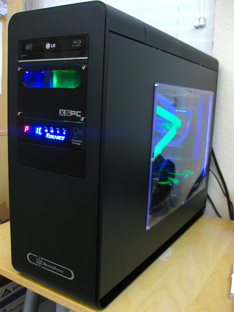

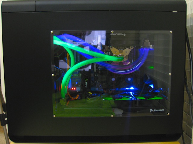

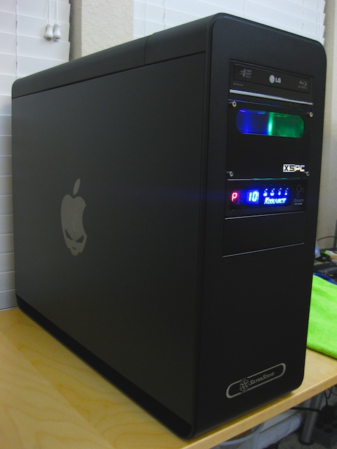

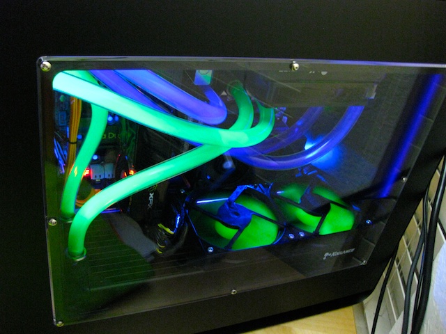

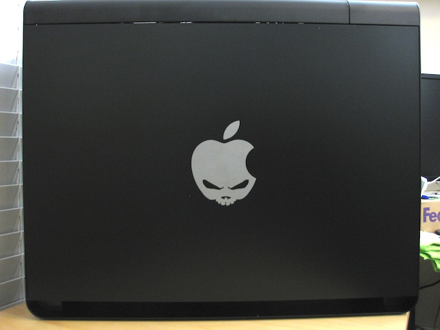

PunkNugget Posted June 23, 2011 Share Posted June 23, 2011 Hi ^Andy^ (and anyone else reading this that can contribute their thoughts), I wanted to find out something since this is my current Mak Hak Pro setup: -Silverstone Fortress FT02 Black w/window -Core i7 930 CPU Overclocked to 4.2 Ghz -Premium Gigabyte GA-X58A-UD7 Water Cooling Motherboard with additional heatsink -XSPC Dual Bay (Dual Coolant Tank) for Dual Watercooling for the Mobo and Processor. -Koolance CPU-360 water block for the CPU -Koolance HX-CU1020V High Flow 3x120mm Radiator -Tygon Tubing -Koolance fittings throughout -12GB GDDR3 1600Mhz Corsair Dominator RAM Kit (w/fan) -1x128GB SSD Mushkin Drive 285MB/S Read 255MB/Sec Write for Mac OS X -Replaced all stock Silverstone fans with their higher model Silverstone fans that create even more "positive pressure" within the tower -1x6128GB SSD Corsair Drive 220MB/S Read 200MB/Sec Write for Windows 7 -1x600GB Velociraptor for Backup and Storage -LG Blu-Ray 10X Burner and Reader -Dual-Layer DVD+/- RW Drive -XFX GTX 280 Graphics Cards -Silverstone ST1500W - 1500 Watt PSU There are few things that I just purchased to max this thing out, here they are: - Core i7 970 CPU (6 core processor) - G. Skill 24GB RAM kit - Koolance CPU-370 (New waterblock for CPU) - Koolance Dual Bay / Dual Pump Unit - Koolance Quick Disconnects I would like to now purchase the best graphics card out there that will fit within this unit (nothing over 10.5 inches in length). I've noticed that these cards have been added as workable cards and I also like them because they have OpenGL 4.2 and NOT OpenGL 3.2. I'd like to have the latest OpenGL app as I use hi-end graphic apps like Photoshop, Final Cut Pro and Apple Motion. I don't know if these apps can take advantage of either one of OpenGL versions, but I'm thinking that 4.2 would be better or at least available for future use (as I don't want to upgrade to another graphics card for at least 2 more years). Here are the three different cards. Please let me know witch one would be the best fit: 1) XFX HD-687A-ZNBC Radeon HD 6870 Black Edition 1GB 256-bit DDR5 http://www.newegg.com/Product/Product.aspx...f264900d619e3ae or this one: 2) XFX HD-687A-ZDBC Radeon HD 6870 1GB 256-bit GDDR5 http://www.newegg.com/Product/Product.aspx...N82E16814150520 (I like the double fans for a cooler run card) and the last one: 3) SAPPHIRE Vapor-X 100314VXSR Radeon HD 6870 1GB 256-bit GDDR5 http://www.newegg.com/Product/Product.aspx...N82E16814102925 Honestly I really wanted this one (since ASUS is one of the most reliable card companies out there): ASUS EAH6870/2DI2S/1GD5 Radeon HD 6870 1GB 256-bit GDDR5 http://www.newegg.com/Product/Product.aspx...96f3009b8b7b3b6 But they don't have it available anymore and the one place that does (eBay) they're going for $290 - $325 and they're overseas. I don't like taking chances purchasing anything like that overseas. Lastly, I noticed this post from a user that had problems with this card (that is similar to the first two XFX 6870 cards but a slightly different model): http://www.tonymacx86.com/viewtopic.php?f=15&t=22816 It was this card: XFX HD-687A-ZDFC Radeon HD 6870 1GB 256-bit GDDR5 Maybe his particular situation was just an unusual one. So Andy (or anybody else for that matter) PLEASE let me know what you can as some of these Newegg.com deals will be ending by the end of this month and I would like to make the best purchase as soon as possible, but the correct one also so I don't face any issues down the road. Thank you in advance for your time and help... :-) Link to comment https://www.insanelymac.com/forum/topic/250804-ati-radeon-6xxx-working-qeci/page/23/#findComment-1701991 Share on other sites More sharing options...
jpa Posted June 23, 2011 Share Posted June 23, 2011 Hi ^Andy^ (and anyone else reading this that can contribute their thoughts), I wanted to find out something since this is my current Mak Hak Pro setup: -Silverstone Fortress FT02 Black w/window -Core i7 930 CPU Overclocked to 4.2 Ghz -Premium Gigabyte GA-X58A-UD7 Water Cooling Motherboard with additional heatsink -XSPC Dual Bay (Dual Coolant Tank) for Dual Watercooling for the Mobo and Processor. -Koolance CPU-360 water block for the CPU -Koolance HX-CU1020V High Flow 3x120mm Radiator -Tygon Tubing -Koolance fittings throughout -12GB GDDR3 1600Mhz Corsair Dominator RAM Kit (w/fan) -1x128GB SSD Mushkin Drive 285MB/S Read 255MB/Sec Write for Mac OS X -Replaced all stock Silverstone fans with their higher model Silverstone fans that create even more "positive pressure" within the tower -1x6128GB SSD Corsair Drive 220MB/S Read 200MB/Sec Write for Windows 7 -1x600GB Velociraptor for Backup and Storage -LG Blu-Ray 10X Burner and Reader -Dual-Layer DVD+/- RW Drive -XFX GTX 280 Graphics Cards -Silverstone ST1500W - 1500 Watt PSU There are few things that I just purchased to max this thing out, here they are: - Core i7 970 CPU (6 core processor) - G. Skill 24GB RAM kit - Koolance Dual Bay / Dual Pump Unit - Koolance Quick Disconnects I would like to now purchase the best graphics card out there that will fit within this unit (nothing over 10.5 inches in length). I've noticed that these cards have been added as workable cards and I also like them because they have OpenGL 4.2 and NOT OpenGL 3.2. I'd like to have the latest OpenGL app as I use hi-end graphic apps like Photoshop, Final Cut Pro and Apple Motion. I don't know if these apps can take advantage of either one of OpenGL versions, but I'm thinking that 4.2 would be better or at least available for future use (as I don't want to upgrade to another graphics card for at least 2 more years). Here are the three different cards. Please let me know witch one would be the best fit: 1) XFX HD-687A-ZNBC Radeon HD 6870 Black Edition 1GB 256-bit DDR5 http://www.newegg.com/Product/Product.aspx...f264900d619e3ae or this one: 2) XFX HD-687A-ZDBC Radeon HD 6870 1GB 256-bit GDDR5 http://www.newegg.com/Product/Product.aspx...N82E16814150520 (I like the double fans for a cooler run card) and the last one: 3) SAPPHIRE Vapor-X 100314VXSR Radeon HD 6870 1GB 256-bit GDDR5 http://www.newegg.com/Product/Product.aspx...N82E16814102925 Honestly I really wanted this one (since ASUS is one of the most reliable card companies out there): ASUS EAH6870/2DI2S/1GD5 Radeon HD 6870 1GB 256-bit GDDR5 http://www.newegg.com/Product/Product.aspx...96f3009b8b7b3b6 But they don't have it available anymore and the one place that does (eBay) they're going for $290 - $325 and they're overseas. I don't like taking chances purchasing anything like that overseas. Lastly, I noticed this post from a user that had problems with this card (that is similar to the first two XFX 6870 cards but a slightly different model): http://www.tonymacx86.com/viewtopic.php?f=15&t=22816 It was this card: XFX HD-687A-ZDFC Radeon HD 6870 1GB 256-bit GDDR5 Maybe his particular situation was just an unusual one. So Andy (or anybody else for that matter) PLEASE let me know what you can as some of these Newegg.com deals will be ending by the end of this month and I would like to make the best purchase as soon as possible, but the correct one also so I don't face any issues down the road. Thank you in advance for your time and help... :-) xfx dual fan is better Link to comment https://www.insanelymac.com/forum/topic/250804-ati-radeon-6xxx-working-qeci/page/23/#findComment-1702109 Share on other sites More sharing options...
PunkNugget Posted June 23, 2011 Share Posted June 23, 2011 xfx dual fan is better I was JUST NOW PMing you. Wow that's weird. So why do you believe that the Dual fan one is better over the rest of them? I do like it, I was just curious... Actually (as mentioned before) I would like to have the card that you have (for better reliability purposes from advice from some of the admin staff on Tonymac), but I really don't want to spend $290 - $325 for that card. Plus, that card isn't available anymore (I contacted the company directly, twice, and spoke to two different reps to make sure they were not producing these anymore). Ebay's the only place selling it: http://cgi.ebay.com/New-ASUS-EAH6870-2DI2S...=item1c1822c725 http://cgi.ebay.com/ASUS-1GB-RADEON-HD-687...#ht_3381wt_1141 Also, I did go here to view compatible cards last night: http://www.tonymacx86.com/viewtopic.php?f=15&t=16152 and found the card you mentioned to purchase over the other two: List Number=39 Brand= XFX Model= HD-687A-ZDBC 1GB DDR5 aka Black Edition Dual Fan (OC) Device ID= ID=0x6738 [url="http://www.insanelymac.com/forum/topic/279450-why-insanelymac-does-not-support-tonymacx86/"]#####[/url]= 3.5.2, Extracted only ATi 1.6.32.12, Chimera 1.1 (via pacifist) Method= Chimera 1.1 (uses Andy's fix), GE=yes Framebuffer= Autodetect, so not needed, but probably duckweed MacOS= 10.6.7 Reported by= colorfuel Notes= Use OpenGL.framework from latest 10.6.7 MBP update to replace old OpenGL.framework. This corrects the brightness (gamma?) problem with Valve Games (eg. Portal 2, Half-Life 2 etc.). Here are the files: http://www.insanelymac.com/forum/index.php...p;#entry1655159 Now, from what I seeing here, it looks like this person had to jump through some hoops to get this thing working properly. I'm looking to see if I can avoid having to install all those files to get things set in place. Actually (and I didn't realize this till now) you had one this one (below) that I was asking would be the better card up there, that had some easier success rates. Here's that card: List Number=9 Brand=XFX Model=HD-687A-ZNBC Radeon HD 6870 Black Edition 1GB 256-bit DDR5 PCI Express Device ID= [url="http://www.insanelymac.com/forum/topic/279450-why-insanelymac-does-not-support-tonymacx86/"]#####[/url]= MacOS= Reported by=jpa That's the other reason why I wanted your thoughts on this... I'm just wanting to make sure that I'm getting the right card and I don't mess things up for myself with extra install modded files that might or might not work. Mind you, I just now noticed this information as I'm writing this. Something else, I just noticed this card on that approved list on that link: List Number=28 Brand=XFX Model=6870 HD-687A-ZDFC (New twin blade cooler model) Device ID=0x6738 [url="http://www.insanelymac.com/forum/topic/279450-why-insanelymac-does-not-support-tonymacx86/"]#####[/url]=3.4 & Andy's Fix MacOS=10.6.7 Reported by=MJGunn That have it here on Newegg.com (and I didn't even mention that as one of the cards to choose from): http://www.newegg.com/Product/Product.aspx...0-521-_-Product You know with the XFX 280 GTX it just worked - period. No installing any other drivers or anything else, it just worked. In fact I have two of them (just in case the one of them breaks down and stops working; so far, so good though). Again, thanks for whatever input you (or anyone else that has experience with these cards) can give. I look forward to the replies... BTW, your Avatar (someone mentioned it was scary) don't get rid of it; IT'S CREATIVE - I LIKE IT !!! Later... PNugg :-) You know what's jacked up about all this stuff. I just went on www.xfxforce.com and just found out (with some more searching) that all of the cards that I was interested in that are on Newegg.com state that they use OpenGL 4.2 but on XFX's site they all use OpenGL 3.2. I guess it doesn't matter either way because Mac OS X only uses OpenGL 2.1 - LOL !!! That's messed up... After all that work in trying to find the best 6870 card. Oh well, doesn't matter either way. I wonder if Lion will be compatible with 3.2 or 4.2? We'll see what happens... In any case I'll still be waiting on your replies here. And sorry for the extremely long post. I just like to get all the details out there so there's no back and forth of reply posts... Again, thanks for any input out there... Link to comment https://www.insanelymac.com/forum/topic/250804-ati-radeon-6xxx-working-qeci/page/23/#findComment-1702132 Share on other sites More sharing options...
