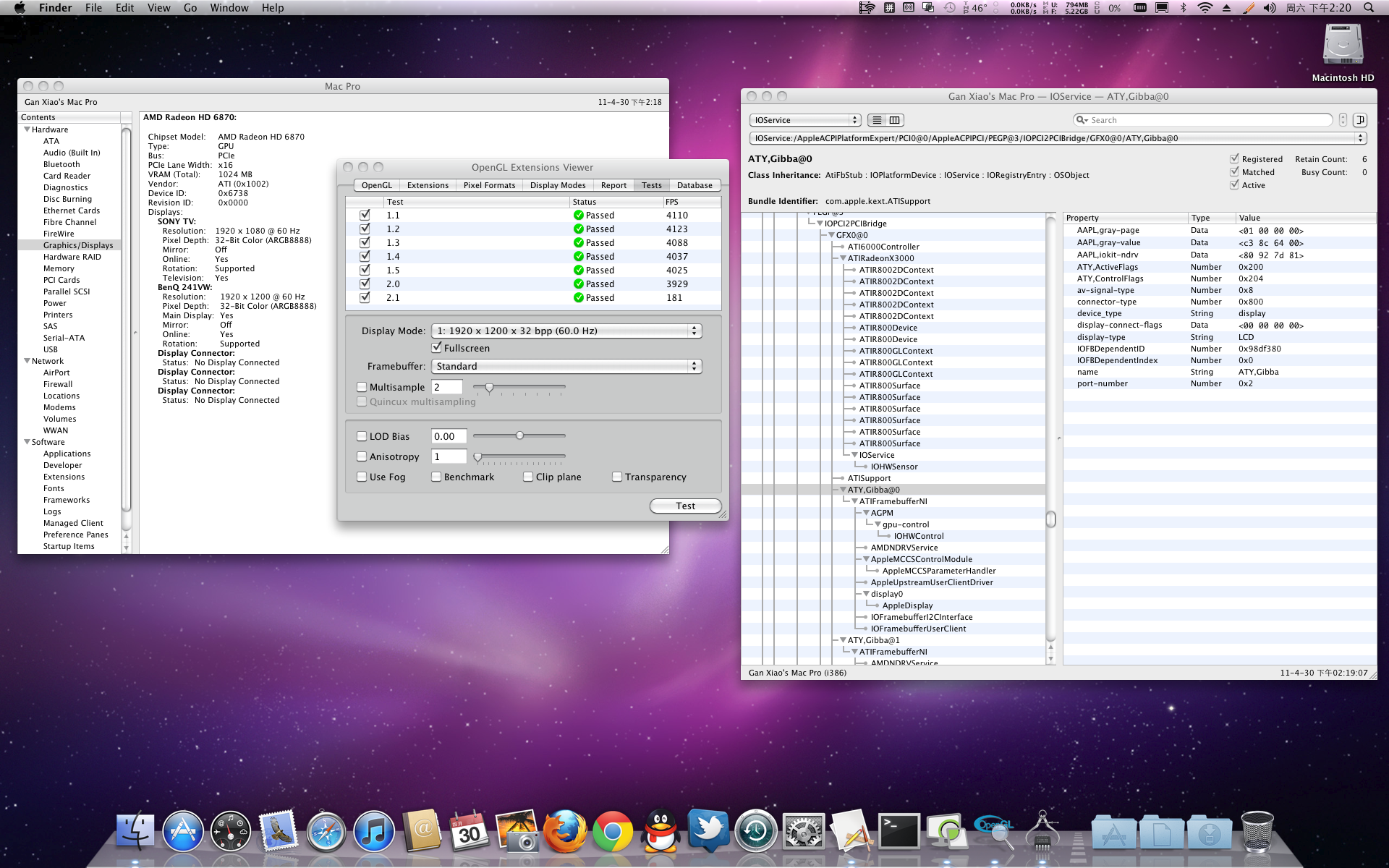

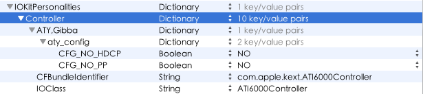

ganxiao Posted April 30, 2011 Share Posted April 30, 2011 Just a hint, people report that performance is low using framebuffer Gibba, it is caused by disabled powerplay in ATI6000Controller.kext, edit ATI6000Controller.kext/Contents/Info.plist, change CFG_NO_PP to NO, i also changed CFG_NO_HDCP to NO. change framebuffer to Gibba, example dsdt Device (GFX0) { Name (_ADR, Zero) Name (_PRW, Package (0x02) { 0x09, 0x05 }) Method (_DSM, 4, NotSerialized) { Store (Package (0x0E) { "@0,name", Buffer (0x0A) { "ATY,Gibba" }, "@1,name", Buffer (0x0A) { "ATY,Gibba" }, "@2,name", Buffer (0x0A) { "ATY,Gibba" }, "@3,name", Buffer (0x0A) { "ATY,Gibba" }, "@4,name", Buffer (0x0A) { "ATY,Gibba" }, "model", Buffer (0x13) { "AMD Radeon HD 6870" }, "hda-gfx", Buffer (0x0A) { "onboard-1" } }, Local0) DTGP (Arg0, Arg1, Arg2, Arg3, RefOf (Local0)) Return (Local0) } } i got similar performace with Gibba, compared to framebuffer Duckweed, but all 5 port displayed in system info but i still can't get HDMI audio, maybe we should use AppleHDA.kext from MBP 2011 10.6.7 UPDATES, but like Lion, AppleHDA.kext has changed a lot since new MBP 2011, there is no AppleHDAPlatformDriver.kext any more, where we configure custom LayoutID and PathMapID to get proper output. Dose anyone managed to get new AppleHDA.kext or lion vanilla AppleHDA.kext to work? Link to comment https://www.insanelymac.com/forum/topic/250804-ati-radeon-6xxx-working-qeci/page/20/#findComment-1676632 Share on other sites More sharing options...

zdravko1972 Posted April 30, 2011 Share Posted April 30, 2011 Just a hint,people report that performance is low using framebuffer Gibba, it is caused by disabled powerplay in ATI6000Controller.kext, edit ATI6000Controller.kext/Contents/Info.plist, change CFG_NO_PP to NO, i also changed CFG_NO_HDCP to NO. change framebuffer to Gibba, example dsdt Device (GFX0) { Name (_ADR, Zero) Name (_PRW, Package (0x02) { 0x09, 0x05 }) Method (_DSM, 4, NotSerialized) { Store (Package (0x0E) { "@0,name", Buffer (0x0A) { "ATY,Gibba" }, "@1,name", Buffer (0x0A) { "ATY,Gibba" }, "@2,name", Buffer (0x0A) { "ATY,Gibba" }, "@3,name", Buffer (0x0A) { "ATY,Gibba" }, "@4,name", Buffer (0x0A) { "ATY,Gibba" }, "model", Buffer (0x13) { "AMD Radeon HD 6870" }, "hda-gfx", Buffer (0x0A) { "onboard-1" } }, Local0) DTGP (Arg0, Arg1, Arg2, Arg3, RefOf (Local0)) Return (Local0) } } i got similar performace with Gibba, compared to framebuffer Duckweed, but all 5 port displayed in system info but i still can't get HDMI audio, maybe we should use AppleHDA.kext from MBP 2011 10.6.7 UPDATES, but like Lion, AppleHDA.kext has changed a lot since new MBP 2011, there is no AppleHDAPlatformDriver.kext any more, where we configure custom LayoutID and PathMapID to get proper output. Dose anyone managed to get new AppleHDA.kext or lion vanilla AppleHDA.kext to work? Ty for this Link to comment https://www.insanelymac.com/forum/topic/250804-ati-radeon-6xxx-working-qeci/page/20/#findComment-1676761 Share on other sites More sharing options...
