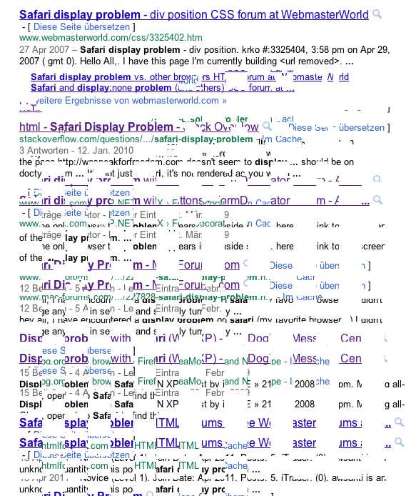

schnullimaus Posted August 1, 2011 Share Posted August 1, 2011 Hi, i have tried a Sapphire Radeon 6850 in my Q9550 Hackintosh (Gigabyte Board) and faced some issues running Lion: 1. card was autotetect with no enabler etc nessesary. I like that because it is more vanilla 2. when doing very fast scrolling in text pages (like google search results) I get a garbled screen. Scrolling slowly is fine. Problem exist in Safari and also in Preview viewing a PDF file, as well in word processing. But this problem doesn't happen in Firefox. 3. Cinebench R10 GL Benchmark is approx 6500 Points with my old nvidia 8800GT, but only 4500 Points with the ATI 6850. (it seems to be CPU limited as while running the test only one out of 4 cores has load, but that one has 100% load. Increasing the clock speed of the CPU also increases the Cinebench result) At the end the garbled screen makes it unusable for me. Anyone has the same problem or even a solution? May the card be defective? It is brand new, is and never was OC'd Thanks Stephan Link to comment https://www.insanelymac.com/forum/topic/250804-ati-radeon-6xxx-working-qeci/page/24/#findComment-1727244 Share on other sites More sharing options...

schnullimaus Posted August 2, 2011 Share Posted August 2, 2011 maybe a clarification: when scrolling in safari, only safaris window content is garbled, rest is fine. See the attached file for an example. Moving safari around on the desktop doesn't change anything, but as soon as another window overlaps safari (only a little bit is enough) safaris display returns to normal. I did exchange the card against another one of the same make and kind, and have the same probs, so i think i can rule out the 6850 card. btw, i am lucky with the fan speed. It is less lound than my MSI geforce 8800 zilent. regards, Stephan Link to comment https://www.insanelymac.com/forum/topic/250804-ati-radeon-6xxx-working-qeci/page/24/#findComment-1728420 Share on other sites More sharing options...

schnullimaus Posted August 2, 2011 Share Posted August 2, 2011 another Info: same card, same computer. but SnowLeo 10.6.8 => all looks fine So maybe I face a LION driver problem? Link to comment https://www.insanelymac.com/forum/topic/250804-ati-radeon-6xxx-working-qeci/page/24/#findComment-1728467 Share on other sites More sharing options...

schnullimaus Posted August 3, 2011 Share Posted August 3, 2011 solution found: when running on my nvidia 8800GT, i had enabled Quartz2d Extreme using the QuartzSimple tool AKA quartz debug. It has always worked like a charm for me. In LION, with the new ATI 6850 card, I had to disable Quartz2DExtreme to get rid of the screen artifacts desribed above. So I am a lucky man for now but still have to make my mind about what i loose when i cannot use Quartz2DExtreme with the 6850 card. Maybe I should go back to the nvidia card? I am not a gamer, at least not on the Hachintosh. Maybe it will be fixed / improved in the next update. regards, Stephan Link to comment https://www.insanelymac.com/forum/topic/250804-ati-radeon-6xxx-working-qeci/page/24/#findComment-1728670 Share on other sites More sharing options...

schnullimaus Posted August 8, 2011 Share Posted August 8, 2011 Hi Thireus, my artifact pattern look different. See some post above in this thread for a screenshot. It happend within the safari window on heavy scrolling. To disable Quartz2DeXtreme: Install xcode, then go to utilities (i think, right now i have no mac at hand), there is an utlity called quartz debug, i think it may be also named quartz simple, that allows you to enable or disable Quartz2DExtreme via menu in Gui. See here: http://www.insanelymac.com/forum/index.php...&pid=227749 In this thread also onsole comands for enabling / disabling are given. regards, Stephan Link to comment https://www.insanelymac.com/forum/topic/250804-ati-radeon-6xxx-working-qeci/page/24/#findComment-1731666 Share on other sites More sharing options...
