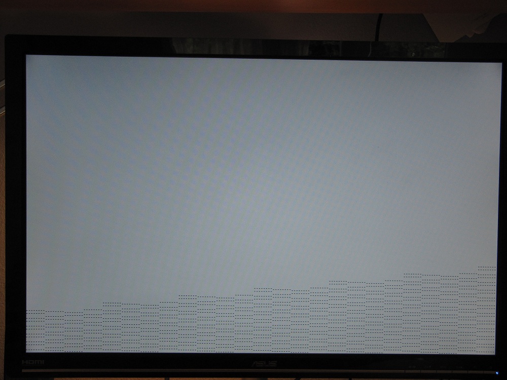

Renegade Posted June 13, 2011 Share Posted June 13, 2011 Hi, I gave it a try with my HD6950, and the result is this garbled screen Used the Kexts posted on netkas' blog, along with the ATY_init he posted. When starting in verbose mode, I get even more garbage... Link to comment https://www.insanelymac.com/forum/topic/250804-ati-radeon-6xxx-working-qeci/page/22/#findComment-1697002 Share on other sites More sharing options...

MoneyMark Posted June 14, 2011 Share Posted June 14, 2011 Hi, I gave it a try with my HD6950, and the result is this garbled screen Used the Kexts posted on netkas' blog, along with the ATY_init he posted. When starting in verbose mode, I get even more garbage... My 6950 works flawlessly now. You need to update the graphics kexts and bundles with the recently released dp4 files and delete the GL file as the directions indicate. Also, make sure you dont have a 6950 running a 6970 bios. I had to revert back to original bios to get past the white screen. You also need the modified ATY_Init kext and make sure it is being loaded. EDIT: I'm not actually positive if the bios needed to be reverted as I just noticed this on netkas' site: delete ATIRadeonX3000GLDriver.bundle, works on second boot Based on that I am not sure if it would have worked regardless of the bios being used. I'll play around with that later and report back when I have time. Link to comment https://www.insanelymac.com/forum/topic/250804-ati-radeon-6xxx-working-qeci/page/22/#findComment-1697399 Share on other sites More sharing options...
telepati Posted June 14, 2011 Share Posted June 14, 2011 My 6950 works flawlessly now. You need to update the graphics kexts and bundles with the recently released dp4 files and delete the GL file as the directions indicate. Also, make sure you dont have a 6950 running a 6970 bios. I had to revert back to original bios to get past the white screen. You also need the modified ATY_Init kext and make sure it is being loaded. I have 6950 and when I add ATY_Init S/L/E folder never accepted. Evertime I got error. How do you modified this? Link to comment https://www.insanelymac.com/forum/topic/250804-ati-radeon-6xxx-working-qeci/page/22/#findComment-1697525 Share on other sites More sharing options...
pino72 Posted June 14, 2011 Share Posted June 14, 2011 My 6950 works flawlessly now. You need to update the graphics kexts and bundles with the recently released dp4 files and delete the GL file as the directions indicate. Also, make sure you dont have a 6950 running a 6970 bios. I had to revert back to original bios to get past the white screen. You also need the modified ATY_Init kext and make sure it is being loaded. OK, is QE acceleration working? Link to comment https://www.insanelymac.com/forum/topic/250804-ati-radeon-6xxx-working-qeci/page/22/#findComment-1697608 Share on other sites More sharing options...

MoneyMark Posted June 15, 2011 Share Posted June 15, 2011 i doubt he's getting acceleration. Exactly. That is what the "delete the GL file" part meant. Removing ATIRadeonX3000GLDriver.bundle, removes the acceleration, which is reported as being unstable at this time. OK, is QE acceleration working? Sorry if that 'flawlessly' comment was misleading. For me, full 2560x1650 resolution and stability = happy man. For now, I'm back into my machine and able to use it without losing my mind. I have 6950 and when I add ATY_Init S/L/E folder never accepted. Evertime I got error. How do you modified this? I didn't have to modify anything. I dropped the kext into the extras directory and corrected the owner and perms. Other than that, I updated to the dp4 graphics kexts as well. I believe I also have graphics enabler set to no if that helps. I have 6950 and when I add ATY_Init S/L/E folder never accepted. Evertime I got error. How do you modified this? I didn't have to modify anything. I dropped the kext into the extras directory and corrected the owner and perms. Other than that, I updated to the dp4 graphics kexts as well. I believe I also have graphics enabler set to no if that helps. Link to comment https://www.insanelymac.com/forum/topic/250804-ati-radeon-6xxx-working-qeci/page/22/#findComment-1698024 Share on other sites More sharing options...
Renegade Posted June 16, 2011 Share Posted June 16, 2011 MoneyMark > are you booting in 32-bit or 64-bit ? ... and which version of Chameleon? Link to comment https://www.insanelymac.com/forum/topic/250804-ati-radeon-6xxx-working-qeci/page/22/#findComment-1698553 Share on other sites More sharing options...
