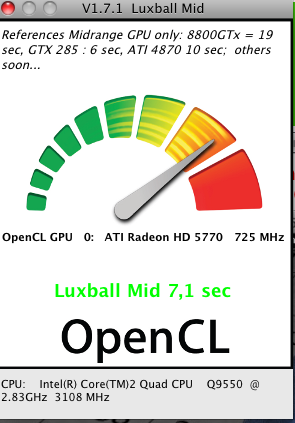

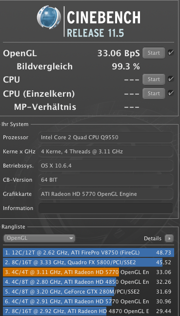

FKA Posted August 25, 2010 Share Posted August 25, 2010 Sorry for Noob post. can anyone enlighten me in short words why to use the trauma boot/vga.rom method , besides it is 64 bit ? a.I use cartris mac bios on my Gigabyte EP-45 , only 2 extensions in E/ b. Force-flashed my Sapphire HD 5770 with the best custom bios (after I tried all on techpower bios archive , besides the Hawks bios) c. DVI works , VGA works, HDMI works with HDTV TV , 1920x1200 works with correct aspect ratio. c. System is extremely stable , Geekbench benches , OpenCl and OpenGL bench scores are very fast as you can see in this thread . d. so , before I kill my running system..... where are the advantages ? Tmongkul -- Trauma ? Thanx as I get only 1 port outputting video when I use ATY_init, the HDMI port. Obviously the ATI BIOS you are using has helped you. I've not got round to trying alternative BIOS's. As the old saying goes - if it aint broken, don't fix it! D Link to comment https://www.insanelymac.com/forum/topic/205802-ati-hd-5770/page/21/#findComment-1536978 Share on other sites More sharing options...

FKA Posted August 25, 2010 Share Posted August 25, 2010 Hi FKA No problem at all with ports -- all of the biosses ( is this english :-) , I tried- had HDMI , DVI and VGA support. Only time I ran into problems , was in the early times of ATY-init , where Uakari was defined as framebuffer , this was completely wrong. Editing the kext with correct Vervet framebuffer did the trick , and all went well . Oops that was a bit noobish of me - I forgot to change the framebuffer ! the different biosses floating around behave very different : i had a hard time checking out that my new found and custom flashed XFX bios for Win 7 (0,9 V - 300/800 UVD - 850 / 1200 3D - silent fan 20%) for my HTPC , killed completely my OpenGL / OpenCL performance of my Sapphire HD 5770 under MacOS 10.6.4 .. to give you an impression : OpenGL : minus 40 % OpenCL : minus 30 % and this was a p.i.a. in semipro apps like Motion , PS and Aperture . best as and b.t.w I am in the ATI flashing business since years :-) and I never had a card thats so harmless as the HD 5770 - in fact I flashed this virgin ten times ( win7 -ATI Bioseditor v.125) with much joy. Slán leat as Good to know - I was tempted to underclock myself as I can see the fan starts to ramp up sharply at 40.C and as it's idling at 45 - 50.C I have a lot of fan noise. I may have a play around and see if I can get the temp down without blowing the performance. Any suggestions appreciated D Link to comment https://www.insanelymac.com/forum/topic/205802-ati-hd-5770/page/21/#findComment-1537133 Share on other sites More sharing options...
