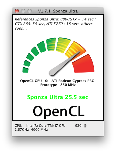

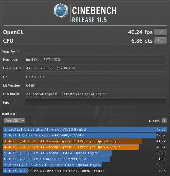

I selected the GIGABYTE GV-R585OC-1GD Radeon HD 5850 with a factory OC of 765MHz. I was concerned about it being a PCI-E 2.1 non-reference card, but the recently reduced price was hard to ignore. Very nice card. Impressive cooler.
Here's the results:
Worth noting, on Win7 with the 8.7 driver my CB result was 39.16. Win7 with the 8.762 driver: 78.95!
I'm confused as to why this is reporting 850MHz, and that my card is a prototype. Kinda cool.

Where's this custom sapphire rom at? I think it should be higher. Cinebench says I'm using 2 cores and 4 threads. Somethings fishy. 64-bit is enabled.
Congrats
to the fastest results so far with an HD 5770 :):):):)
I knew that these i Cpus @ 4 GHz will kill an old Q 9550 soon :):):)
and yes ... I think you could go even higher ....

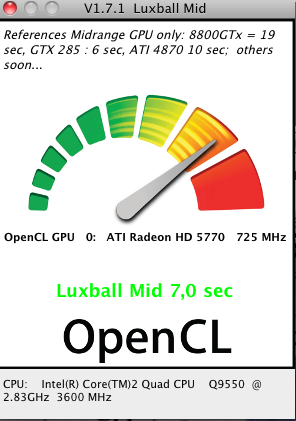

So far I couldn`t go faster than 36, 7 in Sponza
7,0 in midbench
and 38, 13 Fps in Cinebench
thats the end of the story for Quad 9550 CPUs @3,5

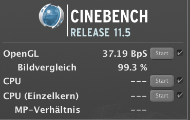

Yepp I too find you must go higher with a full i 7
got 73 fr. with a Hd 5770 * Q 9550 @ 3,5 Win 7 *catalyst 10.8

to the fastest results so far with an HD 5770 :D:(:):)
7,0 in midbench

Thats a very fine rig . The i 7 920/930 are phantastic CPUs. Look over @ macrumors . With the brandnew unboxed Macpros and an HD 5770 , they get 26 fr. in Cinebench .
Thats far away from my 38 and your 40 fr.
