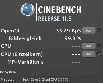

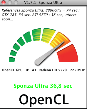

sch8mid Posted September 2, 2010 Share Posted September 2, 2010 Hey ...this is really fun in 64 bit with my aged Q 9550 Set NEW RECORD for ATI HD 5770 in smalluxgpu bench : Sponza : 36 sec. now i5 - i7 users you may easily beat it and for a 3 year old CPU this Cinebench is not shabby too at all : ___________ Link to comment https://www.insanelymac.com/forum/topic/205802-ati-hd-5770/page/25/#findComment-1541640 Share on other sites More sharing options...
