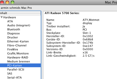

so i seem to be a complete idiot with my Cartri mac bios (Cham RC5 r168)
Whats that ???
only changed : graphic enabler to : Yes
: Kernel flag to : ><
bingo : 64 bit without any hicks .... and it flies
without any boot 7 , boot 8 , boot 9 -- without any ati rom
But : second display HDMI is not recognized any more
and profiler shows strange things under my second PCI-e slot :
motmot : a 4xxx framebuffer ?
What to do now ?

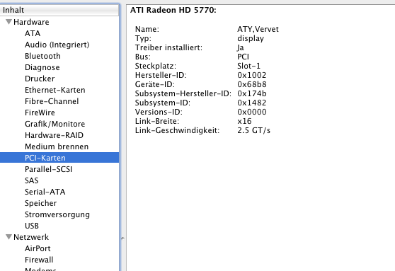

Hey,
I would thank you all in this thread!
I tried to get my new Sapphire Vapor-X OC working but every time I got a black screen and a high speed fan.
I installed with Kakewalk from Retail 10.6
updated step by step to 10.6.4 and Graphics Update
now I
add the UseAtiRom in my com.apple.boot.plist
add the 1002_68b8.rom to /Extra folder
and replace the boot with the boot9 file
that´s it!
now all works great!
Thanks a lot!
@ Trauma
Whats that ???
What to do now ?

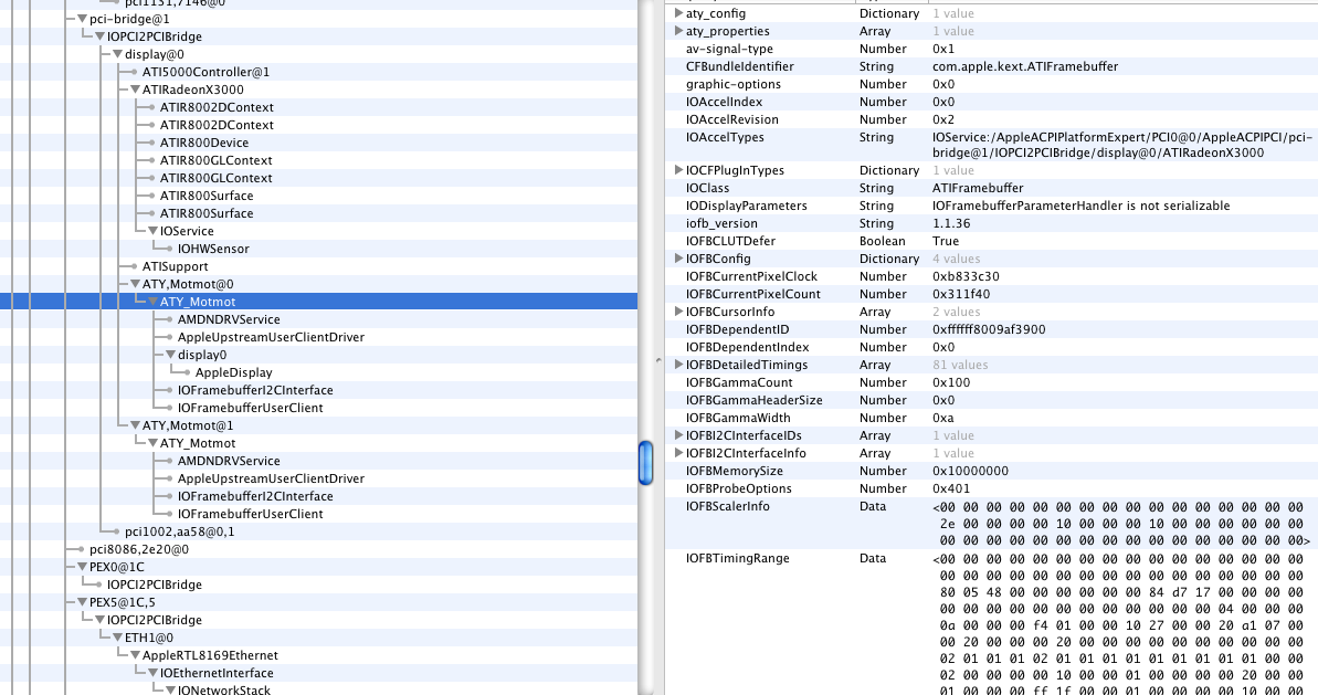

I'm not surprised about motmot frame-buffer, since most of ours HD 5xx0 was already inside. I've changed default frame-buffer and added support for third monitor, plus few specifics injections for Evergreen cards.
But i'm really surprised that this boot-loader can read your BIOS directly from the GFX. I've never changed anything in the accessROM and readAtomBIOS functions. So if this boot-loader can access and read AtomBios, then the difference is elsewhere. I also know that Cartri did modifications inside ACPI tables to favorite ATI root UID detection, but i'm not even sure it as been retained in the end. So basically we will need Balck OSX's sources to compare.
Does "my" boot-loader works fine with Cartri's BIOS ? Do you have to specify "PCIRootUID" ?

So cartris Chameleon -mod is injecting properties to IORegistry,

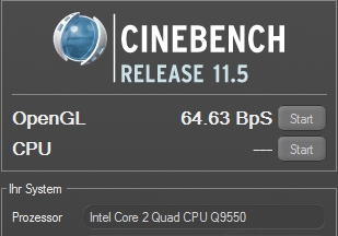

@LoLmoe
sch8mid,
I got 27-28 FPS on Cinebench 11.5
same here :
CINEBENCH 11.5 :
64bit 10.6.4
28,5 fr. @2,66
35,33fr. @ 3,1 64 bit
Win 7

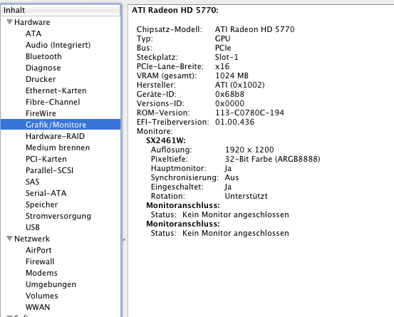

This is my Card
Well last time I remember you saying you didn't need a ROM, then you need it. So I have a hard time choosing which one to take as your output.
As for booting without DSDT, and BIOS, it did the same thing still and does the 100% fan + black screen
