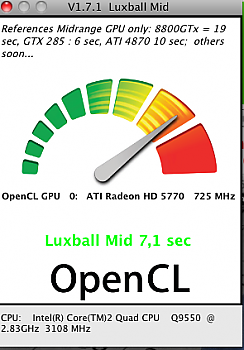

this is with my old Quad 9550 @ 3 GHz :

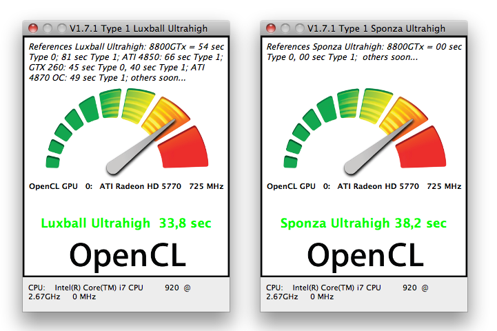

Slower then yours, on my Core i7 computer i get: 46,7 sec for Luxball Ultra
and for Luxball Mid 9.3 seconds.

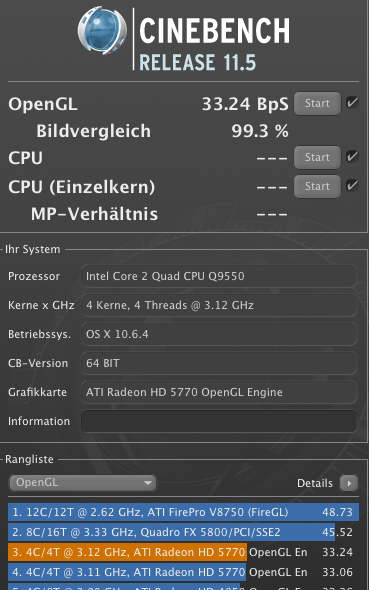

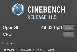

you may try to look at your OPENGL performance with Cinebench 11.5 as well (very usefull)
you have to see 30-36 fr. with your rig. You may post it here in this thread.
http://www.maxon.net/de/downloads/download...ebench-115.html
As a reference point again :Quad 9550@3 GHz - stock ATi HD 5770 Sapphire (custom bios )

Results in CineBench depend on CPU speed as well
Your CPU and speed ? Let us see a screenshot ;)
The >33 fps I posted as reference point
was measured with an : Intel Quad 9550 ES @3 Ghz
i CPUs and new AMD Phenoms OC are faster

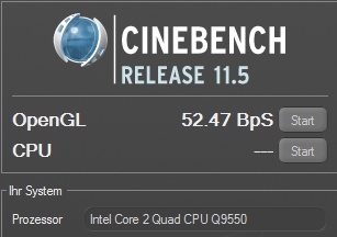

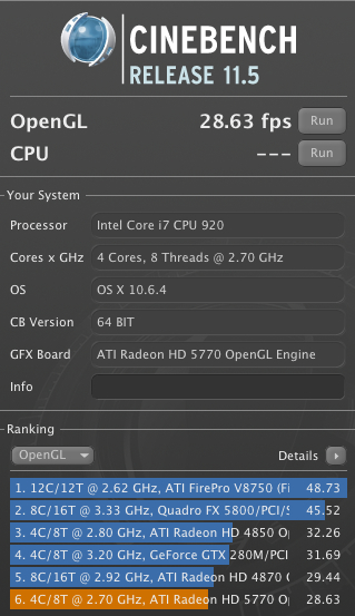

28.63 fps, I'm under the 33-36 ;)
Again: Chameleon RC4 normal version, Only Aty_Init with Graph.EN = No
And the ati kexts from netkas.
BTW. i have the Sapphire 5770 1gb, and it looks like:
http://www.vgadownload.com/wp-content/uplo...eon-HD-5770.jpg
28,63 fr. looks quite normal, though a little bit on the week side
and exactly what I wrote above : I got about 8 % loss in framerate....

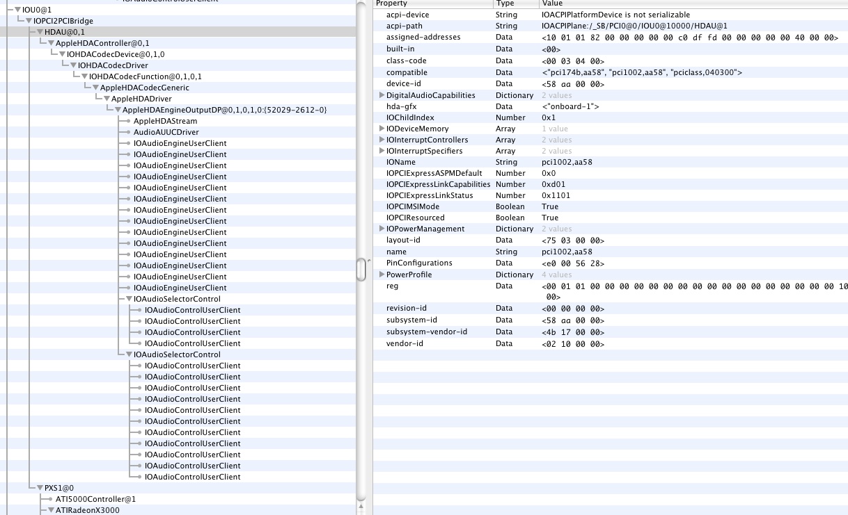

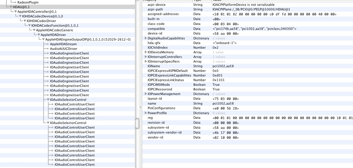

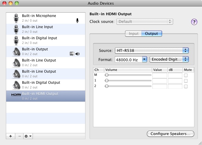

I bought Sapphire vapor-x HD 5770 1GB and tested it with OS X 10.6.4 today. I tried to find this Sapphire HD 5770 but it's not available at local stores. So, I got vapor-x one. PN 288-1E147-301SA, SKU# 11163-05-41R. I saw a new version of vapor-x HD 5770, its PCB is different from the one I got. I have no idea whether native HDMI audio is working on such OS X 10.6.4 or not. So, I listed PN and SKU#.

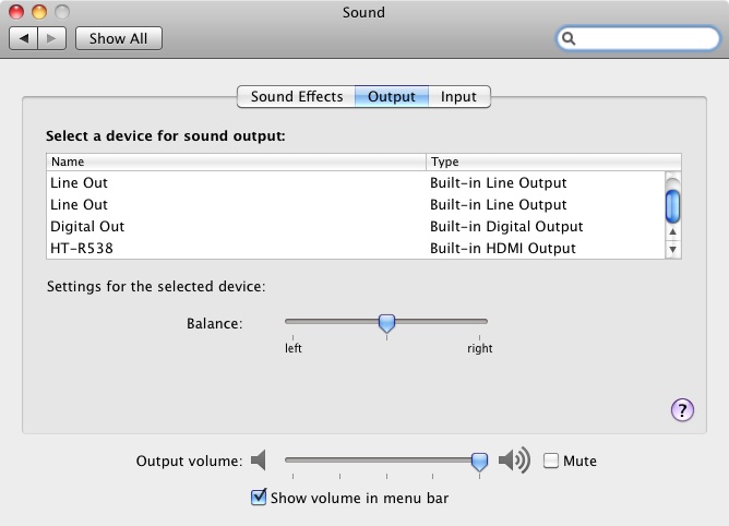

I got native HDMI working as extended monitor and got HDMI audio thru native HDMI port. Connecting ATI DVI2HDMI adaptor to both DVI ports had no HDMI audio. I also tested my new vapor-x one under Windows 7. Connecting ATI DVI2ATI adaptor to DVI ports got no HDMI audio device. Connecting to native HDMI and DisplayPort via DP2miniDP cable plus miniDP2HDMI got HDMI audio device. Finally, I think it is about how to design graphic cards. P.S. At startup, fan speed's full for a few minutes after that it went to normal. I will try to use 1002_68b8.rom later.
In contrast, I tested Gigabyte HD 5770 (batman) (sold) and I got native HDMI working as mirror and got no audio thru HDMI (but under Windows 7 got sound thru every port).
Added to DSDT, got to do it yourself.
           Device (PEGP)
               Name (_ADR, 0x00010000)        <------ it depends on each mother board.
               Name (_PRW, Package (0x02)
                   0x09,
                   0x05
               Device (GFX0)
                   Name (_ADR, Zero)
                       Store (Package (0x02)
                               "hda-gfx",
                               Buffer (0x0A)
                                   "onboard-1"
                           }, Local0)
                       Return (Local0)
               Device (HDAU)
                   Name (_ADR, One)
                               "hda-gfx",
                               Buffer (0x0A)
                                   "onboard-1"
                           }, Local0)
                       Return (Local0)
Got sound assertions, I will try to find out when I have a time.
Aug 29 19:45:07 Mac-Pro kernel[0]: Sound assertion "( cyclicBufMemoryDescriptor->getCapacity() * 2 ) > mDspFuncManager->getBufferSizeForFuncs()" failed in "/SourceCache/AppleHDA/AppleHDA-187.4.1/AppleHDA/AppleHDAEngine.cpp" at line 2374 goto Exit
Edited: using AppleHDA.kext version 1.8.9f1, this error's gone.
Got these after using DVD Player
Aug 29 19:46:25 Mac-Pro kernel[0]: Sound assertion "0 != result" failed in "/SourceCache/AppleHDA/AppleHDA-187.4.1/AppleHDA/AppleHDAWidget.cpp" at line 3891 goto handler
Aug 29 19:46:55: --- last message repeated 2 times ---
Aug 29 19:46:55 Mac-Pro kernel[0]: Sound assertion "0 != result" failed in "/SourceCache/AppleHDA/AppleHDA-187.4.1/AppleHDA/AppleHDAWidget.cpp" at line 3891 goto handler
Aug 29 19:47:30: --- last message repeated 1 time ---
Edited: still got sound assertion after opening DVDPlayer.  It is possible to be software issue.
Aug 31 23:20:42 Mac-Pro kernel[0]: Sound assertion "0 != result" failed in "/SourceCache/AppleHDA/AppleHDA-189.4.1/AppleHDA/AppleHDAWidget.cpp" at line 3891 goto handler
Edited:
P.S. I think why some could not get HD 5770 working properly while they're using "boot" to run at 64 bit because graphic card bus address's not 0x00010000. So, they got to add 1002_68b8.rom into /Extra since boot could not get bin image from such 0x0003000 even though there is DSDT.aml in /Extra, for example. Need talent people, like trauma! and netkas to fix this problem.
