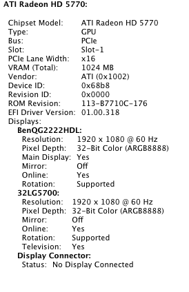

Common Sense Posted August 18, 2010 Share Posted August 18, 2010 I bought a Sapphire Radeon 5770 1 GB in a locale store in Hong Kong, The box says 1 GB and the sticker on the card also says 1 GB but the opencl info program found on this site says its 512 MB. Have I got ripped off or is it detecting wrong? Also it detects the clock frequency as 725 Mhz instead of 850 Mhz. What do you think, have they ripped me off? Any advice would be appriciated. EDIT: To make my card work in OS X i copied the DSDT with the bin image from FormerlyKnownAs, everything seems to be working great except that I can only see 512 mb. Link to comment https://www.insanelymac.com/forum/topic/205802-ati-hd-5770/page/16/#findComment-1532577 Share on other sites More sharing options...
FKA Posted August 18, 2010 Share Posted August 18, 2010 I bought a Sapphire Radeon 5770 1 GB in a locale store in Hong Kong, The box says 1 GB and the sticker on the card also says 1 GB but the opencl info program found on this site says its 512 MB. Have I got ripped off or is it detecting wrong? Also it detects the clock frequency as 725 Mhz instead of 850 Mhz. What do you think, have they ripped me off? Any advice would be appriciated. EDIT: To make my card work in OS X i copied the DSDT with the bin image from FormerlyKnownAs, everything seems to be working great except that I can only see 512 mb. I'm thinking its the software as i get the same results for my XFX [Device 0] Name: ATI Radeon HD 5770 Vendor: AMD Type: GPU Device Version: OpenCL 1.0 Driver Version: 1.0 Compute Units: 10 Work Group Size: 1024 Clock: 725 MHz Global Memory: 512 MB Local Memory: 32 KB Cache Size: 0 KB Cache Line Size: 0 Bytes Available: Yes Double-Precision: No Extensions: cl_APPLE_gl_sharing D Link to comment https://www.insanelymac.com/forum/topic/205802-ati-hd-5770/page/16/#findComment-1532652 Share on other sites More sharing options...
Common Sense Posted August 18, 2010 Share Posted August 18, 2010 I'm thinking its the software as i get the same results for my XFX [Device 0] Name: ATI Radeon HD 5770 Vendor: AMD Type: GPU Device Version: OpenCL 1.0 Driver Version: 1.0 Compute Units: 10 Work Group Size: 1024 Clock: 725 MHz Global Memory: 512 MB Local Memory: 32 KB Cache Size: 0 KB Cache Line Size: 0 Bytes Available: Yes Double-Precision: No Extensions: cl_APPLE_gl_sharing D Thanks for checking. So it seems OpenCL framework might have some problems? Also the OpenCL performance is really bad for me. Audio is not working for me either, only shows up in System profiler but not in sound preferences. And then there is the underclocking to 725 mhz. Still a little work but hopefully it will work soon Link to comment https://www.insanelymac.com/forum/topic/205802-ati-hd-5770/page/16/#findComment-1532662 Share on other sites More sharing options...
jonny1010 Posted August 18, 2010 Share Posted August 18, 2010 I'm thinking its the software as i get the same results for my XFX [Device 0] Name: ATI Radeon HD 5770 Vendor: AMD Type: GPU Device Version: OpenCL 1.0 Driver Version: 1.0 Compute Units: 10 Work Group Size: 1024 Clock: 725 MHz Global Memory: 512 MB Local Memory: 32 KB Cache Size: 0 KB Cache Line Size: 0 Bytes Available: Yes Double-Precision: No Extensions: cl_APPLE_gl_sharing D Hi, can you up your bin image from macpro for hd5770? And your dsdt with all code also for 3 screen in mirror and hdmi sound? Thanks so much Link to comment https://www.insanelymac.com/forum/topic/205802-ati-hd-5770/page/16/#findComment-1532704 Share on other sites More sharing options...

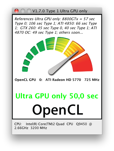

sch8mid Posted August 18, 2010 Share Posted August 18, 2010 Thanks for checking. So it seems OpenCL framework might have some problems? Also the OpenCL performance is really bad for me. OpenCL performance poor ? Link to comment https://www.insanelymac.com/forum/topic/205802-ati-hd-5770/page/16/#findComment-1532720 Share on other sites More sharing options...
Common Sense Posted August 18, 2010 Share Posted August 18, 2010 OpenCL performance poor ? I take it back, It seems fine, I get 50 seconds which is just 1 second more then the 4870 OC. Generally 5770 is around same speed as 4870. But I cannot get the results you get, maybe version 1.71 is much more optimized then 1.70? I really cannot understand why your results are so much better. Link to comment https://www.insanelymac.com/forum/topic/205802-ati-hd-5770/page/16/#findComment-1532747 Share on other sites More sharing options...

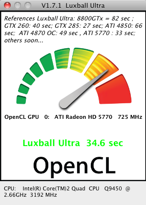

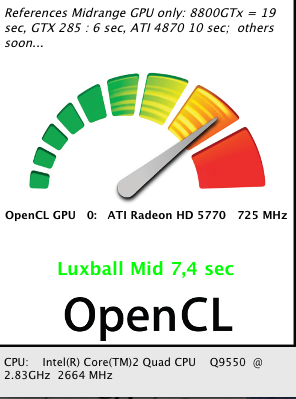

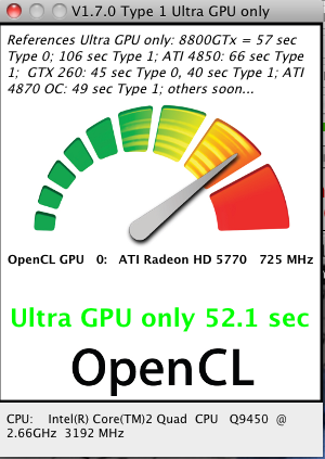

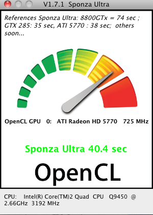

sch8mid Posted August 18, 2010 Share Posted August 18, 2010 I take it back, It seems fine, I get 50 seconds which is just 1 second more then the 4870 OC. Generally 5770 is around same speed as 4870. But I cannot get the results you get, maybe version 1.71 is much more optimized then 1.70? I really cannot understand why your results are so much better. yes you may try v.1.7.1 its optimized (but as I remember the difference is not so high..) To check , if your HD 5770 is working correctly with Open CL: dl: http://rapidshare.com/files/410151278/smallluxGPU171_V3.zip you may post the midrange -ultra -and sponza benches here (the last bench "instances" does not work on ati gpus and reverts to cpu mode.) To check if your HD 5770 is working correctly with Open GL : you may try as well cinebench 11.5 to check if you have updated frameworks if you have a pretty fast cpu (I am still on a slow Q9550 downclocked to 2,6 ) you may have much better results in cinebech (>40 fr.) than me (I got 28 fr.) (The underclock (725 MHz for HD 5770) is a bug in the opencl driver ) These are standard results of a stock ATI 5770 Sapphire (higher clocked Vapor X version is slightly faster) : *As this OpenCL bench is not CPU-dependent , if your results differ more than a few second from the results above something is wrong with your config. best armin Link to comment https://www.insanelymac.com/forum/topic/205802-ati-hd-5770/page/16/#findComment-1532806 Share on other sites More sharing options...

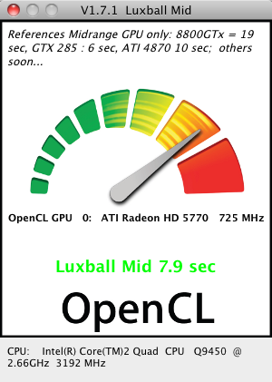

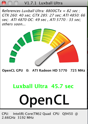

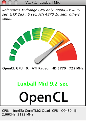

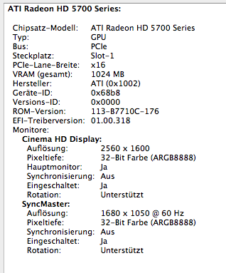

FKA Posted August 19, 2010 Share Posted August 19, 2010 With Traumas' mod'd ati.c and GraphicsEnabler=yes Using Tmongkols' DSDT for 3 monitors with bin image !D Link to comment https://www.insanelymac.com/forum/topic/205802-ati-hd-5770/page/16/#findComment-1533155 Share on other sites More sharing options...

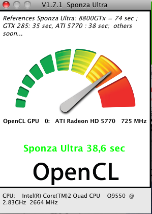

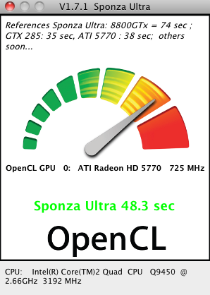

sch8mid Posted August 19, 2010 Share Posted August 19, 2010 Hmmm! first one is a little bit on the weak side, but nothing to worry about it did you optimize your bios ? the results of this open cl bench are rather cpu independent but it likes fast - highclocked RAM with tough timings and high FSB. best armin Link to comment https://www.insanelymac.com/forum/topic/205802-ati-hd-5770/page/16/#findComment-1533189 Share on other sites More sharing options...
FKA Posted August 19, 2010 Share Posted August 19, 2010 first one is a little bit on the weak side, but nothing to worry about itdid you optimize your bios ? the results of this open cl bench are rather cpu indipendent but it likes fast - highclocked RAM with tough timings and high FSB. best armin Hi sch8mid No my RAM is far from tuned at the moment. current 6, 7, 7, 24 @500MHz native i think is 7, 7, 7,24 @533 @1.8v I know i can get those timings down @500MHz fsb is @ 400MHz x8 multi at max Fid Vid This is still on my todo list! Cheers D Link to comment https://www.insanelymac.com/forum/topic/205802-ati-hd-5770/page/16/#findComment-1533202 Share on other sites More sharing options...
sch8mid Posted August 19, 2010 Share Posted August 19, 2010 hi FKAs I use 5-5-5-15 @1066 subs: 52-3-6-4-3 @ 2,15 V :-) and Performance level 8 ..this gave me one additional frame in cinebench and half a second in CL over SPD : 6-6-6-18 I am on 6x 450 FSB a.t.m , but the EP-45 has no problems with > 500 ___- Tmongkols' DSDT for 3 monitors ? where ? in this thread ? EDIT : found it he is a genius I use cartris mac bios , so I have not to deal with DSDT ... which is i confess frankly way over my head Link to comment https://www.insanelymac.com/forum/topic/205802-ati-hd-5770/page/16/#findComment-1533205 Share on other sites More sharing options...
