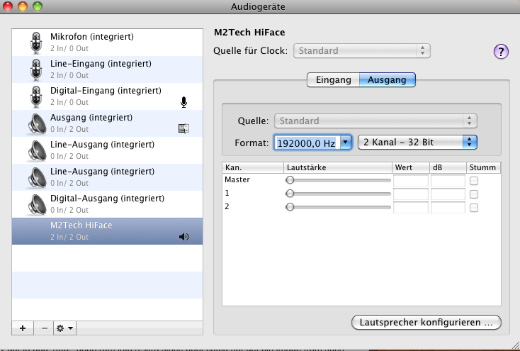

concerning > 24bit / 96 /192 KHz (over SPDIF) to get hi-res audio ...
never got it to work (think its an Apple limitation -my 2009 PB is 24/96 only)
workaround : M2Tech HiFace interface (100$) over USB (mac_driver) ...worked like a charm with all resolutions up
to 32bit/192KHz - sounds phenomenous (no intention to deal with this crappy realtek hdmi audio)

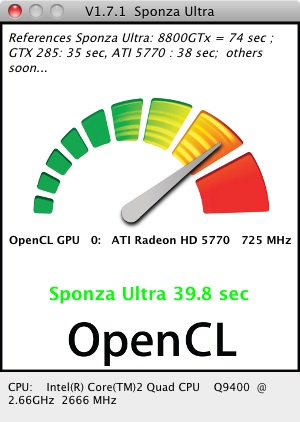

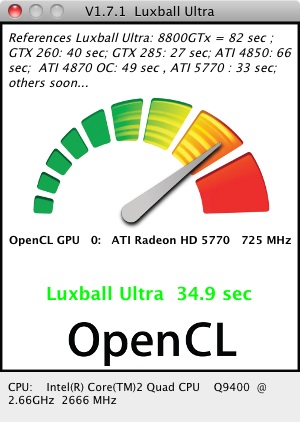

Would you mind testing (as you use a very clean dsdt) your rig
with smallluxgpu ?
I use the Sapphire Rev.3 you searched above
(works with all resolutions and HDMI on second monitor)
see :
http://www.insanelymac.com/forum/index.php...t&p=1538787
you will see speed results in OpenCL and OpenGL there

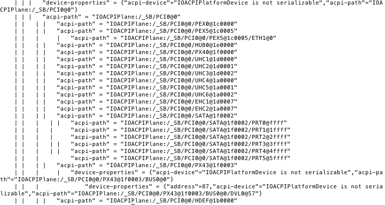

I bought Sapphire vapor-x HD 5770 1GB and tested it with OS X 10.6.4 today. I tried to find [P.S. I think why some could not get HD 5770 working properly while they're using "boot" to run at 64 bit because graphic card bus address's not 0x00010000. So, they got to add 1002_68b8.rom into /Extra since boot could not get bin image from such 0x0003000, for example. Need talent people, like trauma! and netkas to fix this problem.
In my case GFX is @ 0x0003000, and i need a ROM file. We will need people to report there addresses and if they need to use a ROM file or not.
ati.c use the same pci call to find the device and build device properties path, it's seems to work fine, but let see if the address is the problem.
Using ioreg output from this command should bring us the requiered information:
ioreg -lw0 | grep acpi-path
In my case :
 | | |   "device-properties" = {"acpi-device"="IOACPIPlatformDevice is not serializable","acpi-path"="IOACPIPlane:/_SB/PCI0@0"}
| | |   "acpi-path" = "IOACPIPlane:/_SB/PCI0@0"

these results are quite good if you use a non OC Q 9400 .
i used a Q9550 @3 Ghz for my measurements
in fact there are people with the netkas ati.rom posted here
and i 7 cpus
who get results in the 50 sec. range with ultragpu bench
thats 30 % worse as you measured.

TOOK THE RENDER TESTS:
7.2 - Mid
34.6 - Ultra
38.2 - Sponza Ultra
But it said 725MHz on the GPU, neither my core or mem is supposed to be that. other XFX rom says the same.
7.2 - Mid
34.6 - Ultra
38.2 - Sponza Ultra
edit2: I thought the other ROM was fine so I kept it, but with that ROM i had a white/gray screen with dark gray vertical lines (evenly)... then i restarted, happened again 2 times. I revertd back to the old rom.. hope it didn't do any permanent damage.
very good bench results.. just about the same as me ..and best so far ..What CPU ?
did you compare if there are small speed variations between 32bit and 64 bit ?
reported 725 Mhz is a known bug in Apple OpenCl drivers ( Mitch )

About the IOREG output i've asked you: unfortunately i'm not able to determine what's the adress of your card in all cases. The simplest would be that you post your full ioreg output here, and tell us if you need or not to use a ROM file. I guess nearly everyone need the rom for the moment.
Cheers.
Cheers.

For my Gigabyte GA-H55M-UD2H + Gigabyte 5770. Using boot9 + ROM. According to gfxutil this the address should be 0x010000. The ioreg did not show it correctly.
gfxutil -f display
DevicePath = PciRoot(0x1)/Pci(0x1,0x0)/Pci(0x0,0x0)
Ok so as I thought, the problem is not related to the device path. ;) Thanks for this output.

haha will do! i am using a i3 540 cpu with 4gb of corsair dhx xms3 ram 1333mhz. (2x2).
you know, I haven't done 32-bit vs 64-bit. I'll do that now! I haven't flashed the card once and can't since I can't install Windows until my DVD Drive gets here. (I pried open an Xbox to install OS X LOL, but apparently it can't read DVD-R)
OK got the results.
32-bit:
7.2 -> 34.6 -> 38.3
64-bit:
7.2 -> 33.6 -> 38
