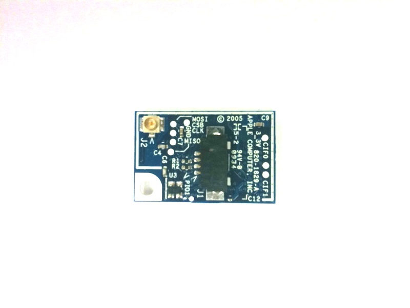

Yes, very expensive, you can get macbook or imac bluetooth modules on ebay for a few dollars. The problem is that these modules run on 3.3v instead of 5v. I have been searching for a DC regulator that will step down 5v from USB to 3.3v so I can use one of these in my "Mac Pro"
I think I finally found what I was looking for... Once I get it, I will post exactly how I did it and how it worked out.
DC-DC Converter Module Regulator
Check out the post here for the way macaddictcr integrated the Apple BT module...
Interesting. I never thought of a USB hub.
A while ago, I did buy what I thought was a 5v to 3.3v regulator. Once I got it, i hooked it up and it did not work. After fiddling around with it, I found out that the minimum input voltage was 7v not 5v like I need (you need to drop down the 5v usb to 3.3 cause the usb is powered even when the computer is asleep). I hooked up the regulator again to a 12v source, and I got 3.3v out of it with no problem, and the Macbook bluetooth module I connected worked perfectly, except when it went to sleep (cause the power got cut to it).
I then put this idea aside, and tried with a legacy bluetooth kext and the original Targus USB BT adapter, works great, wake from sleep works, but the computer won't auto sleep. I tired an autosleep script from the forum, and it did go to sleep, but after say 5 min or so, when you tried to wake it again. I found that the computer was shutdown.
Determined to get this working like a real Mac, I finally found that 5v to 3.3v regulator on ebay for around $5.00 USD. I figured for 5 bucks it's worth trying again. If it will drop 5v usb to 3.3v, then I am positive the Macbook bluetooth module will work. I feel I am so close to a permanent hassle free solution.
I will post my results, and if I am successful I will do a detailed easy to follow how to with full parts list and close up pictures etc.

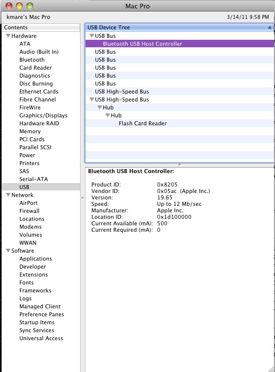

Spent today experimenting with a same/similar macbook pro BT module (attached). It works fine using 5V off a USB hub, it does not work for some reason off a USB header. This is definitely the way to go as these modules are available for cheap off ebay
Update: March 14 - Genuine usb is wired up to MB USB header. I put 2xdiodes in series at the 5V to drop the voltage more or less down to 3.6V volts, close enough for me. Full sleep support, full magic mouse support. Screen shot of profiler attached
