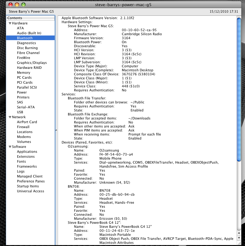

D-an-W Posted December 15, 2010 Share Posted December 15, 2010 @flakmonkey Can you post the information in System Profiler so I can see if it differs from the dongles I have already? Link to comment https://www.insanelymac.com/forum/topic/193272-apple-magic-mouse-osx86-external-bluetooth-dongle/page/14/#findComment-1602845 Share on other sites More sharing options...
flakmonkey Posted December 15, 2010 Share Posted December 15, 2010 @flakmonkey Can you post the information in System Profiler so I can see if it differs from the dongles I have already? Here's a screenshot from the G5 it's currently plugged into Hope that helps Link to comment https://www.insanelymac.com/forum/topic/193272-apple-magic-mouse-osx86-external-bluetooth-dongle/page/14/#findComment-1602857 Share on other sites More sharing options...
D-an-W Posted December 15, 2010 Share Posted December 15, 2010 Thanks, the best one I have tried so far is the D-Link DBT-120. Sleep works fine (Even with Trackpad turned on), to wake I have to use the power button but everything works once it comes back on. Link to comment https://www.insanelymac.com/forum/topic/193272-apple-magic-mouse-osx86-external-bluetooth-dongle/page/14/#findComment-1602864 Share on other sites More sharing options...
