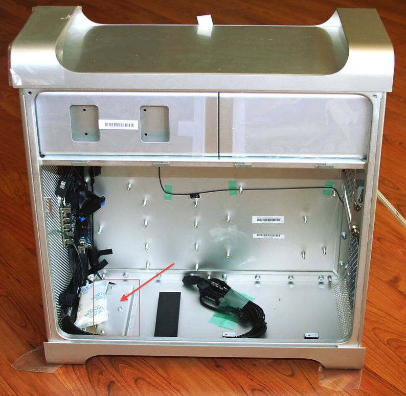

henrygale Posted May 31, 2011 Share Posted May 31, 2011 Hi Swhay, thanks for the guide! I have a PowerMac G5 case for my hackintosh and was wondering if I would have the same problem you did with your Mac Pro case? I don't really understand what you did to get it to work..do you think you can take some pictures or make a diagram? Thanks!! Link to comment https://www.insanelymac.com/forum/topic/193272-apple-magic-mouse-osx86-external-bluetooth-dongle/page/17/#findComment-1691158 Share on other sites More sharing options...
Swhay Posted June 1, 2011 Share Posted June 1, 2011 Hi Swhay, thanks for the guide! I have a PowerMac G5 case for my hackintosh and was wondering if I would have the same problem you did with your Mac Pro case? I don't really understand what you did to get it to work..do you think you can take some pictures or make a diagram? Thanks!! In the bottom of the Mac Pro case (2009 and later), there is a built in antenna for Airport with three wires coming from it. There is also a wire coming from the back of the case along the back of the 4 open expansion card slots, that cable is labeled BT for Bluetooth. It's a known issue with the Mac Pro case and Bluetooth not working right, the solution is to use one of the AirPort antenna wires for Bluetooth. That's what the note at the end of my tutorial is saying. See picture below. In your case since you have a G5 Powermac case, there is no Airport antenna built into the bottom of the case. I did a search and found this site, which might help you. Basically you need an external Bluetooth antenna for your case, I think the thickness of the aluminum cases interfere with the Bluetooth signal. Adding Bluetooh to the Apple PowerMac G5 here is another example of how to fix it, this may work good for you since you don't have the Airport antenna anyway in a G5 case. It shows how to use an external wireless card antenna. Mac Pro 2009 Bluetooth Fix Link to comment https://www.insanelymac.com/forum/topic/193272-apple-magic-mouse-osx86-external-bluetooth-dongle/page/17/#findComment-1691253 Share on other sites More sharing options...
henrygale Posted June 1, 2011 Share Posted June 1, 2011 here is another example of how to fix it, this may work good for you since you don't have the Airport antenna anyway in a G5 case. It shows how to use an external wireless card antenna. Mac Pro 2009 Bluetooth Fix Thanks, I understand what you did now! I'll try using the wifi card antenna method, as I already have one left over and a cable from making a homemade Airport card Link to comment https://www.insanelymac.com/forum/topic/193272-apple-magic-mouse-osx86-external-bluetooth-dongle/page/17/#findComment-1691314 Share on other sites More sharing options...
