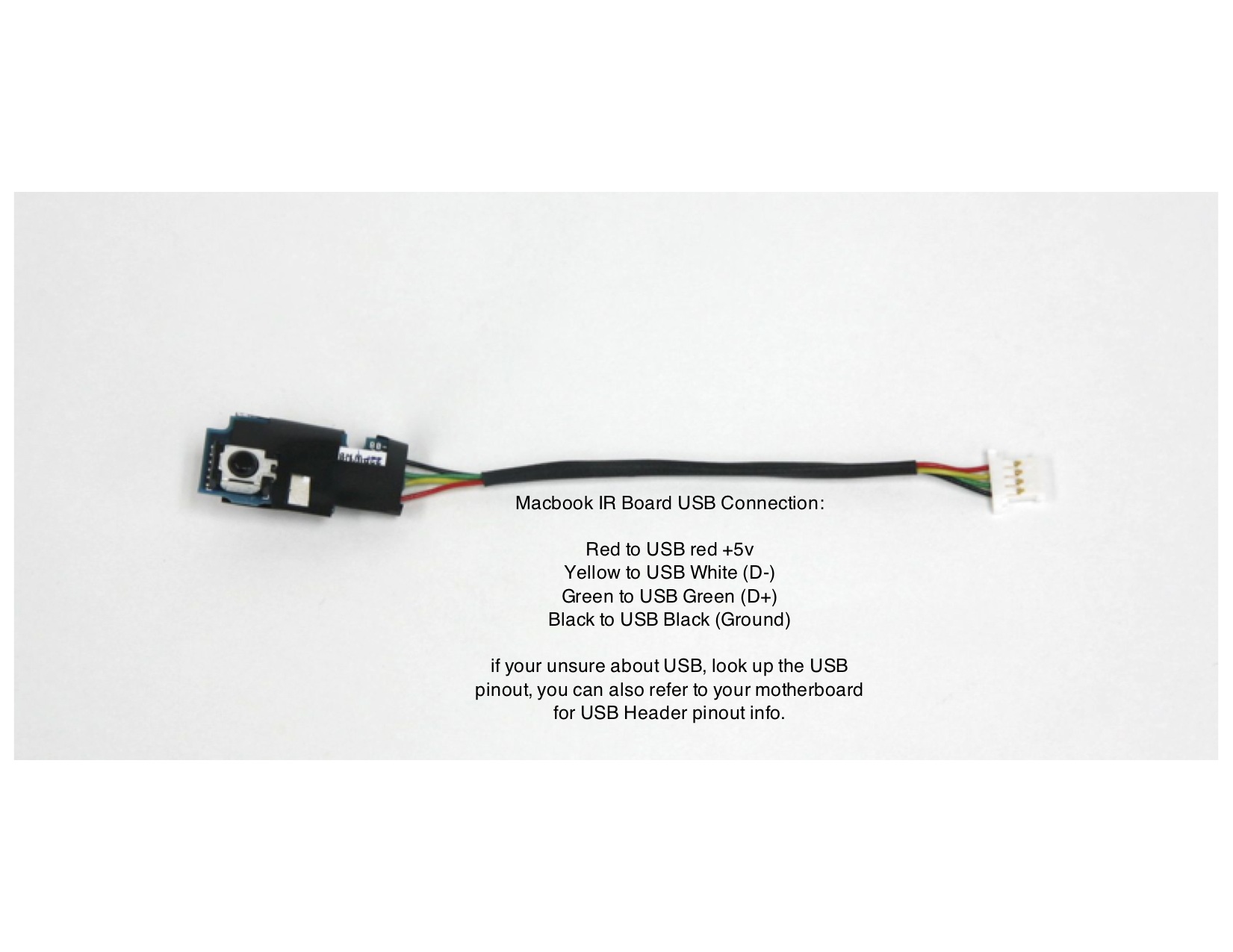

I also ordered a Macbook Pro IR (Infrared Receiver) I hooked it up to a USB cable I had and it works PERFECTLY. So I now have IR for my "Mac Pro"
I am reporting this cause I am fairly confident about the fact that the Macbook Bluetooth board was bad right from the start. It also makes me confident about buying another one and trying it again.
I'll be searching ebay for a reasonably priced one and i will be trying it again.

Here is the pinout and closeup picture of the Macbook Pro IR board for those who are interested.

Edit 08/28/2010:
Thats very interesting, can you post a couple of pictures? Is the pinout the same in both boards? Would be nice if you can post the schematics to make the cable too. Thanks!
Yes, it's quite simple really. It is standard USB 4 wire. I would highly recommend getting an IR board that already has the wire with it as the connector is really small and hard to work with without wires.
I'll post some pictures and schematic in a day or two.

Actually the wires are soldered on the IR board there is no connector on the board side.

Hi there!
I posted some months ago a link with step by step guide to get this working. Here it is...
http://photos.pottebaum.com/gallery/7075206_LwKc4
I have it working flawlessly on my hack, with the aluminium remote.
P.S: I'm very interested on doing the same thing with the BT board... hope the guy above gets it.
