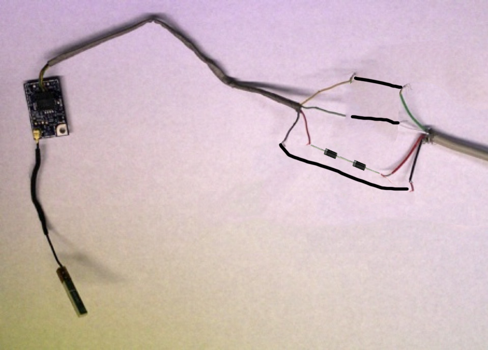

kmare Posted March 26, 2011 Share Posted March 26, 2011 Guys, you can also use 2x1N4001 diodes in series with the 5V UBS power to get the voltage down to ~3.6V or so. Working for me (see sig) Link to comment https://www.insanelymac.com/forum/topic/193272-apple-magic-mouse-osx86-external-bluetooth-dongle/page/16/#findComment-1661399 Share on other sites More sharing options...
D-an-W Posted March 27, 2011 Share Posted March 27, 2011 kmare, did you knock up a wiring diagram at any point? Link to comment https://www.insanelymac.com/forum/topic/193272-apple-magic-mouse-osx86-external-bluetooth-dongle/page/16/#findComment-1661536 Share on other sites More sharing options...

kmare Posted March 31, 2011 Share Posted March 31, 2011 Had a few PMs so here is the wiring instructions for diode method.. Thanks to Swhay for his original diagram Yes the green and yellow wires between the Apple and USB cable do cross over Link to comment https://www.insanelymac.com/forum/topic/193272-apple-magic-mouse-osx86-external-bluetooth-dongle/page/16/#findComment-1663470 Share on other sites More sharing options...

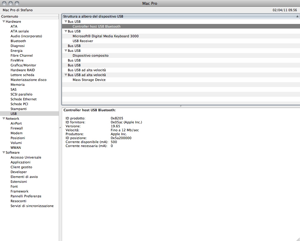

stefano.85 Posted April 2, 2011 Share Posted April 2, 2011 Had a few PMs so here is the wiring instructions for diode method.. Thanks to Swhay for his original diagram Yes the green and yellow wires between the Apple and USB cable do cross over Hi Kmare, i've followed your instructions using an old macbook white bluetooth module (2007 mid) and its working perfectly. Now i've got only a problem with sleep/wake. Before it worked, but now when he go to sleep also wake up after 3 seconds. Is this resolvable? i have a custom dsdt, maybe something to edit in there?? bye and thanks! p.s. here's the screenshot Link to comment https://www.insanelymac.com/forum/topic/193272-apple-magic-mouse-osx86-external-bluetooth-dongle/page/16/#findComment-1664807 Share on other sites More sharing options...
D-an-W Posted April 2, 2011 Share Posted April 2, 2011 Did you remove any Bluetooth related kexts you might have added? It might also be worth removing and re-adding all your bluetooth devices if you haven't already. Link to comment https://www.insanelymac.com/forum/topic/193272-apple-magic-mouse-osx86-external-bluetooth-dongle/page/16/#findComment-1664860 Share on other sites More sharing options...
stefano.85 Posted April 2, 2011 Share Posted April 2, 2011 dsdt.aml.zip Did you remove any Bluetooth related kexts you might have added? It might also be worth removing and re-adding all your bluetooth devices if you haven't already. no, this is my first bluetooth dongle that i connect to, also i have all vanilla kext in S/L/E (apart applehda and atherosL1e kexts), and in E/E efi i've only the kexts in rig (the first one) Note: i use rip3lan script utility to make sure it goes to sleep after a specified time. sorry for english. If anyone can help me i've attached my dsdt in case there's something wrong in it! tnx Note2: this is what i get in system.log when i try to put the computer to sleep: Apr 2 15:10:34 Mac-Pro-di-Stefano loginwindow[44]: loginwindow SleepWakeCallback WILL sleep Apr 2 15:10:41 Mac-Pro-di-Stefano loginwindow[44]: loginwindow SleepWakeCallback will power on, Currenttime:4/2/2011 3:10:41.001 PM - Waketime:4/2/2011 3:10:41.000 PM = Deltatime:0.001297951 Apr 2 15:10:41 Mac-Pro-di-Stefano configd[13]: network configuration changed. Apr 2 15:10:41 Mac-Pro-di-Stefano configd[13]: PMConnection AirPort configd plug-in com.apple.powermanagement.applicationresponse.slowresponse 179 ms Apr 2 15:10:41 Mac-Pro-di-Stefano configd[13]: PMConnection IPConfiguration com.apple.powermanagement.applicationresponse.slowresponse 180 ms Apr 2 15:10:41 Mac-Pro-di-Stefano configd[13]: network configuration changed. Apr 2 15:10:45 Mac-Pro-di-Stefano mDNSResponder[43]: DeregisterInterface: Frequent transitions for interface en0 (192.168.0.3) Link to comment https://www.insanelymac.com/forum/topic/193272-apple-magic-mouse-osx86-external-bluetooth-dongle/page/16/#findComment-1664876 Share on other sites More sharing options...
stefano.85 Posted April 2, 2011 Share Posted April 2, 2011 Investigating in kernel.log I've found this when the pc goes to sleep: Apr 2 15:38:27 Mac-Pro-di-Stefano kernel[0]: System Sleep Apr 2 15:38:31 Mac-Pro-di-Stefano kernel[0]: Wake reason = UHC5 Apr 2 15:38:31 Mac-Pro-di-Stefano kernel[0]: System Wake Apr 2 15:38:31 Mac-Pro-di-Stefano kernel[0]: USB (EHCI):Port 4 on bus 0xfa connected or disconnected: portSC(0x101803) Apr 2 15:38:31 Mac-Pro-di-Stefano kernel[0]: The USB device WirelessControllerDevice (Port 2 of Hub at 0x3a000000) It seems that the system wakes up because the card tells to do it due to disconnect/connect EDIT: Resolved by modify DSDT in UHC5 section to disable the ability to the bluetooth device to wake up system.Now all works perfectly! EDIT: The cons is that if i have a mouse bluetooth or keyboard connected i cannot wake up from their, so the issue it's only half resolved. Link to comment https://www.insanelymac.com/forum/topic/193272-apple-magic-mouse-osx86-external-bluetooth-dongle/page/16/#findComment-1664896 Share on other sites More sharing options...
