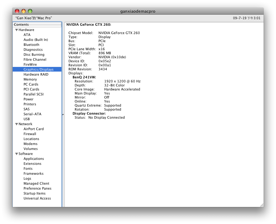

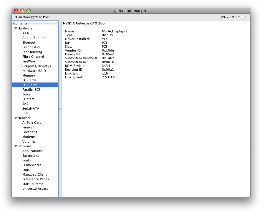

ganxiao Posted July 19, 2009 Share Posted July 19, 2009 Since EFI-String trick works with gt200 series card, so do the DSDT way, I finally manage my MSI N260GTX-T2D896-OC working with modded dsdt.aml Below is PEGP section for GTX260 from my DSDT, Note that the NVCAP and VRAM values may differ based on graphics card Device (PEGP) { Name (_ADR, 0x00010000) Device (GFX0) { Name (_ADR, Zero) Name (_SUN, One) Method (_DSM, 4, NotSerialized) { Store (Package (0x16) { "@0,compatible", Buffer (0x0B) { "NVDA,NVMac" }, "@0,device_type", Buffer (0x08) { "display" }, "@0,name", Buffer (0x0F) { "NVDA,Display-A" }, "@1,compatible", Buffer (0x0B) { "NVDA,NVMac" }, "@1,device_type", Buffer (0x08) { "display" }, "@1,name", Buffer (0x0F) { "NVDA,Display-B" }, "NVCAP", Buffer (0x18) { /* 0000 */ 0x05, 0x00, 0x00, 0x00, 0x00, 0x00, 0x03, 0x00, /* 0008 */ 0x0C, 0x00, 0x00, 0x00, 0x00, 0x00, 0x00, 0x0b, /* 0010 */ 0x00, 0x00, 0x00, 0x00 }, "VRAM,totalsize", Buffer (0x04) { 0x00, 0x00, 0x00, 0x38 }, "device_type", Buffer (0x0C) { "NVDA,Parent" }, "model", Buffer (0x17) { "NVIDIA GeForce GTX 260" }, "rom-revision", Buffer (0x5) { "3434" } }, Local0) DTGP (Arg0, Arg1, Arg2, Arg3, RefOf (Local0)) Return (Local0) } } } Graphics card info now shows up in PCI Cards section of sys profiler PS. Some graphic cards may have different device path on different motherboard, you should change Name (_ADR, 0x00010000) section under Device (PEGP) use gfxutil to get device path of devices ./gfxutil -f display output: DevicePath = PciRoot(0x1)/Pci(0x3,0x0)/Pci(0x0,0x0) The first PCI DEVICE node. Shorthand notation is Pci(0x3,0x0), which is another form of PciAdr(0x30000). PciAdr(uint32 adr) - alias for PCI node with using alternative address value. adr is PCI device "_ADR" property value that your may find from pci device properties in IOACPIPlane. So here _ADR is 0x30000 actually, change Name (_ADR, 0x00010000) to Name (_ADR, 0x00030000) in PEGP section, otherwise graphics card still work but graphics info will not show up in PCI Cards section of sys profiler Link to comment https://www.insanelymac.com/forum/topic/113489-geforce-200-series-support/page/11/#findComment-1203619 Share on other sites More sharing options...
