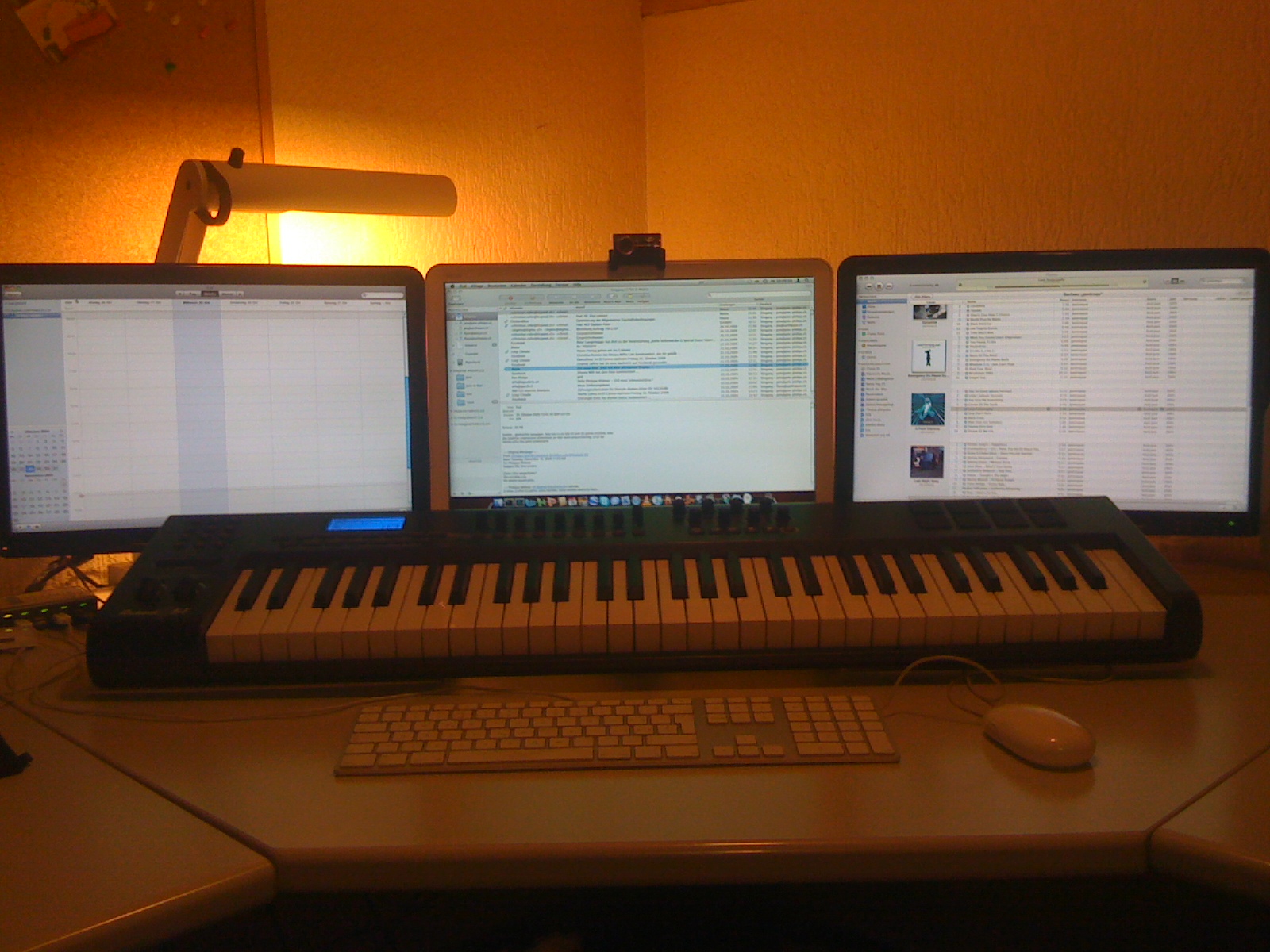

freanux Posted October 29, 2009 Share Posted October 29, 2009 Hello evbdy. I got my GTX 260 fully working: * Leopard 10.5.8 (based on Kalyway 10.5.1) * EVGA GeForce 8600 GTS (1 monitor) * XFX GTX 260 Black Edition (2 monitors) Before I additionally installed my GTX 260: * Leopard 10.5.8 (based on Kalyway 10.5.1) * EVGA GeForce 8600 GTS (2 monitors) What I did: 1) copied of my /System/Library/Extension to /System/Library/Extension.backup 2) installed the official NVIDIA drivers from here Official NVIDIA Mac Drivers 3) rebooted my diy-mac (checked if my GTS was already running) -> success 4) modified my boot.plist. i just copied my GTS efi string. 5) connected my monitors 6) restarted -> success My modified plist (the non-hexed-device-property-string): <?xml version="1.0" encoding="UTF-8"?> <!DOCTYPE plist PUBLIC "-//Apple//DTD PLIST 1.0//EN" "http://www.apple.com/DTDs/PropertyList-1.0.dtd"> <plist version="1.0"> <dict> <key>PciRoot(0x0)/Pci(0x1,0x0)/Pci(0x0,0x0)</key> <dict> <key>@0,compatible</key> <string>NVDA,NVMac</string> <key>@0,device_type</key> <string>display</string> <key>@0,name</key> <string>NVDA,Display-A</string> <key>@1,compatible</key> <string>NVDA,NVMac</string> <key>@1,device_type</key> <string>display</string> <key>@1,name</key> <string>NVDA,Display-B</string> <key>@2,#address-cells</key> <string>0x01000000</string> <key>@2,#size-cells</key> <string>0x00000000</string> <key>@2,compatible</key> <string>NVDA,sensor-parent</string> <key>@2,device_type</key> <string>NVDA,gpu-diode</string> <key>@2,hwctrl-params-version</key> <string>0x02000000</string> <key>@2,hwsensor-params-version</key> <string>0x02000000</string> <key>@2,name</key> <string>sensor-parent</string> <key>@2,reg</key> <string>0x02000000</string> <key>NVCAP</key> <data>BAAAAAAAAwAMAAAAAAAABwAAAAA=</data> <key>NVPM</key> <data>AQAAAAAAAAAAAAAAAAAAAAAAAAAAAAAAAAAAAA==</data> <key>VRAM,totalsize</key> <data>AAAAOA==</data> <key>device_type</key> <string>NVDA,GeForce</string> <key>model</key> <string>nVidia GeForce GTX 260</string> <key>name</key> <string>NVDA,Parent</string> </dict> <key>PciRoot(0x0)/Pci(0x3,0x0)/Pci(0x0,0x0)</key> <dict> <key>@0,compatible</key> <string>NVDA,NVMac</string> <key>@0,device_type</key> <string>display</string> <key>@0,name</key> <string>NVDA,Display-A</string> <key>@1,compatible</key> <string>NVDA,NVMac</string> <key>@1,device_type</key> <string>display</string> <key>@1,name</key> <string>NVDA,Display-B</string> <key>@2,#address-cells</key> <string>0x01000000</string> <key>@2,#size-cells</key> <string>0x00000000</string> <key>@2,compatible</key> <string>NVDA,sensor-parent</string> <key>@2,device_type</key> <string>NVDA,gpu-diode</string> <key>@2,hwctrl-params-version</key> <string>0x02000000</string> <key>@2,hwsensor-params-version</key> <string>0x02000000</string> <key>@2,name</key> <string>sensor-parent</string> <key>@2,reg</key> <string>0x02000000</string> <key>NVCAP</key> <data>BAAAAAAAAwAMAAAAAAAABwAAAAA=</data> <key>NVPM</key> <data>AQAAAAAAAAAAAAAAAAAAAAAAAAAAAAAAAAAAAA==</data> <key>VRAM,totalsize</key> <data>AAAAEA==</data> <key>device_type</key> <string>NVDA,GeForce</string> <key>model</key> <string>nVidia GeForce 8600 GTS</string> <key>name</key> <string>NVDA,Parent</string> </dict> <key>PciRoot(0x0)/Pci(0x1b,0x0)</key> <dict> <key>PinConfigurations</key> <data></data> <key>built-in</key> <data>AA==</data> <key>layout-id</key> <data>DAAAAA==</data> <key>revision-id</key> <data>AgAAAA==</data> <key>subsystem-id</key> <data>AqAAAA==</data> <key>subsystem-vendor-id</key> <data>WBQAAA==</data> <key>vendor-id</key> <data>hoAAAA==</data> </dict> <key>PciRoot(0x0)/Pci(0x1c,0x5)(Pi(0x0,0x0)</key> <dict> <key>built-in</key> <string>0x01</string> </dict> </dict> </plist> A full success story . Have a look: Greez freanux Link to comment Share on other sites More sharing options...
