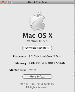

Zeroburn Posted October 9, 2008 Share Posted October 9, 2008 For the retail over itakos, I think we are almost there. I installed kalyway 10.5.2-->Jas 10.5.3-->Mac software update 10.5.4.It works good. Then the 10.5.5 out, I used the software update to 10.5.5, It works just fine except the powermanagement which I had to restore anyway due to the hardware issue For Atheros 5006/5007EG, I dont think anyone can make it now. The worst thing is we even can not plug in another wireless card like 4311 because the bios for compaq C700 is no way to hack. If anyone able to find out another wireless card which is working w/o hacking bios. That would be great. In a previous post, I noted that I was able to install a Wireless pc-card from a Compaq Persario C712 I believe into my C751 without a problem. No hacks or mods needed. I went on ebay and bought the card for roughly $30 From the previous post: This is the HP part number and the Discription off of the HP parts replacement website. You could buy it from HP at $113, or you can find it on ebay like I did for $30-$50. This is card is also in the pavilion dv6000 dv9000 series of laptops as well, so you might see it listed for those models also. HP# 441090-001 Wireless LAN 802.11b/g mini PCI adapter card (Broadcom, Hoya) - 54Mbps data rate, 2.4GHz operating frequency range Link to comment https://www.insanelymac.com/forum/topic/76194-install-on-the-compaq-c714nr/page/20/#findComment-923261 Share on other sites More sharing options...
