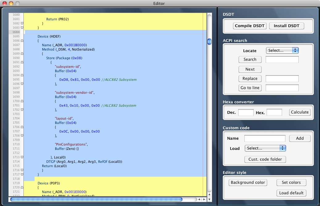

Yes ! this works well. But more importantly - I finally understand how the hdef section of the dsdt is added. It improves how the voodoo kext will work. It also allows the woodyhda.kext to work. The following must be added to your dsdt for full functionality. It goes between the P0P2 and P0P3 sections in your dsdt. This is from 314TeR's dsdts.
I used the 2504 bios plus the dsdt autopatcher (run in windows) then added 314TeR's hdef to the dsdt. All is well.
To be clear, I find that the hdef edit and Woody HDA to be all that is necessary.

dsdt + hdef from 314TeR's , dsdts automatic editor.
