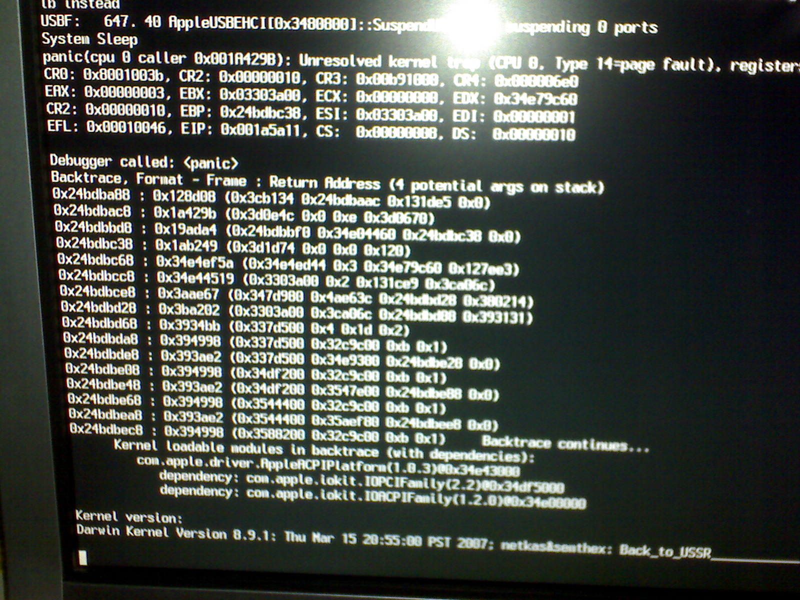

JSR Posted May 24, 2007 Share Posted May 24, 2007 After many tries I found a way to get the mac os loaded... but now I get a new error. What is it about? Link to comment https://www.insanelymac.com/forum/topic/50880-official-uphuck-1049-universal-x86-install-dvd-v12-thread/page/9/#findComment-371239 Share on other sites More sharing options...

uphuck Posted May 24, 2007 Share Posted May 24, 2007 JSR1. pls add your hardware to your signature2. there's no kernel in v1.2 that the date is 15 March. you changed the kernel and now it's complaining about acpiplatform. Link to comment https://www.insanelymac.com/forum/topic/50880-official-uphuck-1049-universal-x86-install-dvd-v12-thread/page/9/#findComment-371353 Share on other sites More sharing options...
JSR Posted May 24, 2007 Share Posted May 24, 2007 2. there's no kernel in v1.2 that the date is 15 March. you changed the kernel and now it's complaining about acpiplatform. hum... I remember I chose an AMD kernel from the setup list. Maybe I got the wrong one? I'm gonna try another installation Link to comment https://www.insanelymac.com/forum/topic/50880-official-uphuck-1049-universal-x86-install-dvd-v12-thread/page/9/#findComment-371376 Share on other sites More sharing options...
naquaada Posted May 24, 2007 Share Posted May 24, 2007 JSR: Your Board MUST work. Me and a friend have exactly the same board and we tested the AMD SSE3 and the universal kernel, they're working. But we're using a single HD for OS X and don't have a dual X2 cpu. Try to boot with -v cpus=1 and/or set the CPU Multiplier in BIOS to 11.5 or so, that should eliminate dual-core problems. Also take a look into my nForce 4 driver package. Wish you luck. Link to comment https://www.insanelymac.com/forum/topic/50880-official-uphuck-1049-universal-x86-install-dvd-v12-thread/page/9/#findComment-371381 Share on other sites More sharing options...
