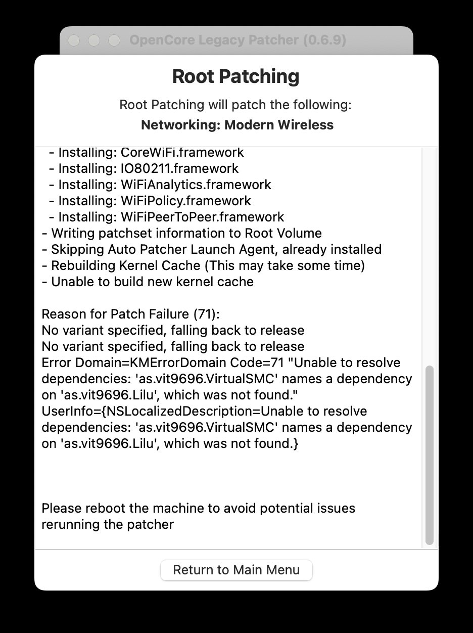

I installed Sonoma RC1 to my main system partition believing that Sonoma was running smoothly enough on my test partition to justify it.  However, I encountered a problem with OCLP patching of the wireless adapter that I had not encountered on my test partition. (Both use the same EFI to boot.)
Has anyone else encountered this?  These are essential kexts and I have the most current versions installed.  Any ideas what to do?  I have tried the recommended installation settings but keep getting this patch failure.  Thanks for your suggestions.
EDIT:  Problem solved.  This error was caused primarily because this was not a clean install.  It appears that, in June 2022, I put a copy of VirtualSMC into my /Library/Extensions/ folder.  It was version 1.3.0.  The current version is 1.3.3.  The dependencies are different. That is what caused OCLP to not be able to find the dependent kext.  Case closed. (Yay!)

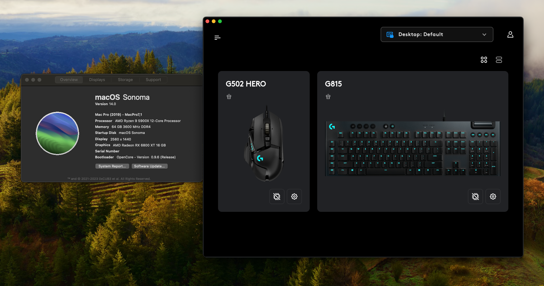

3 minutes ago, SavageAUS said:
Can we use AMFIPass.kext instead of the boot arg? Using the boot arg make Logitech G Hub not work at all.
Yes you can. You just might need to use -amfipassbeta boot arg. I'm not sure if the kexts has been updated yet.

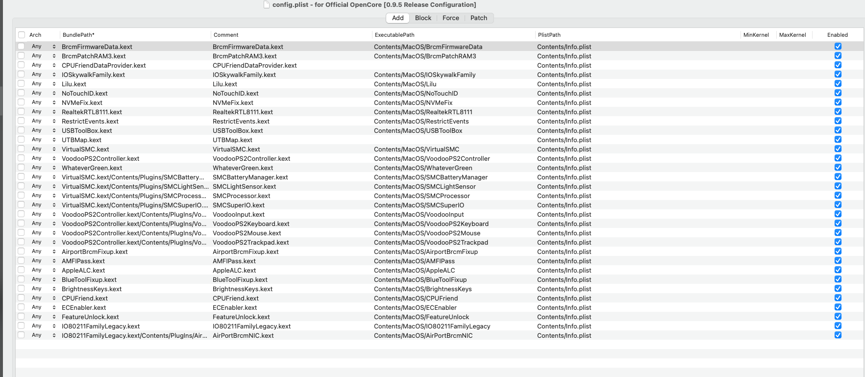

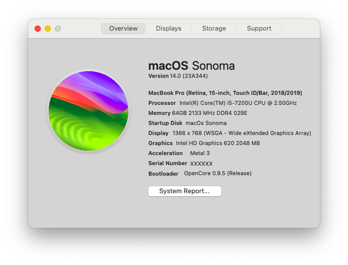

Hi guys, good news for my Lenovo.
Im use this boot-args and get my Broadcom BRCM4352 working great again, and fine Airdrop with OCLP 0.6.9, wi-fi 5G
ipc_control_port_options=0 -brcmfxbeta alcid=14 -v -amfipassbeta -lilubetaall -keempsyms=1
And need use AirportBrcmFixup.kext active on Kernel menu
