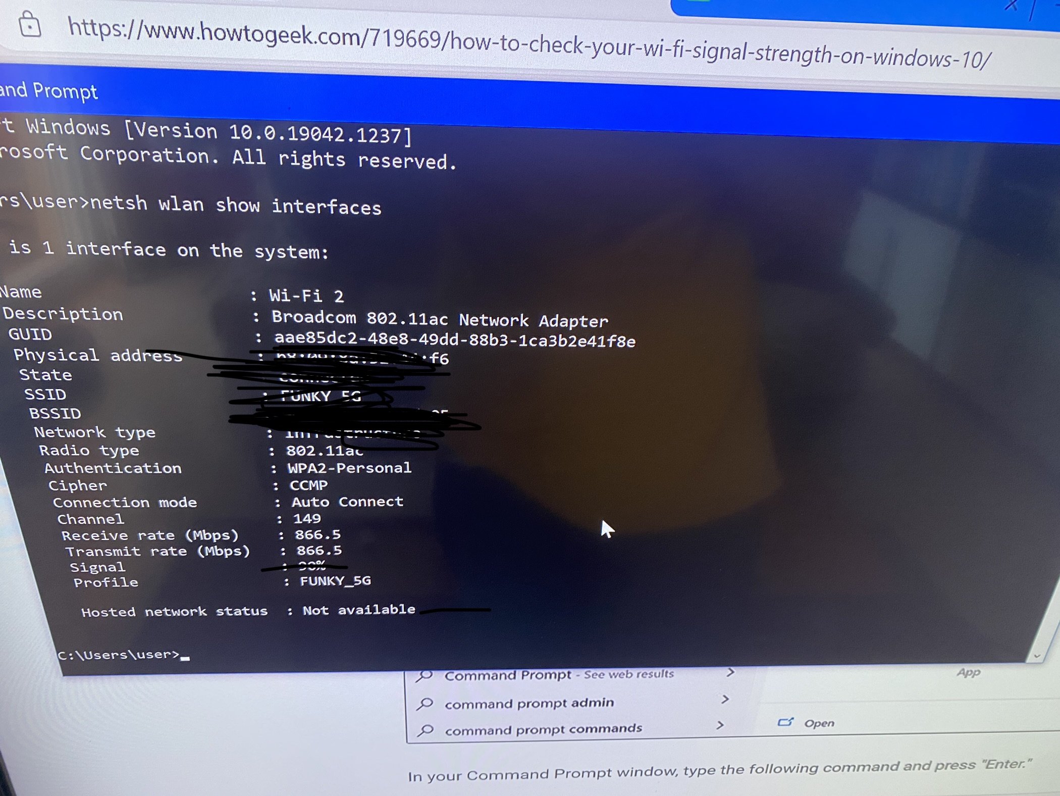

robi62 Posted July 23, 2024 Share Posted July 23, 2024 this is speed with my hp 440 g4 about 3 meters away from router Link to comment https://www.insanelymac.com/forum/topic/357087-macos-sonoma-wireless-issues-discussion/page/31/#findComment-2823168 Share on other sites More sharing options...
robi62 Posted July 23, 2024 Share Posted July 23, 2024 (edited) Its definately a problem in mac in windows speeds are good Edited July 23, 2024 by robi62 Link to comment https://www.insanelymac.com/forum/topic/357087-macos-sonoma-wireless-issues-discussion/page/31/#findComment-2823169 Share on other sites More sharing options...

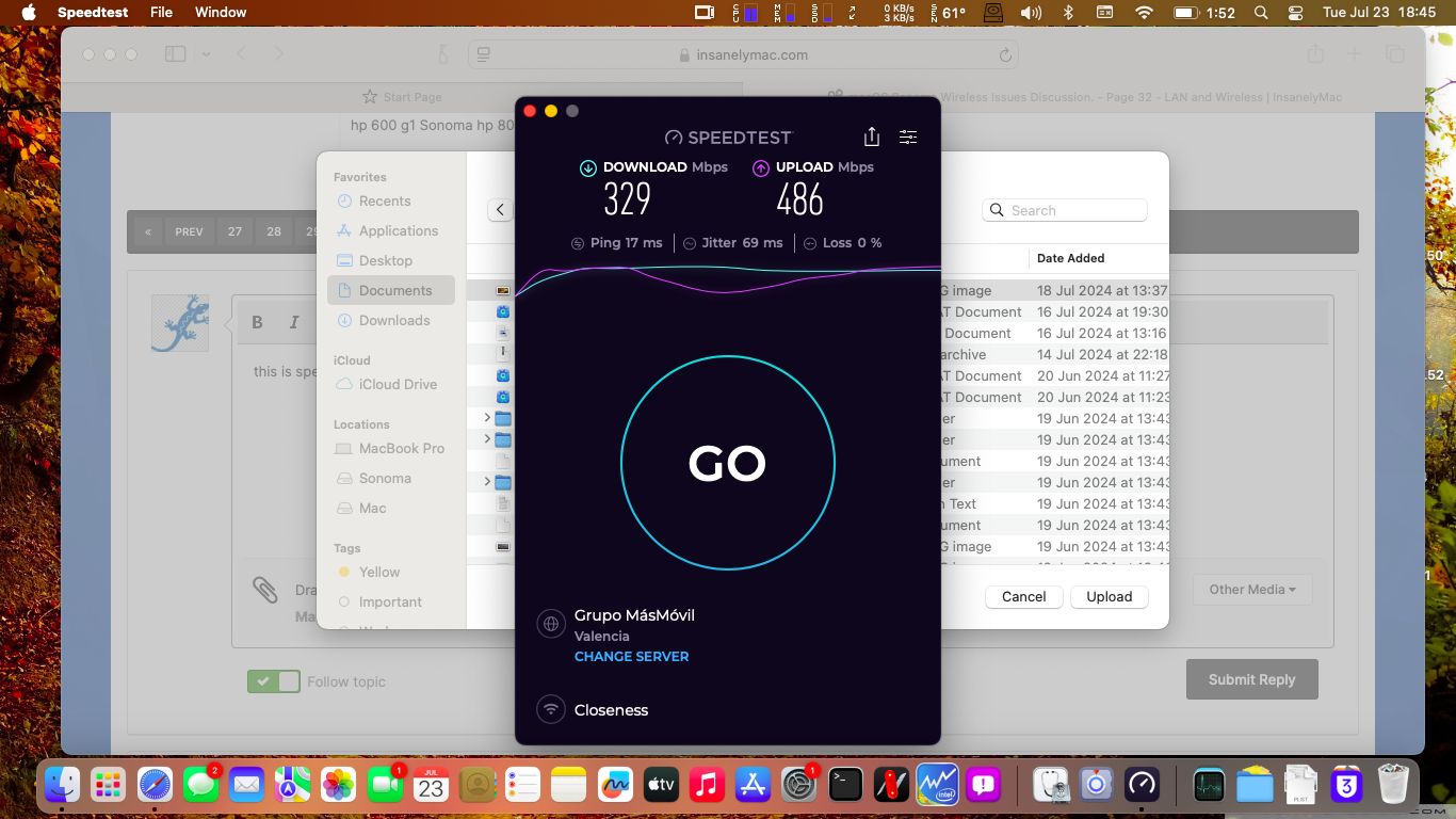

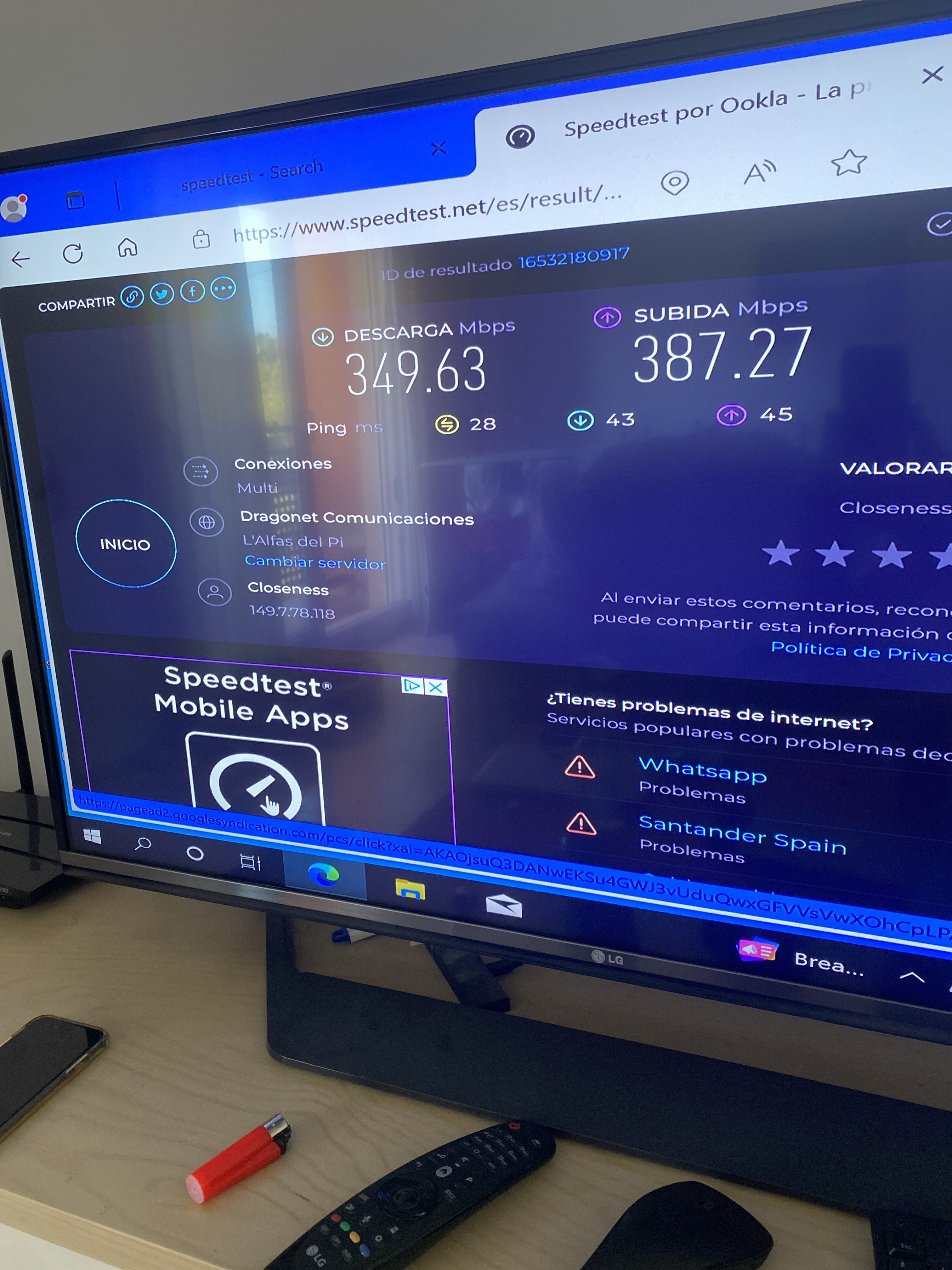

miliuco Posted July 23, 2024 Share Posted July 23, 2024 @robi62 I have Fenvi T919, Wi-Fi chipset is BCM94360CD, it's working fine in my system Sequoia included. Speeds are good. Similar to Windows. I guess Fenvi 1200 has the same chipset. Is it so? I'm not sure about your pics, 349 / 387 Windows and 329 / 486 macOS? Not bad for macOS, don't you think? Saludos. Link to comment https://www.insanelymac.com/forum/topic/357087-macos-sonoma-wireless-issues-discussion/page/31/#findComment-2823175 Share on other sites More sharing options...

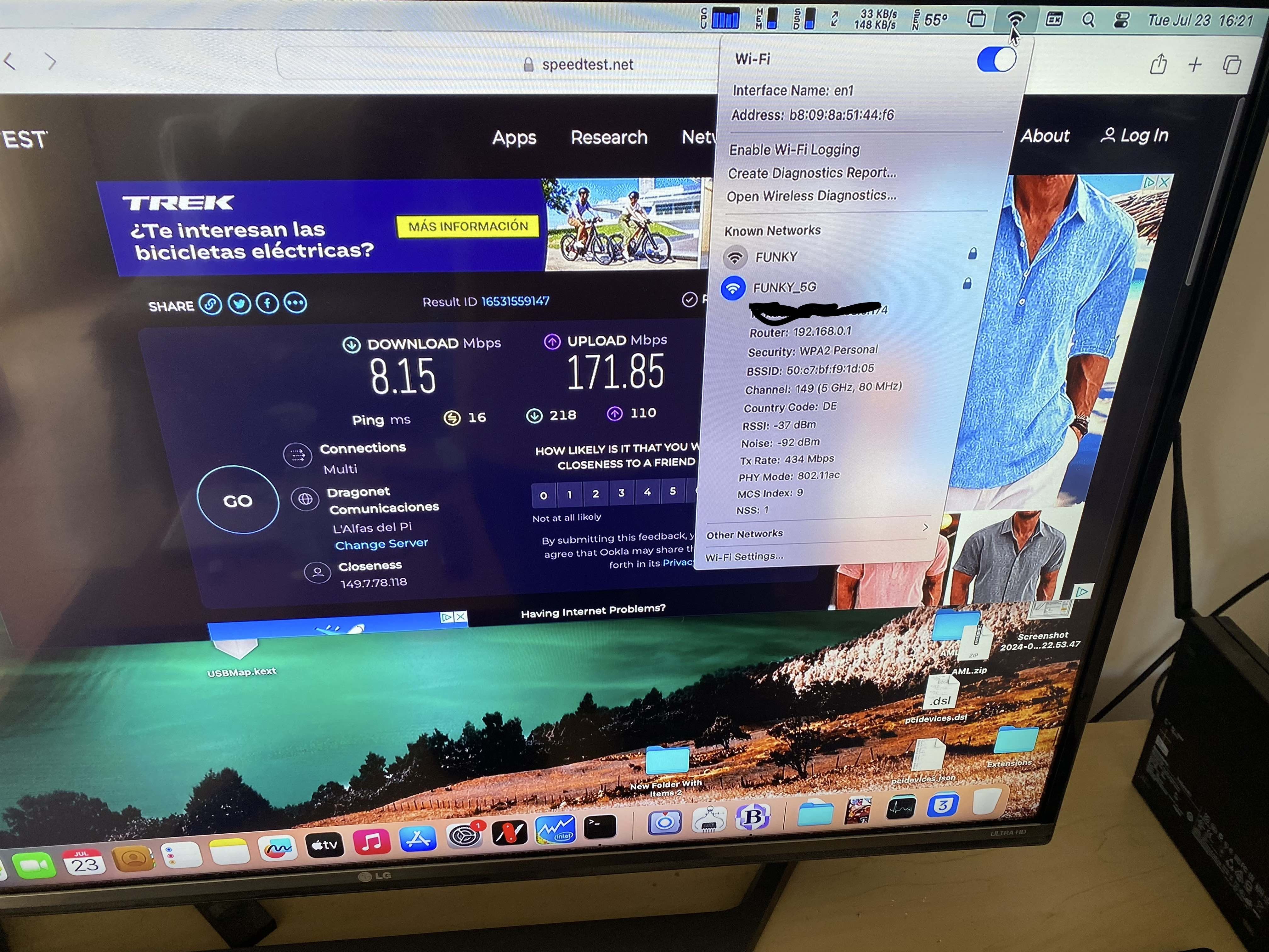

robi62 Posted July 23, 2024 Share Posted July 23, 2024 22 minutes ago, miliuco said: @robi62 I have Fenvi T919, Wi-Fi chipset is BCM94360CD, it's working fine in my system Sequoia included. Speeds are good. Similar to Windows. I guess Fenvi 1200 has the same chipset. Is it so? I'm not sure about your pics, 349 / 387 Windows and 329 / 486 macOS? Not bad for macOS, don't you think? Saludos. @miliuco the speed you are refering to 329 /486 is my laptop The desktop is the first photo 8.15 / 171 that's the one with fenvi card so you can see the speed is useless 1 Link to comment https://www.insanelymac.com/forum/topic/357087-macos-sonoma-wireless-issues-discussion/page/31/#findComment-2823180 Share on other sites More sharing options...
miliuco Posted July 23, 2024 Share Posted July 23, 2024 @robi62 Ah! Understood. Yes, there is a difference. Link to comment https://www.insanelymac.com/forum/topic/357087-macos-sonoma-wireless-issues-discussion/page/31/#findComment-2823183 Share on other sites More sharing options...

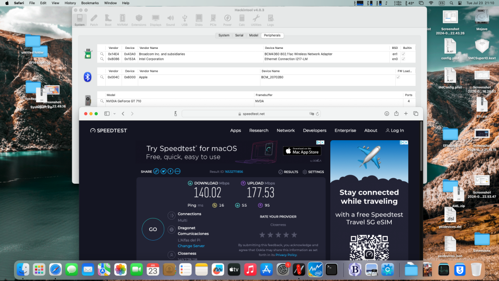

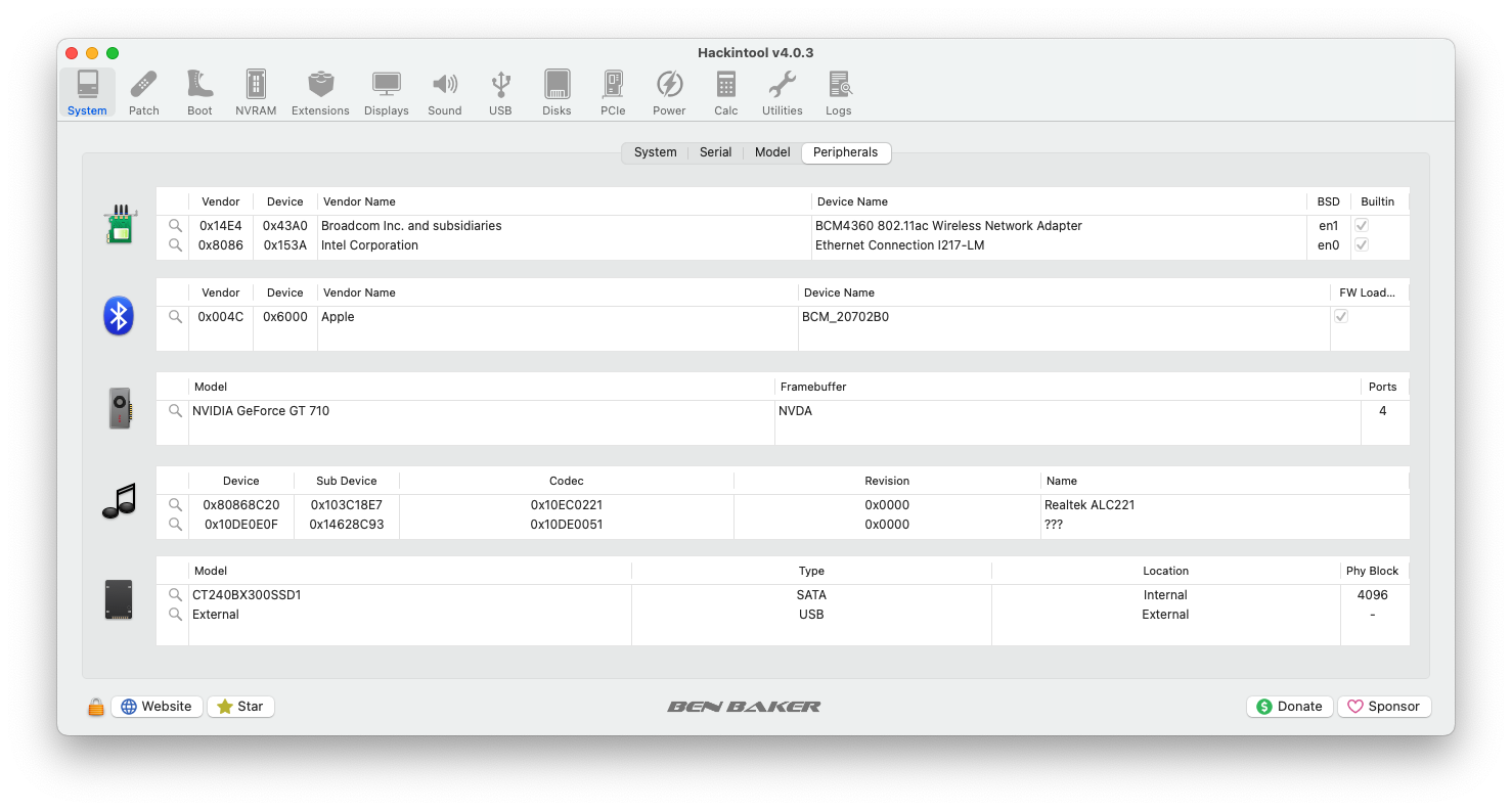

robi62 Posted July 23, 2024 Share Posted July 23, 2024 (edited) speed a bit better but not as good as windows or my other hack This is efi I use with hp 600 g1 which is chris111 from GitHub https://filetransfer.io/data-package/4esDo83h#link the chipset for fenvi 1200 is BCM4360 so not same as fenvi T919 Edited July 23, 2024 by robi62 Link to comment https://www.insanelymac.com/forum/topic/357087-macos-sonoma-wireless-issues-discussion/page/31/#findComment-2823185 Share on other sites More sharing options...
