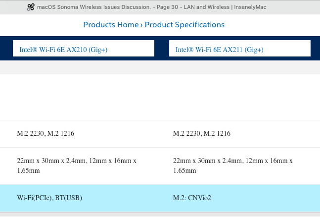

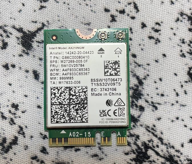

Matgen84 Posted October 10, 2023 Share Posted October 10, 2023 1 hour ago, deeveedee said: Has anyone found a proven USB Wi-Fi solution that works in Sonoma without any post-install patching (a USB Wi-Fi that doesn't need OCLP or modified kexts)? Thank you. EDIT: Bluetooth is optional - I'm only looking for USB Wi-Fi for Sonoma at this time, not Bluetooth. EDIT2: My ask for "USB Wi-Fi" is overly constraining. I'm looking for any Sonoma-compatible Wi-Fi solution that replaces the "factory installed" Wi-Fi and does not require post-install patches / modified kexts. For example, a Wi-Fi device that connects to the PC's Ethernet port would be acceptable as well. I am aware that I could repurpose an Access Point or Wi-Fi Bridge to be a Wi-Fi client, but portability is desirable, too. @deeveedee There are also Intel Wifi card (working with Airportitlwm Preview 05 for Sonoma). OpenIntelWireless on Github. Ask to @chris1111 for USB Wifi key. 1 Link to comment Share on other sites More sharing options...
deeveedee Posted October 10, 2023 Share Posted October 10, 2023 @Matgen84 I haven't played much with the Intel Wi-Fi which is why it wasn't on my radar. Excellent suggestion. 2 Link to comment Share on other sites More sharing options...

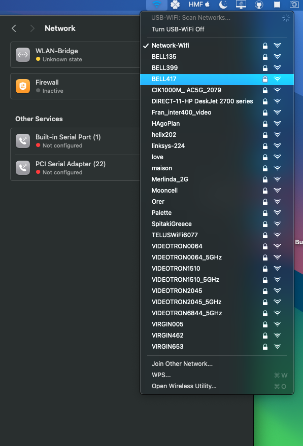

deeveedee Posted October 10, 2023 Share Posted October 10, 2023 (edited) 16 hours ago, Cyberdevs said: @deeveedee Yep, I agree, if any adapter works without breaking the APFS seal is going to better than having the exposed OS. I am currently testing a D-Link Wi-Fi adapter that connects to my laptop's Ethernet port. It is powered via a USB cable to my laptop. While not as seamless as built-in Wi-Fi, it is very portable, very easy to use and requires only IntelMausiEthernet.kext. After I find a wireless solution that meets my requirements, I will post an update. EDIT: Setup of the D-Link Ethernet-connected Wi-Fi is very simple: connect D-Link Wi-Fi adapter to Ethernet port via CAT-5 connect D-Link power port to USB port using provided power cable included with the D-Link adapter configure laptop Ethernet port static IP within D-Link adapter's LAN subnet browse to D-Link adapter's browser-based config and scan for available Wi-Fi SSIDs choose a Wi-Fi SSID, select security (e.g., WPA2) and enter pass phrase With this solution, I have Wi-Fi in Sonoma using only IntelMausiEthernet.kext EDIT2: This particular D-Link model that I am testing (very old, but still works) is 2.4GHz only. It has a built-in wizard (accessible via web browser) that makes scanning and selecting a Wi-Fi hotspot very easy. This solution works very well. EDIT3: As indicated by Slice, this Wi-Fi solution does not provide native support for AirDrop, AirPlay and other features that require natively working Wi-Fi. It provides a Mac with a Wi-Fi wireless data connection. Edited October 11, 2023 by deeveedee 2 Link to comment Share on other sites More sharing options...
