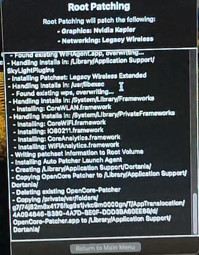

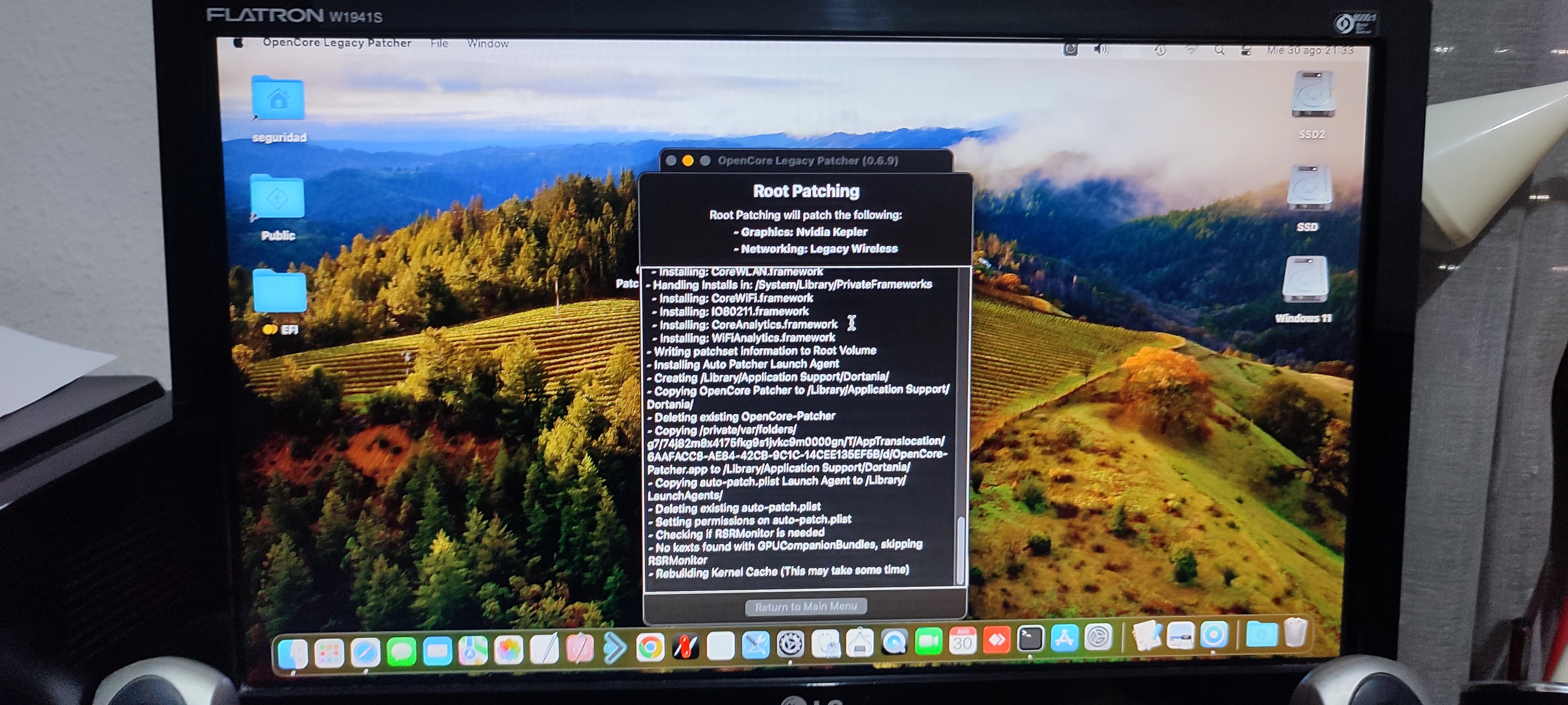

kaoskinkae Posted September 3, 2023 Share Posted September 3, 2023 (edited) Gigabyte Z77X-d3h i5 2310 Sandy Brigue kepler GT640 TP-LINK WDN-4800 Tests carried out without success, the active wifi icon appears but the kext loaded does not appear in both cases using the kext AMFIPass.kext or the boot amfi=0x80 "Legacy" cards Atheros: AR93xx Wifi AR93xx TP-LINK WDN-4800 PCI168c,30 AirPortAtheros40 IDs 0x0030, #AR93xx IO80211ElCap.kext and its plugin AirPortAtheros40.kext (enabled for Atheros cards) Adjust MinKernel settings as below: 16.0.0 16.0.0 18.0.0 Change SecureBootModel Disabled to rule out early kernel panics caused by security conflicts. Change csr-active-config 03080000 Optional: Add amfi=0x80 if boot-args cannot root patch both AMFIPass.kext methods Optional: Add -brcmfxbeta if boot-args cannot connect to Wi-Fi after applying root patches. Optional: Add -amfipassbeta to boot-args (if AMFIPass.kext is not loaded in the latest Sonoma beta). Enter (kextstat | grep -v com.apple) into the Terminal to check if all the required kexts you added are loaded. If not, add -amfipassbeta (if AMFIPass.kext is not present) and -brcmfxbeta (if wireless works but cannot connect to accesspotsints) Tests carried out with the same result MacPro7.1 and Imac12.2 it does not work KEPLER YES Edited September 3, 2023 by kaoskinkae 1 Link to comment https://www.insanelymac.com/forum/topic/357087-macos-sonoma-wireless-issues-discussion/page/23/#findComment-2810778 Share on other sites More sharing options...

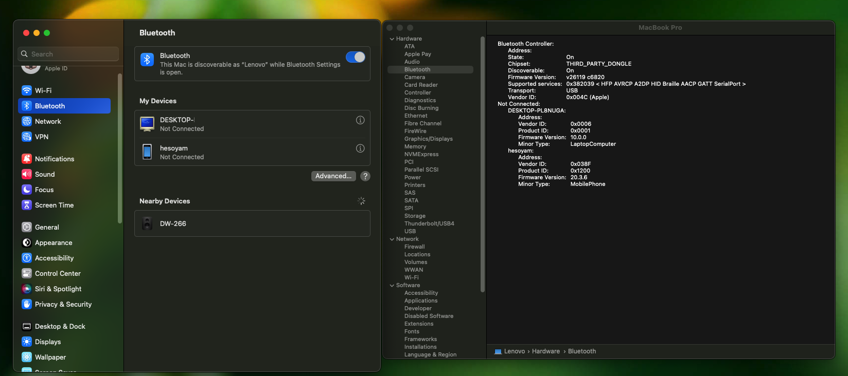

vanmoo Posted September 4, 2023 Share Posted September 4, 2023 On 7/25/2023 at 5:45 AM, Aguys said: Join the party, DW1820A... Does your Bluetooth detected as apple one? not THIRD_PARTY_DONGLE, if so how do you fix that? Because I've used BlueTool kext, BrcmPatchRam3 and the FirmwareData but system information still show it as THIRD_PARTY_DONGLE, kindly waiting for your help, thanks Link to comment https://www.insanelymac.com/forum/topic/357087-macos-sonoma-wireless-issues-discussion/page/23/#findComment-2810815 Share on other sites More sharing options...
vanmoo Posted September 4, 2023 Share Posted September 4, 2023 (edited) Hello everyone, hope you all doing well. Wanna ask about bluetooth related things. How do I change it to be detected as Apple device, it's DW1820A - BCM4350 ? Because of this airdrop wont work, has anyone solve this issue? Thanks before Edited September 4, 2023 by vanmoo Link to comment https://www.insanelymac.com/forum/topic/357087-macos-sonoma-wireless-issues-discussion/page/23/#findComment-2810824 Share on other sites More sharing options...

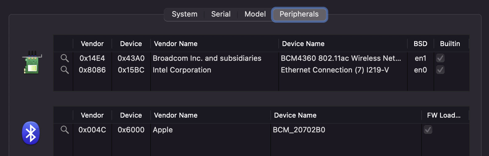

miliuco Posted September 6, 2023 Share Posted September 6, 2023 (edited) 33 minutes ago, ham4ever said: Thanks, i followed the guide and the wifi is working and is it connected, but no bluetooth. Did you have any Bluetooth related kext before now? (Stupid question) Do you have the USB cable from the card plugged into a USB port in the mobo? Edited September 6, 2023 by miliuco 1 Link to comment https://www.insanelymac.com/forum/topic/357087-macos-sonoma-wireless-issues-discussion/page/23/#findComment-2810859 Share on other sites More sharing options...

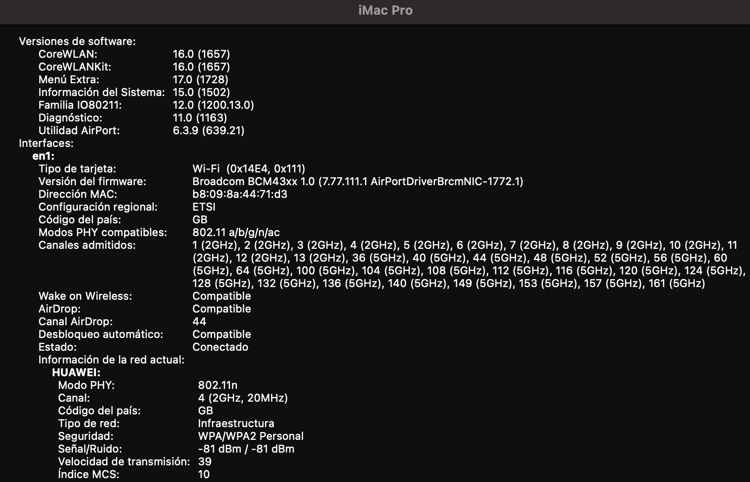

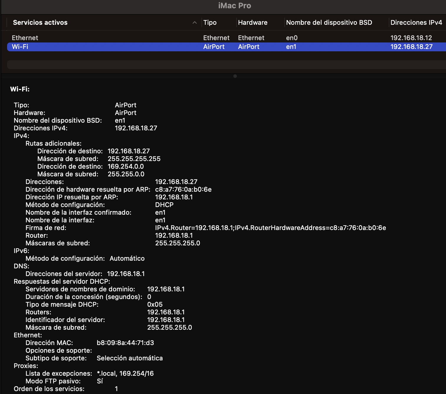

bernito Posted September 6, 2023 Share Posted September 6, 2023 On 7/24/2023 at 5:39 AM, miliuco said: Good morning. I know that it is not the ideal situation that many of us want to have the system as vanilla as possible, but what the OCLP team has achieved is amazing. My wifi is Fenvi T919. I have followed TO THE LETTER the instructions that have been published here (Hackintosh notes):https://github.com/dortania/OpenCore-Legacy-Patcher/pull/1077#issuecomment-1646934494 And it has worked well. I have wifi and Airdrop back in Sonoma. Note that khronokernel's instructions must be followed exactly. Don't forget to enable (Enabled=True) 3 extensions to be added and the extension to be blocked, they are disabled by default. If I don't block com.apple.iokit.IOSkywalkFamily the system won't boot with KP. I'm attaching my config.plist in case it helps anyone having trouble, check out these specific details: csr-active-config | data | 03080000 boot-args | string | amphi=0x80 com.apple.iokit.IOSkywalkFamily blocked IOSkywalk.kext, IO80211FamilyLegacy.kext and AirPortBrcmNIC.kext added in this order (Kexts folder and config.plist). For the future I hope the integration of the amfi-disabled branch with the sonoma-development branch to be able to work without the need to disable AMFI. I guess incremental updates are lost with this setup. But the OCLP approach works, at least for me. Note: as it's a preliminary fix, maybe it doesn't work on some systems. Reveal hidden contents Important: com.apple.iokit.IOSkywalkFamily blocking must have Enabled=True and Strategy=Exclude. Otherwise you get kernel panic at boot. Reveal hidden contents Thank you, OCLP team!!! config.plist 27.63 kB · 69 downloads Thanks to everyone who posted on this thread. I followed this method exactly and have complete Sonoma functionality on a Gigabyte ga-z170x-ud5-th with a Broadcom 4360WiFi / Bluetooth adapter. 1 Link to comment https://www.insanelymac.com/forum/topic/357087-macos-sonoma-wireless-issues-discussion/page/23/#findComment-2810867 Share on other sites More sharing options...

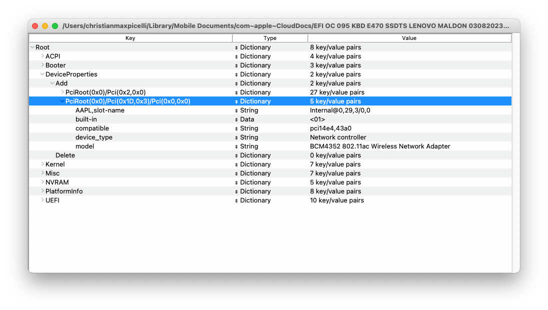

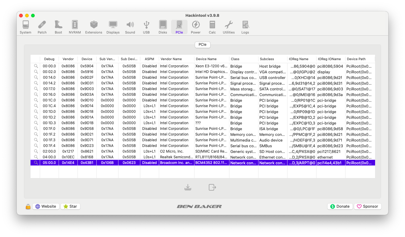

Max.1974 Posted September 7, 2023 Share Posted September 7, 2023 @ham4ever Are you try use Hackintool to inject your device properties compatible ? Works fine to me on my Lenovo I'm have BCM 4352 pcie14e4,43b1 and put compatible like device properties on plist on print screen. 2 Link to comment https://www.insanelymac.com/forum/topic/357087-macos-sonoma-wireless-issues-discussion/page/23/#findComment-2810889 Share on other sites More sharing options...

ham4ever Posted September 8, 2023 Share Posted September 8, 2023 (edited) 23 hours ago, Max.1974 said: @ham4ever Are you try use Hackintool to inject your device properties compatible ? Works fine to me on my Lenovo I'm have BCM 4352 pcie14e4,43b1 and put compatible like device properties on plist on print screen. Yes is also injected in device properties. 22 hours ago, Matgen84 said: BCM4331 was native card before Sonoma like my Fenvi T919 (BCM4360). I don't have Wifi but Bluetooth coniiue to work natively (no kexts). Do you try to reset module from Buletooth icon in Menu Bar. as far i remember i always had to use kext to get my card to work, 22 hours ago, antuneddu said: Probably need to map the USB ports properly or if did maybe that port (where the card is connected) has been excluded how do i make sure that the port isnt excluded ? EDIT: omg you guys, it was the usb cable not attached good to the mobo, i must have touched it when i installed new GPU, i feel so stupid. Thank you all. Edited September 8, 2023 by ham4ever SOLVED 4 Link to comment https://www.insanelymac.com/forum/topic/357087-macos-sonoma-wireless-issues-discussion/page/23/#findComment-2810917 Share on other sites More sharing options...
ham4ever Posted September 8, 2023 Share Posted September 8, 2023 On 9/6/2023 at 8:20 PM, miliuco said: Did you have any Bluetooth related kext before now? (Stupid question) Do you have the USB cable from the card plugged into a USB port in the mobo? YOU were totally right with USB cable, it wasn't fully attached, i must have touched it when i installed new GPU. Thanks. 2 Link to comment https://www.insanelymac.com/forum/topic/357087-macos-sonoma-wireless-issues-discussion/page/23/#findComment-2810919 Share on other sites More sharing options...

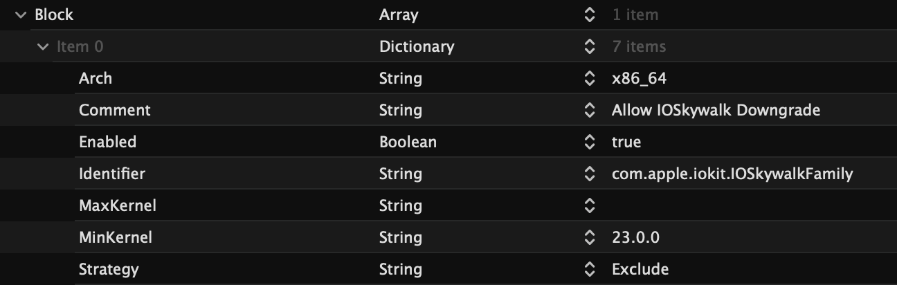

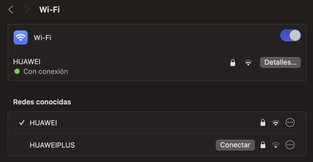

CloverLeaf Posted September 8, 2023 Share Posted September 8, 2023 (edited) I managed to fix the Wi-Fi of my EliteDesk (BCM94360NG) following This guide. Now everything works (2.4G/5G) just fine. BIG THANKS to everybody working on this project! Summarizing the steps: Kexts: IOSkywalkFamily.kext IO80211FamilyLegacy.kext AirportBrcmFixup.kext Kext organized and added MinKernel as per guide. IMPORTANT: Blocked IOSkywalkFamily under Kernel/Block NVRAM settings: csr-active-config: 03080000 Boot args: amfi=0x80 Misc/Security settings: SecureBootModel -> Disabled OpenCoreLegacyPatcher: OCLP 0.6.9 Nightly used to patch the Modern Wireless Restart the system and enjoy Edited September 30, 2023 by CloverLeaf 4 1 Link to comment https://www.insanelymac.com/forum/topic/357087-macos-sonoma-wireless-issues-discussion/page/23/#findComment-2810920 Share on other sites More sharing options...
