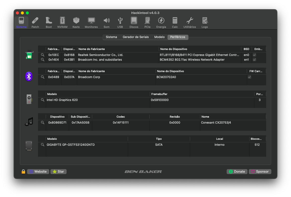

grassmudhorse Posted October 2, 2023 Share Posted October 2, 2023 16 minutes ago, Max.1974 said: Hi guys, good news for my Lenovo. Im use this boot-args and get my Broadcom BRCM4352 working great again, and fine Airdrop with OCLP 0.6.9, wi-fi 5G ipc_control_port_options=0 -brcmfxbeta alcid=14 -v -amfipassbeta -lilubetaall -keempsyms=1 And need use AirportBrcmFixup.kext active on Kernel menu Hide contents Hide contents Hide contents Does airdrop work both way? or just phone to Mac? 1 Link to comment https://www.insanelymac.com/forum/topic/357087-macos-sonoma-wireless-issues-discussion/page/25/#findComment-2811863 Share on other sites More sharing options...

Benjamin Franklin Posted October 2, 2023 Share Posted October 2, 2023 9 hours ago, Max.1974 said: Im use this boot-args and get my Broadcom BRCM4352 working great again, and fine Airdrop with OCLP 0.6.9, wi-fi 5G ipc_control_port_options=0 -brcmfxbeta alcid=14 -v -amfipassbeta -lilubetaall -keempsyms=1 And need use AirportBrcmFixup.kext active on Kernel menu Max, I too have a BRCM4352 (it's actually a DELL DW1560 with a Broadcom BCM94352Z chip). What other kexts related to Brcm and bluetooth do you load? 1 Link to comment https://www.insanelymac.com/forum/topic/357087-macos-sonoma-wireless-issues-discussion/page/25/#findComment-2811874 Share on other sites More sharing options...
Max.1974 Posted October 2, 2023 Share Posted October 2, 2023 8 hours ago, Alpha22 said: question: when to use boot-arg ipc_control_port_options=0 Is this make works Firefox and WhatsApp Desktop. 7 hours ago, miliuco said: @Max.1974 You have 3 beta boot args: -brcmfxbeta -amfipassbeta -lilubetaal. lilubetall includes all other beta arguments for kexts. And can make the boot a bit slower. Better to set specific beta boot args only for needed kexts, as -brcmfxbeta and -amfipassbeta do. Try removing lilubetaall, I think it’s not required. Hi my dear friend, im try without all boot args unnecessary but unfortunately not shows up Wi-Fi. Im order two new pci wireless devices, one is intel AX 210 because im think very risk use OCLP, and another Broadcom native 43a0. Without -lilubetall or another boot args my Lenovo E470 not run Sonoma with OCLP. Thanks a lot for your information my dear I appreciated that. 4 hours ago, Benjamin Franklin said: Max, I too have a BRCM4352 (it's actually a DELL DW1560 with a Broadcom BCM94352Z chip). What other kexts related to Brcm and bluetooth do you load? Hi my friend, first you need put on Device Properties on config.plist compatible with 14e4,43a0 Here my EFI but I compiled on Xcode maybe not run on other devices. Change for your OC. My serial number is Generic modified for share here. Spoiler Spoiler EFI for OCLP 0.6.9 Sonoma 14.0 RC EFI Lenovo E470 096 Xcode Max.1974 GenSMBIOS.zip 3 Link to comment https://www.insanelymac.com/forum/topic/357087-macos-sonoma-wireless-issues-discussion/page/25/#findComment-2811876 Share on other sites More sharing options...

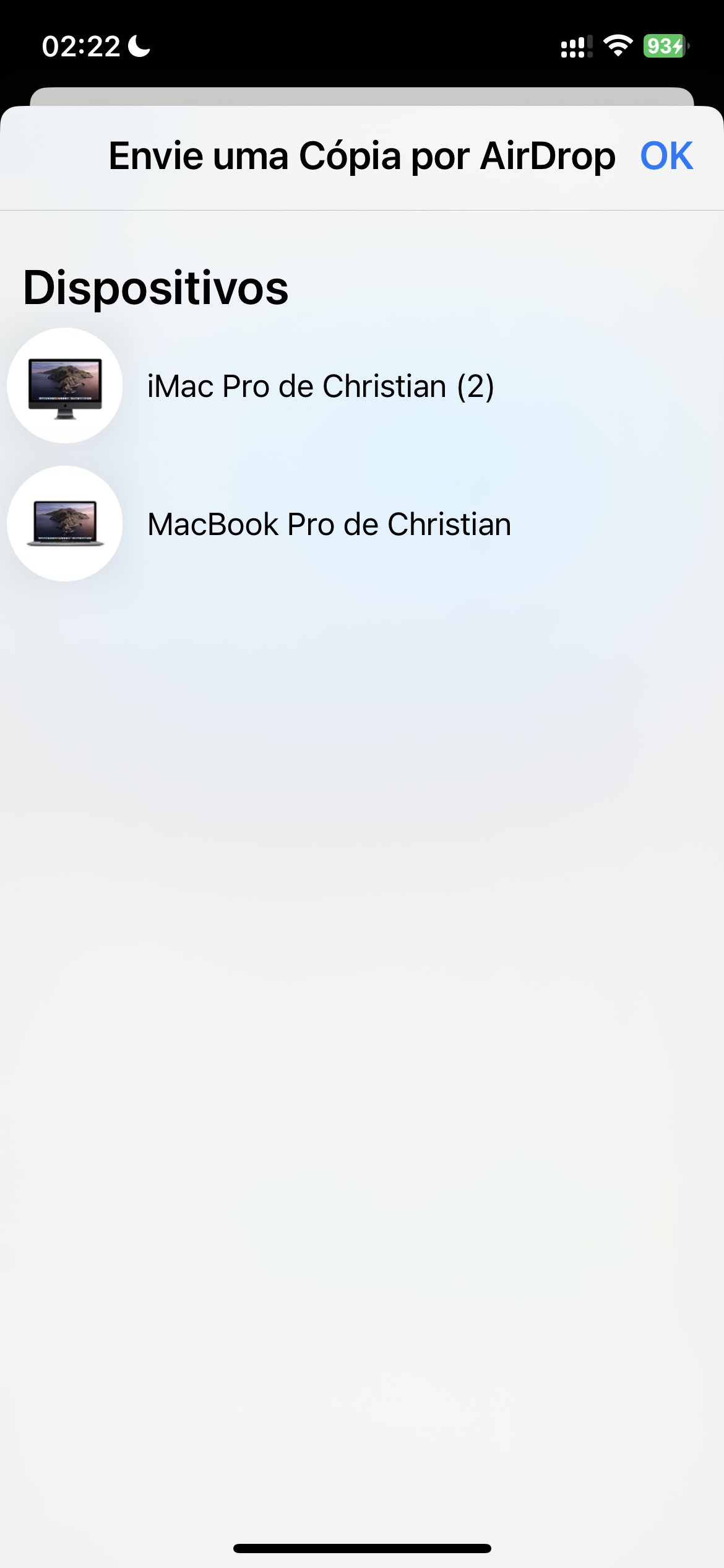

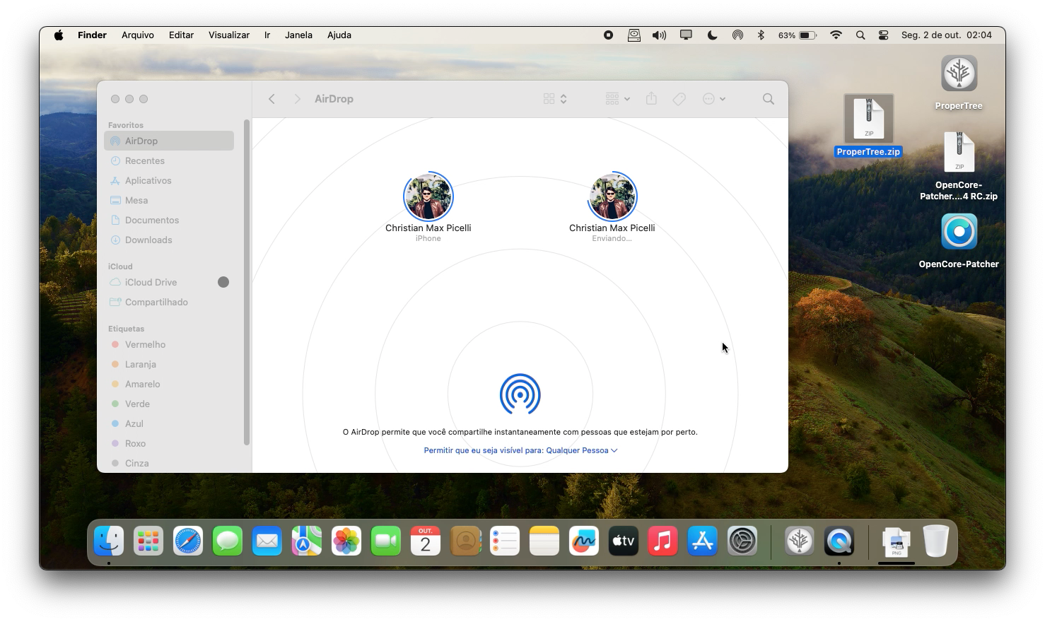

Max.1974 Posted October 2, 2023 Share Posted October 2, 2023 Vídeo how im put work my Airdrop both way Spoiler Airdrop Lenovo iphone.mp4 Link to comment https://www.insanelymac.com/forum/topic/357087-macos-sonoma-wireless-issues-discussion/page/25/#findComment-2811877 Share on other sites More sharing options...
HyperX7 Posted October 2, 2023 Share Posted October 2, 2023 6 hours ago, Max.1974 said: Vídeo how im put work my Airdrop both way Reveal hidden contents Airdrop Lenovo iphone.mp4 12.66 MB · 0 downloads Greetings! I'm curious about something. Can you use the Airdrop feature from Mac to iPhone? On my system, the airdrop from Mac to iPhone direction does not work. I am talking about a situation that has been confirmed especially with the trials I have done from loptop. 1 Link to comment https://www.insanelymac.com/forum/topic/357087-macos-sonoma-wireless-issues-discussion/page/25/#findComment-2811888 Share on other sites More sharing options...

Max.1974 Posted October 2, 2023 Share Posted October 2, 2023 1 hour ago, HyperX7 said: Greetings! I'm curious about something. Can you use the Airdrop feature from Mac to iPhone? On my system, the airdrop from Mac to iPhone direction does not work. I am talking about a situation that has been confirmed especially with the trials I have done from loptop. Hi @HyperX7 Greetings!! Yes, I use it, but if I don't open the iPhone screen after sending it from the Mac, it won't go until the Airdrop screen opens. This I send from Hackintosh to Hackintosh too. At this exact moment I agreed to exchange my Broadcom card for the Intel AX210 which is fantastic, and I use the free AppleStore and GitHub and OpenSource Program called LocaSend. Wonderful. If you need help, try posting your EFI or MediaFire and send me the link and I'll take a look if you need it. Good luck, God bless!! Spoiler Spoiler 1 Link to comment https://www.insanelymac.com/forum/topic/357087-macos-sonoma-wireless-issues-discussion/page/25/#findComment-2811893 Share on other sites More sharing options...

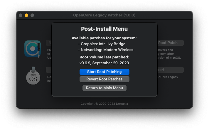

cankiulascmnfye Posted October 3, 2023 Share Posted October 3, 2023 When running OCLP 1.0.0 on my Lenovo T530, I noticed that it automatically detected the BRCM4352 2 Link to comment https://www.insanelymac.com/forum/topic/357087-macos-sonoma-wireless-issues-discussion/page/25/#findComment-2811912 Share on other sites More sharing options...
HyperX7 Posted October 3, 2023 Share Posted October 3, 2023 10 hours ago, Max.1974 said: Hi @HyperX7 Greetings!! Yes, I use it, but if I don't open the iPhone screen after sending it from the Mac, it won't go until the Airdrop screen opens. This I send from Hackintosh to Hackintosh too. At this exact moment I agreed to exchange my Broadcom card for the Intel AX210 which is fantastic, and I use the free AppleStore and GitHub and OpenSource Program called LocaSend. Wonderful. If you need help, try posting your EFI or MediaFire and send me the link and I'll take a look if you need it. Good luck, God bless!! Reveal hidden contents Reveal hidden contents You can find my EFI folder at the link. My system is the Asus Vivobook i7-10870 written in my signature. Today I started using it by removing the amp=0x80 command from bootargs. Thanks. https://disk.yandex.com/d/ivfCACbzDSIDCQ 1 Link to comment https://www.insanelymac.com/forum/topic/357087-macos-sonoma-wireless-issues-discussion/page/25/#findComment-2811913 Share on other sites More sharing options...

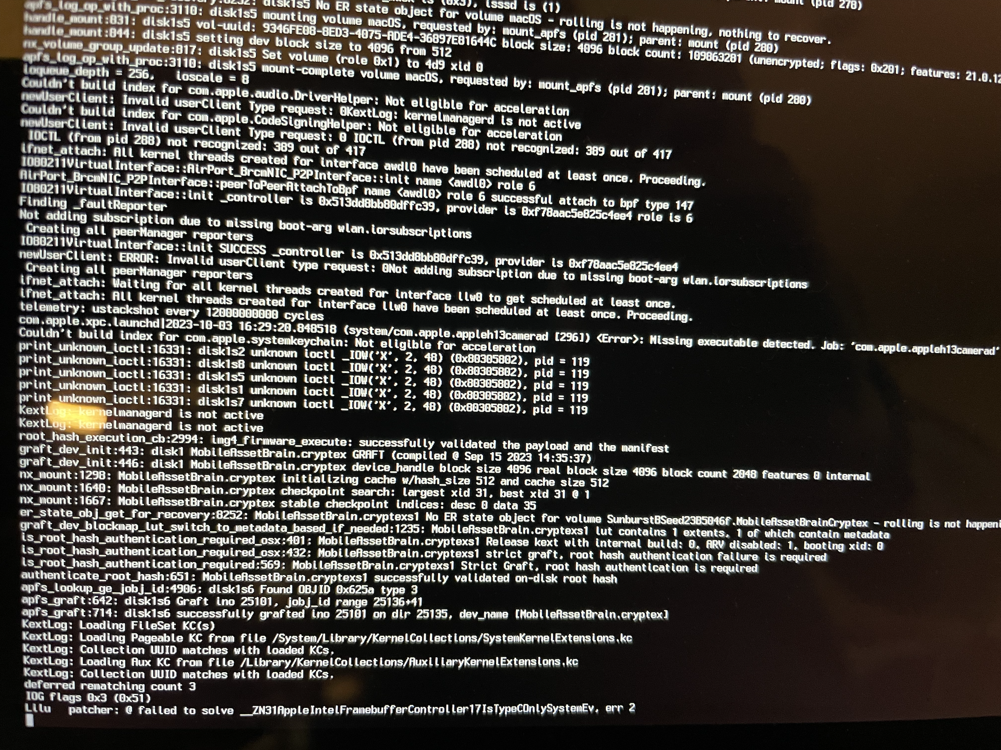

windowless31 Posted October 3, 2023 Share Posted October 3, 2023 (edited) The Sonoma upgrade on the Dell XPS 15-9560 worked fine with OpenCore-0.9.4 and current kexts. Of course, the DW1830 does not work. I would like to change that with the OCLP. As soon as I added AMFIPass.kext, IOSkywalkFamily.kext, IO80211FamilyLegacy.kext, as well as the kernel block for IOSkywalk downgrade to config.plist, Sonoma does not start anymore. csr-active-config is 03080000 SecureBootModel is Disabled SMBIOS MacBookPro 15.1 Started with the old config, I get the following crash log: IOUserServer(com.apple.DriverKit.AppleUserECM.ctrl-0x100000666) has crashed too many times @IOUserServer.cpp:4216 ... Process name corresponding to current thread (0xffffff90acdc40f8): com.apple.DriverKit.AppleUserECM Can someone please help me? Best regards Edited October 3, 2023 by windowless31 Link to comment https://www.insanelymac.com/forum/topic/357087-macos-sonoma-wireless-issues-discussion/page/25/#findComment-2811915 Share on other sites More sharing options...
Matgen84 Posted October 3, 2023 Share Posted October 3, 2023 (edited) 58 minutes ago, windowless31 said: The Sonoma upgrade on the Dell XPS 15-9560 worked fine with OpenCore-0.9.4 and current kexts. Of course, the DW1830 does not work. I would like to change that with the OCLP. As soon as I added AMFIPass.kext, IOSkywalkFamily.kext, IO80211FamilyLegacy.kext, as well as the kernel block for IOSkywalk downgrade to config.plist, Sonoma does not start anymore. csr-active-config is 03080000 SecureBootModel is Disabled SMBIOS MacBookPro 15.1 Started with the old config, I get the following crash log: IOUserServer(com.apple.DriverKit.AppleUserECM.ctrl-0x100000666) has crashed too many times @IOUserServer.cpp:4216 ... Process name corresponding to current thread (0xffffff90acdc40f8): com.apple.DriverKit.AppleUserECM Can someone please help me? Best regards Update Opencore to latest release, same for kexts and try again 😊 MacBookPro 15,1 is not compatible with Sonoma. Edited October 3, 2023 by Matgen84 Link to comment https://www.insanelymac.com/forum/topic/357087-macos-sonoma-wireless-issues-discussion/page/25/#findComment-2811921 Share on other sites More sharing options...
SavageAUS Posted October 3, 2023 Author Share Posted October 3, 2023 The Sonoma upgrade on the Dell XPS 15-9560 worked fine with OpenCore-0.9.4 and current kexts. Of course, the DW1830 does not work. I would like to change that with the OCLP. As soon as I added AMFIPass.kext, IOSkywalkFamily.kext, IO80211FamilyLegacy.kext, as well as the kernel block for IOSkywalk downgrade to config.plist, Sonoma does not start anymore. csr-active-config is 03080000 SecureBootModel is Disabled SMBIOS MacBookPro 15.1 Started with the old config, I get the following crash log:IOUserServer(com.apple.DriverKit.AppleUserECM.ctrl-0x100000666) has crashed too many times@IOUserServer.cpp:4216...Process name corresponding to current thread (0xffffff90acdc40f8): com.apple.DriverKit.AppleUserECM Can someone please help me? Best regards If using AMFIPass I believe you need to use the beta boot arg for it. -amfipassbeta and not amfi=0x80. Sent from my iPhone using Tapatalk 5 Link to comment https://www.insanelymac.com/forum/topic/357087-macos-sonoma-wireless-issues-discussion/page/25/#findComment-2811923 Share on other sites More sharing options...
miliuco Posted October 3, 2023 Share Posted October 3, 2023 1 hour ago, windowless31 said: As soon as I added AMFIPass.kext, IOSkywalkFamily.kext, IO80211FamilyLegacy.kext, as well as the kernel block for IOSkywalk downgrade to config.plist, Sonoma does not start anymore. csr-active-config is 03080000 SecureBootModel is Disabled SMBIOS MacBookPro 15.1 Upload here your config.plist. 2 Link to comment https://www.insanelymac.com/forum/topic/357087-macos-sonoma-wireless-issues-discussion/page/25/#findComment-2811926 Share on other sites More sharing options...

fabiosun Posted October 3, 2023 Share Posted October 3, 2023 (edited) 18 minutes ago, windowless31 said: Thank you very much for the answers. Here is my config. config XPS15-9560.zip 6.48 kB · 1 download maybe -amipassbeta as bootarg (add minus)? Edited October 3, 2023 by mariosun 1 Link to comment https://www.insanelymac.com/forum/topic/357087-macos-sonoma-wireless-issues-discussion/page/25/#findComment-2811942 Share on other sites More sharing options...
windowless31 Posted October 3, 2023 Share Posted October 3, 2023 I had no minus before anfipassbeta. I have changed that now. Now the hackbook already switches from verbose mode to graphics mode. The login screen should appear immediately, then there is a restart. Link to comment https://www.insanelymac.com/forum/topic/357087-macos-sonoma-wireless-issues-discussion/page/25/#findComment-2811943 Share on other sites More sharing options...
fabiosun Posted October 3, 2023 Share Posted October 3, 2023 verbose is due your -v bootarg restart idk Have you tried to reset your Nvram? in my system i can use or amfi=0x80 as bootarg or the kext plus -amfipassbeta with no problems at all in both condition 1 Link to comment https://www.insanelymac.com/forum/topic/357087-macos-sonoma-wireless-issues-discussion/page/25/#findComment-2811944 Share on other sites More sharing options...
windowless31 Posted October 3, 2023 Share Posted October 3, 2023 (edited) 3 hours ago, mariosun said: verbose is due your -v bootarg Yes, I know 3 hours ago, mariosun said: Have you tried to reset your Nvram? nvram takes place via NVRAM / Delete 3 hours ago, mariosun said: in my system i can use or amfi=0x80 as bootarg or the kext plus -amfipassbeta with no problems at all in both condition That it works for you but does not help me, thanks anyway. I have also tested the boot-arg amfi=0x80, unfortunately it does not work either. Edited October 3, 2023 by windowless31 Link to comment https://www.insanelymac.com/forum/topic/357087-macos-sonoma-wireless-issues-discussion/page/25/#findComment-2811946 Share on other sites More sharing options...
windowless31 Posted October 3, 2023 Share Posted October 3, 2023 Is it related to the Intel frame buffer? But without the wifi patch texts, the startup works in macOS Sonoma. Link to comment https://www.insanelymac.com/forum/topic/357087-macos-sonoma-wireless-issues-discussion/page/25/#findComment-2811947 Share on other sites More sharing options...
