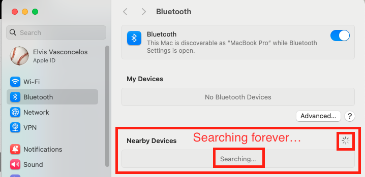

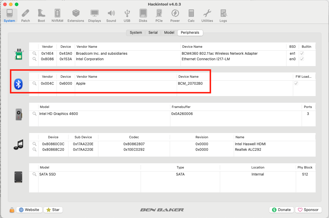

Hi friends,
I'm running Sonoma with OC 0.9.5 and root patched with OCLP 1.0.1 on a Thinkpad t440p using a BCM94360CS2 for wifi and bluetooth. Wifi works perfectly after patching with OCLP 1.0.1 and with the appropriate kexts and boot-args. The problem is with Bluetooth. It shows up but I'm not able to find any devices and AirDop isn't working at all. Does anyone know what could be the problem? Was working perfectly on Ventura before upgrading. I have tried a clean Sonoma install and same problem occured. Thanks in advice!!
Config is attached

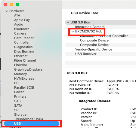

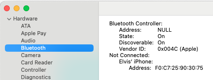

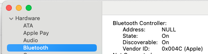

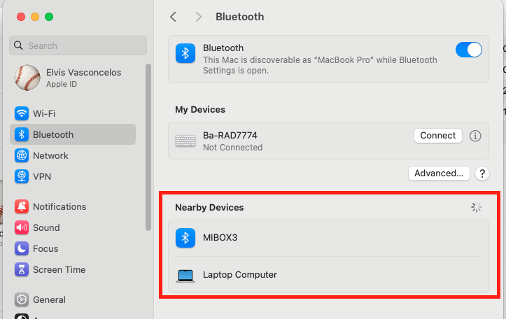

1 - Bluetooth keeps searching forever and doesn't find any device
2 - Bluetooth is recognized as so

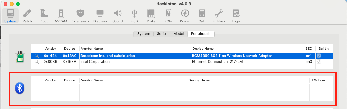

3 - Hackintool -> System -> Peripherals
config.plist

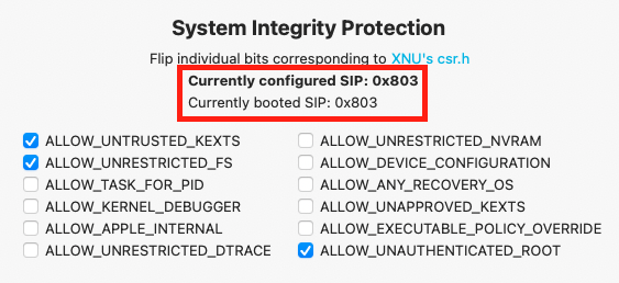

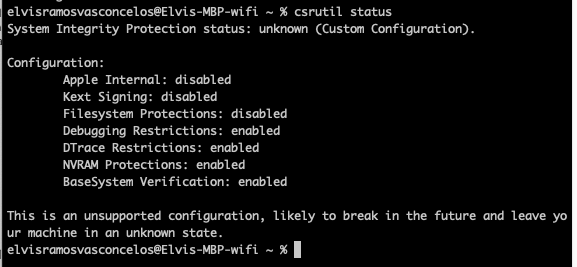

4 minutes ago, eSaF said:
Did you remember the boot-args i.e disable SIP plus the AMFI entries in boot-arg as well?
What about the three dependent kexts, are they listed in the correct order in config.plist?
Those things must be considered to have a successful operation with OCLP in Sonoma.
Yes, I've managed to follow those details as so. Wifi is working perfectly fine, the problem is only with bluetooth.
@elvisv  and @eSaFThe 802.11 kexts and SIP have nothing to do with Bluetooth.  There were Bluetooth fixes in OCLP related to the RestrictEvents.kext and VMM kernel patches.  Disable the VMM kernel patches in your config.plist and make sure you are using the latest RestrictEvents.kext 1.1.3 from here.  Use revpatch=sbvmm instead of the VMM kernel patches.
EDIT: At the risk of voicing an unpopular opinion and inciting debate, I find it very helpful to use OCLP to "Build and Install Open Core" and to examine the resulting EFI generated by OCLP.  Very informative and educational.  Do NOT use the OCLP-generated EFI on your hack - just use it as a reference.
EDIT2: and to reiterate something clarified by @Stefanalmare, there is only one OCLP for real Macs.  There is no version of OCLP that is for hackintoshes.  OCLP Devs support only real Macs at this time.  They have added non-Apple 802.11 Wi-Fi IONames to OCLP only to be consistent with AirportBrcmFixup, not to support hackintoshes.
EDIT3: Also make sure you are using BluetoolFixup.kext version 2.6.8.
EDIT4: @elvisv Maybe I missed it, but I don't see any bluetooth kexts in your config.plist.  Not sure what you need for your device, but the bluetooth kexts are in the Acidanthera BrcmPatchRAM package.

@eSaF, haha!! Yes I knew this was coming. This EFI folder is coming from way back, that's why! It's definitely confusing and now is a great opportunity to declutter. Thanks alot!!
@deeveedee, YOU SAVED MY DAY! Now I'm back to business with Bluetooth, AirDrop is working again!
Like I said this EFI is coming from way back, so not sure which of the steps fixed it, but I did the following as suggested:

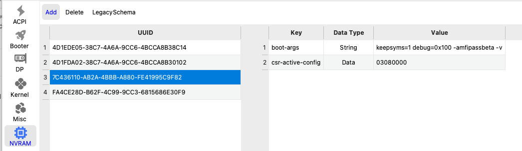

2 - NVRAM > Add > 7C436110-AB2A-4BBB-A880-FE41995C9F82 [Added]
  • a - boot-args String revpatch=sbvmm
