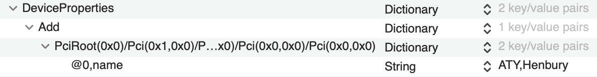

It depends on what smbios you use...if is MacPro7,1 or iMacPro1,1 , you need to inject correct framebuffer for RX6800XT in your config.plist (my real Apple MacPro7,1 with Radeon W6800X DUO have the same issue with Ventura...remember, Ventura is alpha/beta release...don't work like a charm until MacOS 14 come out ahahah xD LoL )
Edited by D3v1L
example: RX6800/XT you need to use ATY,Belknap framebuffer... try it! just add your pci root of your RX6800XT and then @0,name ATY,Belknap on Device Properties in config.plist like pic: (put Belknap instead Henbury)
you find PciRoot of your RX in Hackintool PCI tab:
simply right clic, copy device path
Edited by D3v1L

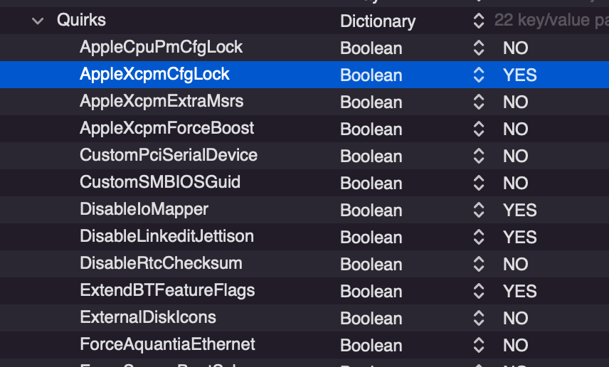

Does anyone have the kernel AppleXcpmCfgLock working with Ventura?. ( Mostly needed on some GA Mobos ) X99/X299?
I have constant KP on wake from sleep, which is also what happens if I remove the quirk in previous version of OSX ( tested from Mojave -> Monterey ).
Edited by Ellybz
44 minutes ago, eSaF said:
This is the setting on my GA-Z390 in Ventura, no problem with Sleep/Wake. Hope I interpreted your query correctly.
  Hide contents
Thank you my friend but if you didn’t need this quirk before OSX Ventura, chances are you won't needed. That’s why I wrote “some Mobos”. Most likely x99/ X299 😉
Edited by Ellybz
I am pretty sure that this patch works with Ventura when I was checking all quirks. You can leave it on if you have problems without it?
I’m using MacPro7,1 and I have followed a guide about adding those device properties but it had more than one listed
It had @0 and @1 and@2 I think.
Do I only need the one line? @0,name belknap
If you use only @0, the 1,2,3 pick up same value... Put all port framebuffer is needed when you want to separate every port with different fb...like you want port 0 with Belknap, port 1 with Henbury etc...if you want same fb for all port, only 0 Is needed... Btw, MP7,1 , put @0 patch, remove whatevergreen and the related bootarg agdpmod=pikera and give it a shot
Edited by D3v1L
Is it possible? AFAIK one framebuffer describes all ports.
Hi @Ellybz this quirk is not needed if CFG-Lock is disabled in the BIOS.
There are different kinds of CFG Locks. (BIOS/CPU)
On all Gigabyte  X299 , ( This my second X299 GA Mobo ) even if CFG Lock is disabled in  Bios, you'd sill need a XCPM Kernel to patch entry for the xcpm_core_scope_msrs.
As far as I can remember, it needed to be updated on each OS release. It was done manually in Clover, but with OpenCore, a quirk was created for this purpose. Thank you Devs!
Again this issue does not affect boot or functionality. It is only related to a KP after wake from sleep.
Z390 is not affected by the issue.

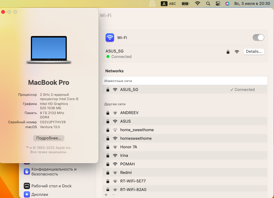

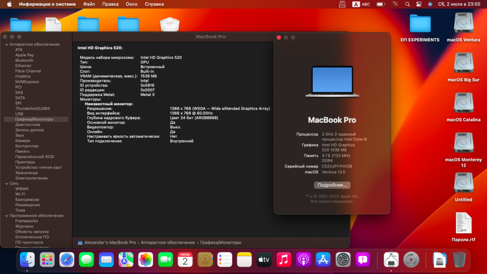

Hi, a very brief description of installing macOS Ventura on a Dell Vostro.
the camera is not connected.
HD Graphics 520 is normal by my standards, audio, wired internet work.
wi-fi is detected and working)After closing and opening the laptop lid, the system wakes up.
Touchpad, gesture, keyboard work,Booting macOS Ventura from an external SSD drive
As described above, there are some pitfalls. I'm just a user - this is my hobby and experiments.
Pre.OC 0.8.2 macOS Ventura.
https://drive.google.com/file/d/1sZ80ItkXzg-BIS02tkEJ878ltJ60AYbc/view?usp=sharing
