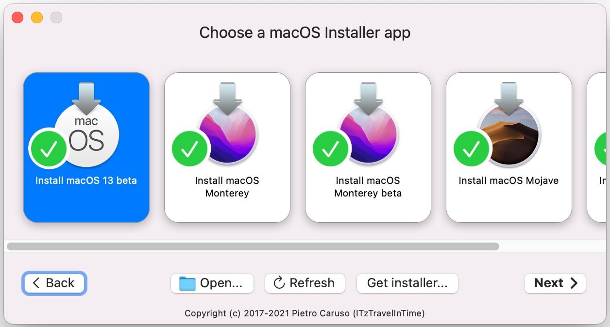

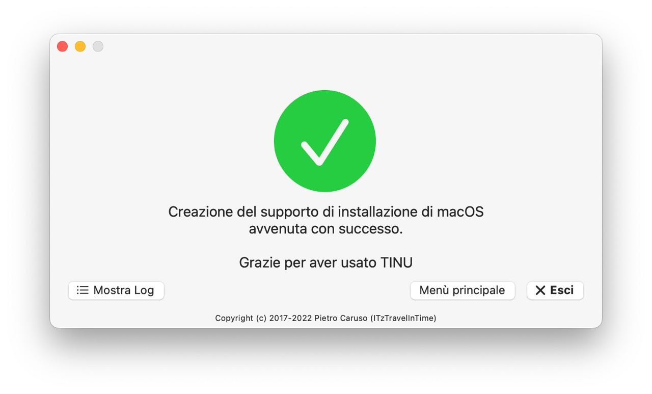

ITzTravelInTime Posted June 7, 2022 Share Posted June 7, 2022 (edited) So I managed to successfully boot the installer on my Mac Pro 5,1 from 2010 which is a socket 1366 machine (mine specifically is a single cpu machine and I am using it with a xeon x5680) so can I pretty much deny that the new os requires AVX2, it could boot if you don’t have any AVX extensions. Other news is that I can also confirm that the latest release of the TINU app (which is a very easy to use app to make macOS usb installers) works with macOS 13 Ventura out of the box, so no update is needed. More about the app here if you are curious: github.com/ITzTravelInTime/TINU Edited June 7, 2022 by ITzTravelInTime 4 2 Link to comment https://www.insanelymac.com/forum/topic/351969-pre-release-macos-ventura/page/3/#findComment-2783856 Share on other sites More sharing options...

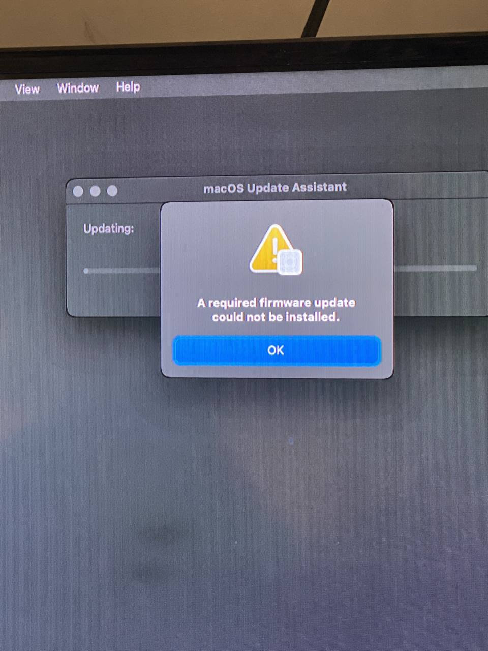

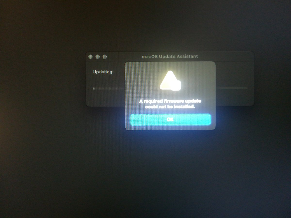

Andres ZeroCross Posted June 7, 2022 Share Posted June 7, 2022 Got that error in second phase installation. First installation was smooth, but when boot in to second phase i got that error notification. I have tried with SMBIOS iMacPro1,1. iMac19,1, MacPro7.1. Full installer from GibmacOS command Link to comment https://www.insanelymac.com/forum/topic/351969-pre-release-macos-ventura/page/3/#findComment-2783858 Share on other sites More sharing options...

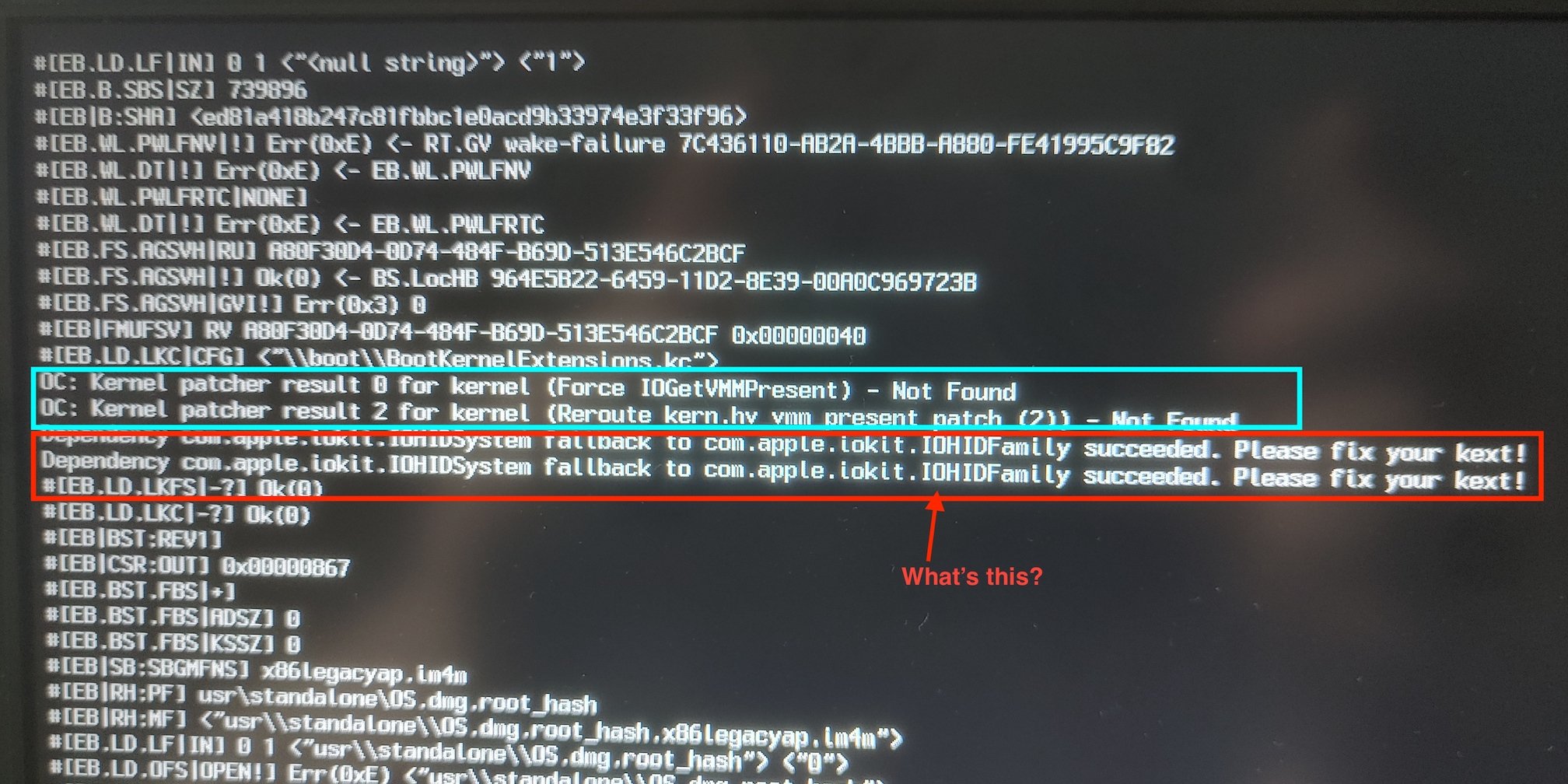

Guest 5T33Z0 Posted June 7, 2022 Share Posted June 7, 2022 (edited) Trying to install on my Ivy Bridge Laptop. Trying figure out if OCLPs Board-Id VMM Spoof and Chris1111's Intel HD4000 are still working. EDIT Board VMM spoof doesn't work There's also another error abot IOHIDFamily. Could be the old VoodooPS2ControllerTrackpad Kext, I guess Edited June 7, 2022 by 5T33Z0 Link to comment https://www.insanelymac.com/forum/topic/351969-pre-release-macos-ventura/page/3/#findComment-2783868 Share on other sites More sharing options...

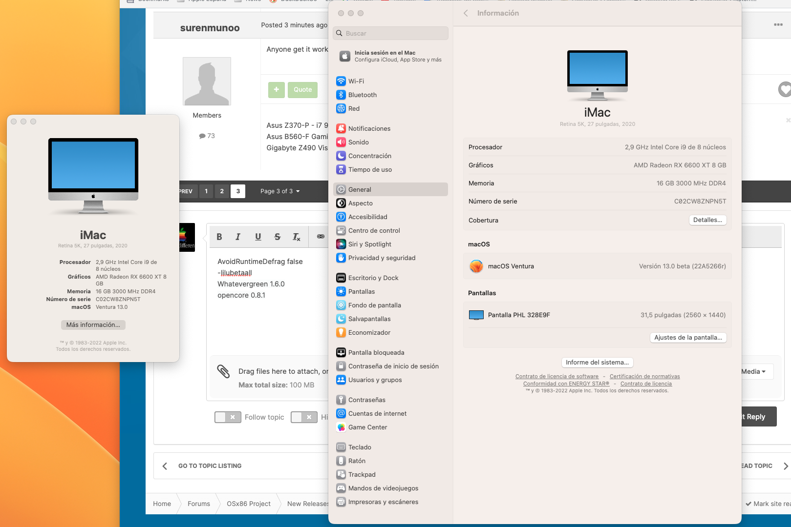

Derty Posted June 7, 2022 Share Posted June 7, 2022 (edited) AvoidRuntimeDefrag false -lilubetaall Whatevergreen 1.6.0 opencore 0.8.1 installed applications run correctly Edited June 7, 2022 by Derty 5 Link to comment https://www.insanelymac.com/forum/topic/351969-pre-release-macos-ventura/page/3/#findComment-2783875 Share on other sites More sharing options...
