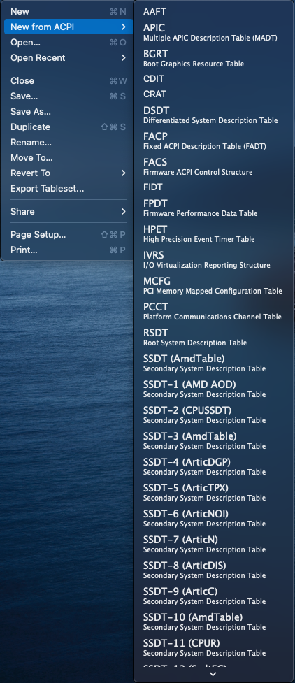

sash11 Posted November 2, 2021 Share Posted November 2, 2021 21 hours ago, 5T33Z0 said: @sash11 Try the DMAR fix method I talked about earlier. it's supposed to work for 500 chipsets: https://www.insanelymac.com/forum/topic/348493-discussion-intel-i225-v-on-macos-monterey/?do=findComment&comment=2770611 Not sure how to drop DMAR and inject modified one. Any guide that I can follow? 2 Link to comment https://www.insanelymac.com/forum/topic/348493-discussion-intel-i225-v-on-macos-monterey/page/7/#findComment-2770878 Share on other sites More sharing options...

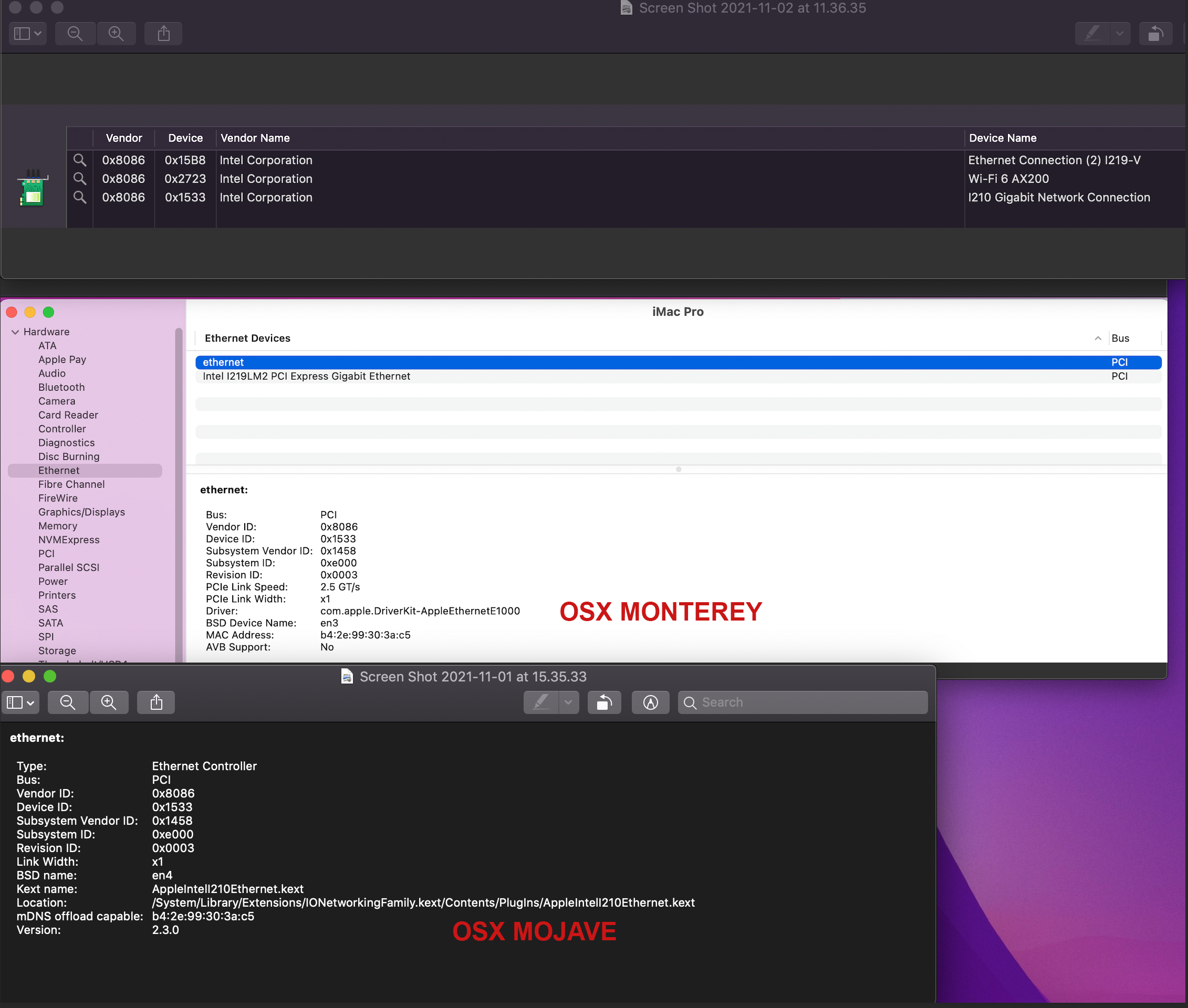

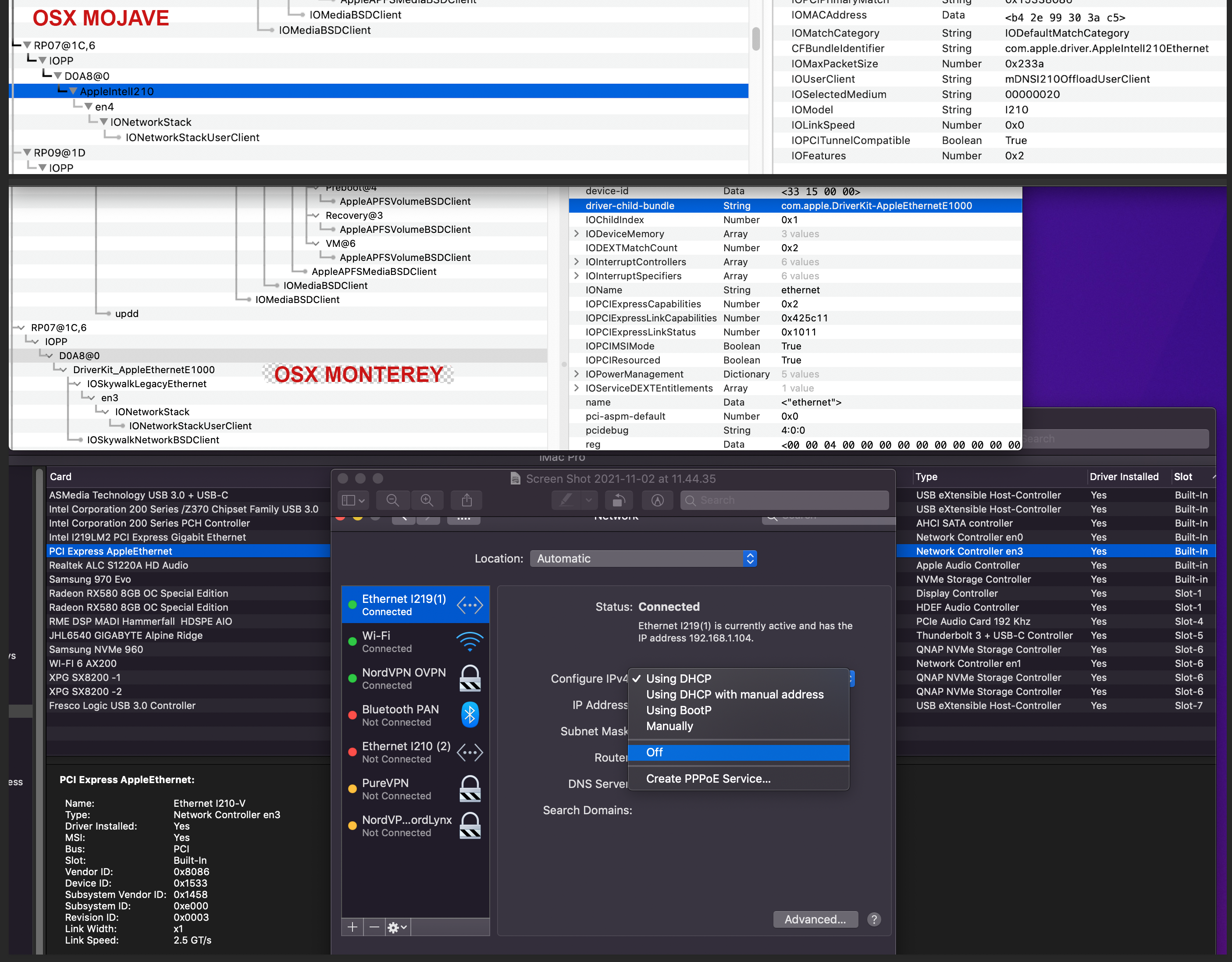

Ellybz Posted November 2, 2021 Share Posted November 2, 2021 (edited) I've been fighting on this issue for the last few days. I have the same behavior on my X299. I210 is not working. I219 is fine. The weirdest thing is that all my devices are properly reported in Hackintool & About this Mac/System report ethernet & Pci. If I switch the ethernet cable from i219 to i210 i still get nothing in network preferences " Either the cable for Ethernet I210 (2) is not plugged in or the device at the other end is not responding." The light never turn green. Even when the i210 is plugged on cold boot. I have tried different kexts including the modified from @Shaneee from another forum. Nothing works. ( i210 didn't need any kext in Mojave to work ). To make the matter worse if I decide to turn off the i219 from the submenu in network prefs ( see below ) I get an instant KP. Never happened before. Can anyone confirm a KP by switching OFF their IPV4? i210 was reported working in beta7 & beta 8. PS: I disabled the DisableIOMapper Quirk. Vt-d in BIOS is enabled. Also tried with boot arg: dk.e1000=0 PS: Also tried changing Device ID & disabling Vt-d in BIOS as suggested here: https://github.com/dortania/bugtracker/issues/213 resulting in KP when cable is connected to i210. Will try the DMAR solution soon. Edited November 3, 2021 by Ellybz 3 Link to comment https://www.insanelymac.com/forum/topic/348493-discussion-intel-i225-v-on-macos-monterey/page/7/#findComment-2770883 Share on other sites More sharing options...
Guest 5T33Z0 Posted November 2, 2021 Share Posted November 2, 2021 3 hours ago, sash11 said: Not sure how to drop DMAR and inject modified one. Any guide that I can follow? https://github.com/5T33Z0/OC-Little-Translated/blob/main/00_About_ACPI/ACPI_Dropping_Tables/README.md Link to comment https://www.insanelymac.com/forum/topic/348493-discussion-intel-i225-v-on-macos-monterey/page/7/#findComment-2770896 Share on other sites More sharing options...
Irish_Man Posted November 3, 2021 Author Share Posted November 3, 2021 (edited) 23 hours ago, Ellybz said: I've been fighting on this issue for the last few days. I have the same behavior on my X299. I210 is not working. I219 is fine. The weirdest thing is that all my devices are properly reported in Hackintool & About this Mac/System report ethernet & Pci. If I switch the ethernet cable from i219 to i210 i still get nothing in network preferences " Either the cable for Ethernet I210 (2) is not plugged in or the device at the other end is not responding." The light never turn green. Even when the i210 is plugged on cold boot. I have tried different kexts including the modified from @Shaneee from another forum. Nothing works. ( i210 didn't need any kext in Mojave to work ). To make the matter worse if I decide to turn off the i219 from the submenu in network prefs ( see below ) I get an instant KP. Never happened before. Can anyone confirm a KP by switching OFF their IPV4? i210 was reported working in beta7 & beta 8. PS: I disabled the DisableIOMapper Quirk. Vt-d in BIOS is enabled. Also tried with boot arg: dk.e1000=0 PS: Also tried changing Device ID & disabling Vt-d in BIOS as suggested here: https://github.com/dortania/bugtracker/issues/213 resulting in KP when cable is connected to i210. Will try the DMAR solution soon. Shouldn't BSD name be en0?? I don't think it will fix it but just a thing I noticed on your pics. Edited November 3, 2021 by Irish_Man 1 Link to comment https://www.insanelymac.com/forum/topic/348493-discussion-intel-i225-v-on-macos-monterey/page/7/#findComment-2770976 Share on other sites More sharing options...
sash11 Posted November 3, 2021 Share Posted November 3, 2021 23 hours ago, 5T33Z0 said: https://github.com/5T33Z0/OC-Little-Translated/blob/main/00_About_ACPI/ACPI_Dropping_Tables/README.md I don't have DMAR table( Link to comment https://www.insanelymac.com/forum/topic/348493-discussion-intel-i225-v-on-macos-monterey/page/7/#findComment-2770994 Share on other sites More sharing options...
Ellybz Posted November 3, 2021 Share Posted November 3, 2021 (edited) 2 hours ago, Irish_Man said: Shouldn't BSD name be en0?? I don't think it will fix it but just a thing I noticed on your pics. I219 is en0 ( Main ethernet port ); Wifi is en1 ( see pic No 2 ) i210 is the extra ethernet port so BSD names are correct. I even trash/reset several times the system prefs. Edited November 3, 2021 by Ellybz 3 Link to comment https://www.insanelymac.com/forum/topic/348493-discussion-intel-i225-v-on-macos-monterey/page/7/#findComment-2770995 Share on other sites More sharing options...

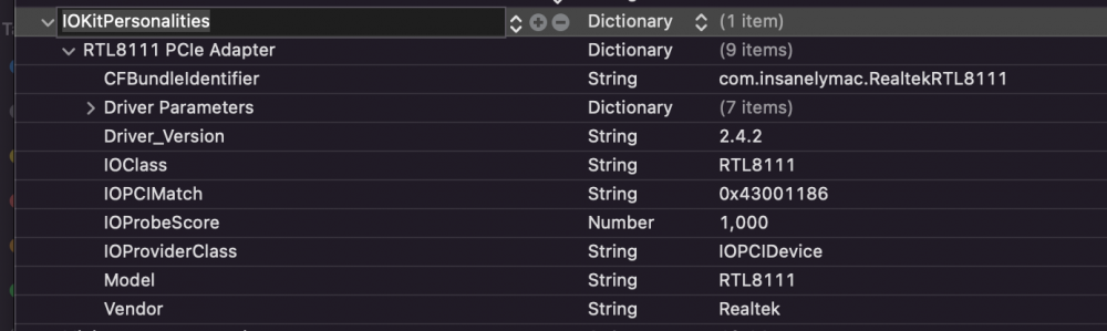

Henties Posted November 4, 2021 Share Posted November 4, 2021 @xtddd I am using a tiny, dirt cheap D-Link DGE-260T which was lying around. With @Mieze 's RealtekRTL8111.kext V 2.4.2, patched with the PCIID for this NIC (0x43001186) it just works like a dream, with all functions you can think of being available on my GA-7490 Vision G build, even "wake for network access". Thank you @Slicefor originally prompting me into this patching "direction" Attached is a screenshot as to where in the IOKitPersonalities section of the Info.plist the PCIID patch 0x43001186 has to go, also note that it has to "live" in that position by itself, sharing with other PCIID's will not lead to success. The only problem is that one looses a precious and scarce PCIe slot, especially on the mobo I am using with a wide GPU already taking up 3 slot positions, but that is life. I am hoping that sometime down the line I can revert back to the onboard i225-V NIC. Greeting Henties 2 Link to comment https://www.insanelymac.com/forum/topic/348493-discussion-intel-i225-v-on-macos-monterey/page/7/#findComment-2771032 Share on other sites More sharing options...
